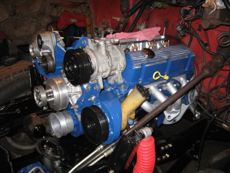

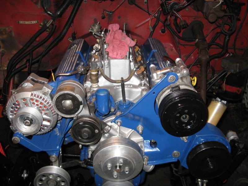

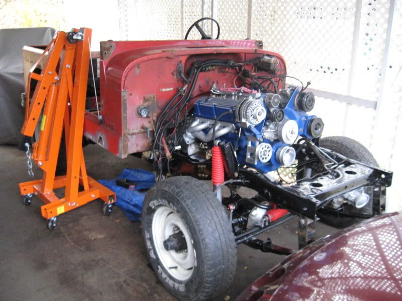

Got the valve covers that I painted on. Got a pair of Hedman truck shortys with the 02 sensor bung welded in. They actually fit pretty decent with room on both sides for starter, driveshaft and clutch linkage. The driver's side one doesn't look like it will be too bad to tighten up, but then again I haven't hooked up the clutch linkage yet. I lifted the tub up on wood blocks b/c I want to remove it soon, so I can get on with cleaning up the rest of the frame. Is there a way to edit the titles to these threads so I can make it my Jeep build thread? thx

Coming right along my friend.
You might be able to talk one of the mods into retitling your thread, otherwise you may need a new thread.

Those headers look exactly like my Summits- ceramic?
That is one purty engine.

Thanks who knows how long it will stay looking clean though..I got these headers off my buddy, they say Hedman and I just hit them with the high heat silver header paint. I would love to have them ceramic coated but the costs right now for that probably won't allow mw to buy other things I need.

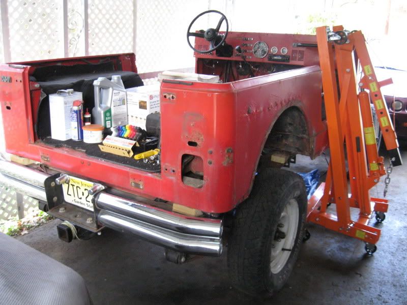

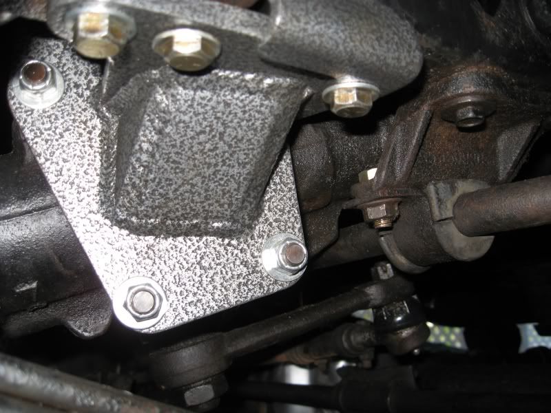

Been stripping the tub down the last couple days. Got the track bar on, tierod, sway bar with new bushings and extended endlinks on along with the steering stabilizer.

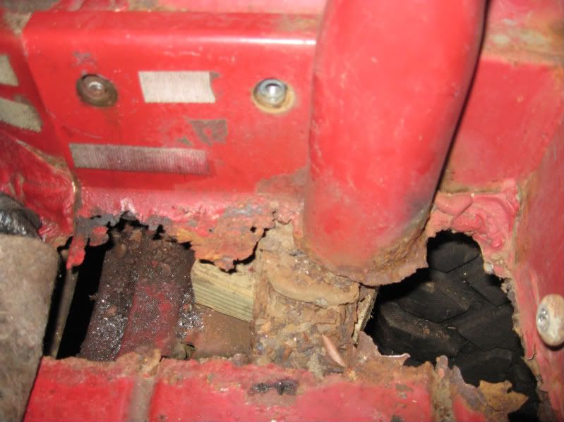

Yea its going. Too much rust and rot for me to deal with. I got a solid YJ tub as a replacement.
Here's an example under the rollbar
CJ7ROB is offline

Wow- that was a fairly substantial chunk of metal at one point.

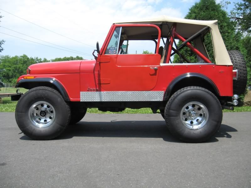

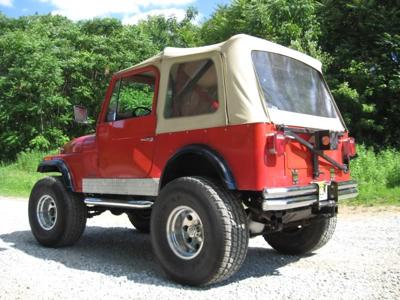

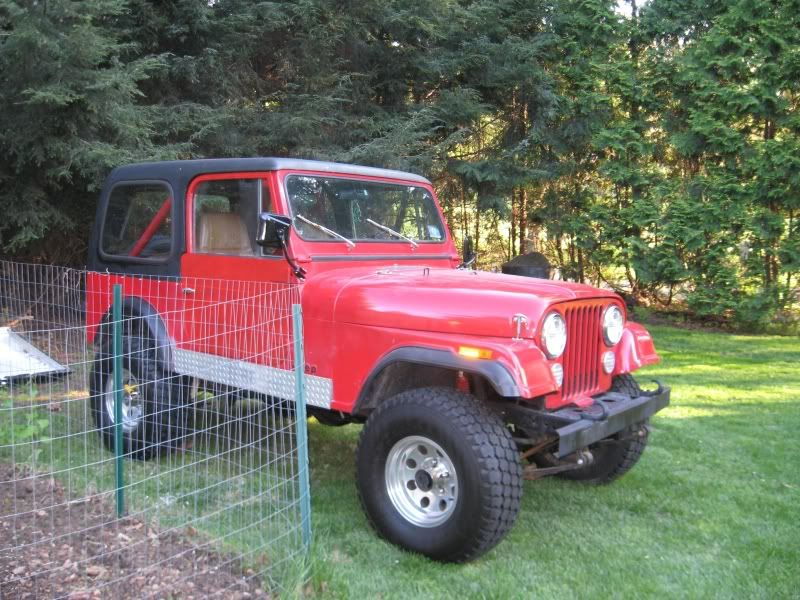

Here is some backround info on my Jeep in chronological order before I started to tear it down
This is how it looked when I got it
Traded it for these even up:

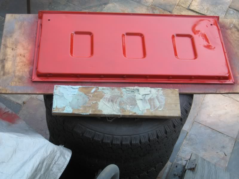

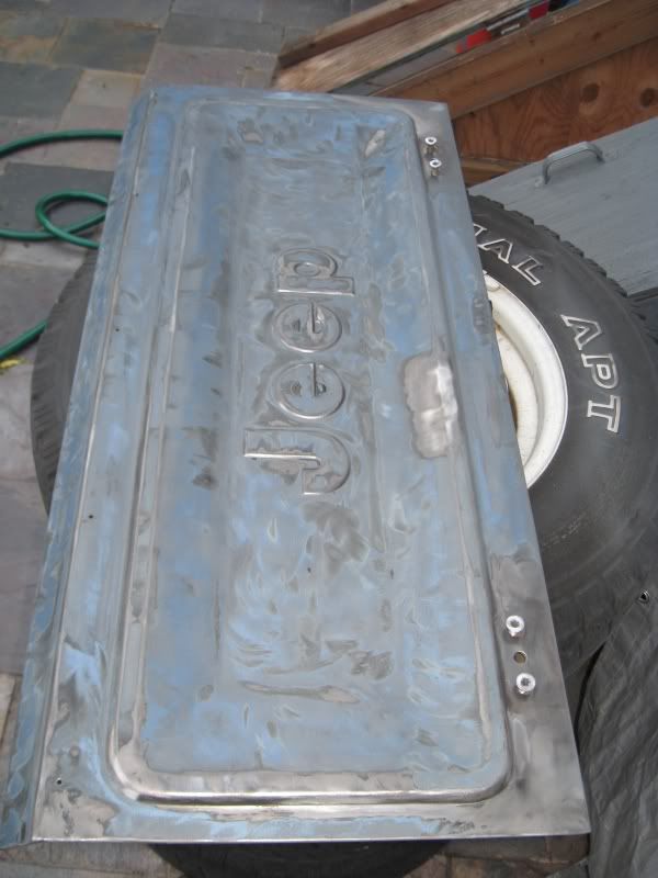

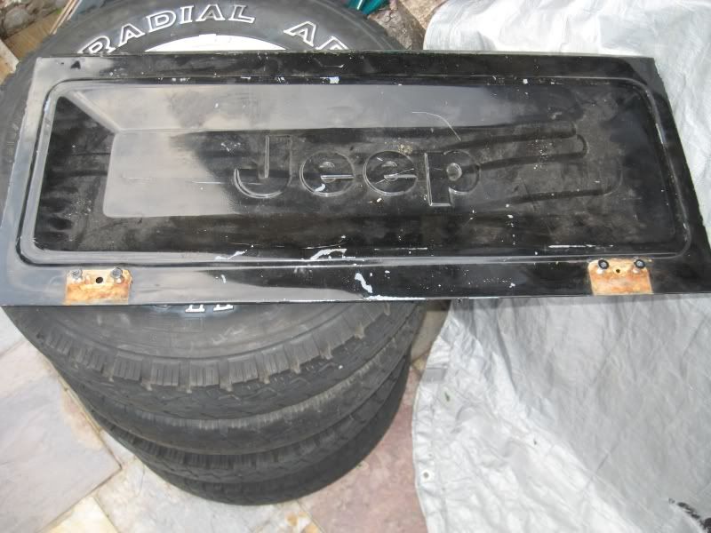

Found another tailgate and stripped it down, painted it.

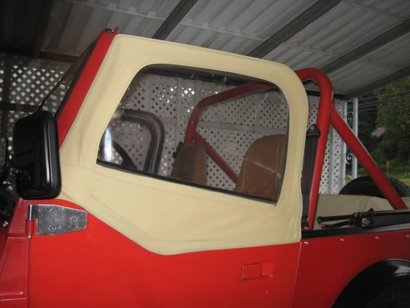

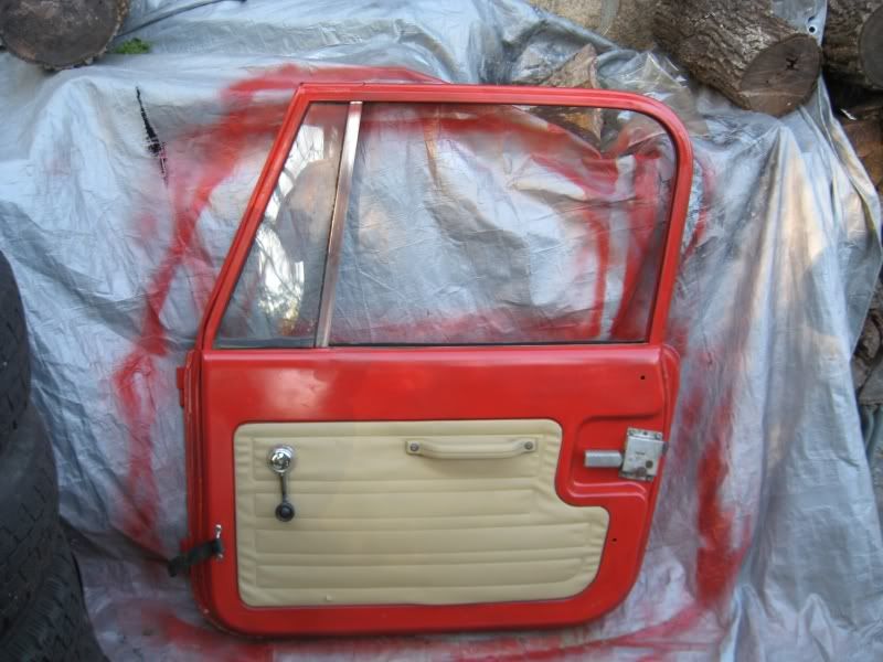

Found some older style hard doors and painted them
Put on a tube bumper and added a hitch

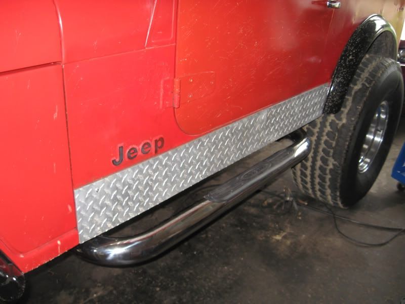

Added some diamond plate to the sides to cover some rust

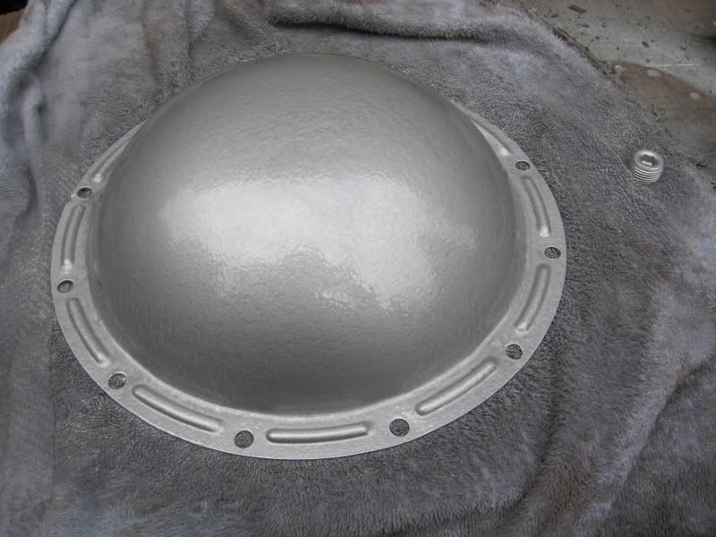

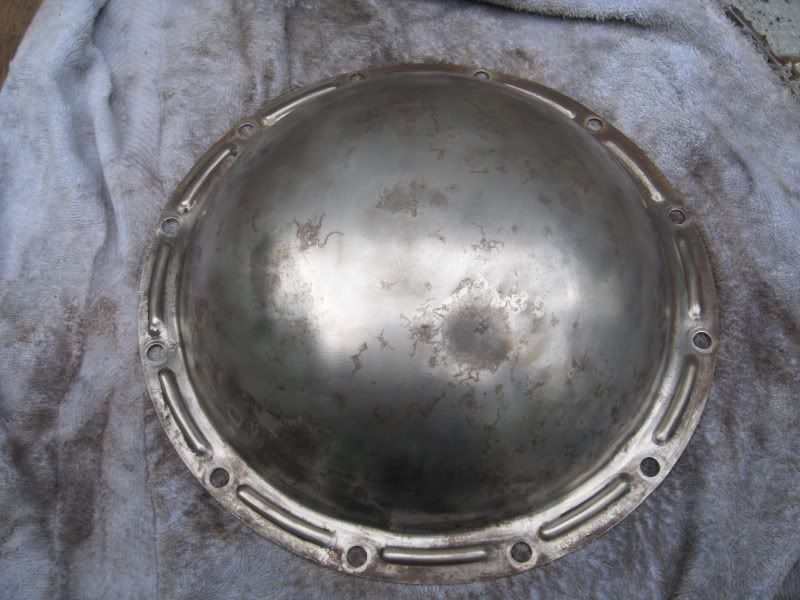

Stripped and painted the diff covers
CJ7ROB is offline

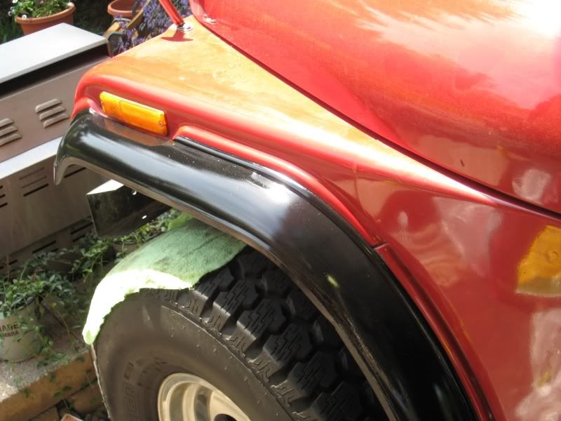

Painted the flares:

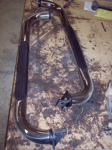

Added some side bars

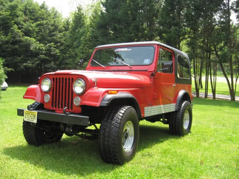

Put on a chrome Laredo grille

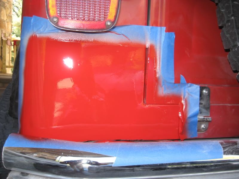

Filled some holes

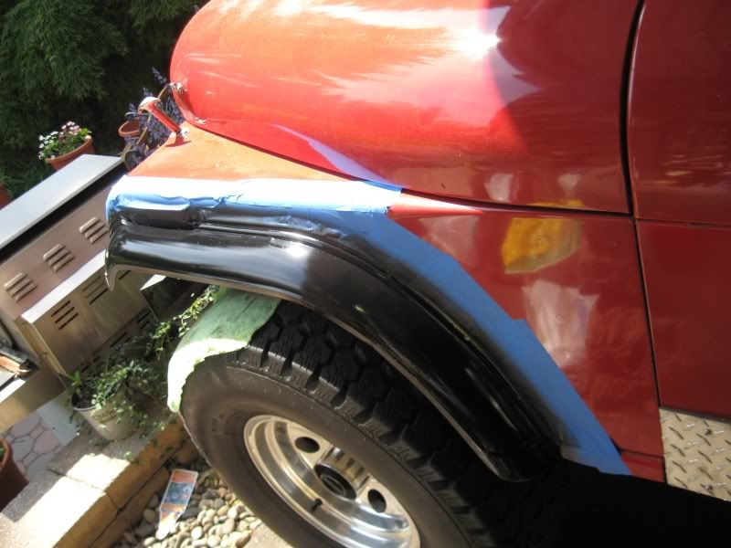

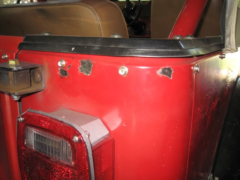

Fixed some rot
That is about it up until I started getting parts for the engine.
