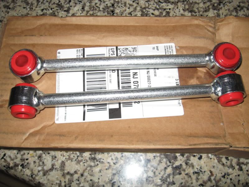

I ended up getting the correct Mustang alt and AC brackets, painted them up and installed them. The PS pump & bracket I have is for a truck, so I won't be using that, so I'll end up getting the correct Mustang PS pump & bracket.
Got my extended sway bar endlinks too.
