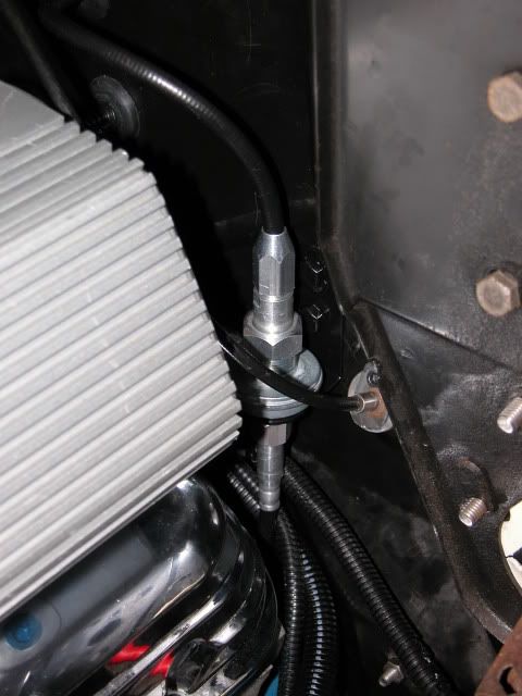

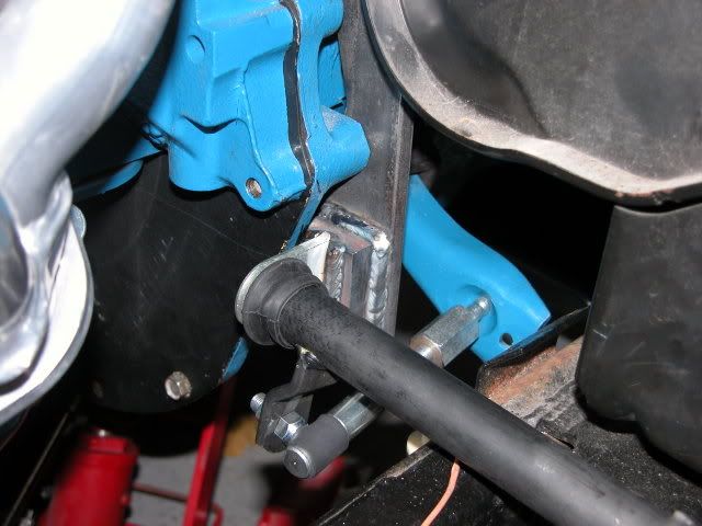

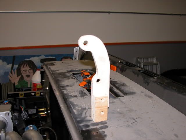

the engineering team at Hack Fabrication came up with this for the Mechanical Clutch Mount:
There wasn't enough room to bolt the OEM Jeep part to it so it got welded. They don't wear out as long as the nylon bushings are in place and grease is applied on a regular basis.

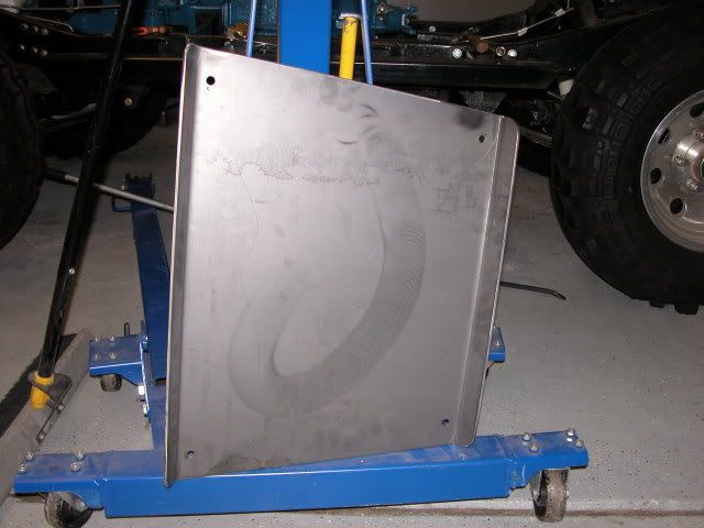

As far as engine placement, the MORE mounts will move the engine slightly.
On my 76 CJ5 I could not get the OEM skidplate to work. And trust me, I tried every possible way. Decided to go with the TDK skid/crossmember combo. I ordered it without the holes drilled for the trans or stabilizer mount.
"In the end...It's all Hack."

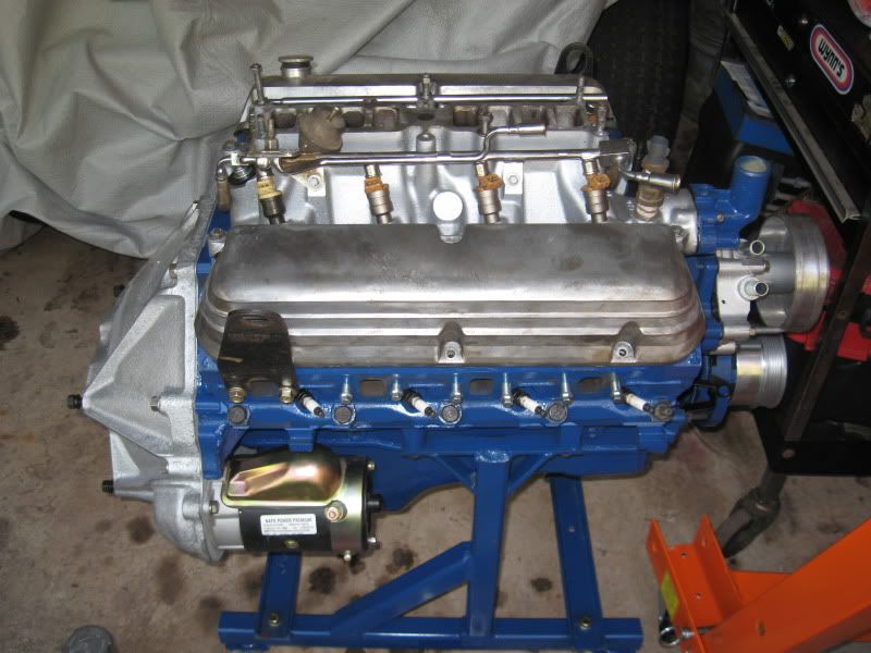

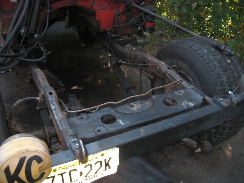

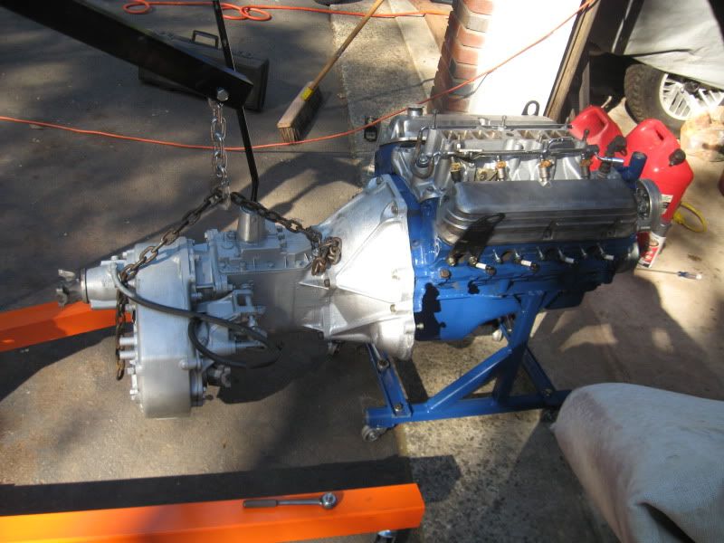

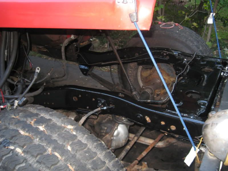

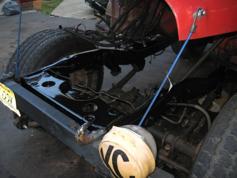

Got the engine on the cradle I made:

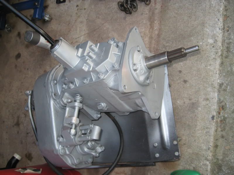

Trans and xfer case rebuilt and painted:

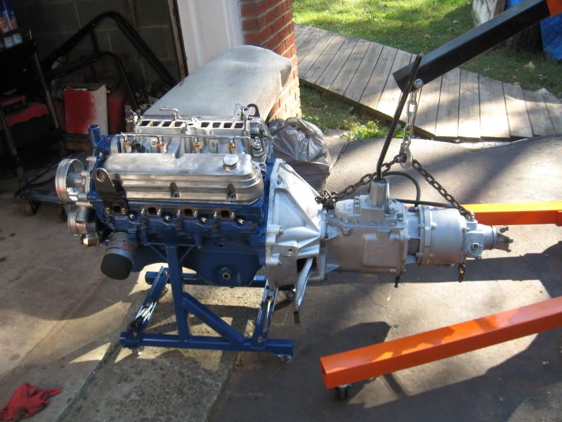

Trans mated to the engine:
Cleaned up frame:
Put on some chassis saver paint:

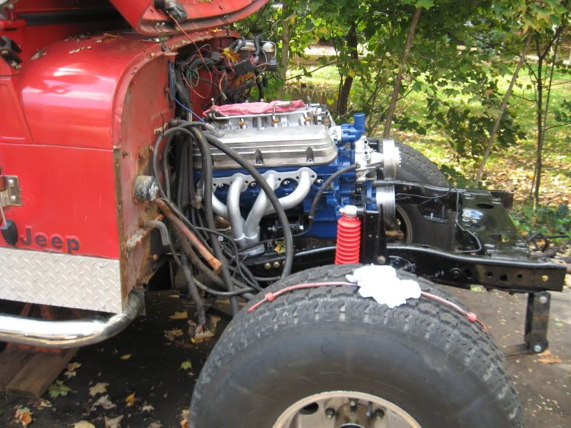

Got the engine and trans in today. Might have to trim the pass. side header to clear the starter.

Good call on the 150 amp alternator upgrade. That is on my shortlist.

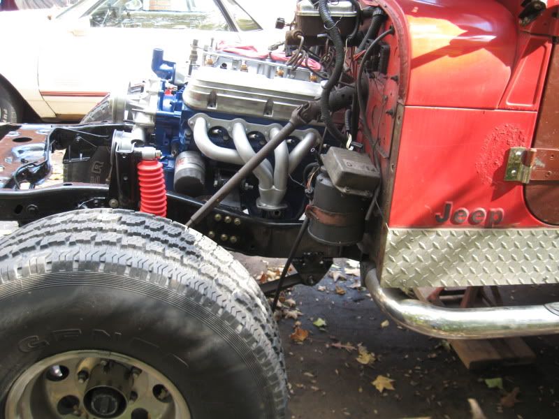

As far as trimming your header to clear the starter, here is how close mine turned out.
Mike

Originally Posted by Coiz View Post
Nice progress and looking good!
Thanks guys, Mike I got the alt $95 delivered to my door off ebay. Let me know if you want the link. Did you have to trim your flange at all, or its just very close?
