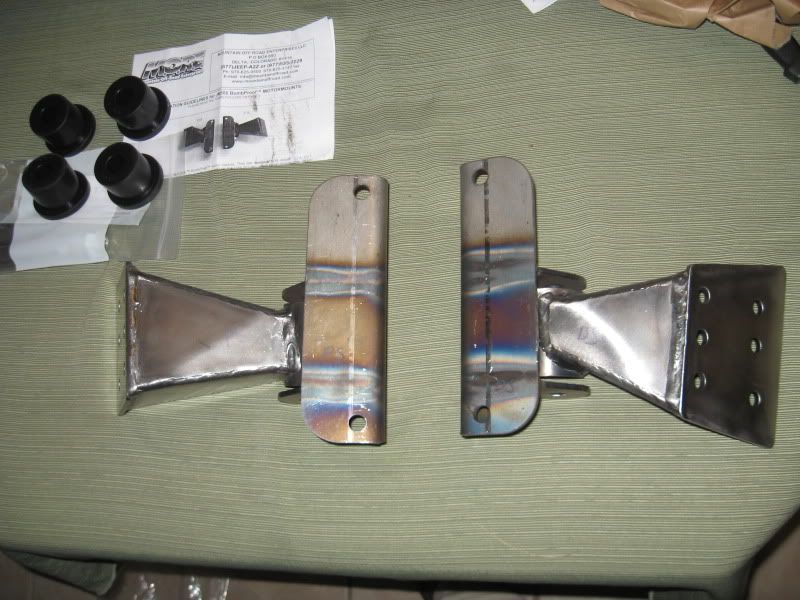

M.O.R.E sent me their mounts today. They are sweet. Thanks to Jim, Calvin and Hack for convincing me to get them

So is the engine in yet? I mean you have the mounts.

The MORE mounts locate the engine to just clear the firewall, from what I understand, so moving it back farther isn't really possible without cutting the firewall.

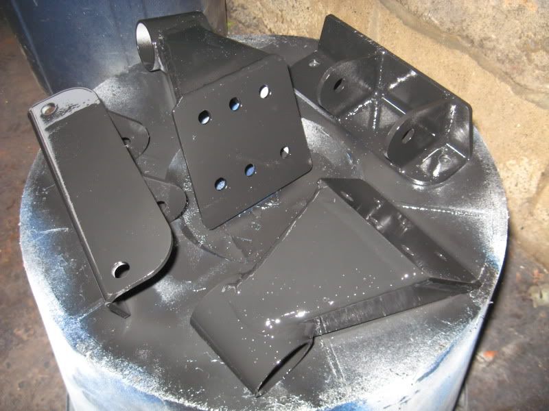

Yea Im hoping the mounts will place this engine right where it needs to be and the trans/xfer case get put in the right spot. Finished up this cradle for the engine so I can work on getting the flywheel, clutch and PP in.
Also painted the mounts

post #158 of 568 Old 09-23-2011, 04:18 AM
84MSRB

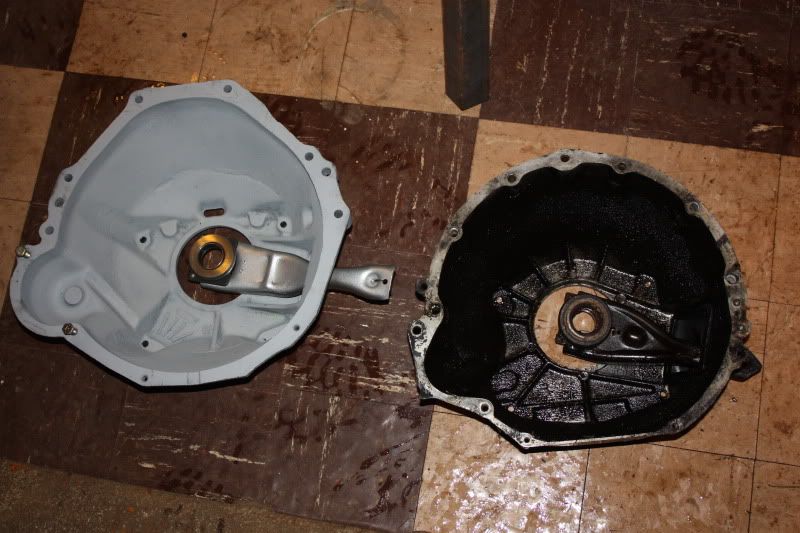

I put the TO bearing and clutch fork on the Ford bellhousing. Still need a new rubber boot. Anyone interested in a T176-to-Jeep Bellhousing?

Rob the stand looks great. There's just something about Ford Blue too. Hey where did you get your clutch fork? I need one just like that from what I can tell.

Thanks Jim, I figured paint it blue b/c it will probably only hold Ford Engines. The fork is from a '70 Bronco, same with the bellhouse and TO bearing.
