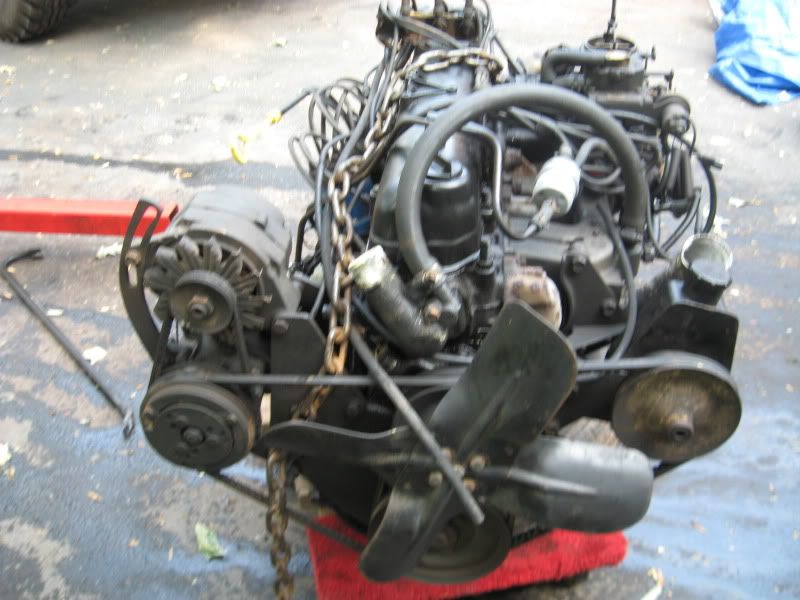

Thanks mvbrady for the PS pump idea. Today pulled the 258 out..anyone interested in a complete running 258 I6? Thanks

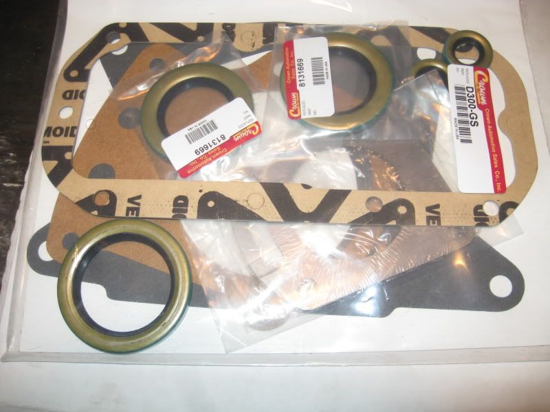

Got some goodies waiting for me when I got home today.
D300 gasket kit:
CJ7ROB is offline

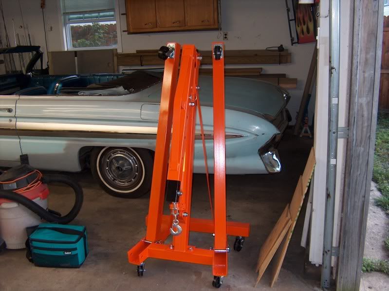

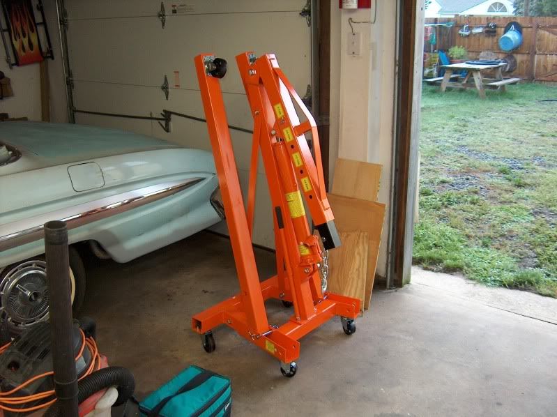

This past weekend I sold the old 258 for $475, so I was happy about that, now I have more Jeep fund$..bought this HF engine hoist for $99. Figured I couldn't go wrong, so now I don't need to borrow my buddy's anymore.

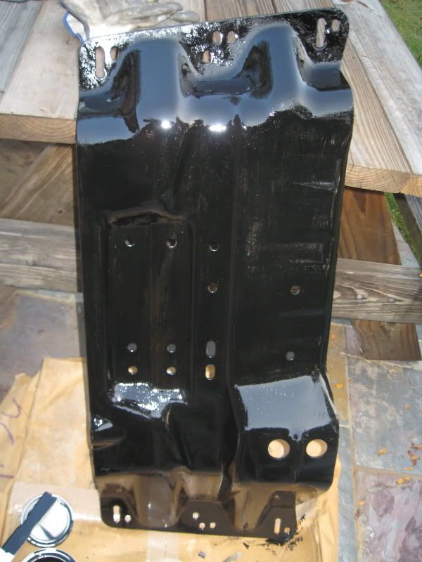

Trans and Xfer case ready for rebuilding, I didn't steal the shopping cart

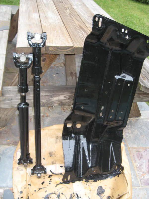

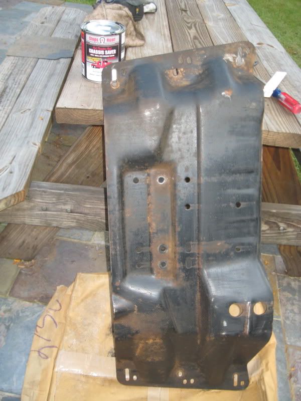

Prepped the trans shield:
Painted with the chassis saver paint 1st coat:

Painted the inside of the trans pan, swapped in the new U-joints and painted the shafts.
