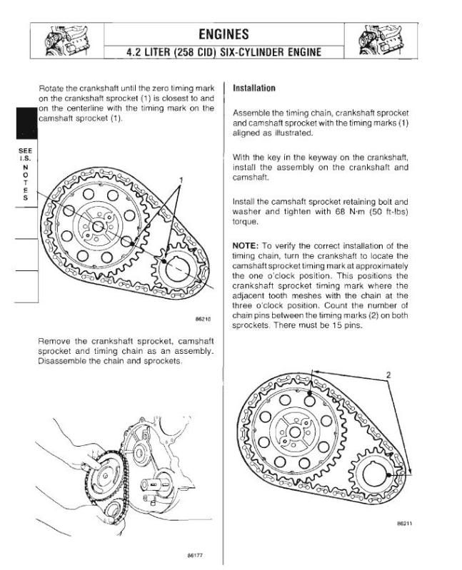

Yup and here it is; 3 o'clock timing mark on the crank and 1 o'clock on the cam, 15 chain pins between them. Hope this works!
That's the method I use and it has never been wrong.
Here's a page right out of the FSM for correct timing of the cam and crankshaft sprockets.
This. Dunzo.
