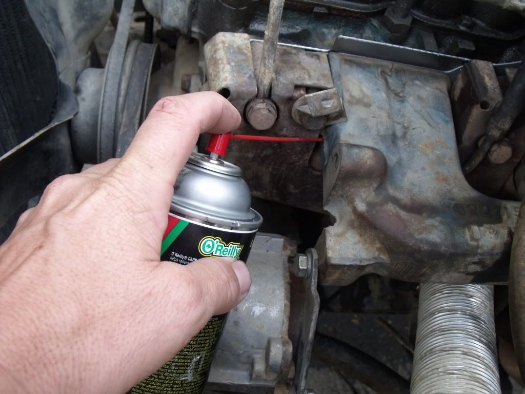

Are you looking for the thread pitch on the 5/8ths bolt above the red spray tube?
'79 CJ5, 258 c.i., Carter BBD, T-150, Dana 20, Dana 30, AMC 20, 33x12.50x15, 3" body lift, taking it back to stock, then tearing it apart and putting it back together again!

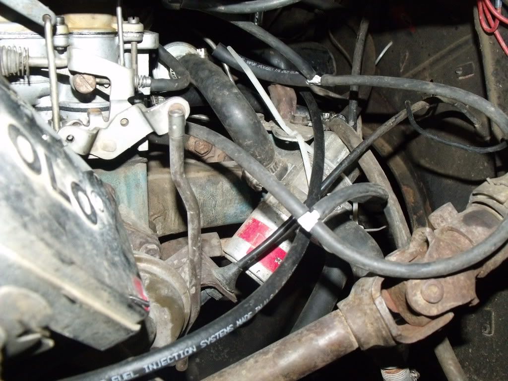

Sometime if you would look on your diverter valve can you tell were the smaller line (vacuum sensing inlet) were does the vacum line go on yours.

In this pic, you can see where the vacuum line goes.
