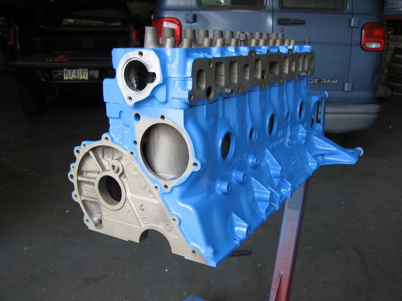

I have powder coated my entire engine, including the intake manifold and the heat has no effect on it. I even powder coated the cast iron exhaust manifold with a special silicone powder meant for high heat and it is holding up well. The engine has about 6000 miles on it since its been powdered and still looks as good as the day it was done.
