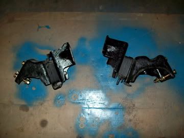

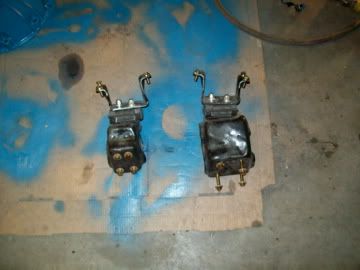

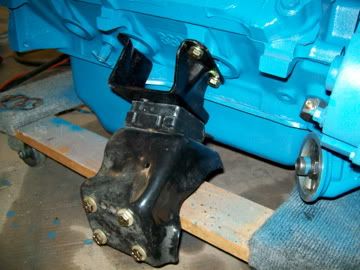

Originally Posted by Superjeep3 View Post
Let me re-phrase then. I have a set of block mounts from a 304 (I think...can't remember if they were on the 304 or not)
This is what CJ V8 block mounts look like (for comparison):
