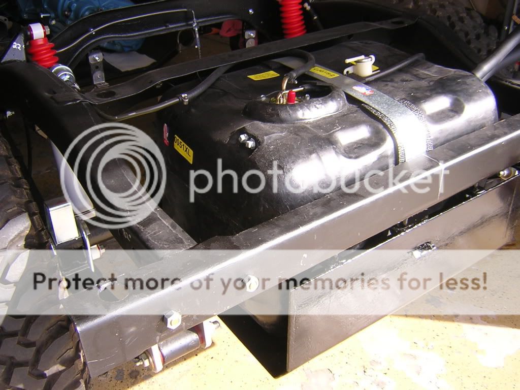

I picked up a 21 gal poly tank for my CJ. It was a complete kit with sending unit installed. It also came with extenders to lower the factory skid plate and a center strap. Maybe this weekend I can get a chance to install it.

http://www.maxbilt.com/20gasskid.html

Home made skid plate 3/16" steel,, most web sites sell (skid to OEM) extension for 20 retro tanks

I just installed a max-bilt into the frame of my 84. Looks good, very impressed with the quality.

Just did this upgrade on my CJ. Vent and filler neck are the same!! Just keep in mind that your tank will be lower, about halfway down the rear diff.
