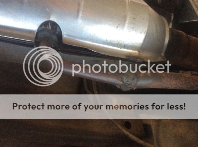

I recently bought the Jeep and need to get it smogged here in California.
I've ordered all the parts that are missing and should have them soon.
My question is what is the best way to connect the Downstream tube to the Catalytic Converter and the Upstream tube to the exhaust pipe? Do they need to be welded on or is there another way?
Thanks in advance for your help.

I just had a cat put on. I will post some pics.

My smog guy welded that up. He welds better than me, which doesn't say much about his welding. .

First pic does not show. How is the pulse air connection made at the catalytic converter and exhaust pipe? I haven't seen a CJ with those OEM emissions systems intact - either rusted away or removed. There must have been a flexible connector at the converter.
