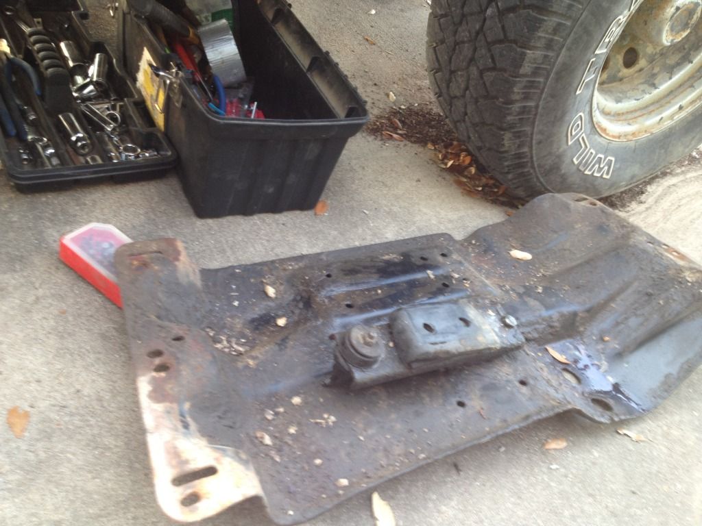

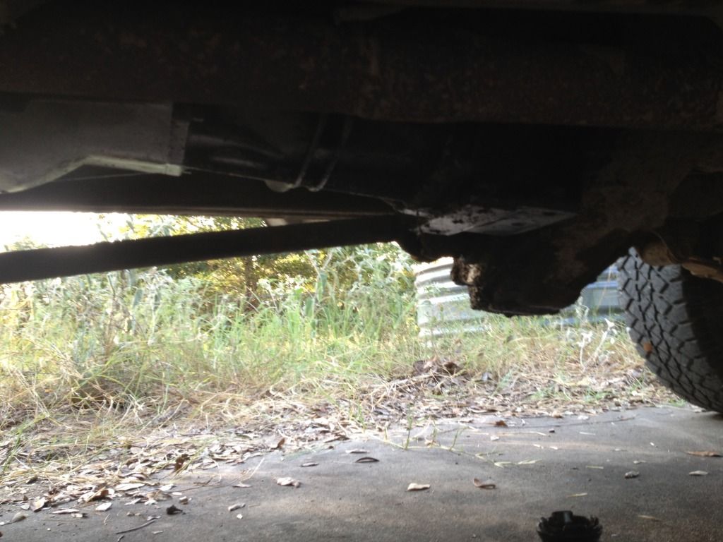

I had family in town this weekend, so I wasn't able to get as much done as I wanted to, but I spent some time yesterday evening doing odd jobs. I removed the windshield and started the process of removing the transmission. I had to stop so I do some research to make sure I was doing it correctly! When I removed the cross member for the transmission, I saw some transmission fluid leaking. I have the jack in place so when I get home tonight, I'm going to try my hand at lowering it down. As always, here are some pics. Sorry for the poor quality...I'm using my iPhone!
Removed the windshield. I've loosened the hinges but will have to wait until the dash is removed to finish.
Here's a pic of the cross member of the transmission. If you look closely, you can see how wet it is.
What my finger looked like after touching the cross member.
Removed! When I removed it, the transmission housing dropped about 6 inches, so I want to get it out ASAP!

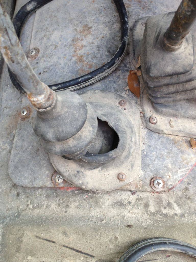

The shifter...I've already removed the screws to loosen the plate.

You got a good start on things! When you try to pull the transmission make sure you support the engine under the oil pan first. In fact, whenever the cross member is removed you should try and support the engine or transmission to prevent it from dropping like you experienced. Not a big deal since you are in tear down mode but for future maintenance you'll want to support them to prevent the valve cover from hitting the firewall, and/or fan from hitting the rad.
