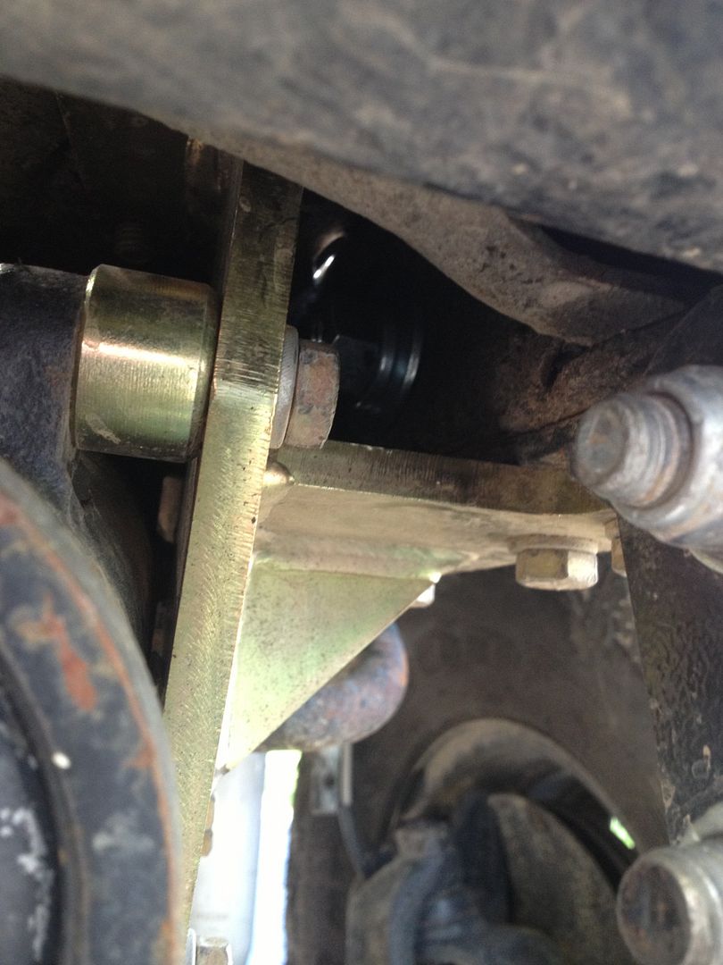

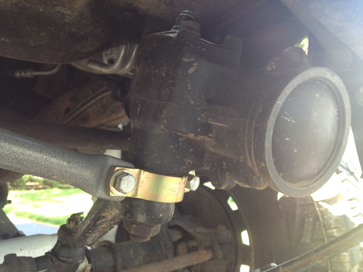

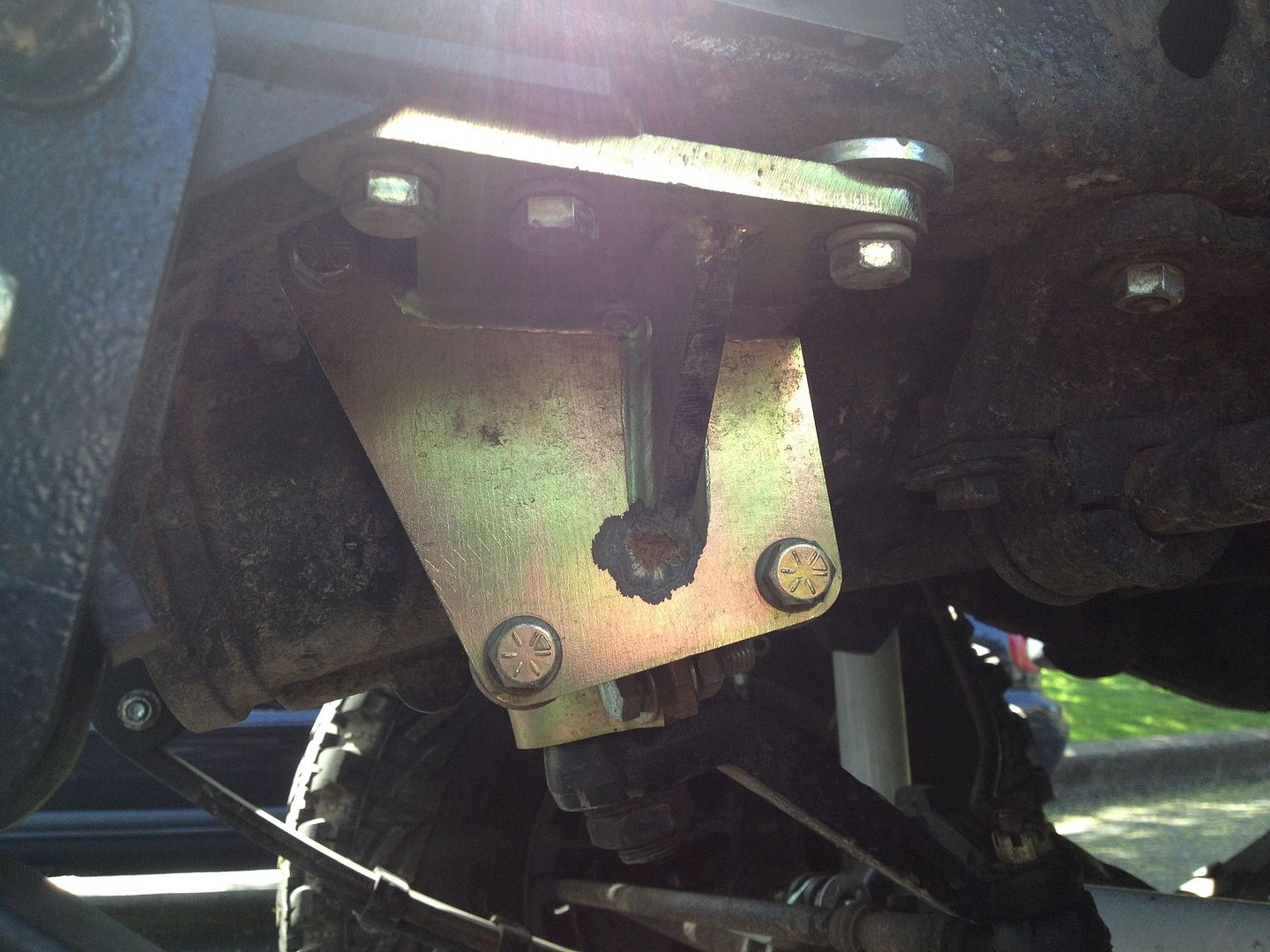

Originally Posted by weapon View Post
I agree with VACJ7. Something is just not right. I will go take a photo of mine at lunch and post it since my front end is in pieces and a good photo should be a easy.
*Oops. Just saw that you changed the brace order in the second photo. The MORE kit should have had a spacer to even out the level between the sandwiched parts.
You can see the spacer and correct setup in the photo.
Good to know you are liking the new box. These are the kind of things I love finding out about on Cj forums.
I forgot to update. The problem has been fixed.
The spacer is now on like it should be
