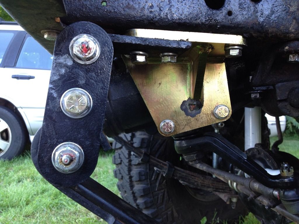

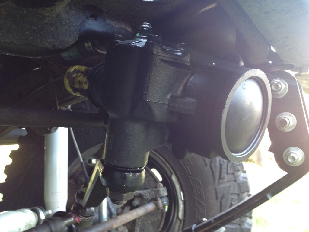

So the H1 Hummer steering box is now mounted along with the MORE HD bracket. Of course, as with anything I do with the Jeep, it did not go on without issue. Both lines on the stock steering box are now permanently attached and aren't going anywhere. I had to call up Quadratec and I have new lines coming in the mail. Should be in on Tuesday. The H1 box is much more heavy duty than the stock one, just based on looks alone. It really looks good on there. The MORE brace will be going on with the lines.
Now here was the really unexpected part. I had been feeling something weird going on in the front end when I was driving, and there was even like a clunk at times, and I just figured that the steering was the issue. I was wrong. One of the frame brackets, that holds the shackle to the frame, cracked right in half. I couldn't really get a picture of the crack when the Jeep was off the lift, but it was pretty bad. Just one of those things that could have been pretty bad if it wasn't discovered. If I didn't have the steering box issues, and the jeep was never put on a lift, I don't know if I would have seen the issue until I was out in the woods . . . .
Here was the bracket that cracked.
Here is was I ordered to replace the stock brackets. I ordered a complete set for the front and the rear of the jeep. I hope I can re-use the stock bolts because I forgot to order new ones . . . . .

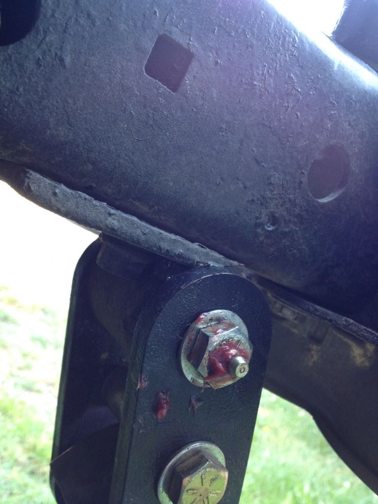

Originally Posted by diddy2003 View Post
Is this mounted correctly? I know the OEM bracket sandwiches the hanger between the mount and frame. Something about this does not look right.

post #29 of 78 Old 07-01-2012, 11:36 AM Thread Starter
diddy2003
1984 CJ7
Location: Holyoke
Posts: 778
I hear what you are saying about it looking funny, and I thought the same thing when I checked it out, but I really don't see how it could be mounted any other way. Here is the M.O.R.E picture of it installed, without the springs installed though:
It looks to be mounted exactly like mine, meaning it is flush with the frame. I don't see how the shackle hanger bracket could be installed to it any other way. It does look a little weird though.
diddy2003 is offline
post #30 of 78 Old 07-01-2012, 11:47 AM
GlennLever
GlennLever's Avatar
1984 CJ7
Location: Rochester
Posts: 2,300
I would at least make a spacer the thickness of the grear box bracket to go under the spring shackle.
Something like this (my spacer is under the stock gear box braket, your spacer would be under the shackle braket)
