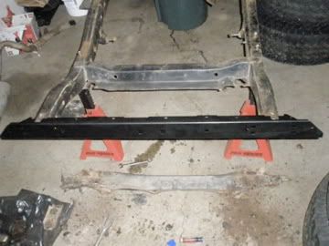

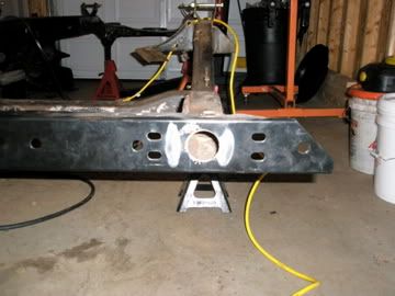

Frame repair I'm not to pleased with. After I mock everything up and then tear down for paint I will probably redo a couple of things, but for now I'm pushing forward.
Rear crossmember replaced with one from Quadratec. The mounts from the old one were totally eaten by rust. The rear of the tub had been sitting directly on the crossmember.
http://s636.photobucket.com/albums/u...10906_3231.jpg
The bolts and nuts swaged to the inside of the frame had totally siezed and broken off. With the crossmember off I chiseled them out. I used a hole saw to cut holes through the crossmember so I can now stick a wrench into the frame and tighten new Grade 8 nuts by hand.

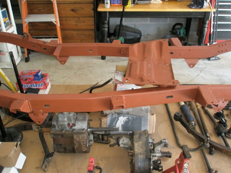

I repaired rust in all of the body mounts. Sanded and painted the frame with a coat of eastwood's brush on rust encapsulator. I will put on a second coat and paint with chassis black after the initial mockup.
http://s636.photobucket.com/albums/u...t=P3220015.jpg

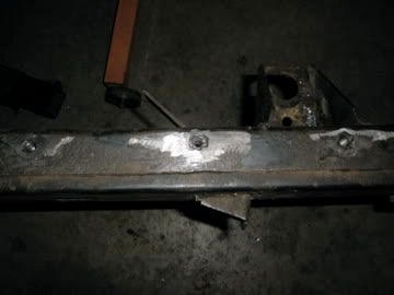

Welded in new 3/16 plate on all of the body mount horns. I still have to drill the actual holes but I will wait to do this until I have the fiberglass tub on the frame. You can also see the NP435 I'll be using. That thing is heavy.
http://s636.photobucket.com/albums/u...t=P3220016.jpg
Close up of a repair. Cut out rusted portion until only good metal was left, cut 3/16 plates to fit and welded in.
http://s636.photobucket.com/albums/u...t=P3220017.jpg

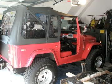

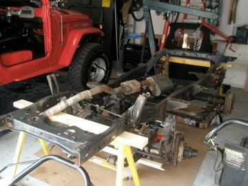

I moved back to VA and my dad let me keep my project in his garage. Next to his 76 FJ40.
http://s636.photobucket.com/albums/u...t=P1050028.jpg
http://s636.photobucket.com/albums/u...t=P1050029.jpg

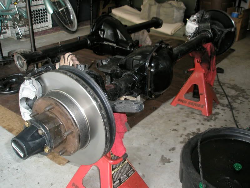

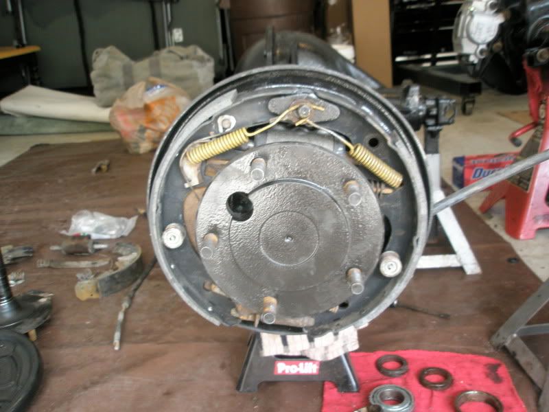

been back at it for a few days now and its moving along. i hope to have a rolling chassis by monday.
the axles, 4.10 gears installed in both
the calipers on the front axle are pretty loose, is this normal until there is pressure in the cylinder?
http://s636.photobucket.com/albums/u...t=P5130031.jpg
here's a shot of the front axle
http://s636.photobucket.com/albums/u...t=P5130032.jpg

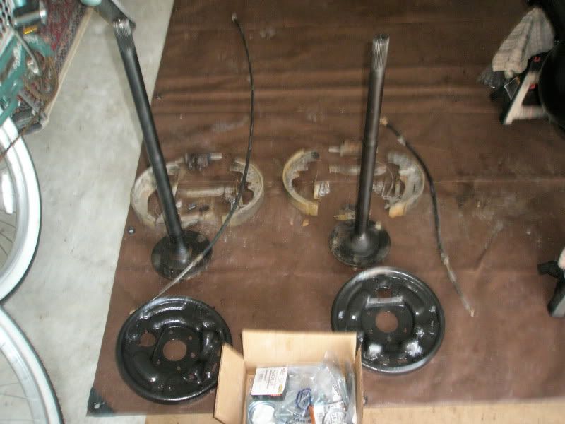

rear axle shafts disassembled and ready to be rebuilt
http://s636.photobucket.com/albums/u...t=P5130030.jpg

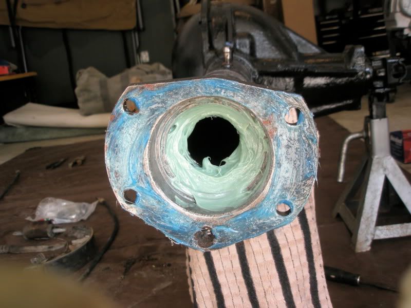

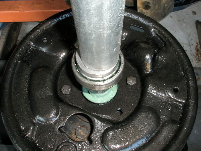

pressing on the new bearings.
http://s636.photobucket.com/albums/u...t=P5130034.jpg
housing is ready for the shaft. i only did one side today cause i broke one of the bearings in the press. i should have another bearing by monday.
http://s636.photobucket.com/albums/u...t=P5140035.jpg
brake shoes installed
http://s636.photobucket.com/albums/u...t=P5140036.jpg

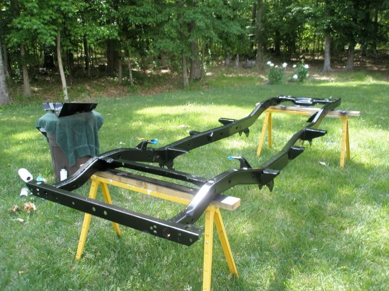

got the frame and skid painted today
http://s636.photobucket.com/albums/u...t=P5140038.jpg
