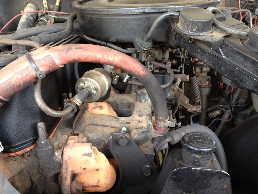

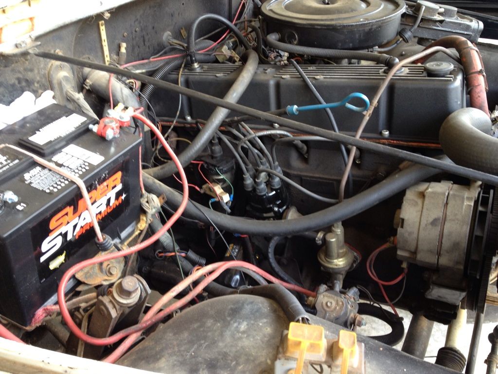

Here's some pictures of the engine before I replaced the battery, and before I've worked on the carb.
This is my first time owning a Jeep, and I have done a little bit of engine work on my F150. Can anyone tell me any details about my engine by looking at it? All I know right now is that I have a 258 4.2L Straight 6, & I'm pretty sure the carburetor is a Carter BBD double barrel. Not really sure about what else I've got going on in there, or what's been removed or added.

Eh, many here do not like the stock carb, the MC2100 is a decent upgrade.

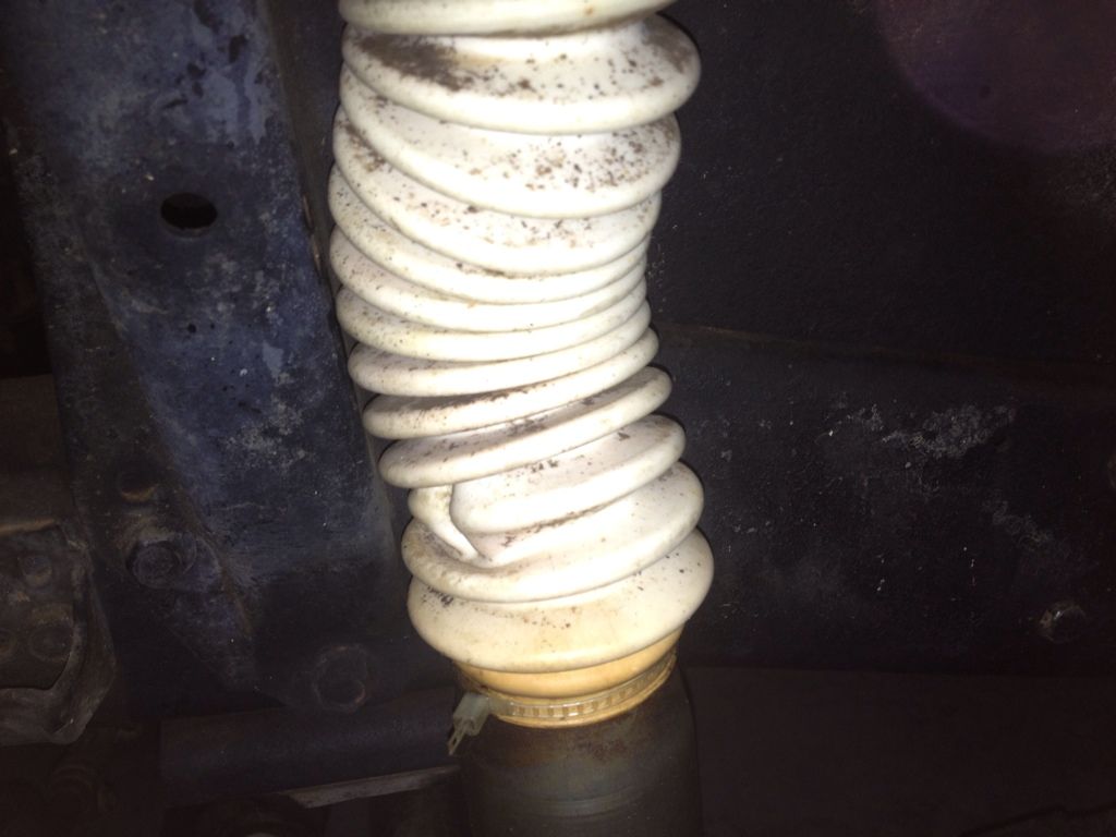

Does anyone have any suggestions on replacement shocks for the front? Needs to be inexpensive. Can I just refurb these? I have no idea if that's possible or not.
Here are some pics of the one that I have now which is loose:

I had really bad idle issues. I replace all my hoses and it fixed. it. Hose is really cheap. As for the shocks check Rockauto.com. They have some Monroe's and Grabiels. They are about $10 - $15 each. They are not the best for off road but great for budget.

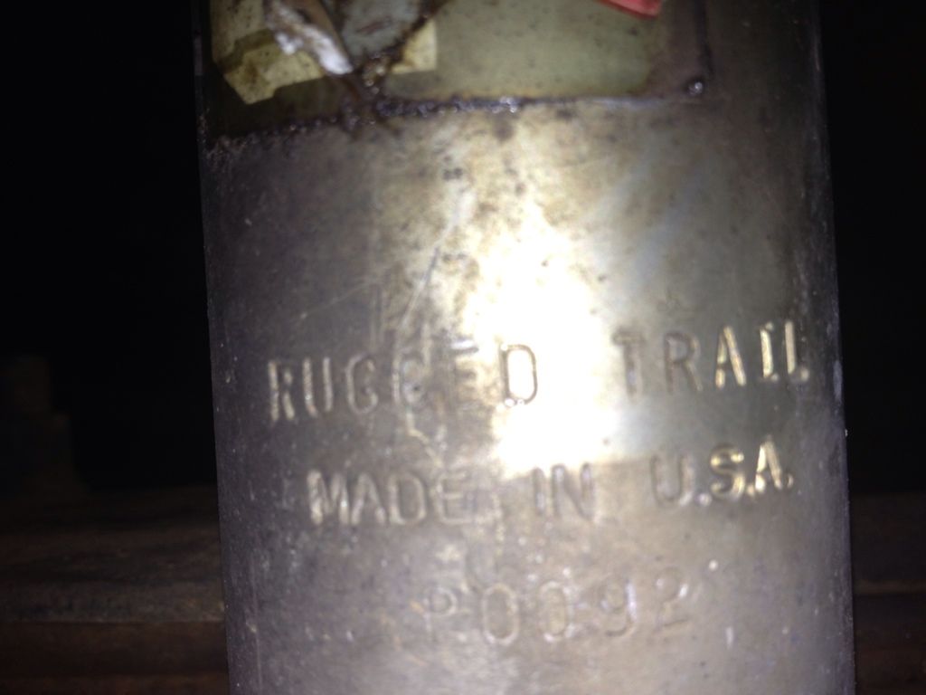

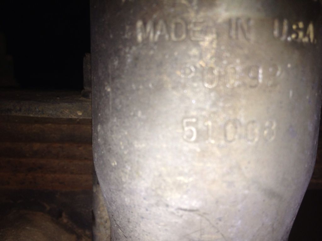

How in the world would I know which shocks to get? I'm really new to this? The Jeep has a SOA lift.
The current shock is a Rugged Trail P0092 51008 (last numbers may be 51088 or 51068... couldn't see it very well).

Thats a good question. Those are stock. You could measure the ones you a have a start with that. It may cost a few more $$$'s. If you get rid of th SOA and put on a lift it will make it easier, since you know size lift you have.

take the shocks off, then flex the jeep fully both directions. need to mearsure how much it travels both ways. With the SOA, stock shocks may not be long enough. At least that's what I've learned from this site I have to do the same with mine, I did a SOA on mine, but haven't got any shocks yet. I am sure someone more knowledgeable will help you out soon.

not a stupid question. by both directions I mean, fully compressed and fully extended travel of your suspension. Since it is SOA now, it probably needs a longer shock. How long? IDK
You just need to figure out your fully compressed measurement, and fully extended measurement on all four corners. So you don't get a shock that is too short or one that is too long. You understand? maybe someone will help me out here, lol. I know what I am trying to say, is probably sounding like a stupid answer.

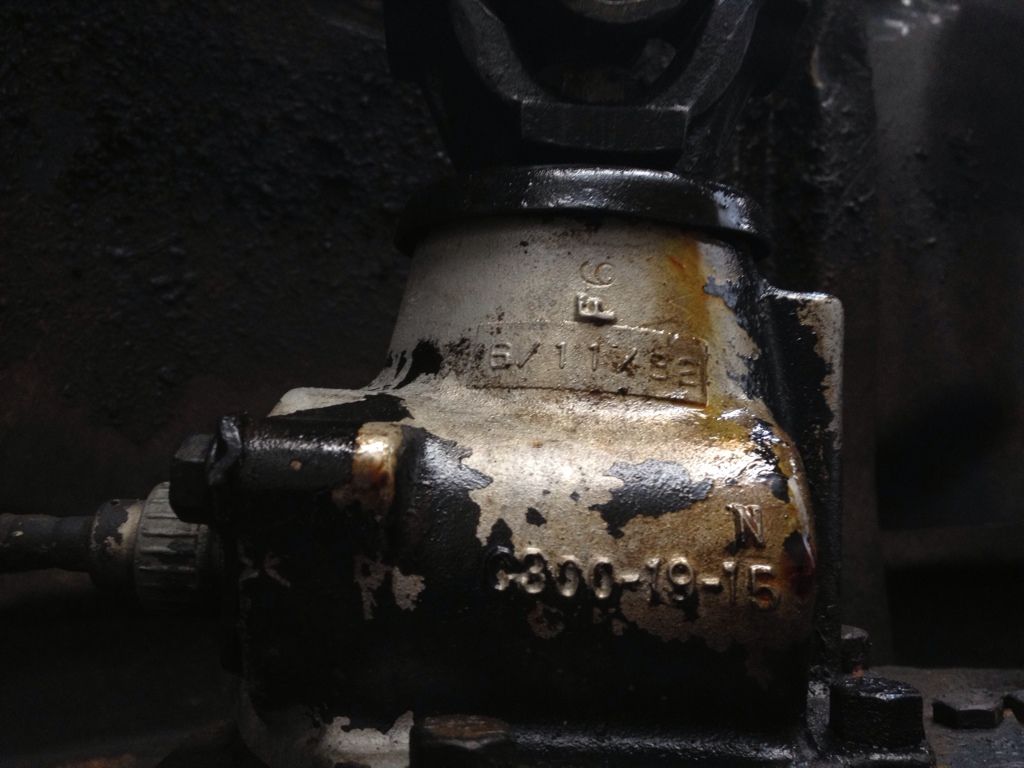

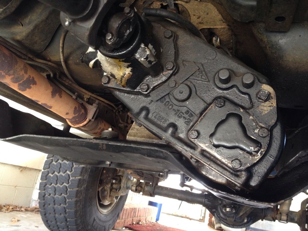

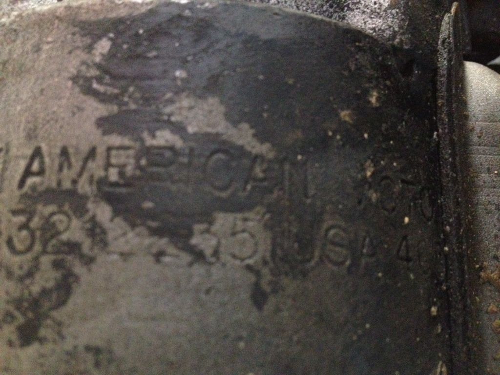

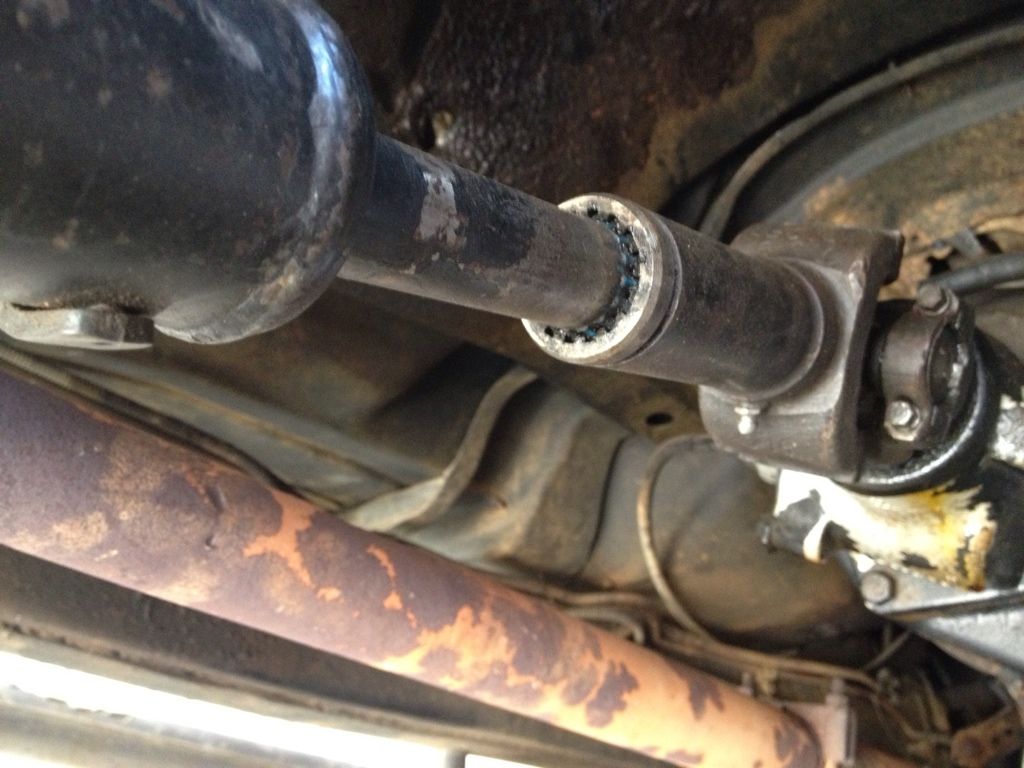

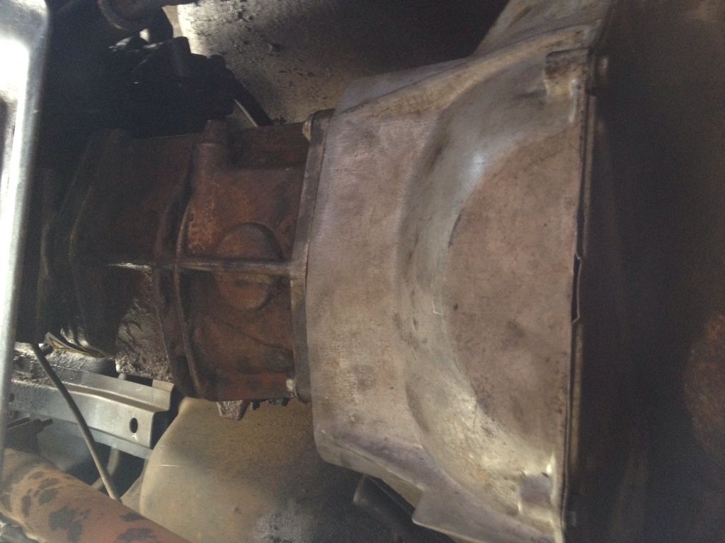

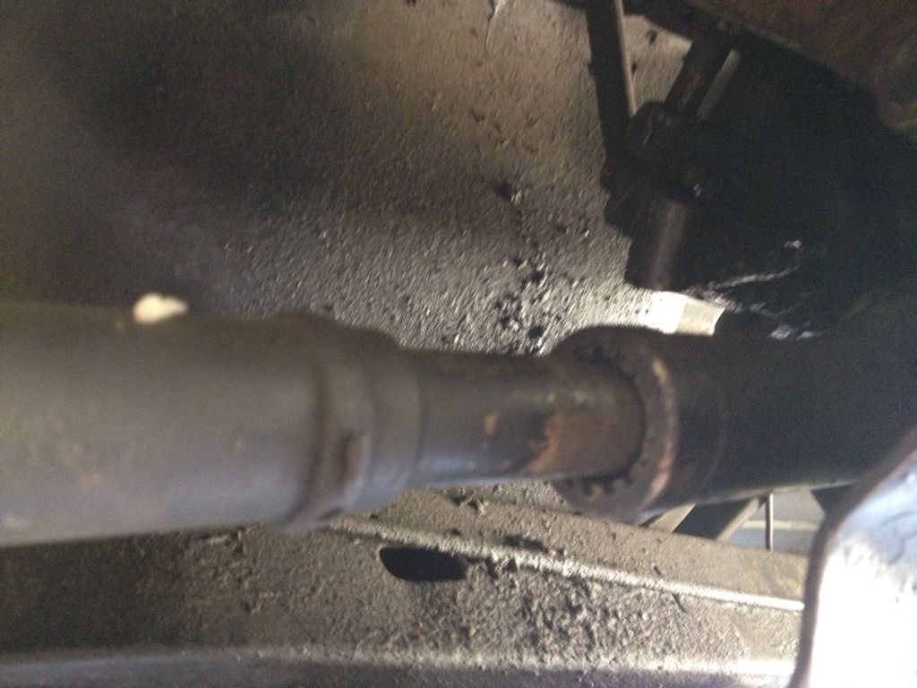

Trying to figure out what kind of transmission and driveshaft I have. I've taken some pictures (not the best). I'm not even sure what all I'm looking at under there.
I'll post the pictures and see if anyone can tell me what I'm looking at.

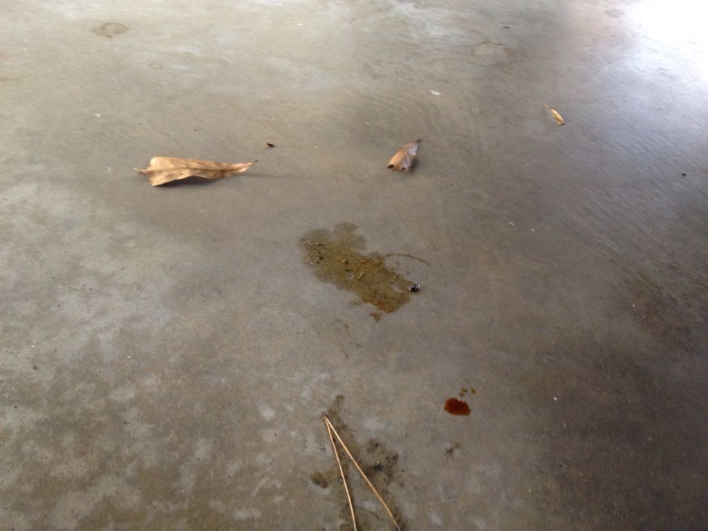

I've also got this leak
Coming from this...
I feel like such a moron most of the time on here, since I have no idea what I'm talking about. I'm learning though, and I've really enjoyed working on the few things I've learned about so far.

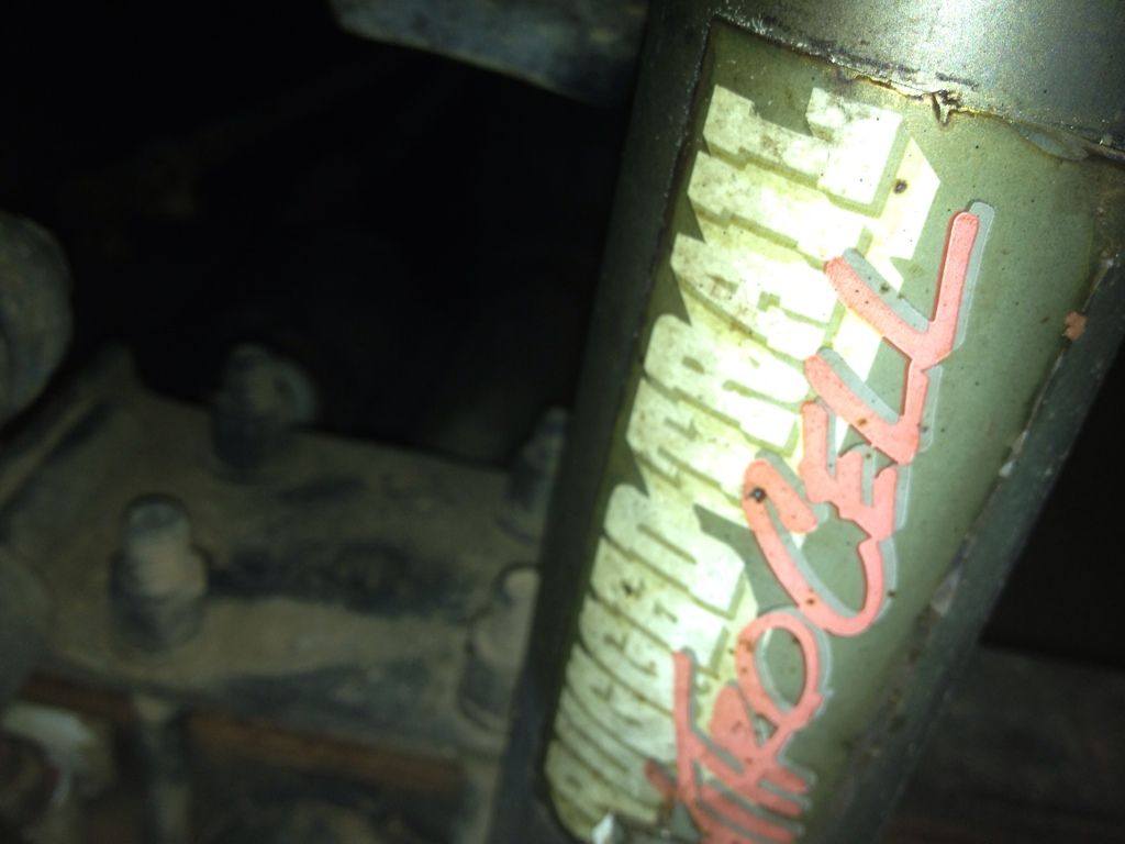

Upon further inspection of the shocks, I've realized that they may still be ok, but the bushing needs to be replaced on a couple of them. I'm going to start there and see what difference it makes.
