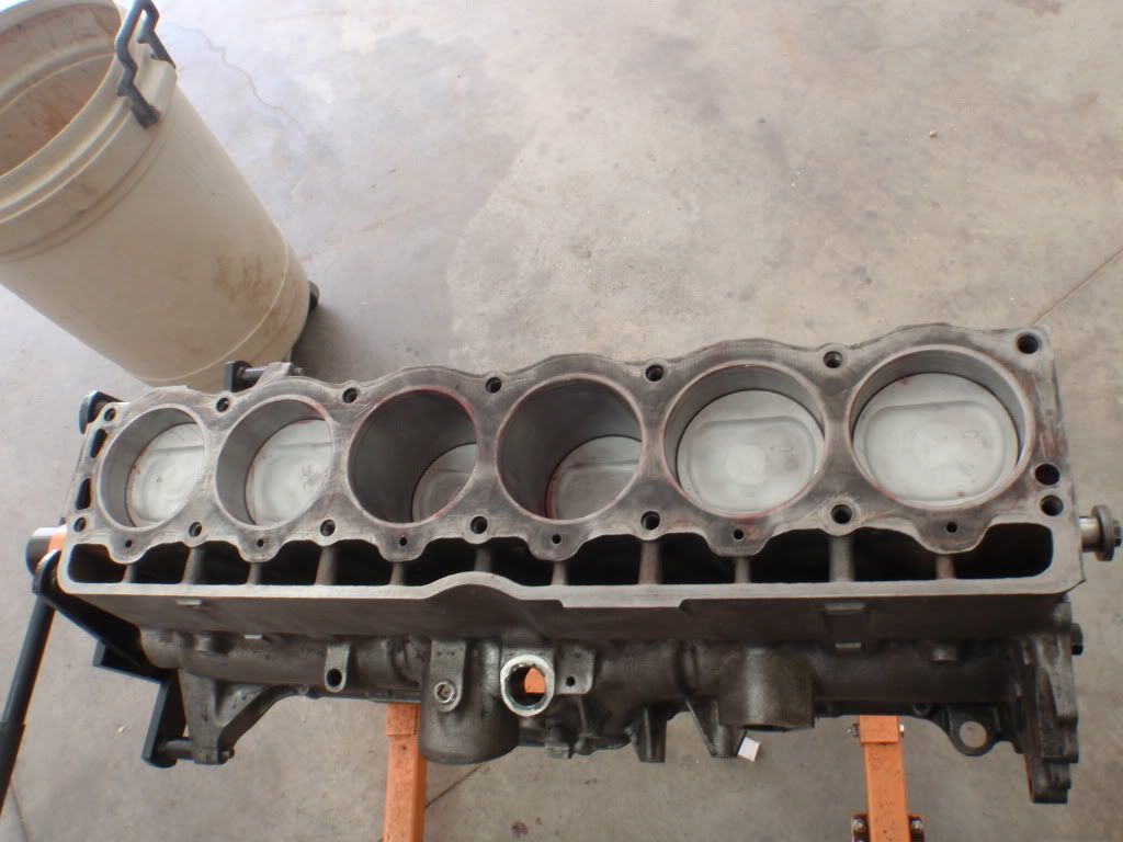

Well I managed to get quite a bit done with my one day off this weekend. With some help from my uncle and a cousin, we put my engine back together. It was pretty easy and straight forward with the exception of the piston rings. The rings we used were Mahle, so they are very good rings, but the directions that came with made it very confusing as to which rings were the #1 and #2. I'm confident that we figured it out correctly however and the rest of the assembly went pretty smoothly. I did notice however that I didnt get my thermostat housing back when I had it rebuilt, so I will have to go down and ask them about it tomorrow.
All thats left for me to do on the engine is the oil pump, cleaning up the oil pan, timing cover, and paint. If i can get a hold of my father tonight I'm going to try and sand blast the oil pan, bellhousing, and timing cover.
Well thats all I've got for the moment, here are some photos.

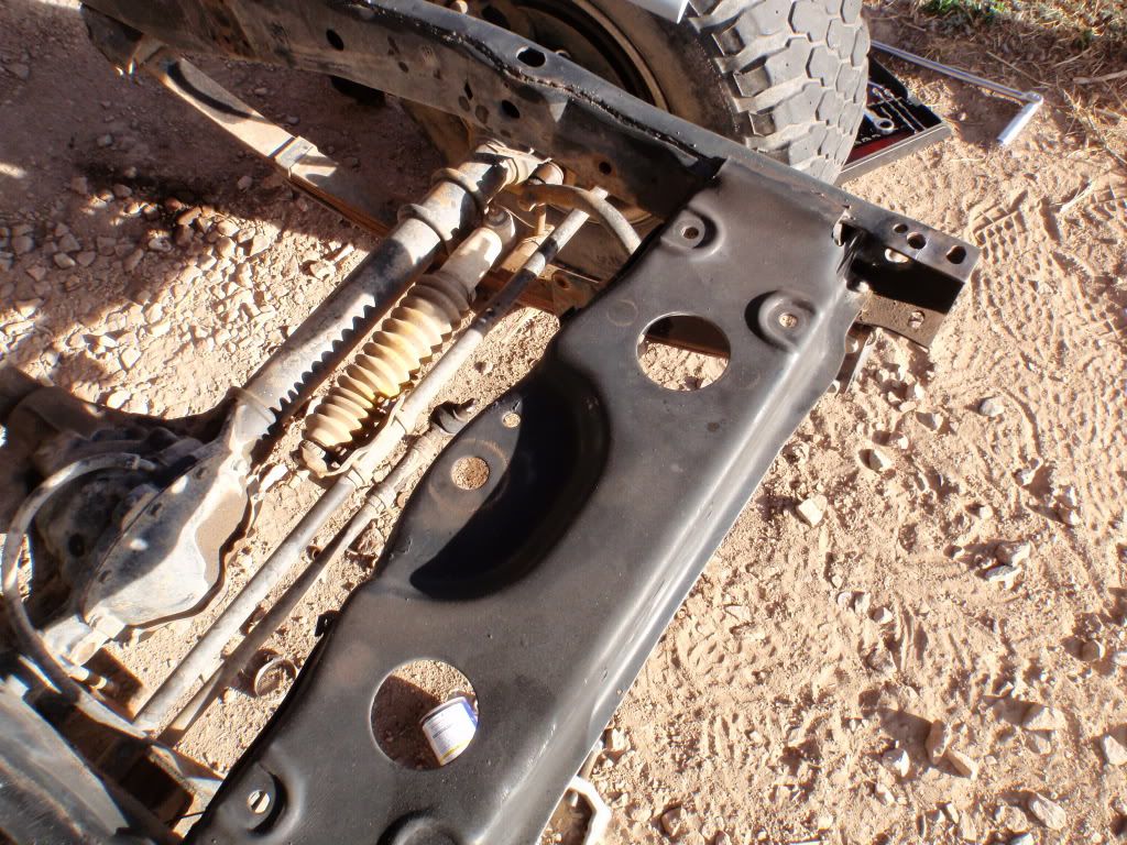

Well since I'll be leaving Friday for about a week I figured I'd better update this while I have the chance. I took my frame back down to the car wash today and really hit it hard, got most of the grime off of it. I'm pretty sure that I got the frame rails cleared out pretty well too. I paid for the car wash with a debit card, and spent about 20 minutes down there. When I went to leave the card reader was frozen. Well to shorten the story the whole time I was there only cost me 3 bucks some days are just awesome. I also took my bellhousing down to clean it up but I forgot to take it out of the car o well. So when I get back I will clean it up with a wheel and paint it. I'm not gonna worry too much about taking it down to metal. I'll get the grime and whatever else thats lose off. One advantage of Colorado, you dont have to worry to much about rust, cause the humidity is barely ever above 20%.

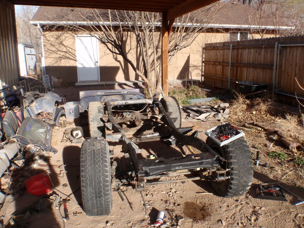

Sunday was a bit better. I stripped all the remaining bits off my frame, fuel and brake lines, mounts, steering box, and started to hit it with a wire wheel. So far I have the entire top rail done.
I wont worry about getting all of the little rust specks paint off. My plan is to paint it with a good anti rust coating. I know there are a lot of differing opinion on it, but I've heard good things locally. Plus since I live in Colorado I dont have to worry so much about rust, even whats on the frame as of now is very very minimal. The only places I will actually focus on doing a better job is the body mounts. The metal has actually gotten somewhat thin, so I might just reinforce them with a little steel.

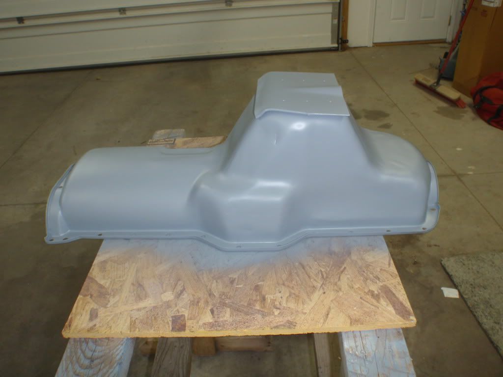

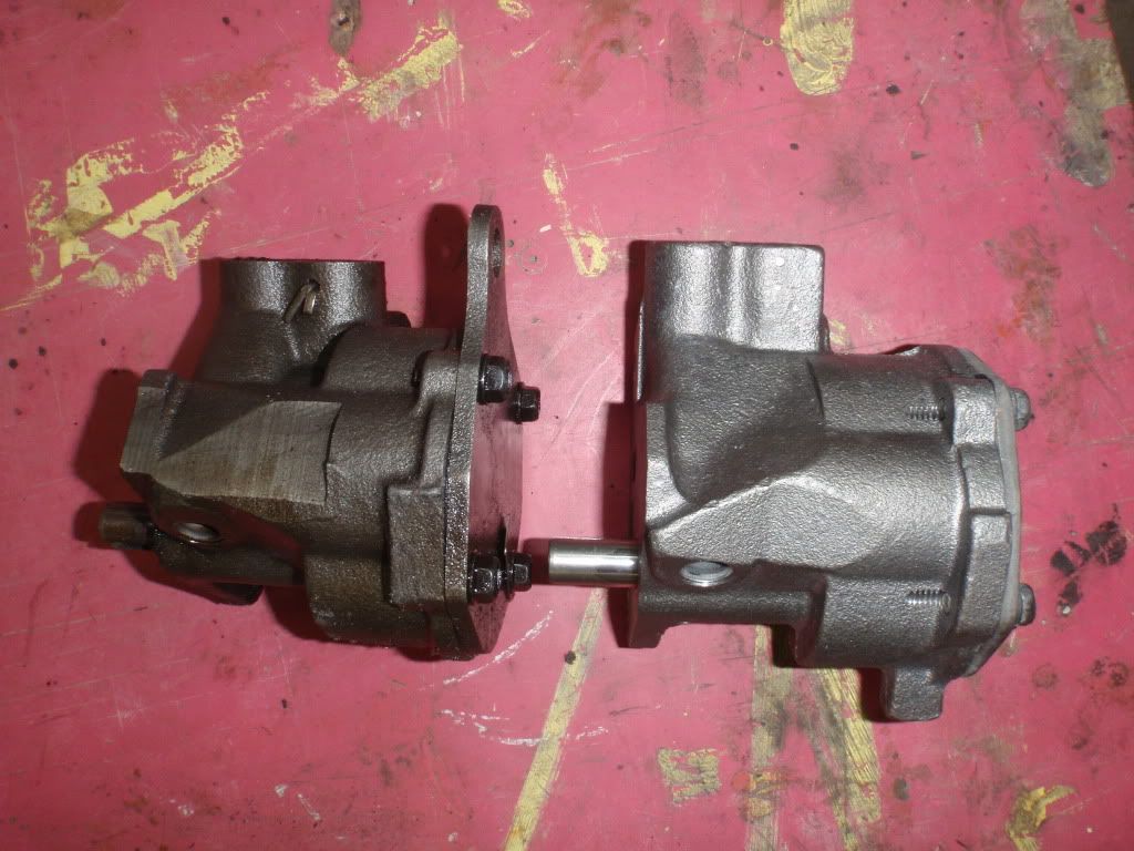

So my goal yesterday was to finish assembling the engine and slap some paint on it, but I ran into a snag with the new oil pump. I'll take some pics later today when I work on it. Before I figured out I had that problem though, I got the oil pan all cleaned up. So I went ahead and sprayed some primer on the pan so I wouldn't have to worry about it flash rusting.
Before I painted it I scrubbed it pretty good with a degreaser, and then wiped it down with some solvent.

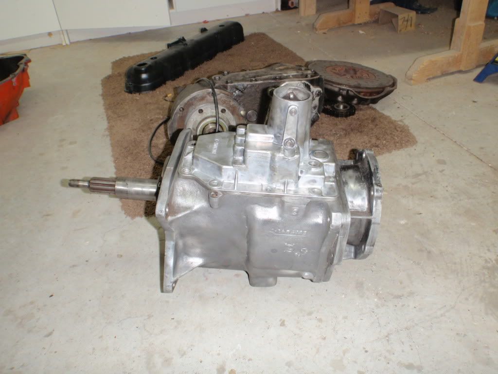

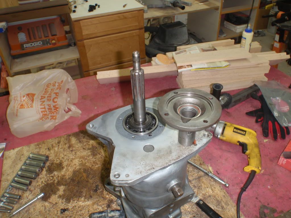

Not wanting to waste the rest of the day I jumped back to the transmission. I had one more seal to replace on the front bearing housing so I went ahead and did that....
then spent a good while cleaning up the top cover. So as soon as the weather gets a little nicer so I can give it a scrub with degreaser it will be ready for paint as well.

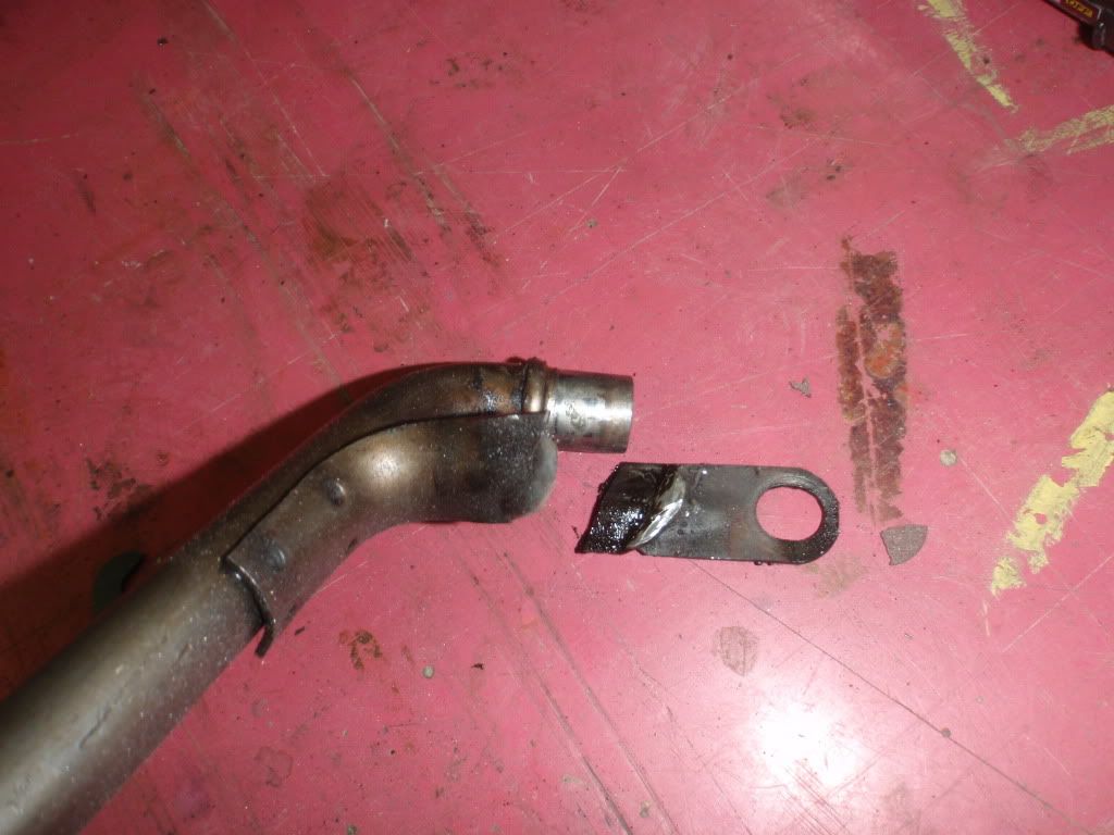

Got the snag with the new oil pump worked out. The new one has a slightly different design then the original, and it caused the oil pick up to not sit properly. Luckily the arm that bolts to the pump is actually two separate pieces that were welded together. So it was as simple as cutting the weld off, and re welding it to the proper length. Not difficult by any means but between setting up the tools and fixing it, it ate up almost all the time I could spare today.
