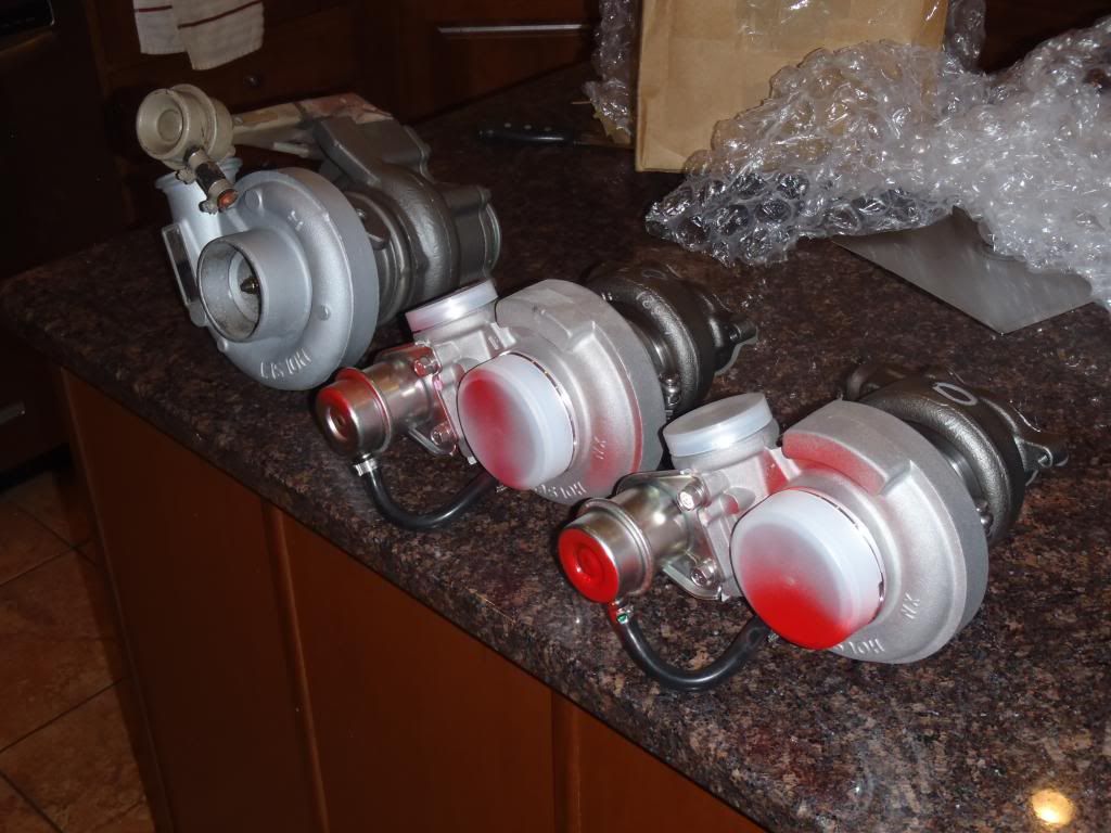

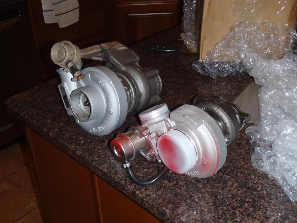

The turbo on the left is what I had originally planned on using. The turbo on the right is brand new, cost a fraction of what it's worth, and is better suited to my needs. Physically it's much smaller, which means it will build boost quicker, but still flows as much air as the one on the left.
Sometimes being a scumbag would make things so much easier. I received the turbo above yesterday. Then I got another package today, and guess what.
The person I bought the turbo from on ebay is lucky I'm honest, sent him a message and told him.
For anyone curious the turbo's above are and HX30W on the left, the two new ones are HE221W.

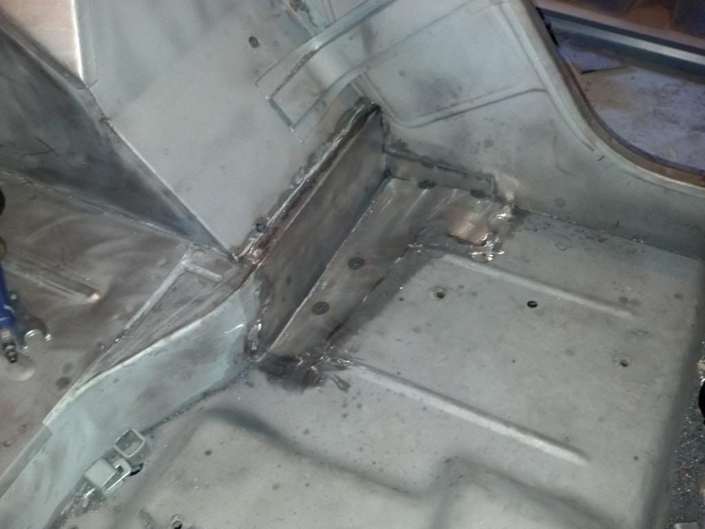

I got both areas under the roll bars finished

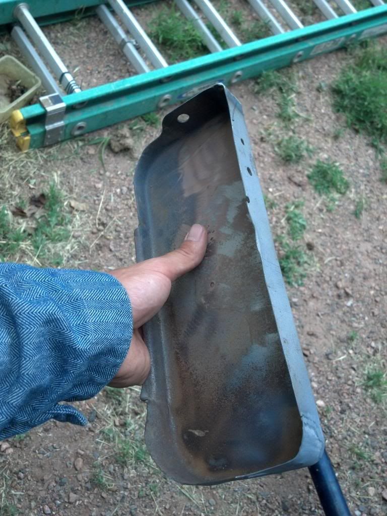

If you recall, I had to remove the wheel well baffle on the passenger side to make room for the new fuel filler, so I cut the baffle down and will remount it out of the way

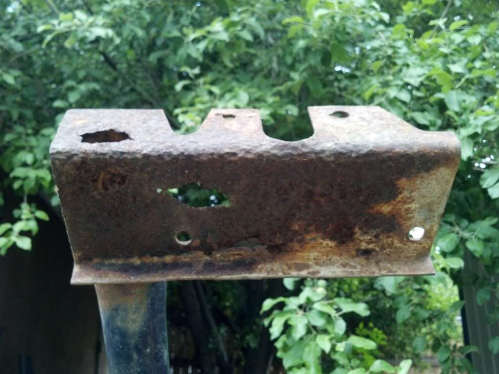

Now I've run into a little bit of a wall. The front feet on my roll bar were pretty rusted out, so I was going to cut them off and replace them. I started cutting and noticed that the roll bar wasn't in as good of shape as I had thought. I grabbed a hammer and sure enough, managed to knock a hole through the lower part of the bar. I few more whacks and it began to look worse.
Now I'm not sure where to go with this. I looked for a replacement roll bar before I decided on repairing this one, and haven't had any luck. Not sure how many years the CJ5 came with the floor mounted roll bar, but it seems to be pretty limited. Aftermarket roll bars are basically non-existent. I'm not looking at doing a custom or full cage. It's not that I dont want one, but rather I would rather focus on getting this on the road in my lifetime, and do something like that further down the road. Can I repair it and still have a safe (as far as the stock roll bar goes) roll bar?

Glad to see you back at it. Yes you can repair the roll bar. I'd cut the whole thing off above the rust and start over. Get some tubing that will slide over the old or make it the same size and sleeve it. I wouldn't trust just a butt weld seam, hence the sleeve. You can make the part that bolts to the floor too, I did. On second thought the entire Jeep is just too far gone...I'll store the 4bt for you.

The tube is 2.25" OD and 2" ID
