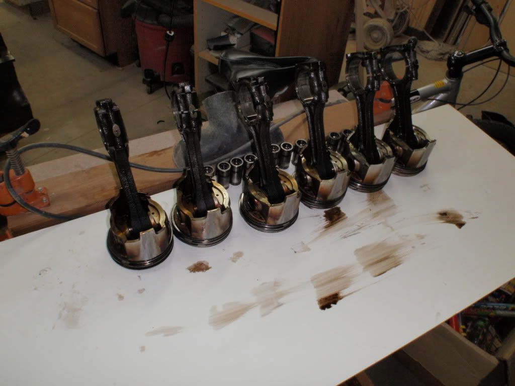

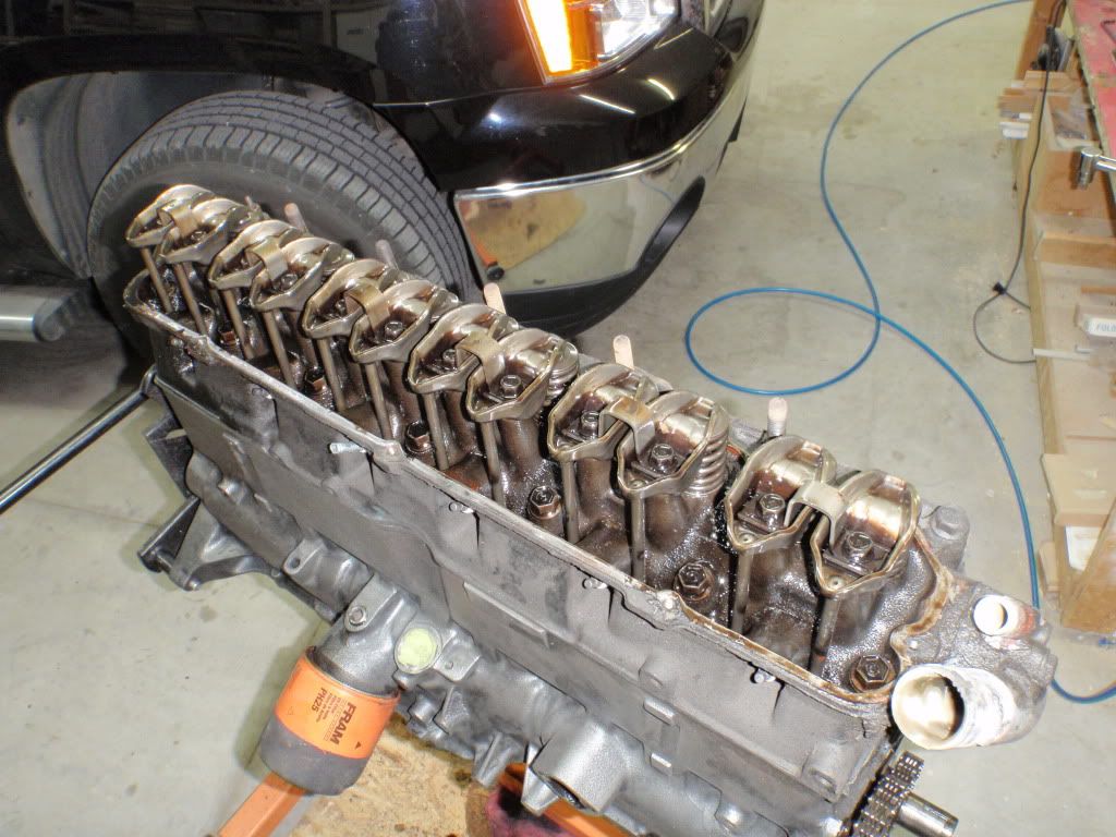

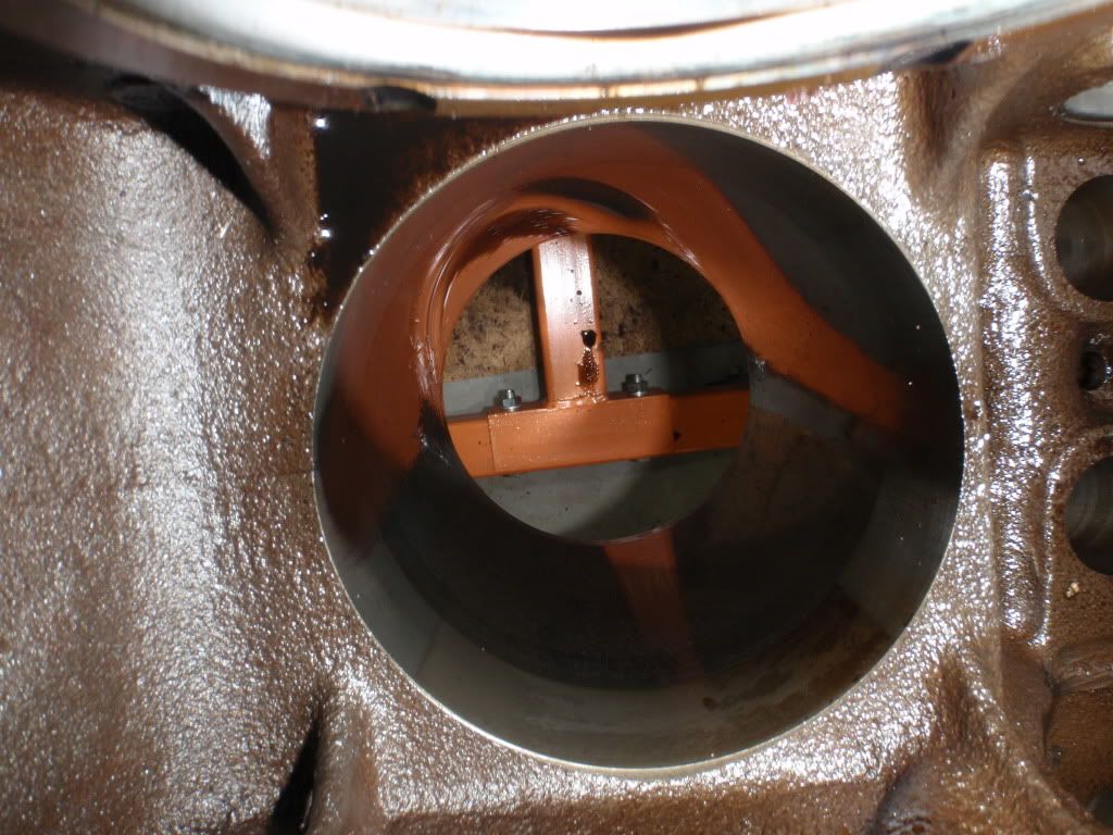

Tonight I flipped the engine over and started taking off the valve cover and head. Now keep in mind since I'm working in my uncles shop I'm trying to be quick and clean. Well my uncle comes out and encourages me to make a bigger mess and take longer. He talked me into having the cylinders honed and new rings and such. So we went ahead and tore right into it
This Jeep has been sort of an emotional roller coaster. I have days like the one with the U-joints that make me question what I got myself into, and then some days are like today. Look at those cylinder walls! they are immaculate. You can just barely tell where theres a wear line. I know the guys that rebuild engines locally, so I'm going to head down there tomorrow. I'm hoping they say it doesnt need to be honed, and can help set me up with new rings and bearings. I'll go ahead and have them clean everything up while they are at it, and rebuild the head.
I gotta say I'm pretty happy with how things turned out tonight. Sure its a few more bucks out of my pocket. But its entirely possible that for a couple hundred dollars I'll have a rebuilt engine. I have to wonder if it was rebuilt not that long ago. The PO owned it for 11 years, you would have to think if he had done it he would have used it as a selling point. The odometer reads 49 thousand miles. Of course I've assumed it has 149, so theres no way it looks this good without some work done.

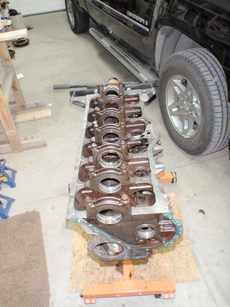

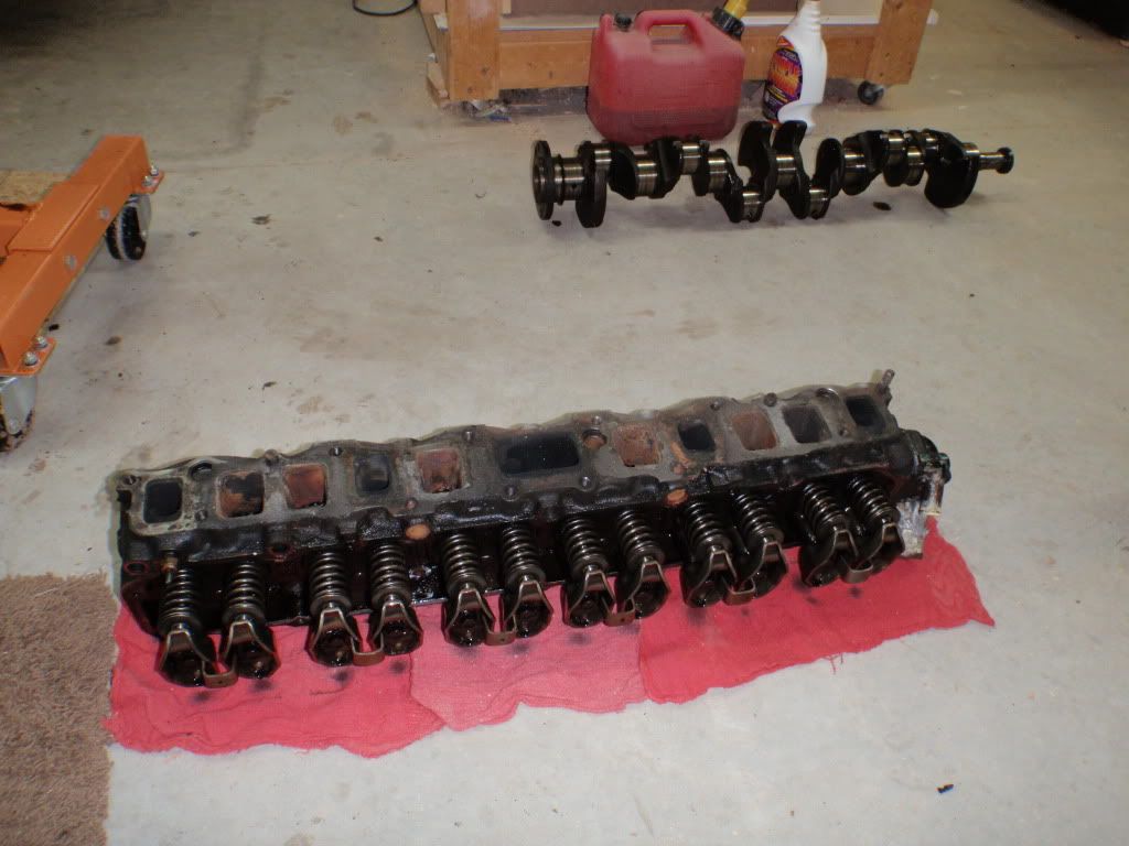

Hey there.. everything looks great, however, when the crank is out of the engine you should store it standing on it's end. If you put it on it's side like in that one pic it can get damaged.

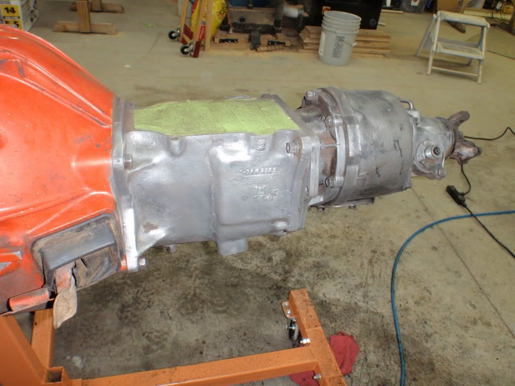

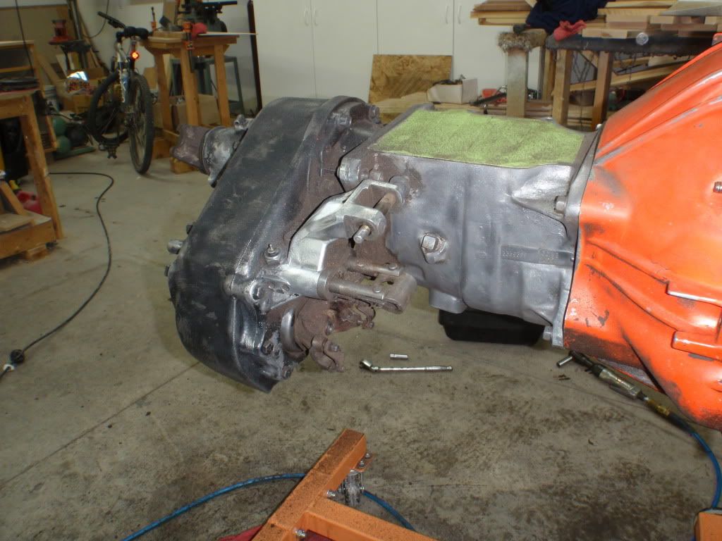

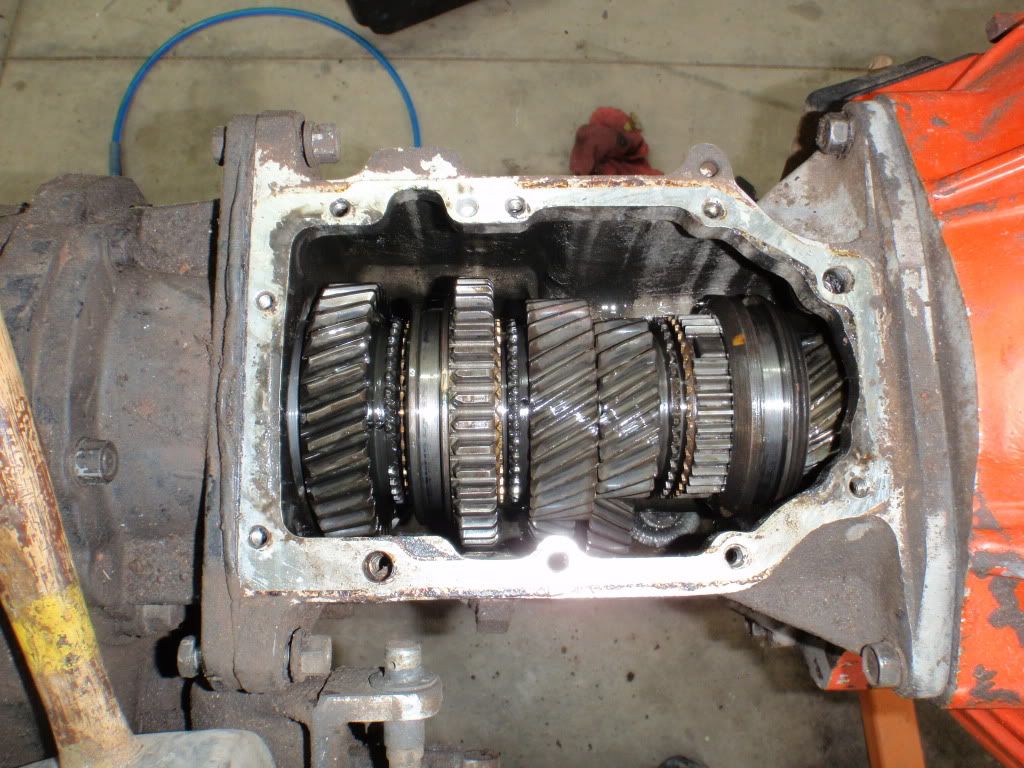

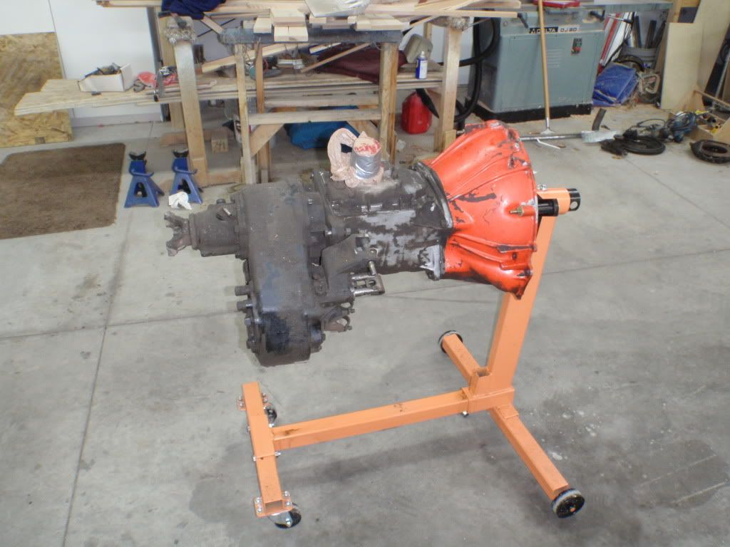

Thanks for the tip, learn something new everyday. Makes sense though. Well I managed to get my transmission bolted up to the stand and cracked it open, then started to clean it up.
I'm actually very surprised at what great shape everything is in. The gears all look great, and the syncros dont look worn at all! The only thing I'm unsure of is the input shaft. Where the input shaft meets the main shaft there is a bit of vertical slop between the two. Maybe thats how its supposed to be, or maybe the bearing needs to be replaced. I dont know enough about it to make the call myself. Has anyone here dealt with the same issue? I'll probably take it down to the local transmission shop and get their opinion, a little free advice never hurt. But I'm honestly starting to think this Jeep only has 48k miles on it. Between the engine and transmission there appears to be very little wear.
could you elaborate? Never heard of such a thing! Im new to the engine building scene.....

benullman; You dont want to store a crank on its end because its more likely to scratch some of the connecting surfaces, which could be catasrophic. Also if you do a quick search online there are a lot of people that will argue storing on its side can cause the crankshaft to deform. Thats how I understand it, although I'd love to hear otherwise if I'm wrong

Interesting. Its one of those those things I have seen both ways and never thought much of it. Makes sense though!
