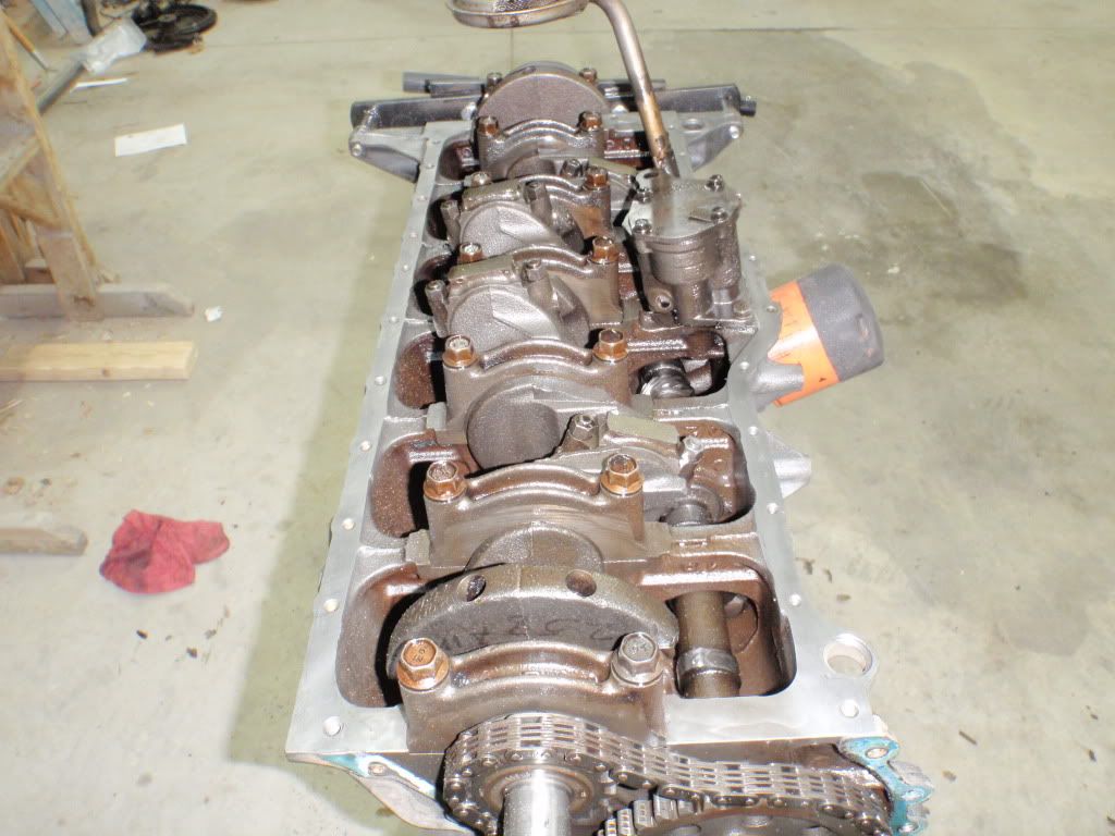

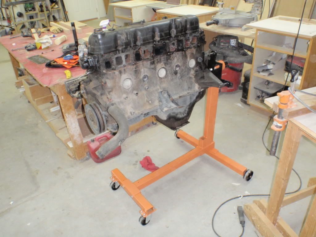

I took the engine to have it worked on. The guy took one look at the cam and instantly noticed something I didnt, a flat spot. Well now I'm getting a new cam, new lifters, rods etc. It will literally be a new engine when I get it back. Cost you ask? More then I was intending, $750. With everything I'm getting though its a heck of a deal

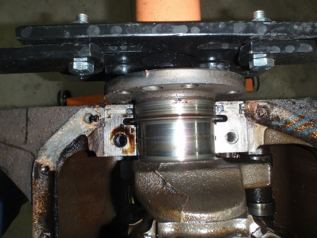

Hey there.. everything looks great, however, when the crank is out of the engine you should store it standing on it's end. If you put it on it's side like in that one pic it can get damaged.

benullman; You dont want to store a crank on its end because its more likely to scratch some of the connecting surfaces, which could be catasrophic. Also if you do a quick search online there are a lot of people that will argue storing on its side can cause the crankshaft to deform. Thats how I understand it, although I'd love to hear otherwise if I'm wrong
