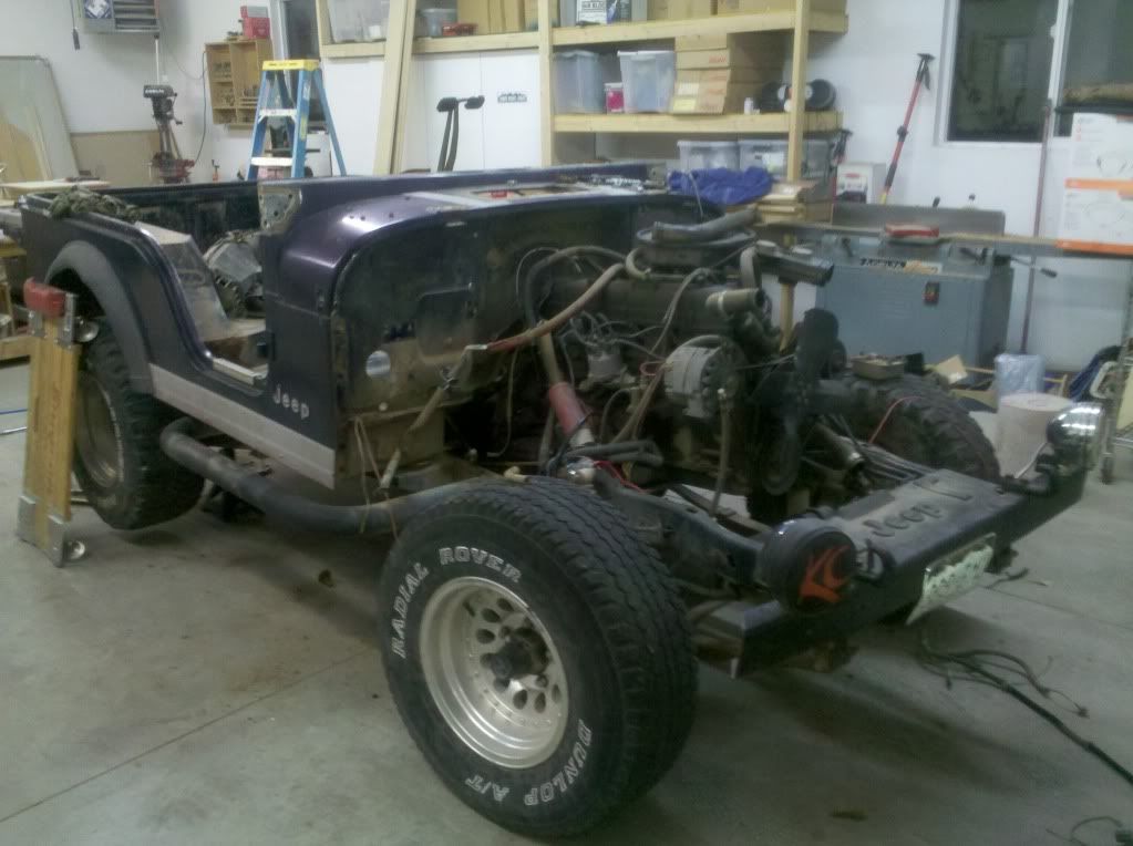

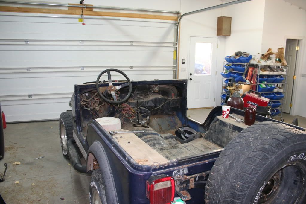

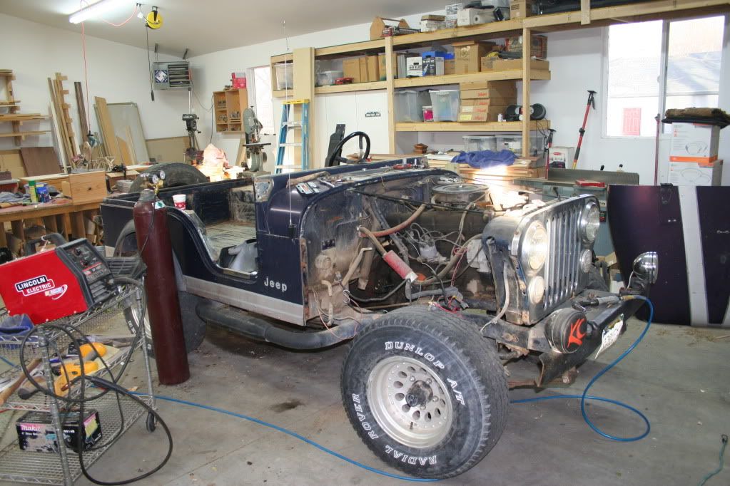

So I got the time to do some work to my Jeep saturday. At this point I have everything on the interior stripped, as well as the grille assembly. After reading some horror stories about rusty body mount bolts, I was worried about how that would go, but to my surprise they came out very easily.
So as it stands this is how it looks at the moment
I probably could have got the body off the frame very easily. I believe the only thing thats left attached are wires from the gas tank. I'm trying to get my hands on a body work table (basically angle iron with castor wheels) so that I can move it around easier before I take it off. I'm doing this work in my Uncles shop, so its important that I have the ability to move it out.

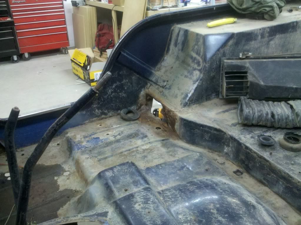

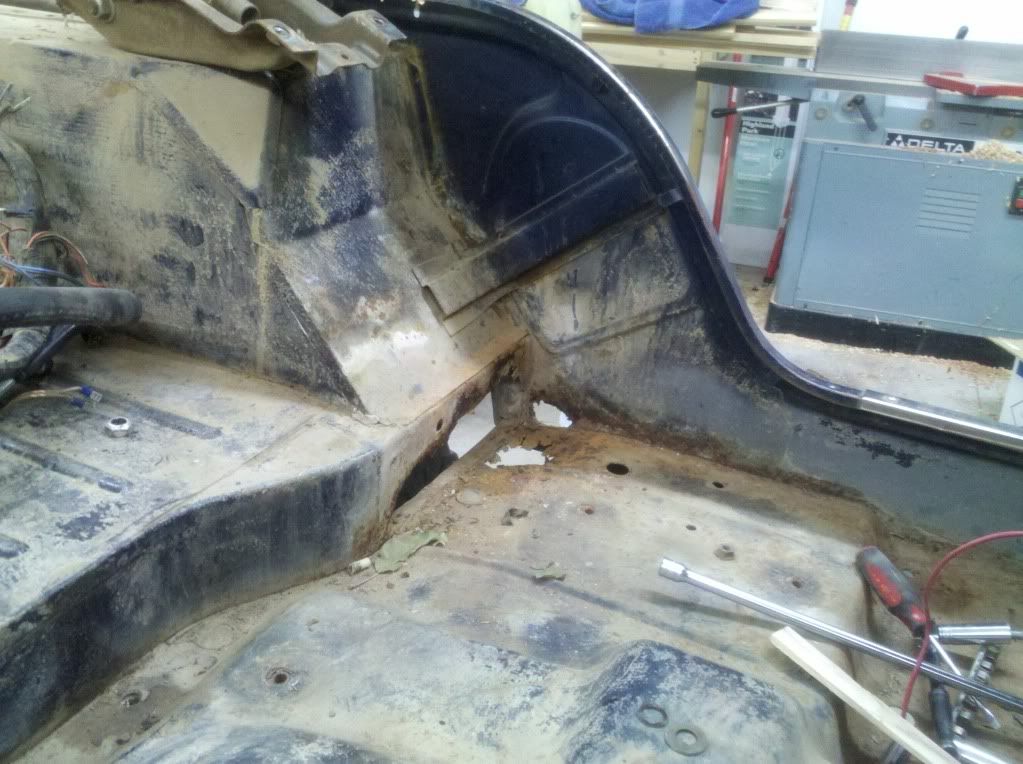

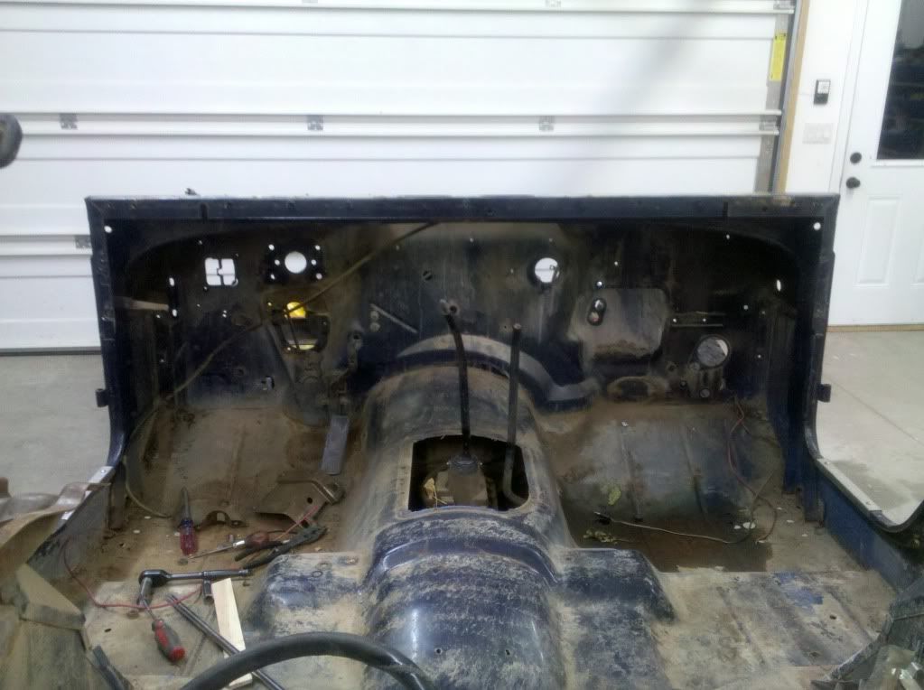

So the body seems to be in pretty good shape. The biggest rust holes are behind the seats where dirt collected between the roll bar and body
These holes should be pretty easy to fix. The only other spots that I'm aware of so far that has pretty good cancer is below the door sills, but I wont know the extent of that until i get some paint stripped.

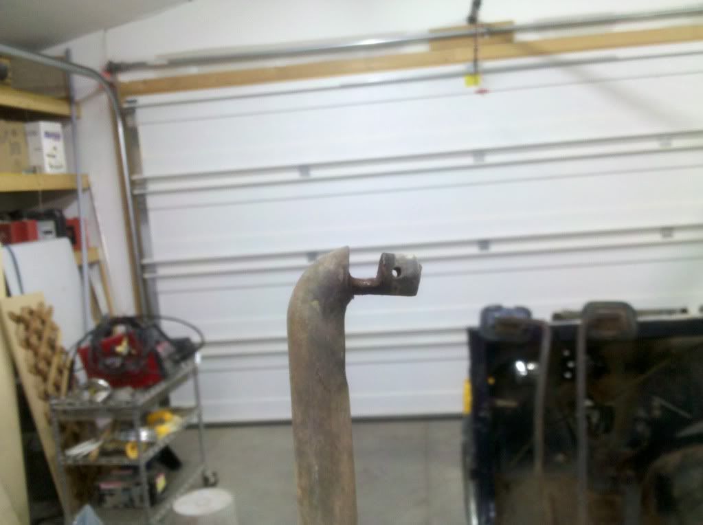

While I was removing all of the linkage on the tub I got to the clutch. I knew that the clutch linkage was fairly sloppy but I had assumed that it was just in need of a good adjustment. But when I removed the linkage I found this;
It's pretty much the same story on the clutch pedal, and assembly that attaches to this linkage. I had done some reading about upgrading to a hydraulic system, but decided that for the time being I mechanical linkage would be fine. This would be fairly easy to fix, but I think this has pushed me into going ahead with the hydraulic setup.

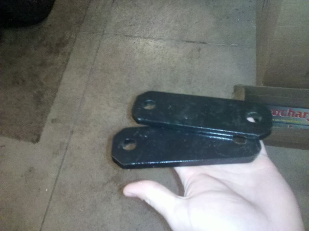

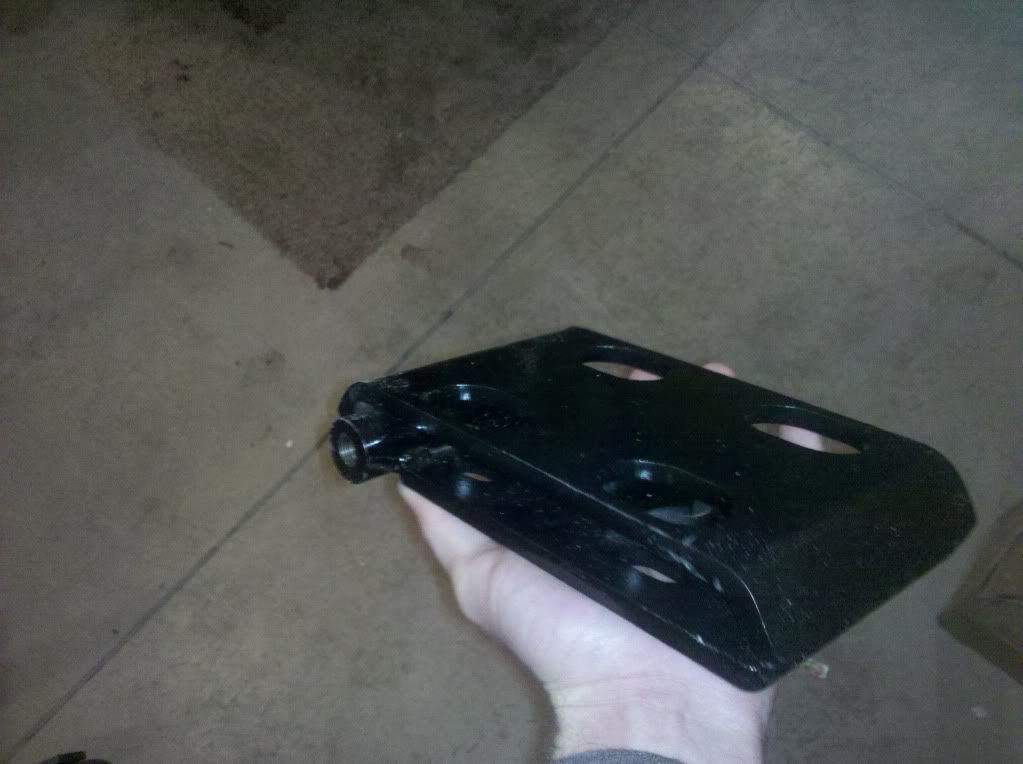

Wow it has been a long time since I have got the chance to post an update, well if you can really call it an update. So first off I must have been a very good boy for the last year since I received a suspension system for Christmas. Its the Old Man Emu suspension. I decided on OME for a few reasons, first of all I havent been able to find a single negative comment about it. And the other reason is that the leaf springs are all wider then the stock CJ set up, actually they are the same springs from the Wrangler. So it should provide a very nice ride. Judging by the appearance it seems like a very nice kit, and provides everything needed.
Notice that all of the steel is very heavy, I think it will hold up well.
