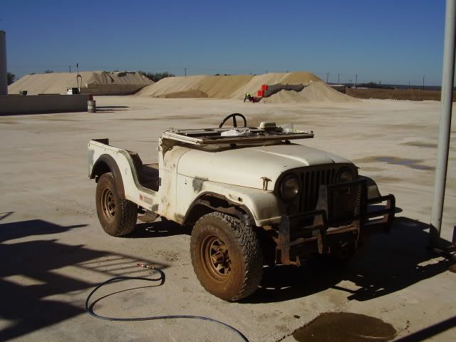

we have been really busy today doing our jobs...
hahaha. ok nevermind. we pulled the jeep over to the shop and started tearing it down. we got some good work done in a short amount of time.
we got the rear hunting seat out, the front seats out, the rollbar out, the windshield off, and the dash is ready to come off after we pull the steering wheel....kinda needed that to move it around easier though.
here are some pics...

got some more pics. we made some more headway this afternoon. one more body bolt to go and the body comes off....hopefully tomorrow.
it really helped getting an extra couple of hands in there tearing it down.

ok...it was 3 more body bolts, but the body is off!!!! muuahhahaha.
and the drivetrain is out from between the framerails.
may not be the most common method of removing a body....but it worked very well.
