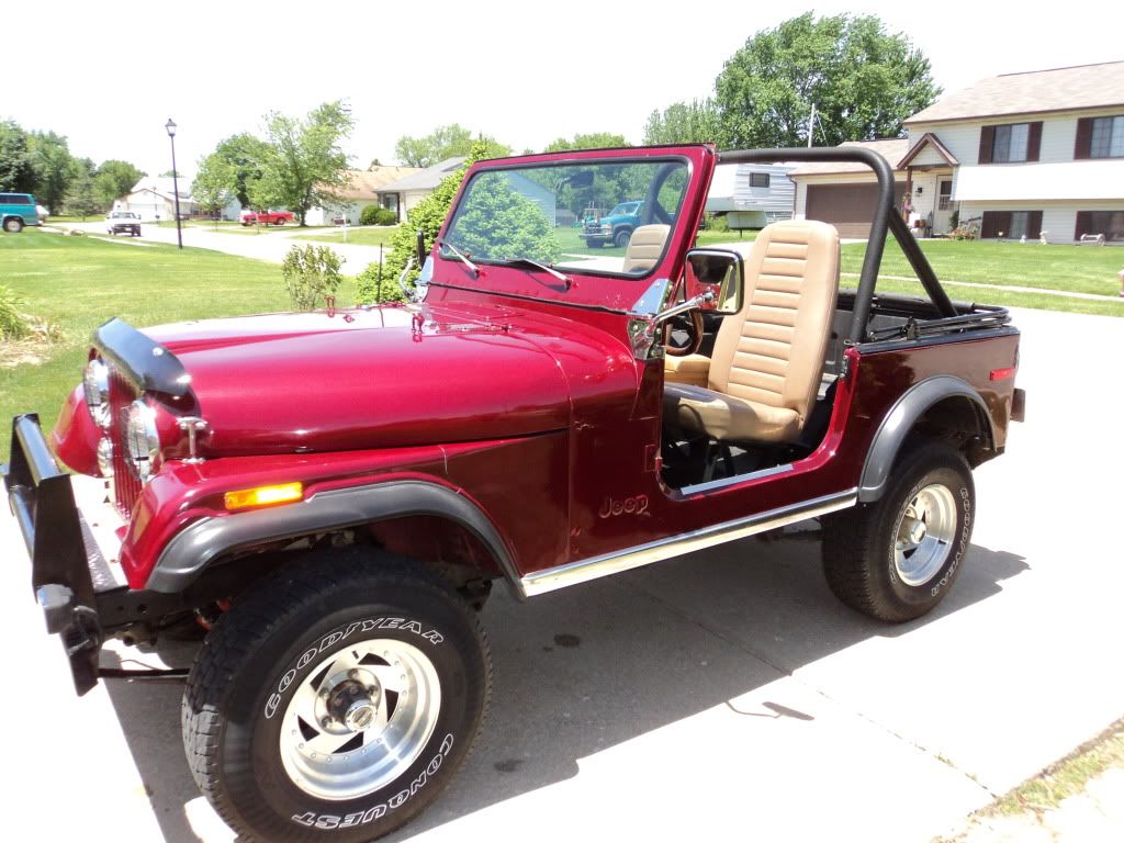

So i just recently traded my 1999 Mustang GT for the new love of my life, a 1978 CJ7. She's got the 4.2L 258 I6 and a rebuilt carb. Not my first jeep, as i owned a 97 TJ a few years back, but it got totaled while sitting in front of a house while parked on the highway. Anyways, I was wanting another Jeep BAD, the stang was a quick buy cause i had to have another vehicle and honestly, speed isn't really my thrill so i grew to dislike the car. So after 2 years of ownership of the mustang, I decided it was time to get another Jeep. I spent a few weeks looking, and a used dealership owner who was helping me find one, called me up one day and said, "Mike, just got a jeep in on a trade and i think its exactly what your looking for." So i hopped in the car and sped away to meet him, and as i pull into the dealership, sitting out in front to me was like seeing an angel with its illuminating glow, and choir "ahhh" sound, was love at first sight.

the rear end looks like its a glass tub
1978 CJ7 Diesel
smoothop is offline
post #7 of 29 Old 06-07-2011, 12:19 AM
cjfarmer
1982 CJ7
Location: Princeton
Posts: 268
I was just about to say, I dont think thats the original. There's no tailgate.

correct, PO welded it shut. not a bad job at all either, its seamless on the outside but the inside still has the latch flanges and the creases going down either side.
And i know after reading the story it sounds like heap of crap for a jeep, but once you actually see it, its a rather nice CJ. Thanks. more pictures coming soon
