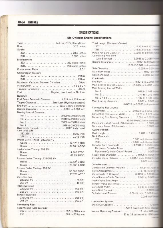

from 78 service manual

They are slightly different.
.................................84-86..... 78 2 bbl..... 78 1bbl
Cam lobe lift..................0.0253..... 0.0248..... 0.0232
Intake Valve
Opean ...................9 BTDC..... 14.58 BTDC..... 12.12 BTDC
Close ...................73 ABDC..... 68.79 ABDC..... 64.80 ABDC
Exhaust Valve
Opean.................57 BBDC..... 55.59 BBDC..... 53.12 BBDC
Close..................25 ATDC..... 27.78 ATDC..... 23.80 ATDC
Overlap......................34....... 42.36....... 35.92
Intake Duration.............262....... 263.37....... 256.92
Exhaust Duration...........262....... 262.37....... 256.92
I guess the next question would be if they ran different mechanical advance limiters in the 2bbl vs 1 bbl distributor.

Looks like the 84 cam is a little more retarded (14* vs 9*)than the 78 but that makes sense since it's more designed for emmisions. THat would make the most impact i would think. Redrill the pin holes on the gear? .
What is the rocker arm ratio on the 78?

They were probably trying to take out some of the overlap.
same as the V-8
1.6:1
