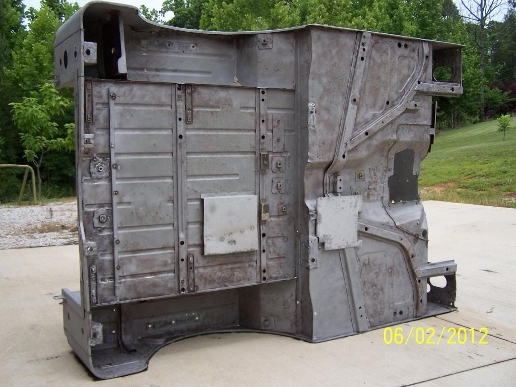

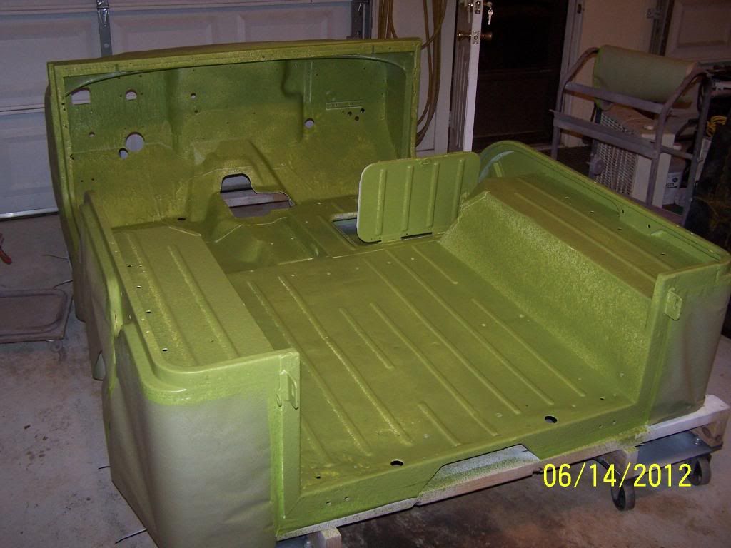

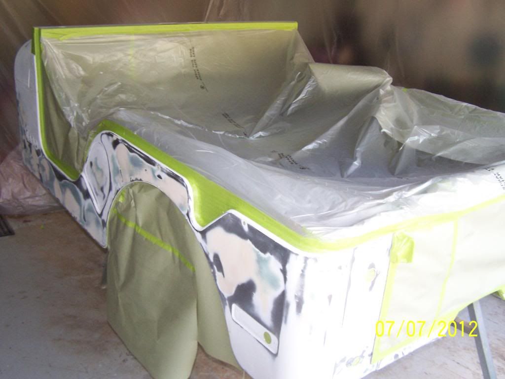

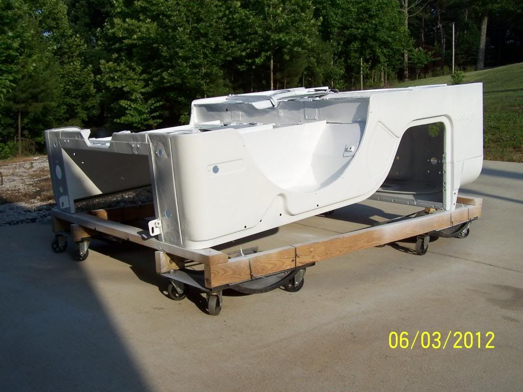

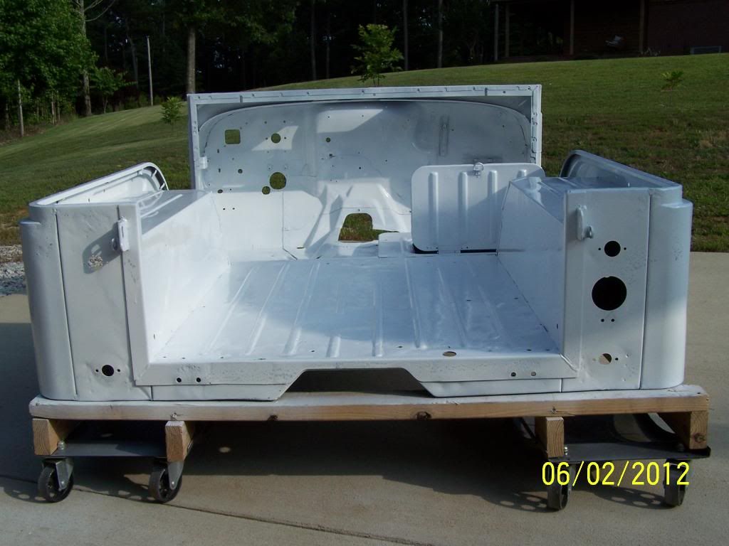

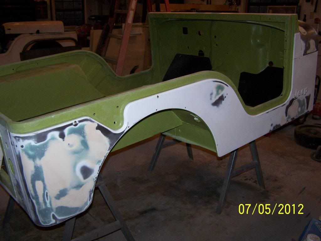

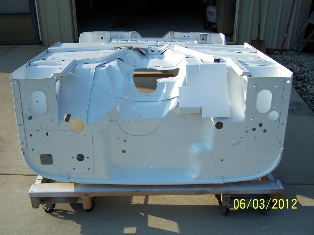

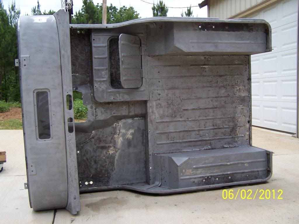

What's up guys? Hope everyone had a good weekend. I dug out some more pics to post. After cutting out all the rust and patching all the holes, I started stripping the body. It was at this point I realized that I was in for far more work than I could ever imagine. I mean, I knew it was going to be work, but just didn't think it was going to be this tough. I thought I never would get all the paint and surface rust off this sucker! I had a few people tell me that I would never finish it. That actually made me want to work harder to prove them wrong, plus I knew I had too, because I wanted to finish what my dad and I never got to start.
I have had this thing every which way you could turn it. This sucker had me beat down, but finally I got to shoot some SPI epoxy primer on it and it gave me a shot in the arm that I needed.

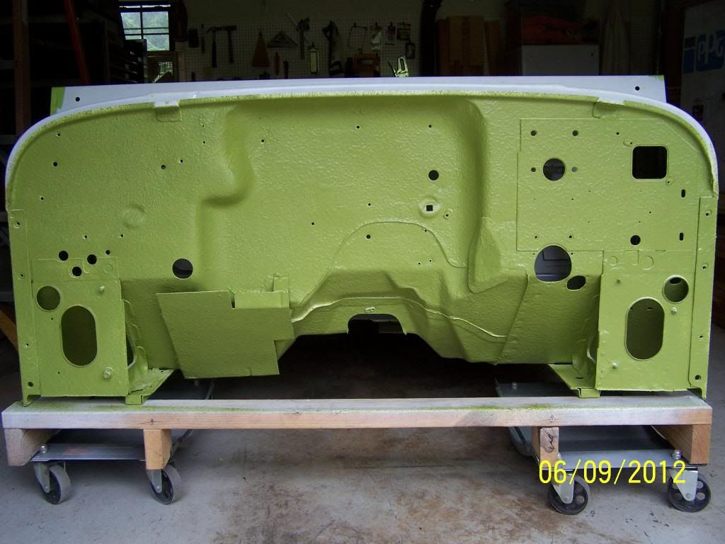

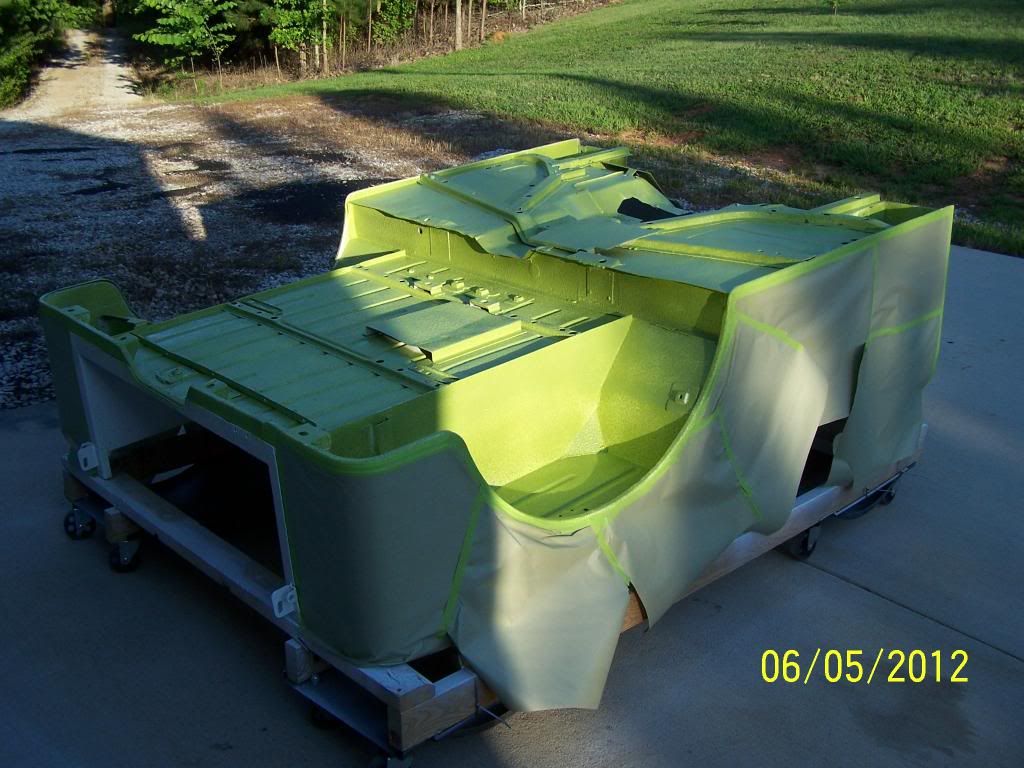

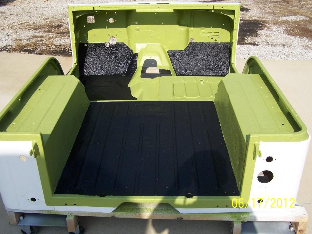

I wish I had been on the forum a long time ago for advice and to have you guys along for the ride! I sure needed all the help I could get. Anyway, after the primer went on I realized that the inside of the tub was pretty ruff and beat up. I had wanted to just shoot it with paint, but was afraid with the gloss on it it would look like crap with all the little dents and dings. I decided to go with a bed liner spray tinted the factory color. It went pretty good but did take more than it was supposed too. I also used it on the underside of the tub.
After I got it sprayed on, I had the idea of taping off some "fake" floor mats. I thought it would break the green up and give me some extra protection and I wouldn't have to use actual floor mats. I was tickled at how it turned out in the end.

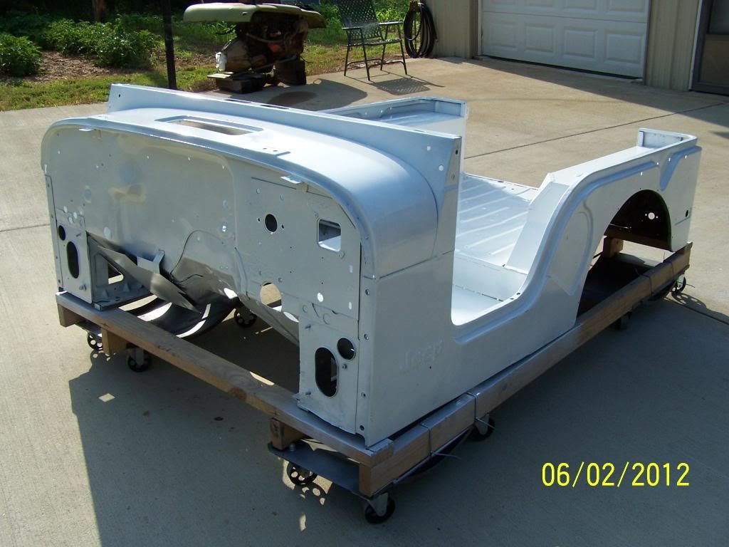

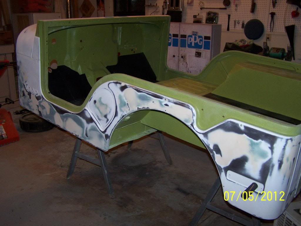

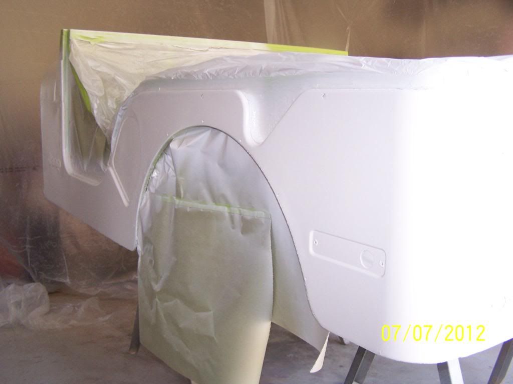

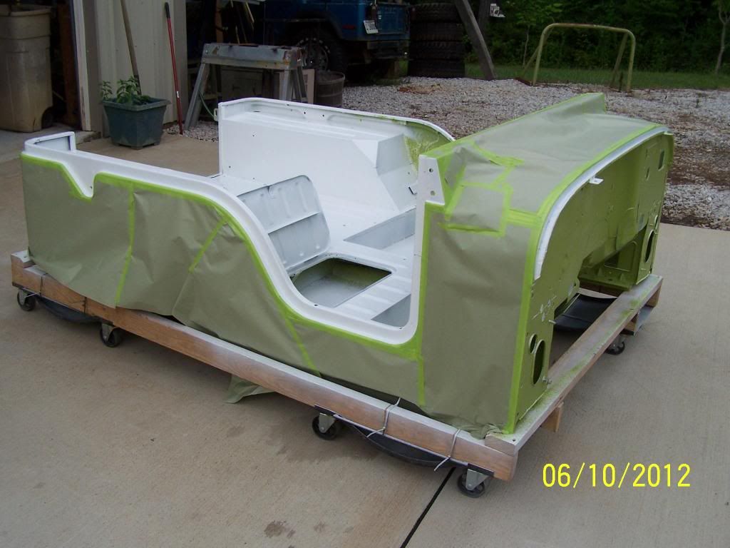

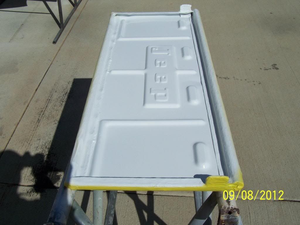

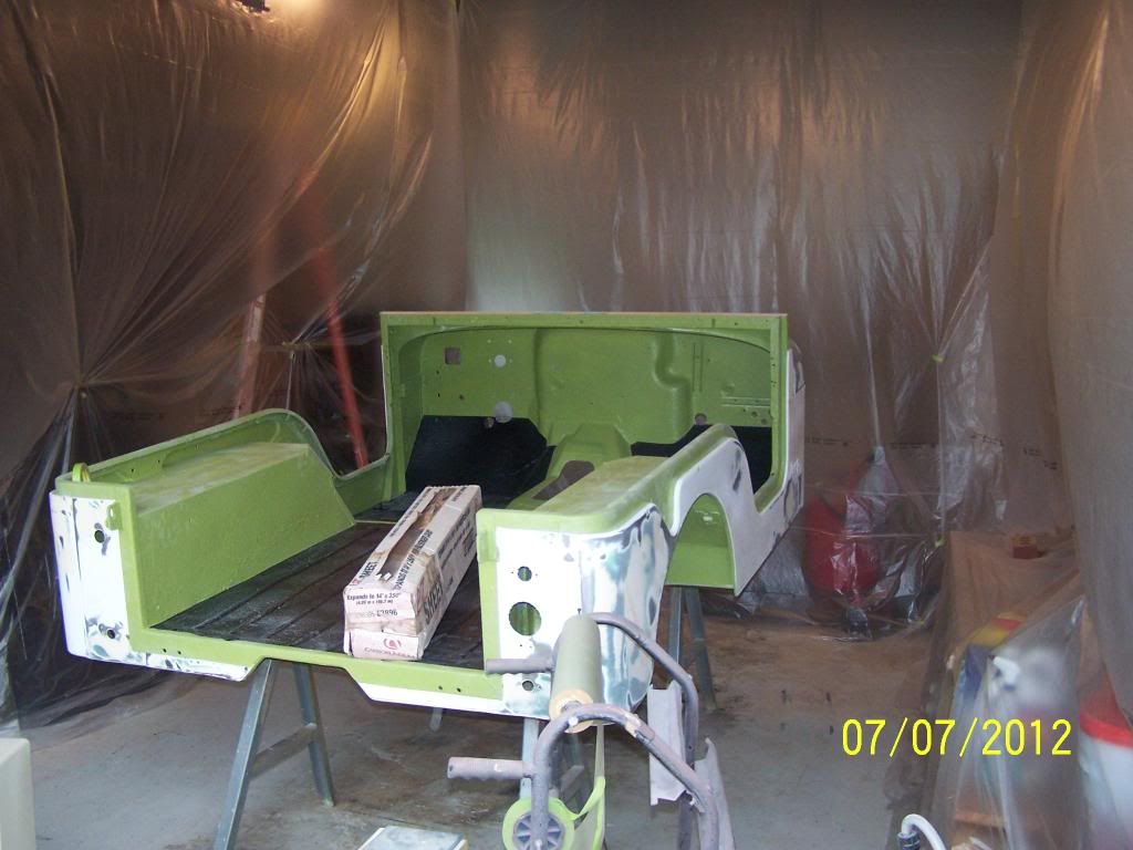

Thanks guys! Had some more time to post some more pics this afternoon. I have got to get you guys caught up to where I am at so y'all can help me 'cause I am going to need it! After the shot in arm with the primer it was back to the slow grind of sanding and body work. I decided to go with a short hair fiberglass body filler like dyna-glass. I know one thing. Knocking the dents out is an art that I sure don't claim to have a grasp on, but since it's a Jeep and you can see the factory spot welds already I knew it didn't have to be perfect. When I got the dents knocked out, it was time for the body filler. When I popped the lid on the body filler, it brought back so many memories of my dad and his shop. It smelled just like I remember when I was a kid. It had been a long time (20-25 years) since I had spread any, but I could almost close my eyes and watch my dad spread it on. It was pretty awesome. Just wish he could have been there to show me how once again. Anyway, here are the pics of the body work.
After the body work was done I hung a makeshift paint room in my shop. I was sure that my dad was laughing or shaking his head in heaven at it and my taping off job! I used the tape machine that I watched him roll a mile of paper off of. It was pretty neat.
Time to finally prime again.

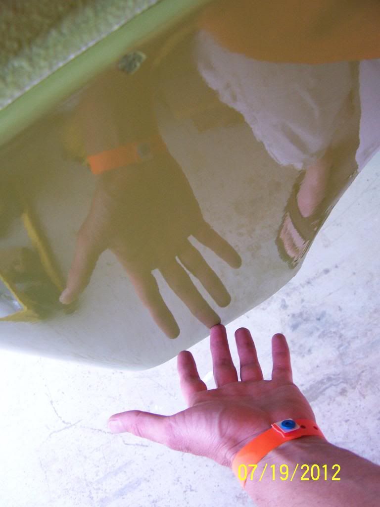

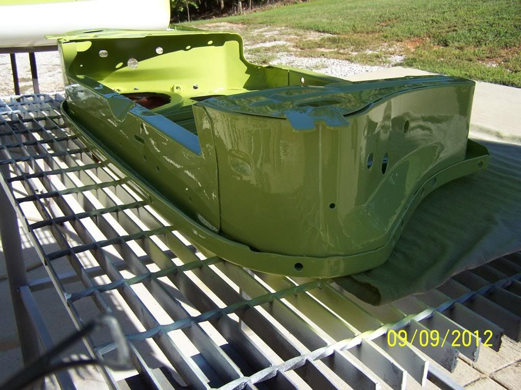

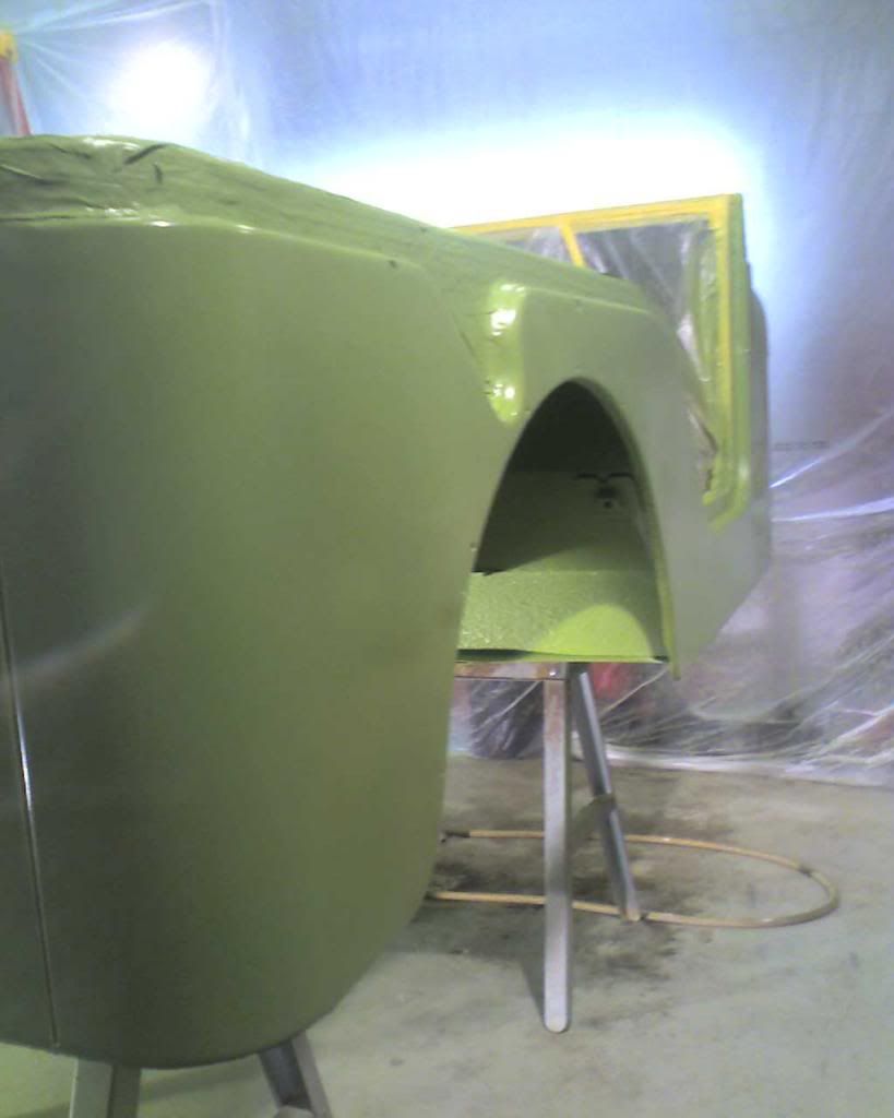

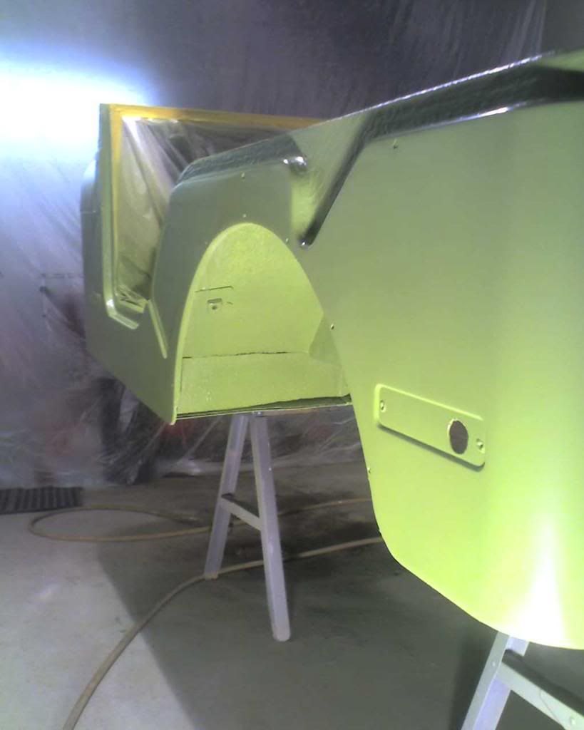

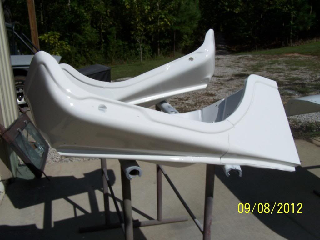

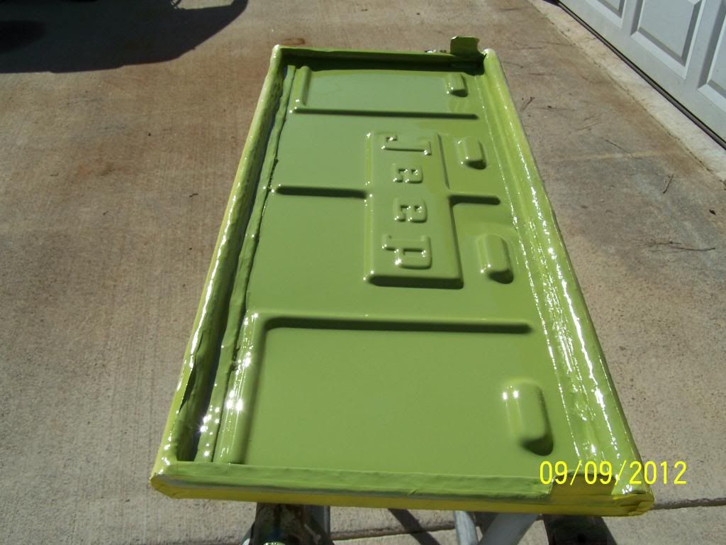

Thanks guys! I have a little time to post some more photos this morning. After the primer went on, it was time to sand some more. Something I forgot to mention was that my grandad was a body shop man too. I still had his old wood hand block sander and I blocked the tub out with it. I hung new plastic in my make shift paint room and re-taped everything off. It was finally time to paint the real deal. A lot had changed since I messed around the shop with my dad. Acrylic enamel was king back then. I had to do some research on this base coat clear coat stuff. I had never sprayed a vehicle before so I was a little nervous. The base coat gave me fits, but I got it on with a few runs. In hindsight, I was trying to put it on too thick. I sanded out the runs and scuffed the whole tub out the next day. Now that base coat ain't nothing pretty and I wasn't really sure what it was supposed to look like. I had my doubts and was a little worried. Here are some pics of the base coat.
After the base went on, it was time for the real deal. I ended up using SPI's universal clear. I had cleaned my dad's shop out a few months after he passed away. I found 3 of his paint guns in a bucket of laquer thinner that he was cleaning them with. I was only able to find all the parts and may one of them work. I had been saving that gun for 6 years to spray the clear on this Jeep. Now this may sound stupid, but I was so nervous that I felt like Barney Fifthe trying to put his one bullet in when I mixed the clear up. I was so scared that I was going to screw it up because it was my first time to spray clear and didn't know exactly what I was doing. I had seen my dad spray a bunch and knew it wasn't easy. I had put so much work into it to get to this point and I sure didn't want to have to sand it all off and start over again. I walked outside and calmed down a little, said a little prayer, went back in and shot the clear on it. It went great and I really settled down after the first coat. It was actually fun after that or well a serious fun! I ended up with only a couple small runs on the last coat. I can't believe it turned out as good as it did. And let me tell you, that clear is the bomb! It is some liquid shine! It makes that base coat come to life!
Getting the clear on gave me a big boost and got me ready to start stripping parts again. It was so awesome to see this thing green again and shine like a new one.

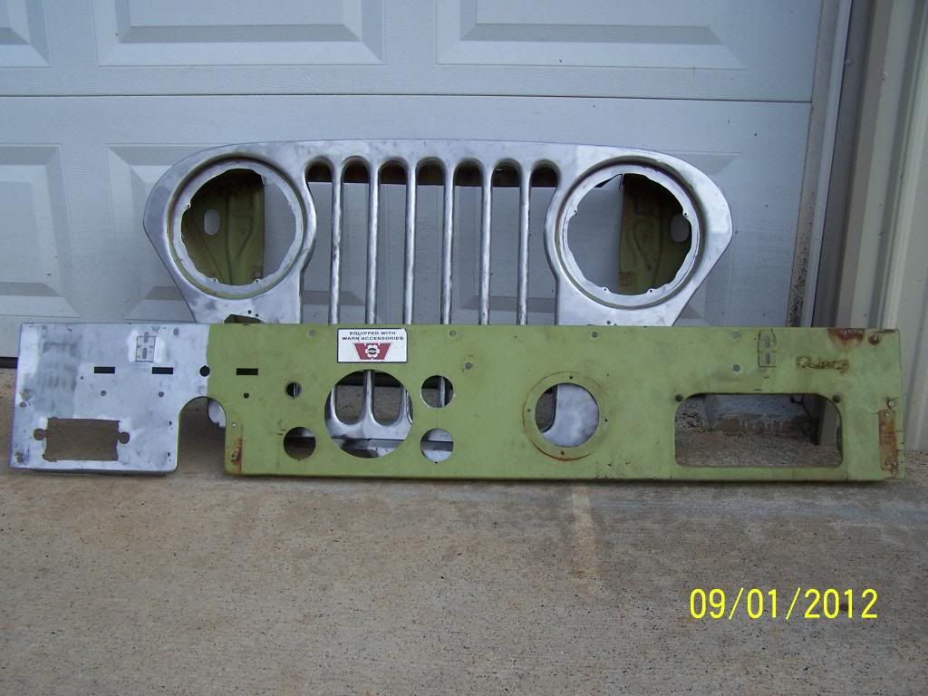

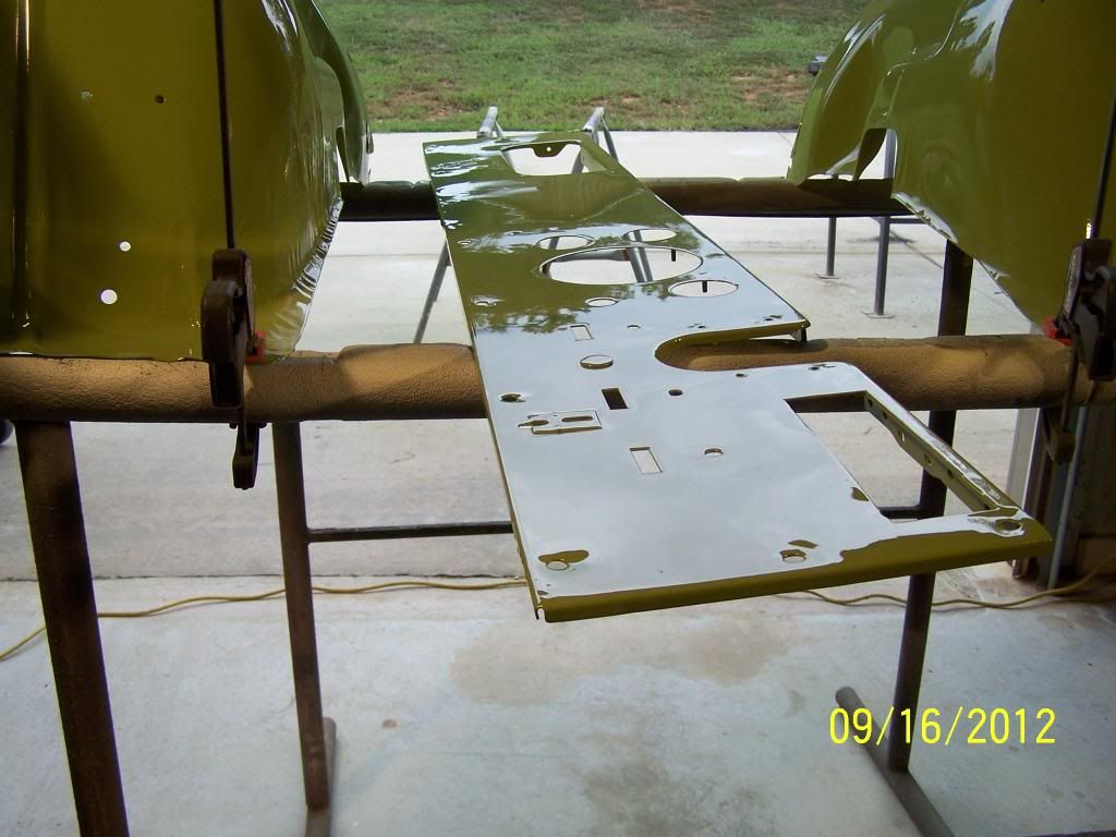

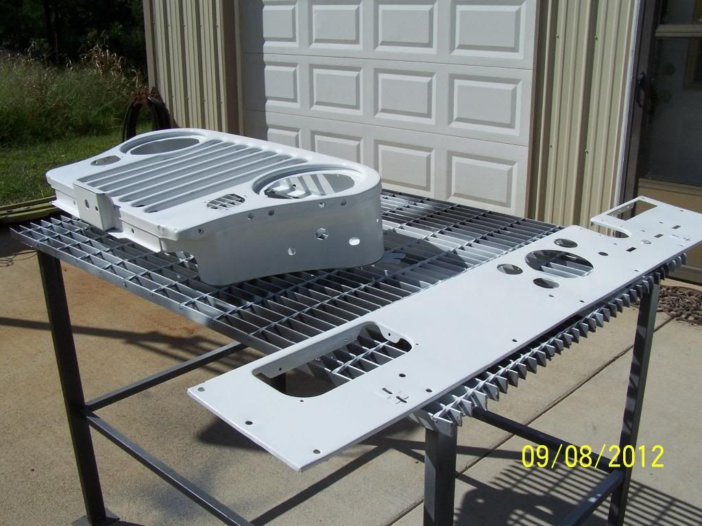

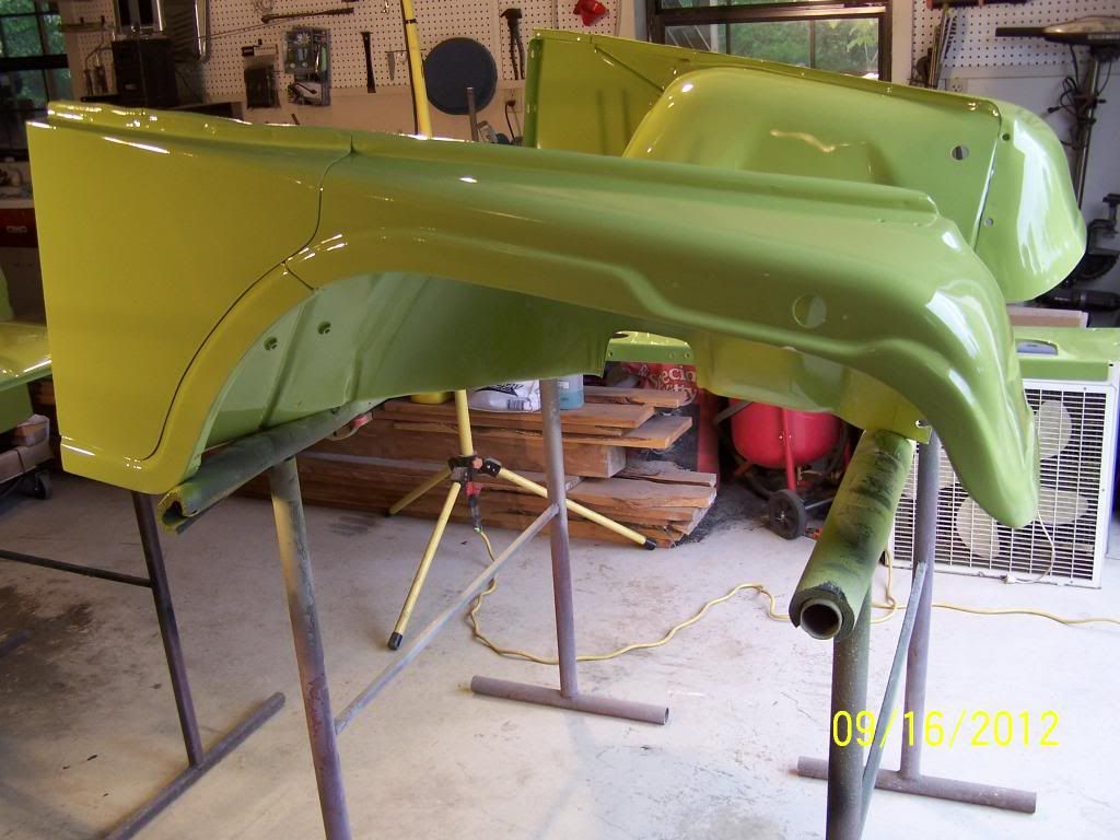

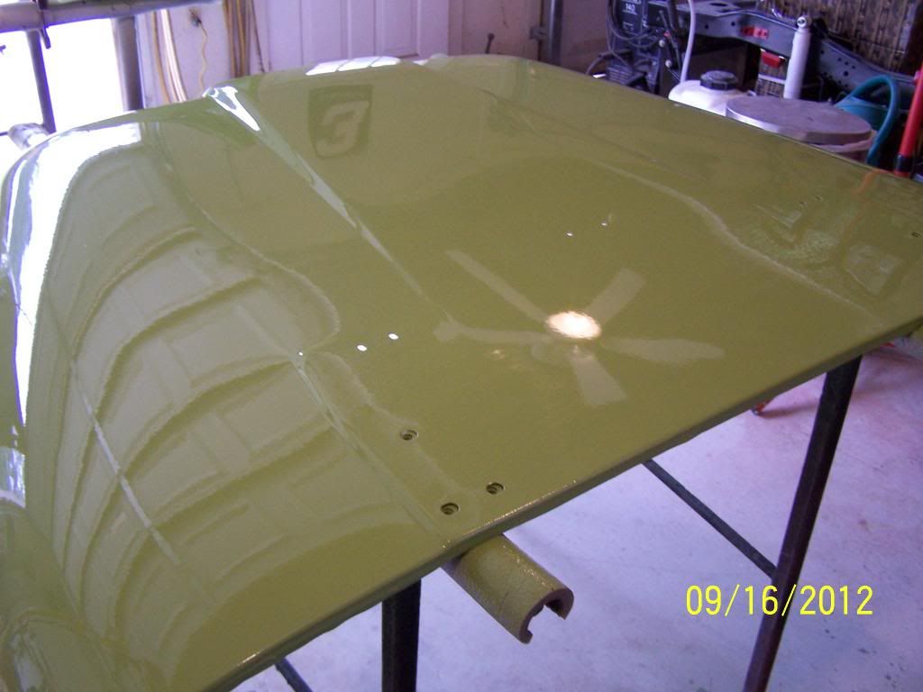

Using the old tools has been pretty cool. Got a little slow so here are some more pics. After I got the tub painted I started cleaning, sanding, grinding and stripping some 70 parts. It took me over a month to get them all down to bare metal. It just about got me in the end. I just didn't know if I was going to make it or not. I went with acrylic enamel on them since base coat clear coat would be too hard for all these parts. They looked great when I sprayed them, but after a week they still weren't dry. Even a month later they weren't dry with a hard finish. It turns out that the guy at the parts store forgot to put drier in the paint. I had to strip every last one of them back down to bare metal again. Since the paint wasn't fully dry it was like getting gum off you shoes! It was a nightmare! I wanted to cry. At this point I see why it is so hard to finish a project like this. Here is a pic of some of those parts.

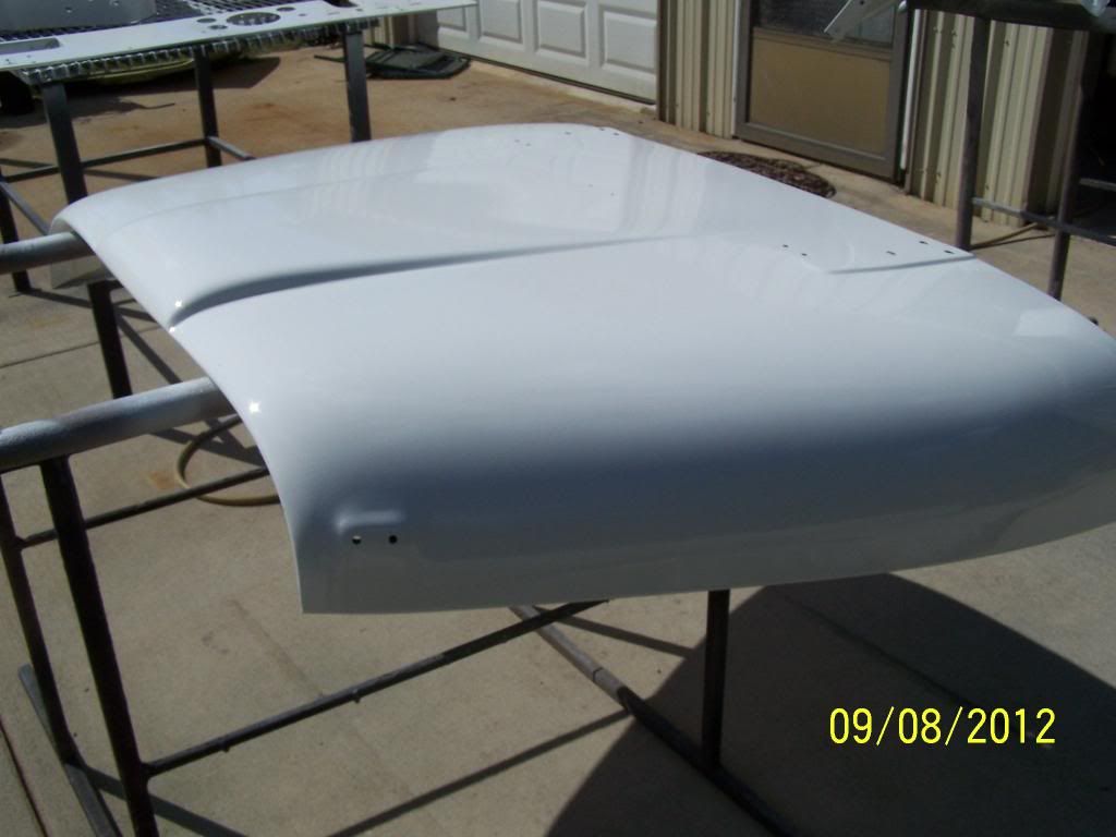

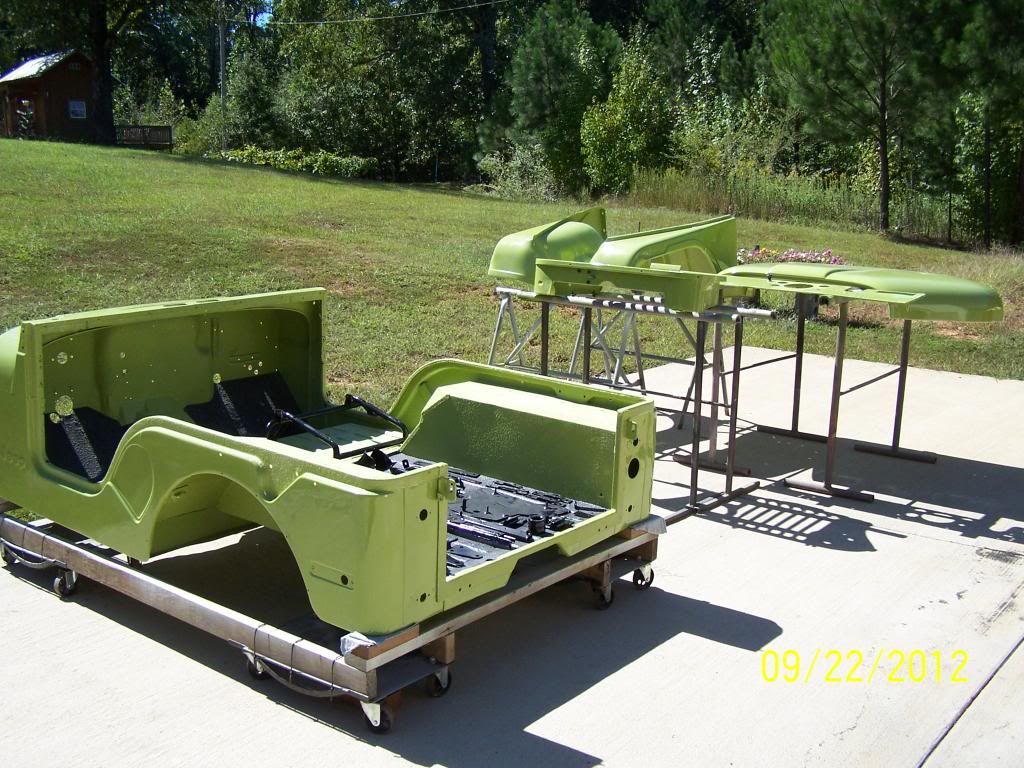

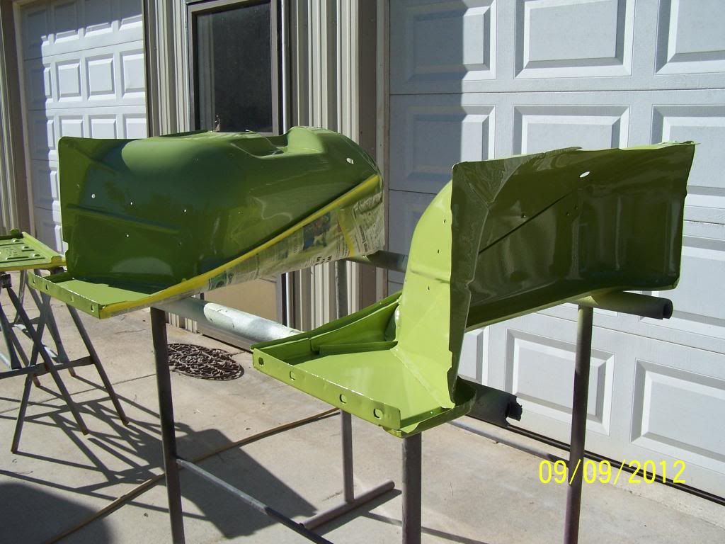

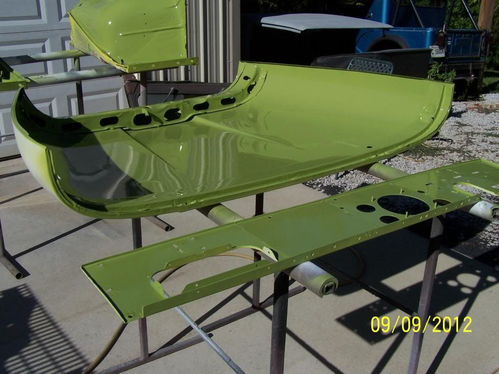

Okay, time for more pics. After fighting with all the small parts, I tackled the fenders, hood, grill and dash. I had to buy new fenders and a hood. The others were just way too beat up. Those aftermarket fenders ain't nothing like the original!
Finally got almost everything painted. Here it is all outside together. It was a proud day.
