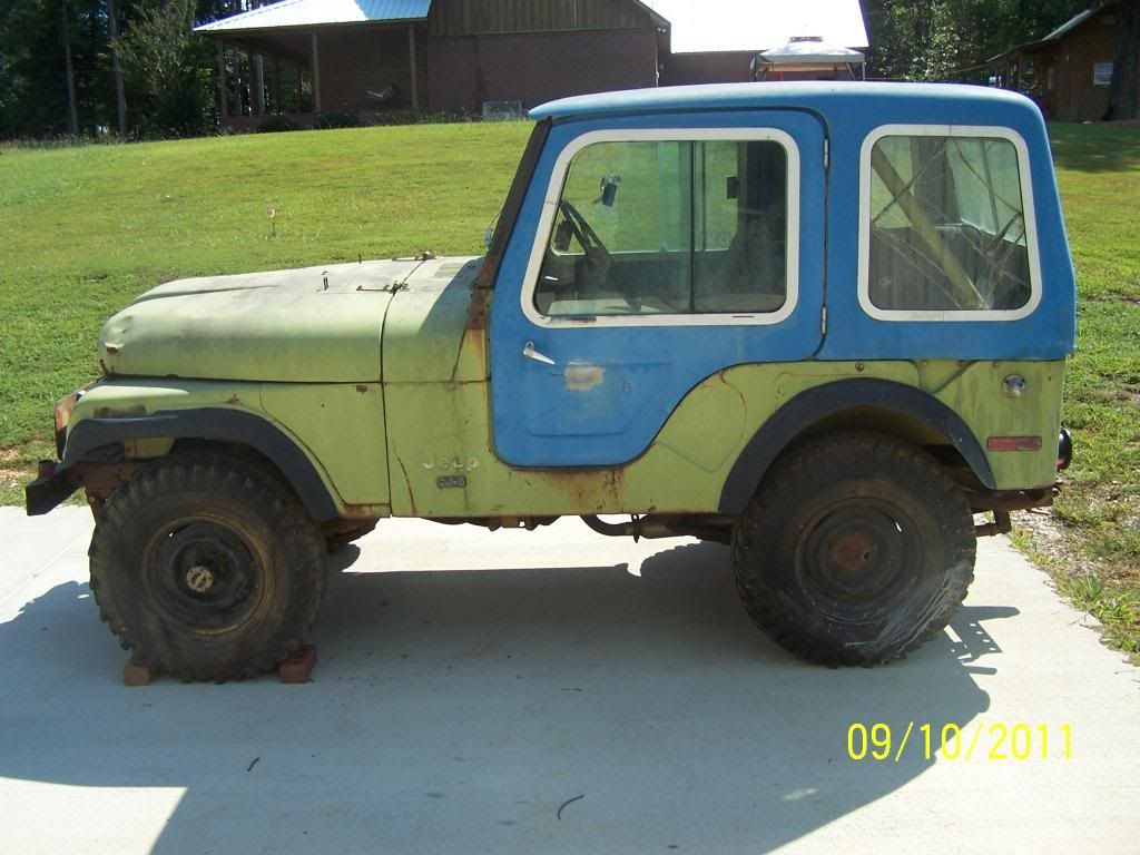

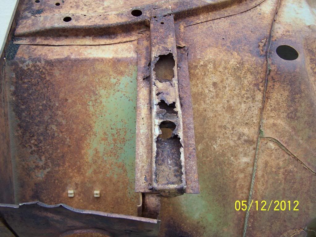

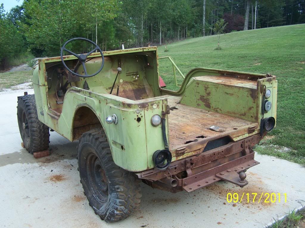

Hot dawg! I got it figured out...what a dummy! Here are some more pics of before I started.[IMG][/IMG]

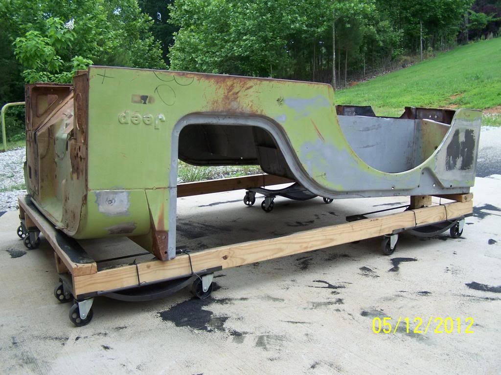

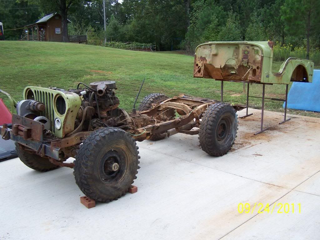

Here are a few tear down pics. Taking it apart was fast and easy! I must not can put but one image to a post or at least I can't figure out how to do two!

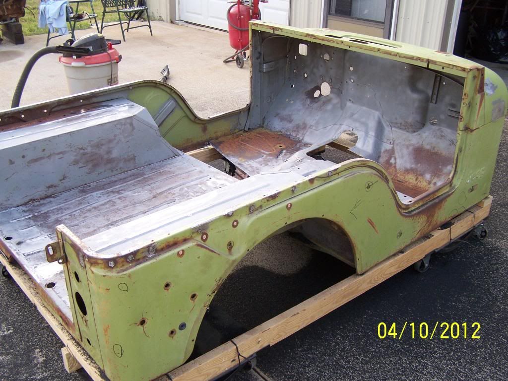

Here is one more pic, then I gotta get back to work! I plan on posting a few more each day until I get caught up to where I am at. Hope I am doing all this right!

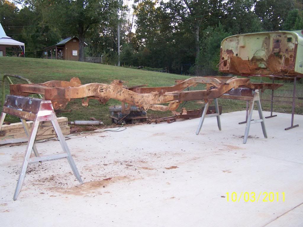

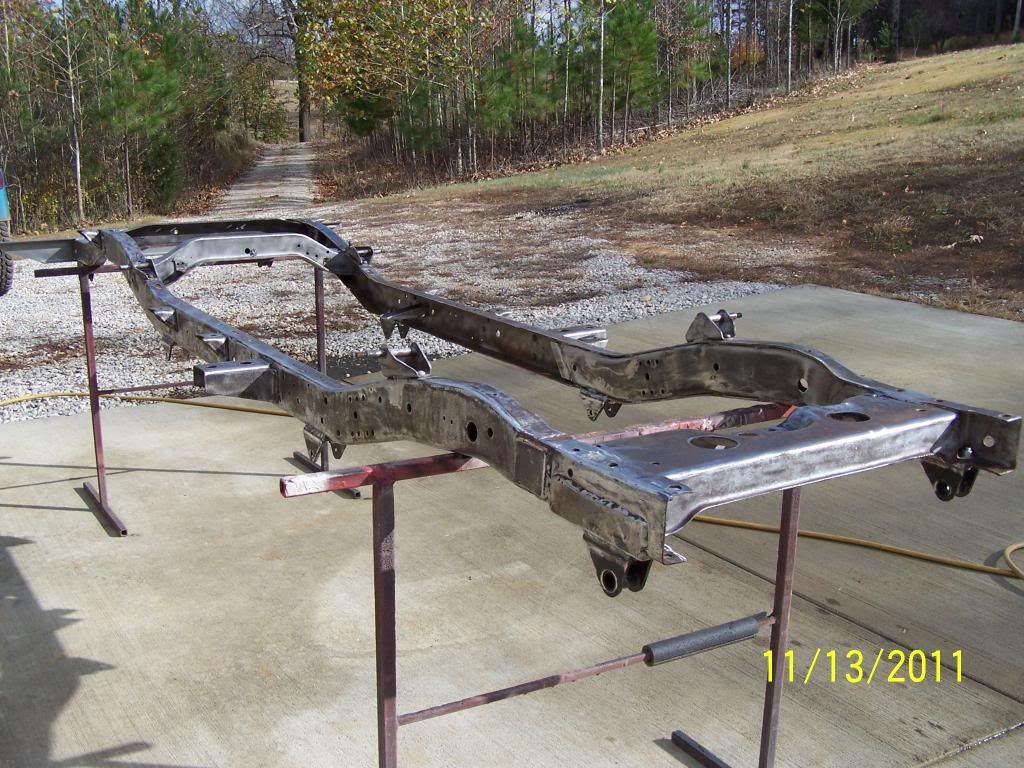

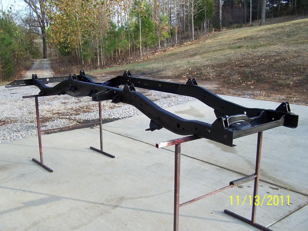

Thanks guys! and JeePete, I know what you mean. As a kid it seemed dad's old jeep would climb a tree like a squirrel when he locked it in! Even when I was older and it was wore out, it would go places in 2wd that I would have to lock my pickup in 4wd to go. Any way, here are some pics of the frame.
I have been wanting to fix this Jeep up for close to 20 yrs. so at this point I am pumped! I was dreaming about it when I would lay my head on the pillow. The tear down was fast and I thought this isn't going to take as long as I thought. What a dummy I was! If you will notice, the frame on the passenger side has a patch on it. My dad broke it probably 30+ yrs. ago pulling out a dump truck. The patch had held all those yrs. so I just welded it on the inside while I had the frame upside down. I hope I did it right. Wish I had been on the forum then to ask you guys what I should do.

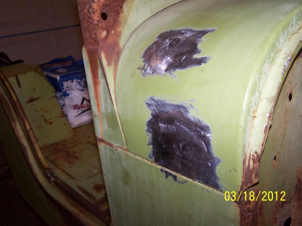

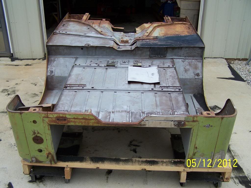

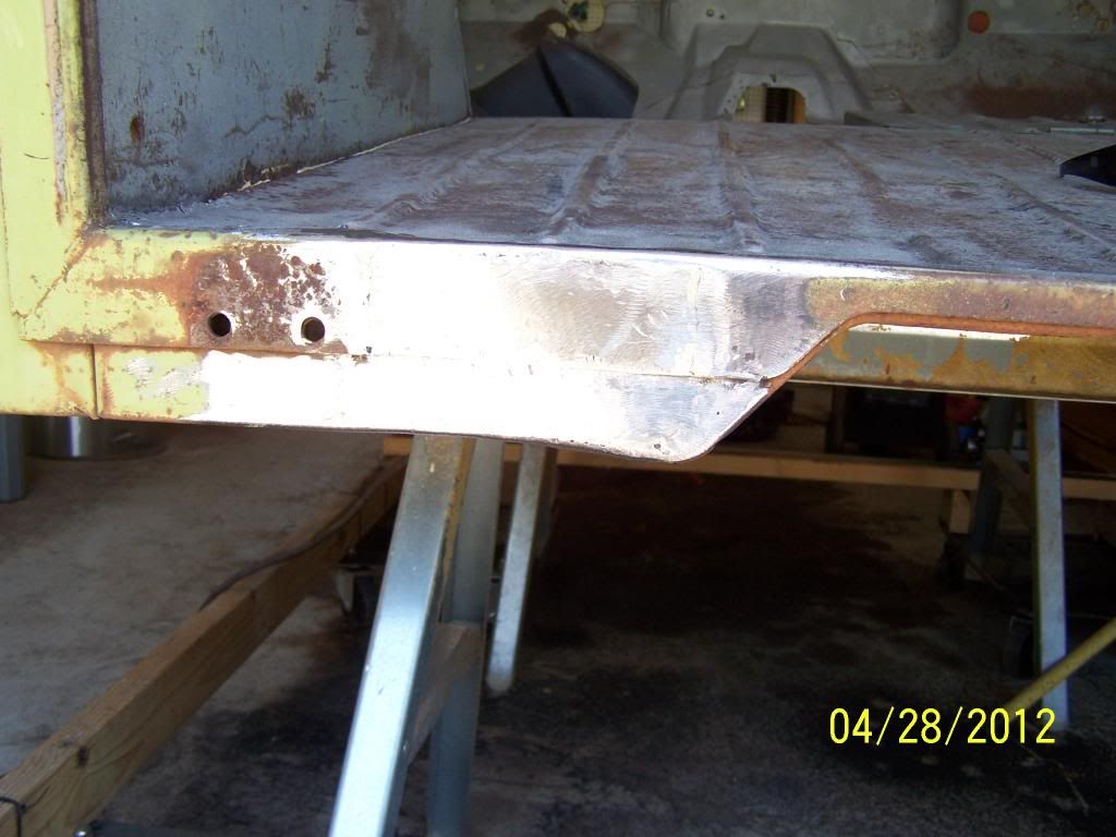

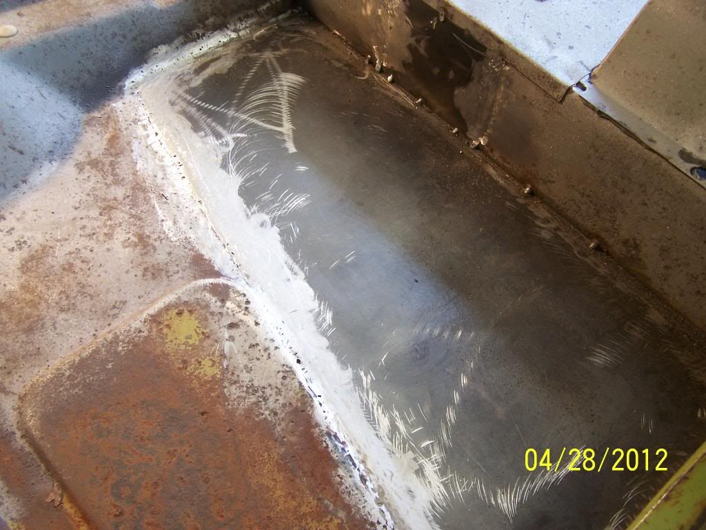

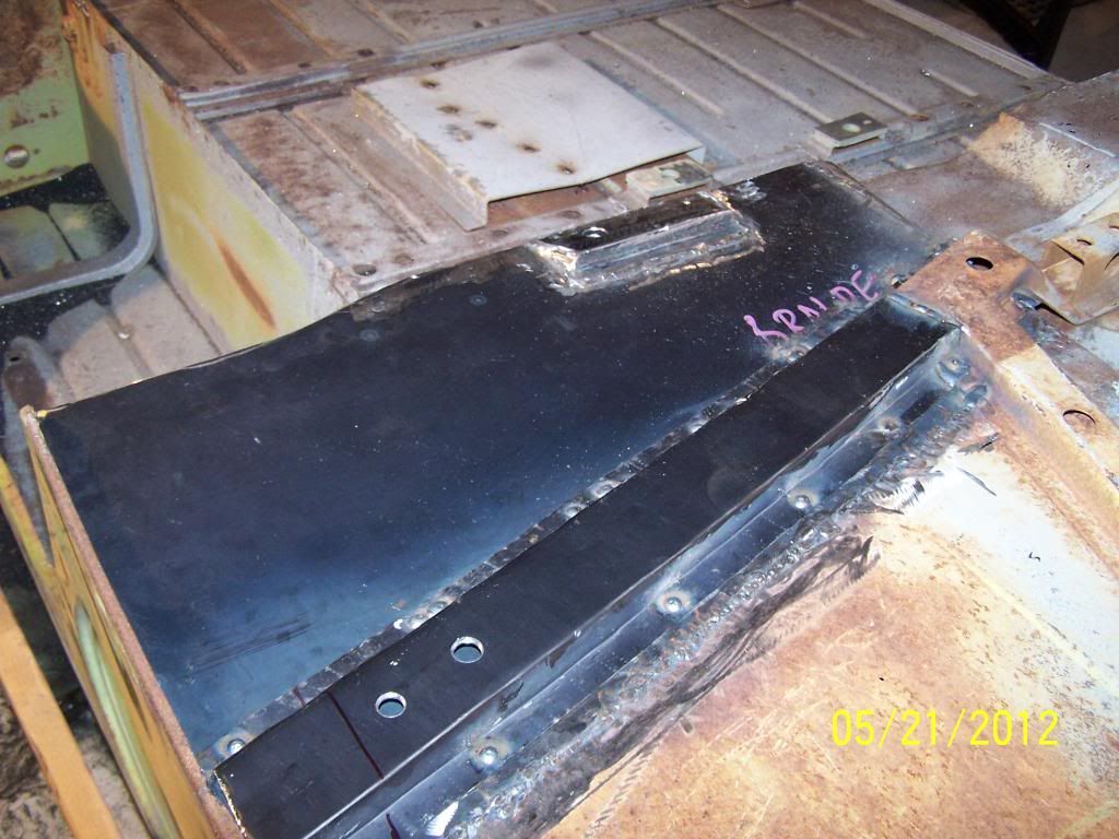

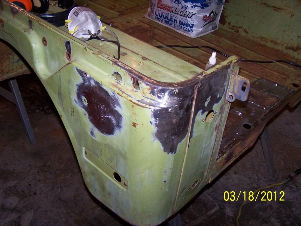

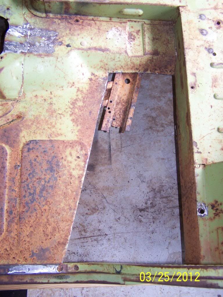

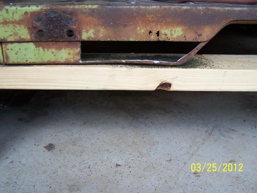

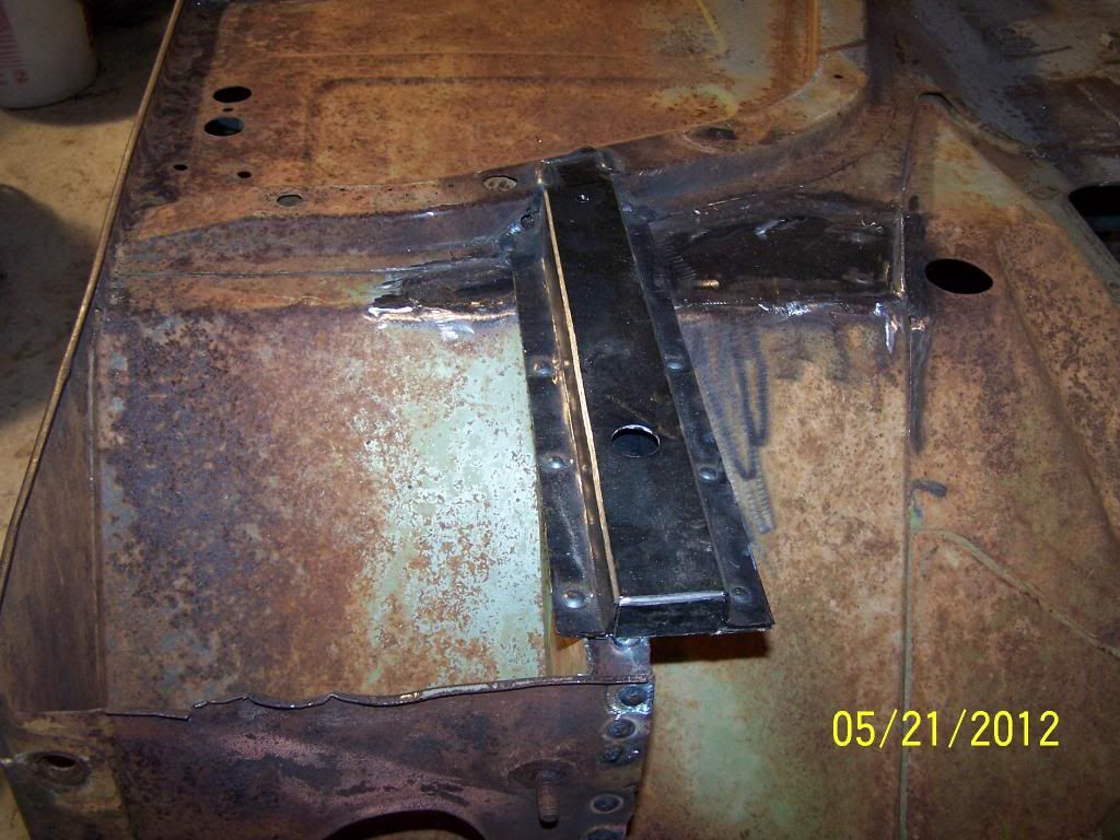

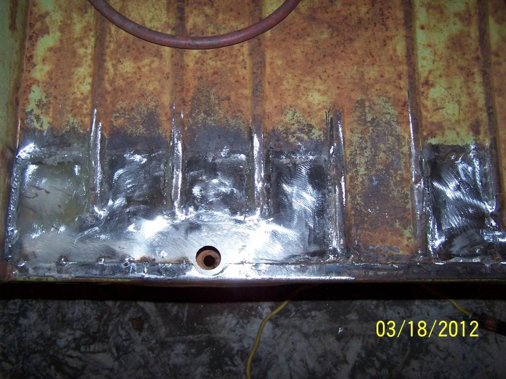

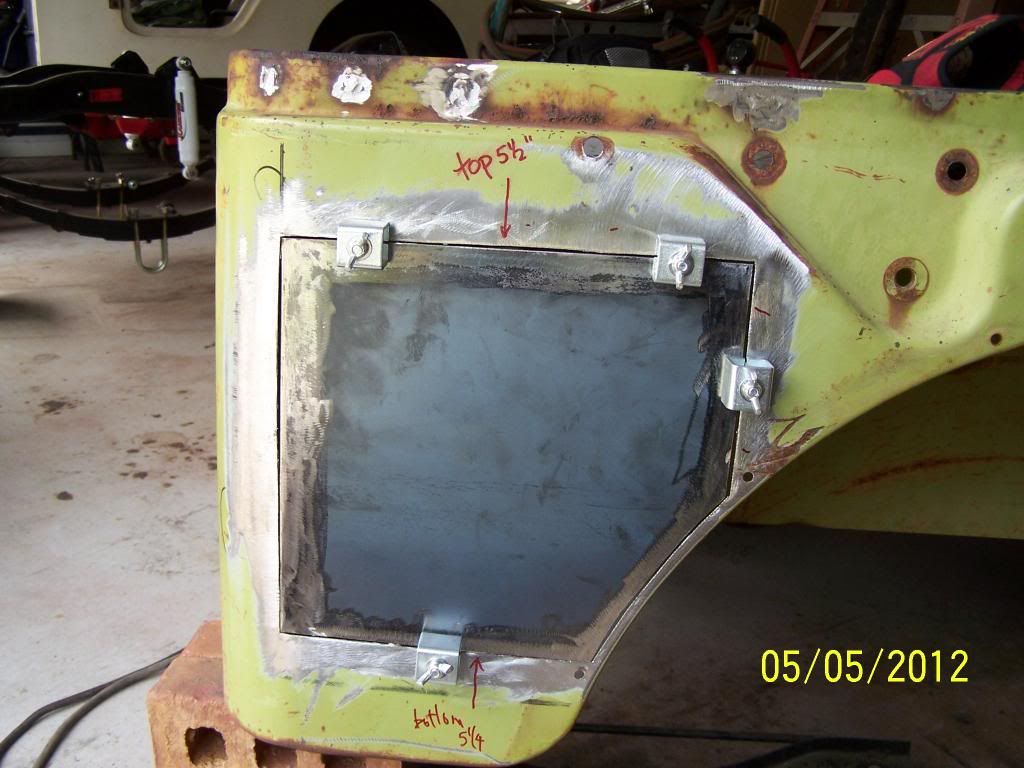

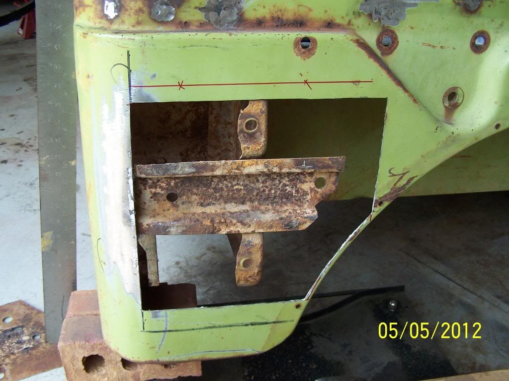

After I got all the shackle brackets replaced, the frame patched up and painted, I started patching holes in the body. For some reason, my dad had like 6 antenna holes cut in it. I would have loved to ask him why! Since I had never welded before, I decided to try patching them 1st. I had read not to get the metal too hot so that made me not weld them in good enough on the first try. I figured out that you had to get it hot enough to "burn" them in on the backside so they would hold and not crack. I would tack and cool it with water soaked sponge. They held up on my second try. Just hope they hold up in the future! After I got comfortable doing them, I started cutting the rust out and fixing those spots. It was pretty cool to use the tools that my dad had used doing body work for so many years.
Hope that's not too many pictures. After all the patching was done, it was time too strip the body. I also figured out that I kind of like that welding. It was pretty fun! I just hope I did it right and it all holds up because I didn't have anyone to help or show me how.
