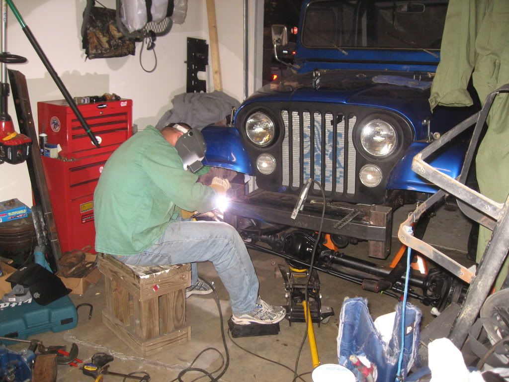

Ok, so I didn't do such a god job of updating this thread as I went. Here is a recent description of where it is though. It is still awaiting me to finish the roll cage and front flat fenders.
Cutting the axles in half to change the castor. Tig Welder and sleeves to strengthen it up.
What did I do!

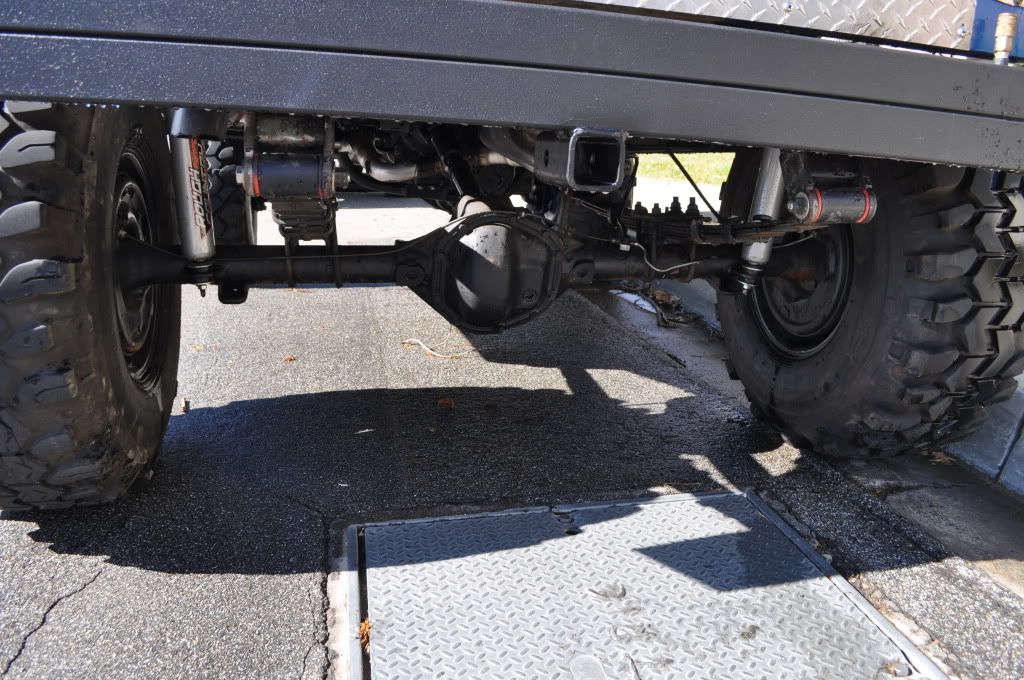

International Scout Dana 44s Front and Rear.....Detroit Locker in the front.
XRC8 winch w/ synthetic line
Custom front bumper
High steer chevy knuckles w/ CNC machined arms
Ford expedition brake discs to keep the 5X5.5
Chevy calipers
International Scout inner axle shafts and Chevy stubs
Custom tie rod and drag link
Griffin radiator w/ electric fan
Jeep YJ 2.5 inch wide springs with custom hangars SOA
Marinehorne is offline

Dana 44 in the back. CV driveshaft. Air tank bumper.
Homemade flat fenders. We relocated the rear axle as far back as possible. Custom Shock hoops.
