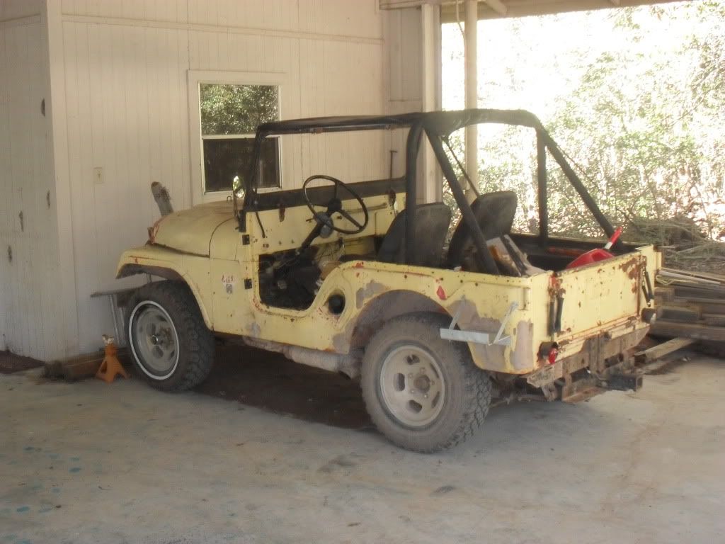

i have a 1966 CJ5 that i am trying to fix up and get running again
couple questions i have is what are the size of the stock tires( i have bf goodrench all terrains on there now but dsont know what size they are )
my carb is acting up and i would like to replace/rebuild it. wich direction should i go and how hard is it to rebuild or clean it
[IMG][/IMG]

If it's the OEM carb, it's pretty easy to rebuild.

My '64 originally had G78-15 bias ply tires, which translates to about 215-75-R15. I think you could go up to 235 without looking too far off-stock.
For the carb, it would help to know which carb you have. If you have a 4-cylinder engine, you probably have a Carter YF, which is pretty easy to rebuild.

The V6 uses a Rochester 2G 2 bbl. carb,
As posted above, it's pretty easy to work on.
If you get it set up right they work well.
