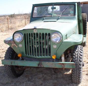

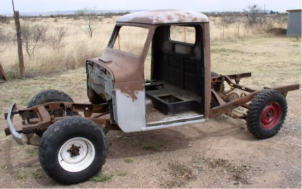

For my next project I will take two Willys projects and combine them into one complete machine. Here is what I'm starting with. A 1950 P/U:

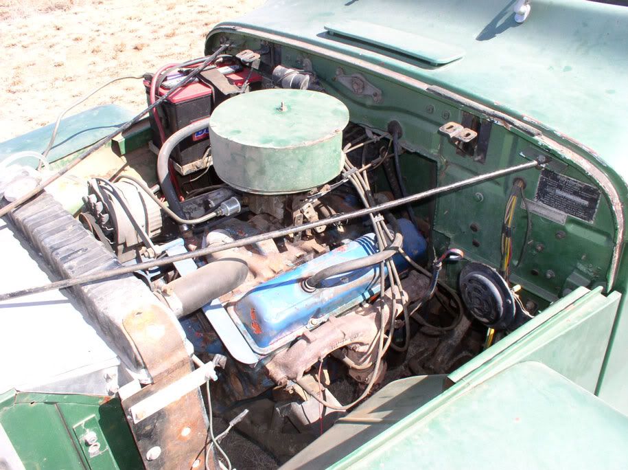

And it has a V8 307 SBC. that runs.

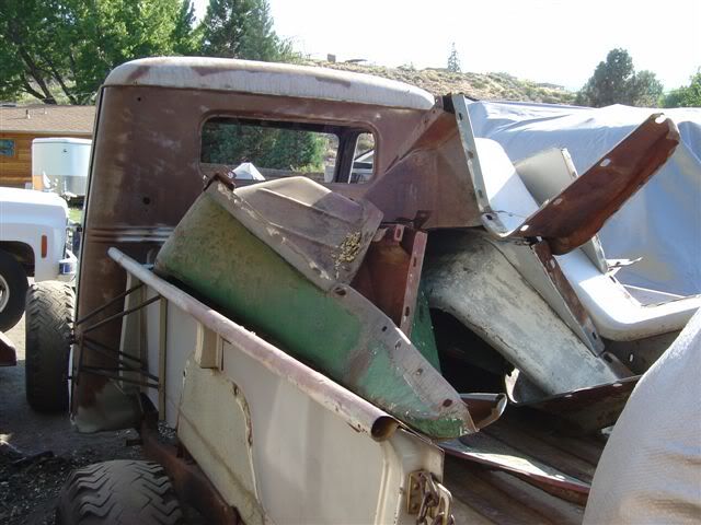

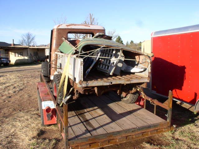

I recently made a 3000 mi. road trip and picked up this 1952.
I got lots of extra parts in the deal.

I will use the frame off the 1952 since it is bone stock and in very good shape. I will sand blast it and prime/paint it. I'm toying with the idea of painting the frame yellow. This is going to be a just for fun build, so anything goes. So far I have $700 invested in both trucks.
I borrowed a MIG welder, so will be learning that also.
The axles on the green 1950 were upgraded when the V8 was installed. I was told they came out of a gladiator, so that is what I'm using. The front is a D25, and not sure what the rear is yet. The tranny is a three speed, and shifts very nice, so will use it for now. All the 4WD works great. I'm going to convert the front to disc brakes.
I'm using the cab from the white 1952, and have my choice of bench seat or buckets. I like the buckets. The bed is a toss up. Not sure which one is better yet. As for the engine, I'm planning on getting rid of the 307 and using my 1985 258 that is on a stand ready to go with weber carb and HEI. The 307 is worn out, and too big for the engine compartment IMO.
For guages I'm going to add modern parts very similar to a CJ's. The rest, I'll make up as I go. Anywhere along the way someone has ideas, I'm most definately open to. I'm new to this, so will need lots of help. I will have lots of parts left over that will be free for the taking also. Extra frame, bed, door, hoods, grills, etc...
