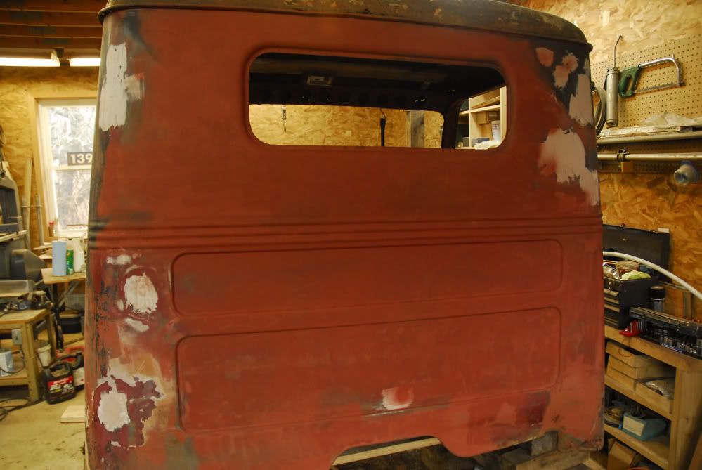

As for body-work, I love it. I don't know why. Perhaps it's because I don't really care too much about how the truck looks. Basically, as long as the holes are patched, I just throw some bondo at it with a quickie coat of rust-paint. Works for me and passes a 20 or 30 foot test.
D-side door, before:
After:
And here's my grille, looking purdy, to me at least. The colour is International Red, BTW.
Got the fenders done in the loosest sense of the word (I'll get new ones one day, hopefully), and the hood. Haven't done much with the cab yet. Needs a floor and some other patches. I don't know how to weld yet, but I hope to learn one day. Maybe I'll weld-up my cab floor.

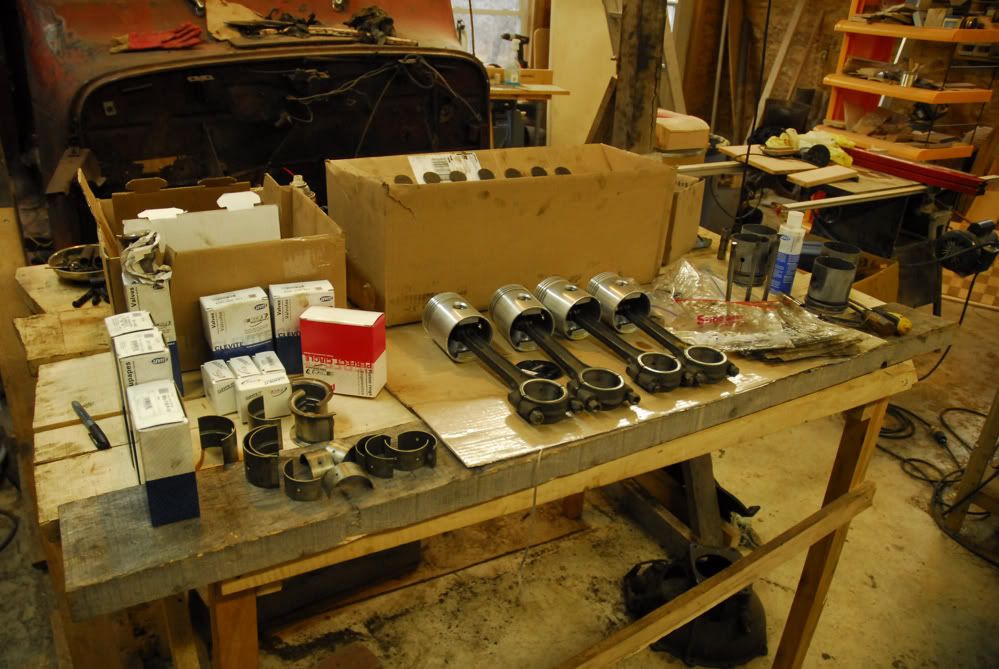

Update

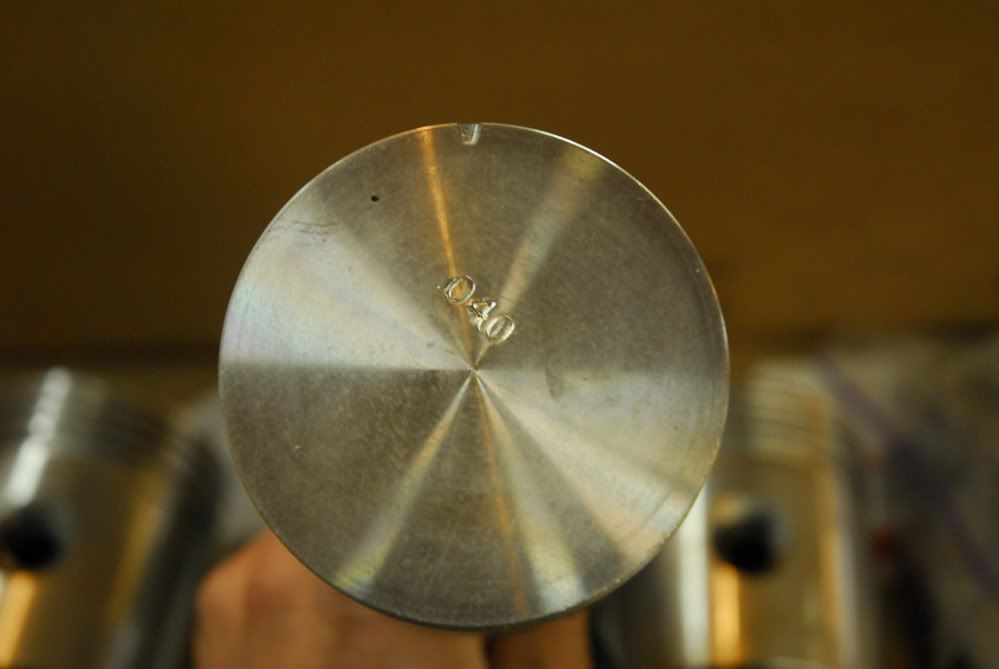

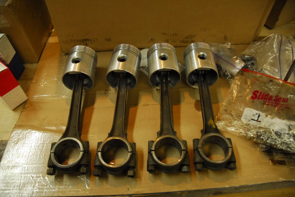

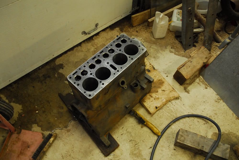

Picked up my engine yesterday from the machine shop in Saint John. They bored the block .040 over (was standard before with 90'000 miles on it), reground the valve seats, new valve guides, reground valve tappets, new valves and springs, reground crankshaft, new bearings, pistons etc. etc.

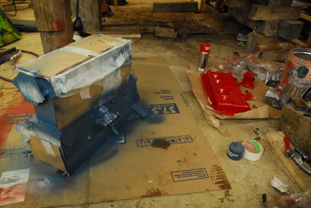

I cleaned it up and started on it today. Put down a coat of paint on the block and head (went for Chev blue on the block and Ford red for the head -- which turned out to be kind of bright orange -- I hate it.) Put the camshaft in after it dried.
PICS

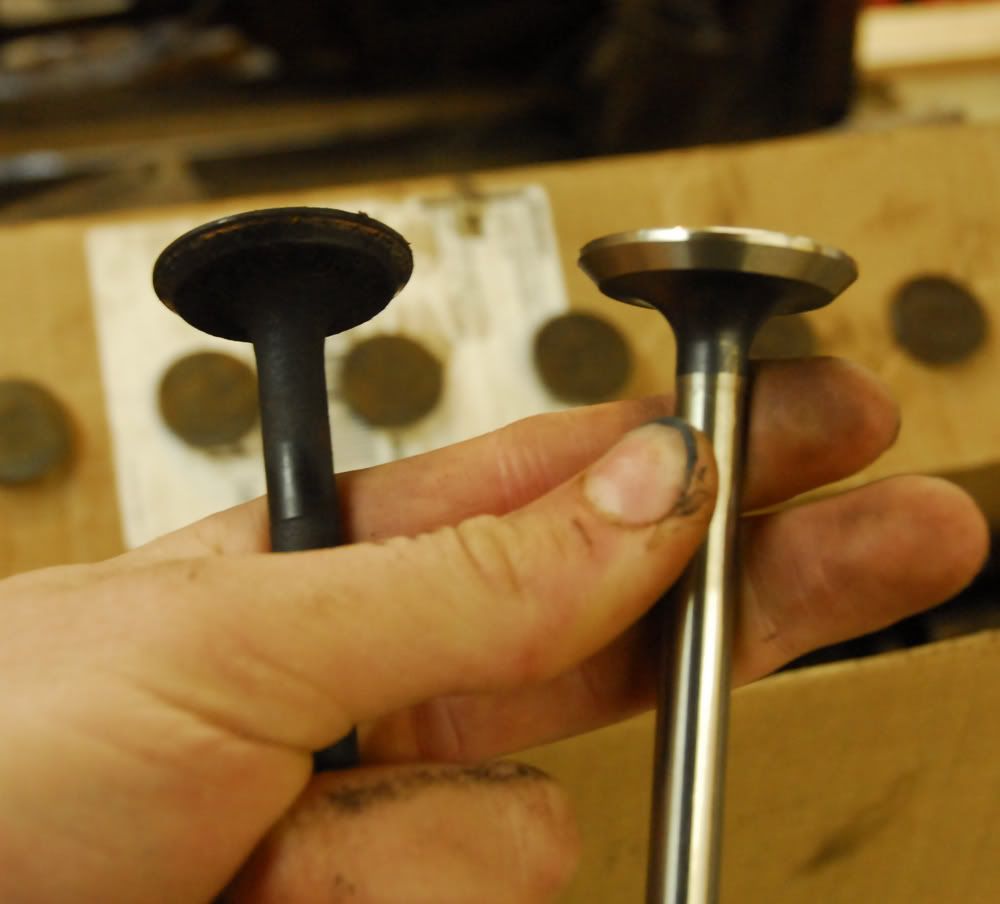

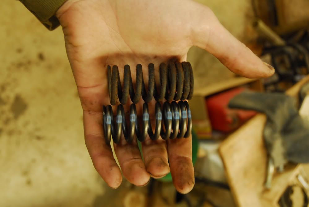

Valve comparison, new vs. old...
And springs:

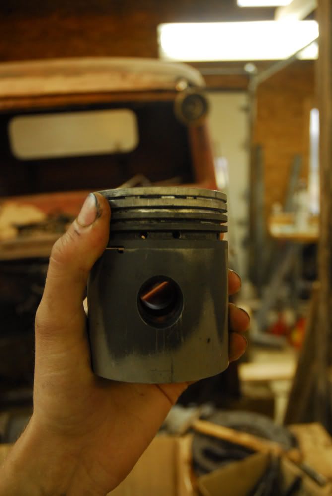

Old piston with obvious blow-by
Reground crank

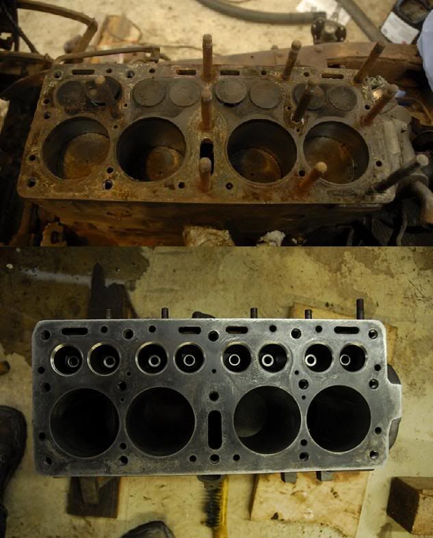

Freshened block

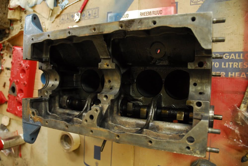

Before/after
Underside

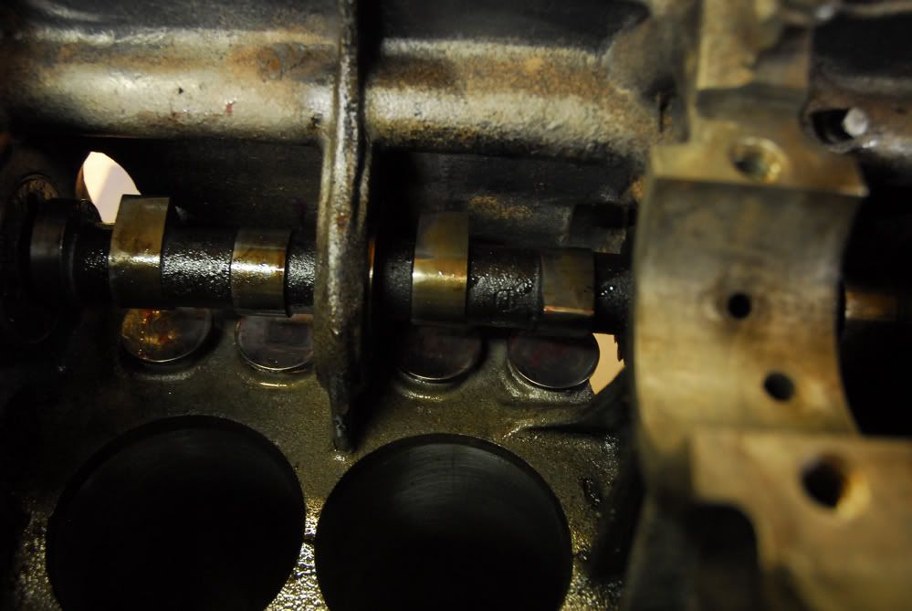

Camshaft and valve tappets installed
Coat of paint. Going to change the head colour. Too red for that blue methinks...what do you think?
Threw a coat of primer at the cab. Still need to do some bodywork.

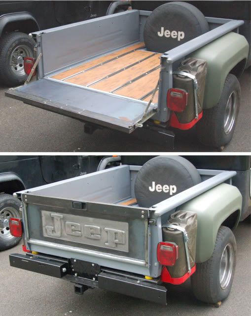

Anyway, sweet jeep truck. If your going for a flatbed look, you should use some real nice wood back there.
Or use what Jeff Scherb used on his Retro Wrangler and CJ9 pickups.

Thanks for that crankshaft tip. I installed it today with no problems -- turns like new. I did have a problem though with my piston rings. I took them out of the package to see which was which (they came in two bundles), and they look identical. I couldn't figure out which groove they go into. Upon further investigation, I noticed there are tags in the box saying which is which. However, when I took the bundles out, I got them switched and I don't know which is which! I measured them to the best of my ability and looked at them with a magnifying glass and they look the same. Note that I'm talking about the compression rings only. Any help??? Will post photos later.
For the flatbed it's going to look like the ones in the original adverts. I will probably use Oak or Elm, painted. Should look good, but more importantly be very durable. That hardwood is tough!

the top groove on the piston isn't used on these 134ci engines.
groove
thin ring
slightly thicker ring
the ziz-zag type ring thats sandwiched in between 2 thin rings
NOTE: stagger the groove in the rings when installing them for correct compression.
I hope I simplified it enough. I have rebuilt 3 of these kinds of engines before....doing another one now...

My confusion is with the compression rings...how much thicker is the slightly thicker ring? Honestly, after staring at these things and measuring them for quite awhile I couldn't see any difference. Maybe I need some precision measuring equipment. I would have thought the difference would be more obvious (both have an upper facing bevel on the inside of the ring, same design).
I really think they're the same. Is this possible? The rings that were on the old pistons, square upper ring and beveled lower (compression rings).

they might be...I usually use Sealed Power rings when doing my engines...I will check my box when the new ones come in. They come with instructions, just to double check.
