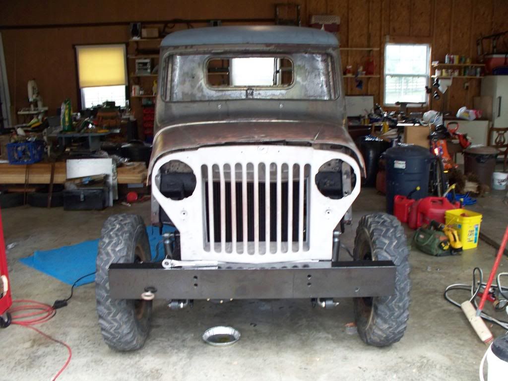

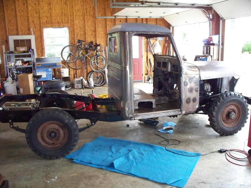

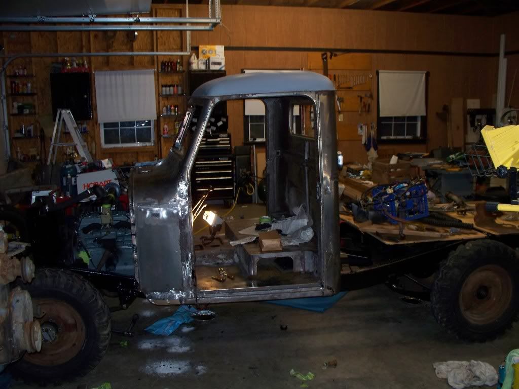

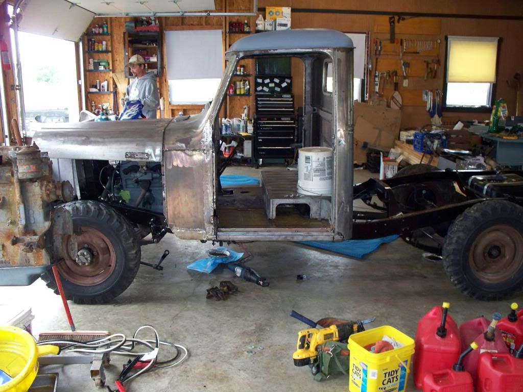

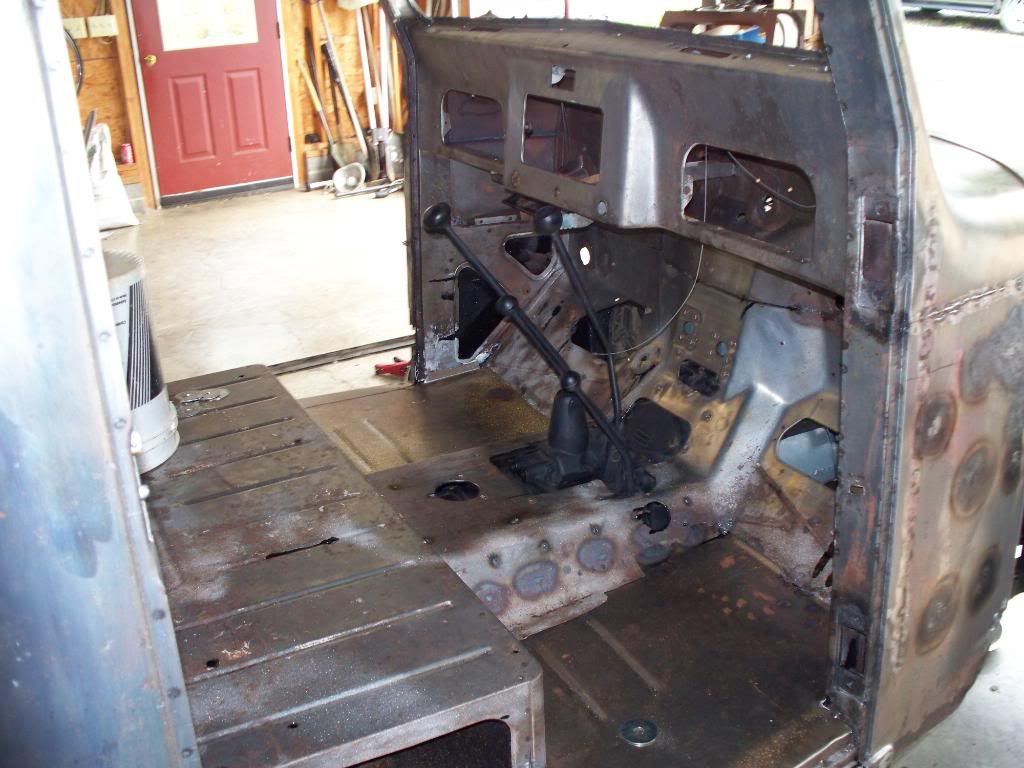

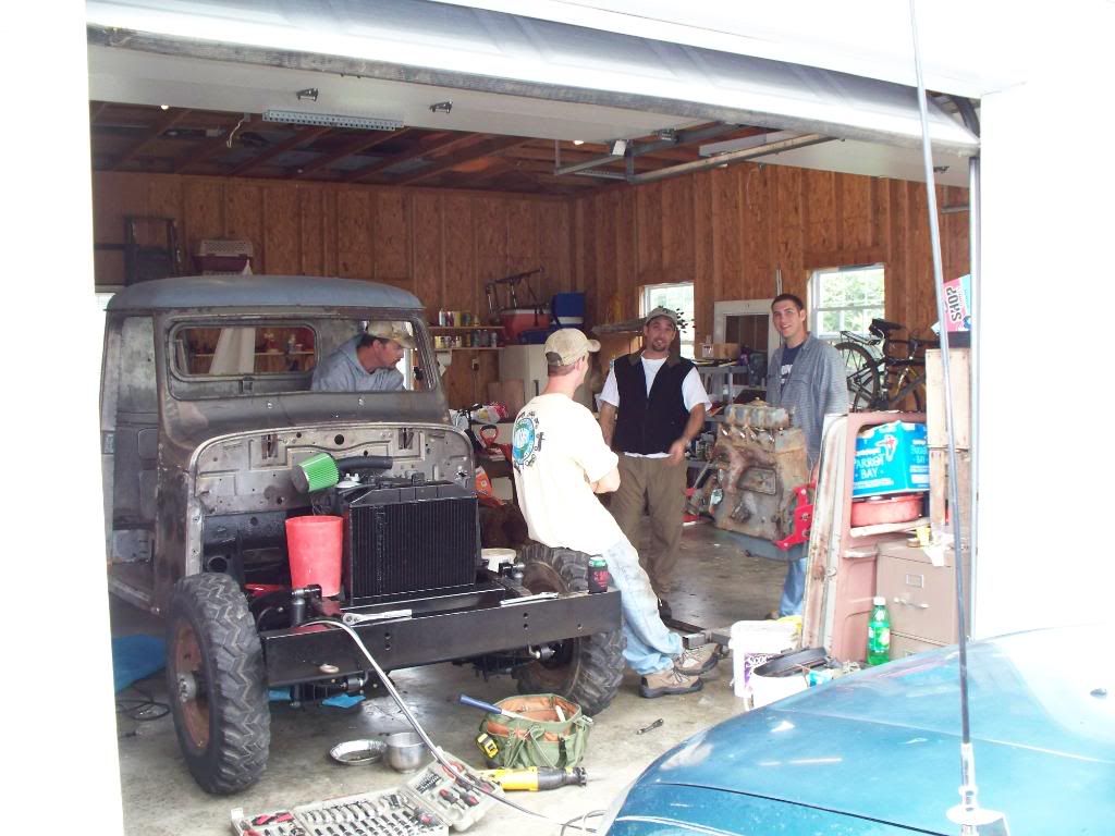

Today, I put the cab on the frame for the first time since November 2006. I would like to thank the Southside Jeepers for coming out and giving me a hand today! Afterward we went to BIG LEVELS, and did some wheelin'. That made for a great day!
Also, I took the started button/switch off a Dodge Powerwagon engine I had lying around, to see if it it would work...it did, but I have a new one on order. The engine started right up, after we figured out why it wasn't getting spark (forgot the "hot" wire) After we sorted that out it stared RIGHT UP THE FIRST TIME AND IDLED PERFECTLY FOR ABOUT 2 MINUTES

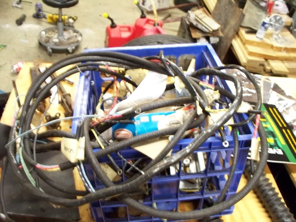

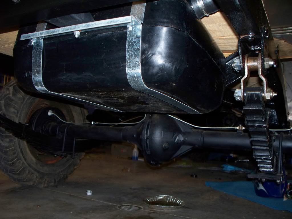

I know that those of you who have been folowing along are eager to see more pics....and here they are...
PICS: (mostly random, no order)

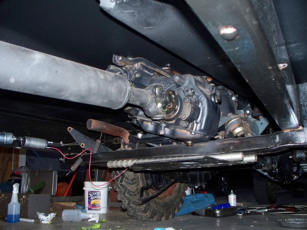

I have recently gone through my shelves of parts and sorted out what was left. Most of the items are in good shape - nothing some spray paint can't fix. I also acquired four newish 15 inch '62 Corvette tires from a friend the other day...I might run them as road tires, I'd need to get a set of 15 inch rims though. Still need to figure out what to do with the ceiling...might coat it with sound deader. I also need some rubber pads between the cab and frame, I'm thinking about 1/2 inch will look good, and i bought 1/2 inch longer bolts.
I also worked on the cab some -see next post...

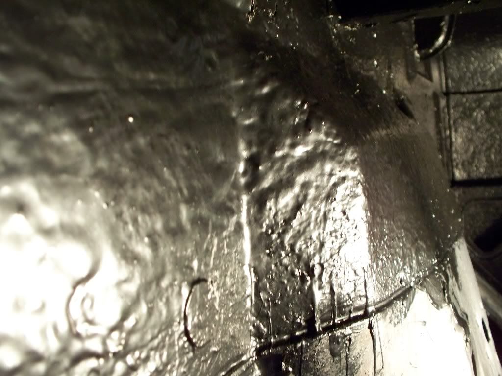

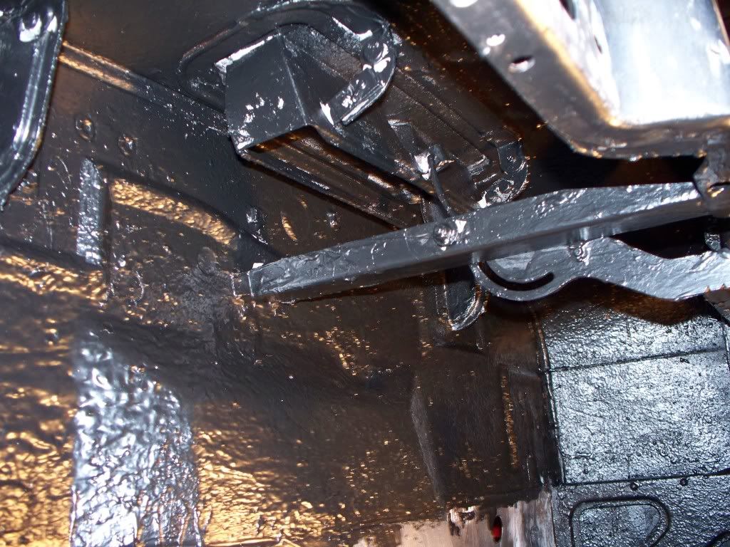

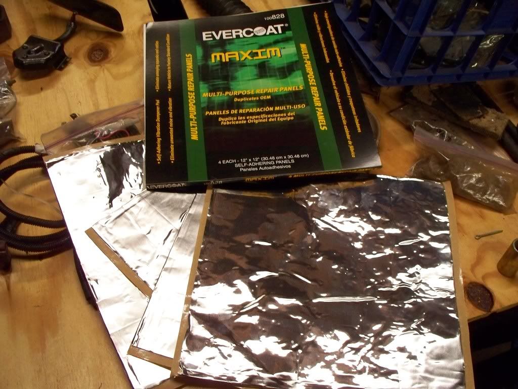

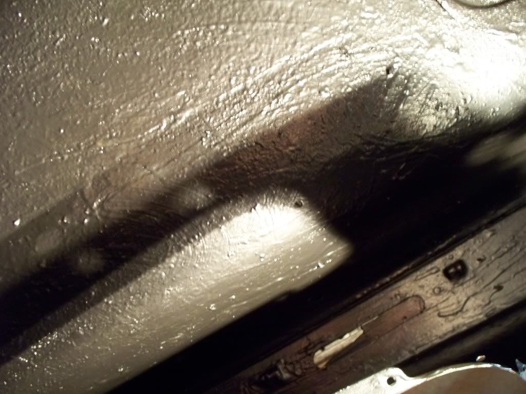

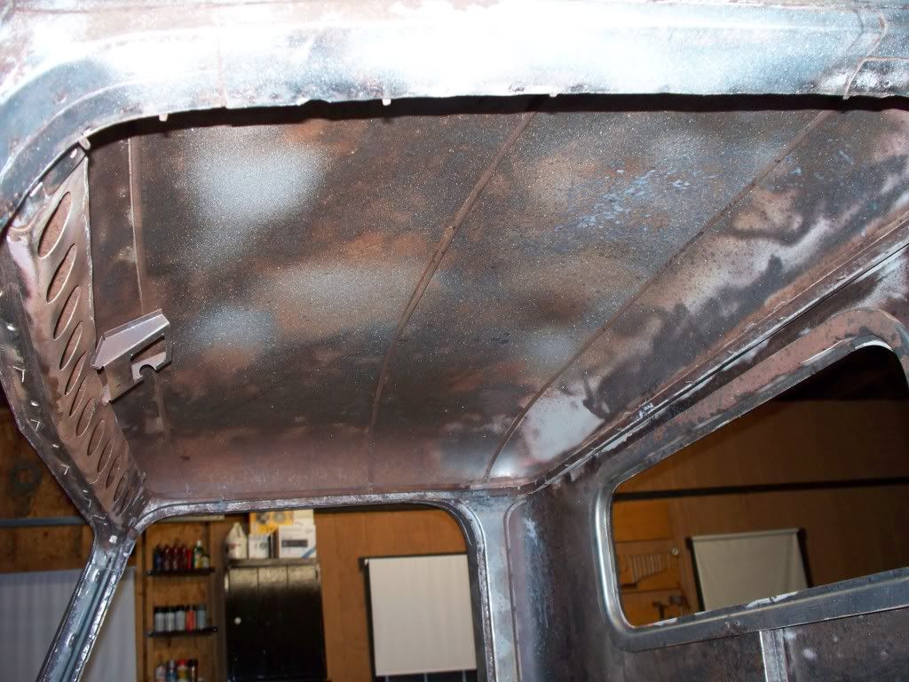

I wanted to put some thing to deaden sound under the dash (I was told their was a lot) I also wanted something CHEAP, (spectrum sludge would be ideal, but its $200 for 5 gallons!) I also had a gift card to autozone that was burning a hole in my pocket. I picked up some dupi-color bed coating. I thought I could spray it like I did the POR stuff -WRONG! it sprayed for about 1 minute, then cloged my gun...had to then "smear" on the stuff with a foam brush (its all I had) I don't think it looks very good, AND the pan I was using spilled while I had it on my belly, while lying on my back to coat the underside of the dash. Ruined my shirt. To prep the metal, I used Metal Ready (zinc phosphate)and got some on the floor...again.
I like this dupi-color stuff, it goes on thick!, and it kills sound. might to the roof in the stuff, and the floor riser, and use the POR stuff on exclusively the floor pans. What do you think? is this a wise move?

Looking good, you're making some excellent progress there. Are you going to put headliner up on the roof, or just the coating? I'm not sure how much sound deadening coating would help on the roof.

yeah thats what I was thinking...but im NOT putting carpet in, the only cloth will be the canvas cloth seats (re upholstered seats) Im also looking at spectrum sludge (Google it), but my budget is flat right now.

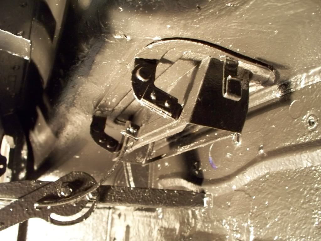

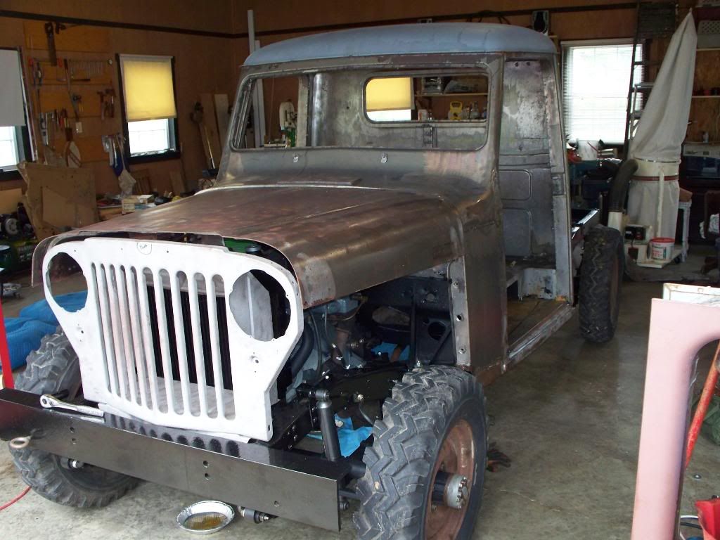

I have been thinking lately, What colors, and how am I going to paint the interior? I was thinking Dupicolor bed coating on the floor riser, and halfway up the back side of the cab, POR bed coating on the floor pans, and rockers. The roof I don't yet. The dash and topside of the cab, and the A pilers being body color ("craftsman red").
I did some painting of some small things today, I did a few things under the dash Craftsman red, just so I would have some contrast. I also painted some of the block off plates, and "mock fit" them in. The "theft deterrent" device I also painted, and mock fit. I even installed the instrument panel, just for kicks (will have to come back out for painting though). Heres some pics.
PICS:
Heres a pic of my lock out hubs, Dual-matic hubs.
