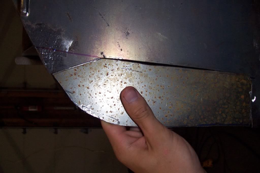

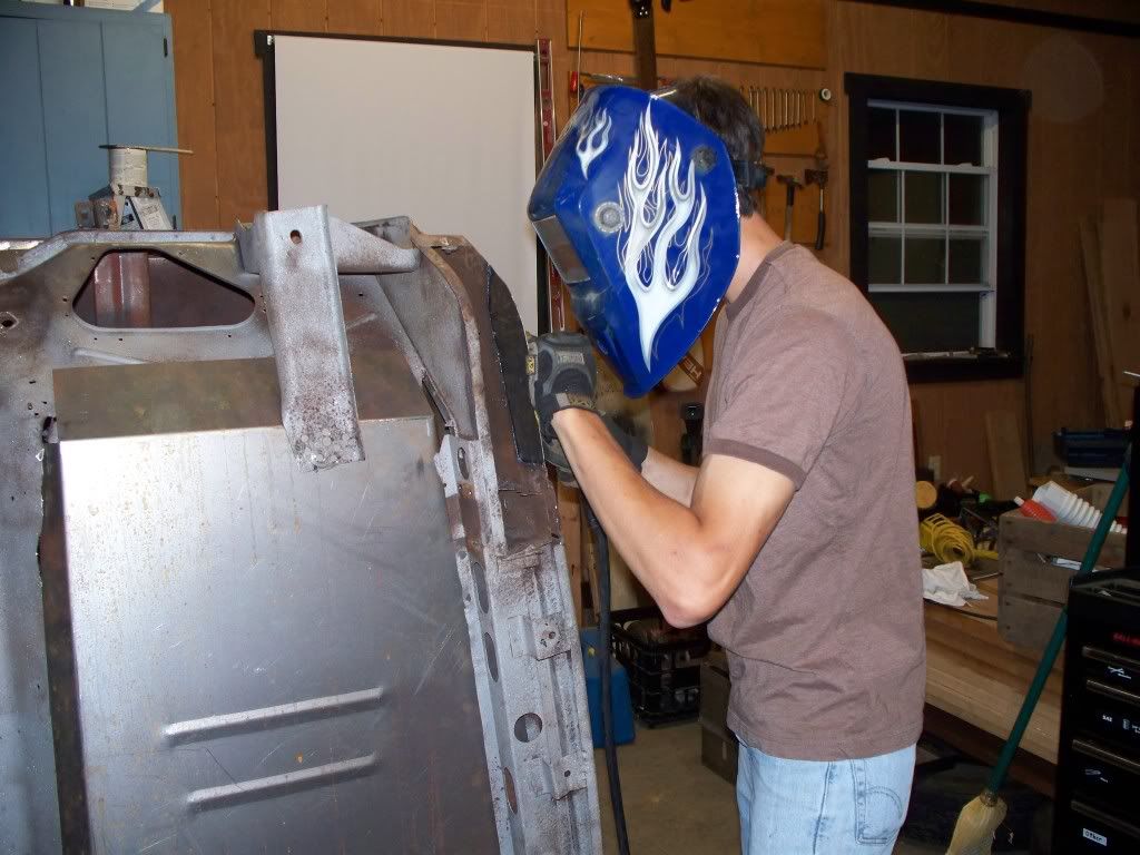

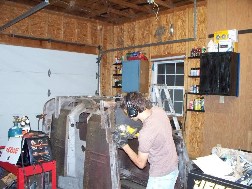

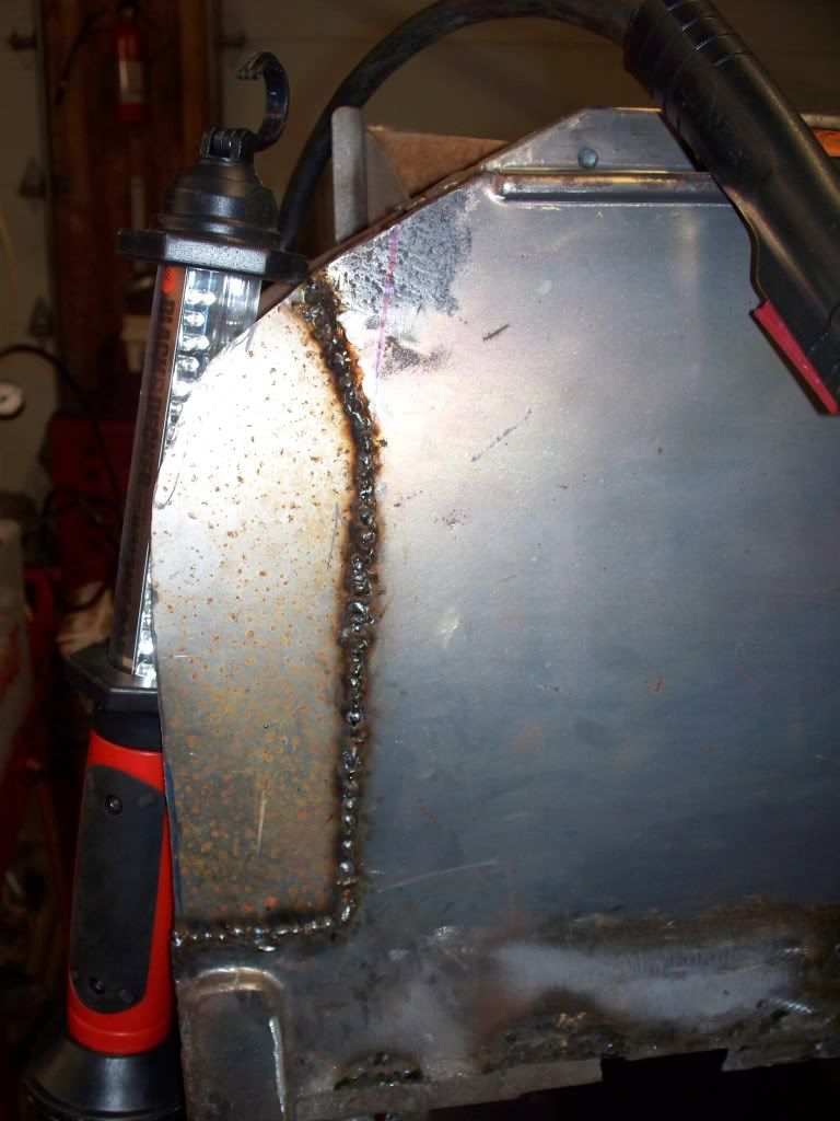

Well...the body work is coming along slowly. Tedious as it is, it has to be done.
Just a lot of pics....(I have filled a 4 GB memory card in 3 months....do I take too many pictures or what! with a 12 megapixel camera!) sorry about the quality of some of them, couldn't get the camera to focus right.
only 2 hours of work to do that
1949 Jeep Truck; just needs paint

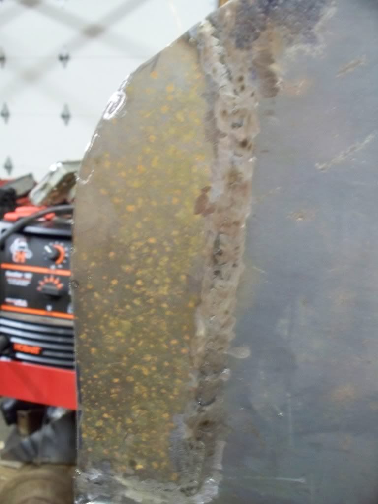

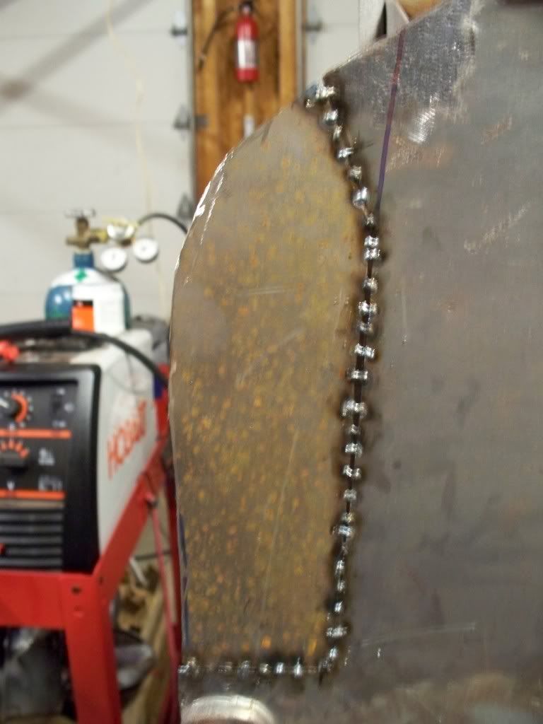

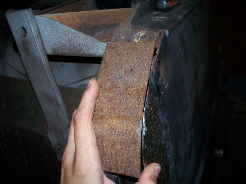

this is another patch panel I made awhile ago, it'll go in tomarrow.

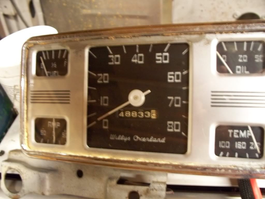

restored the gauge cluster...Did that back in May...

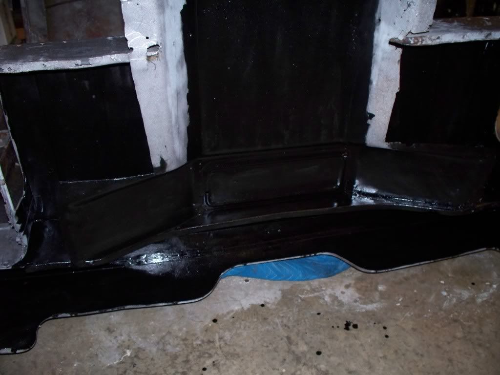

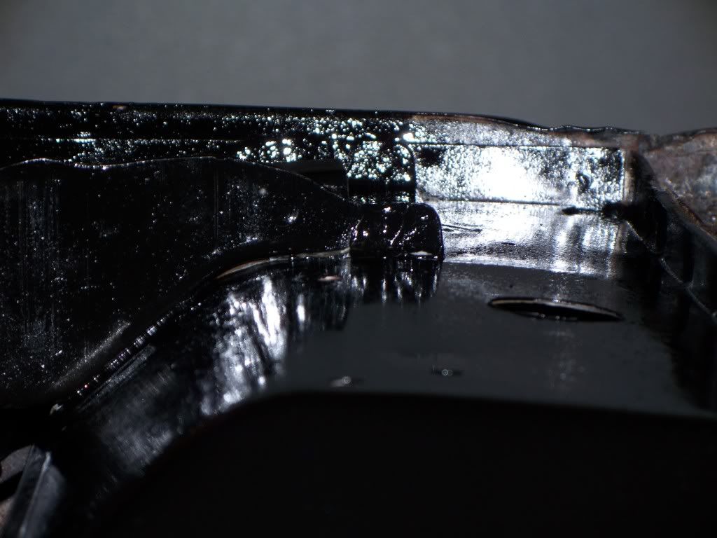

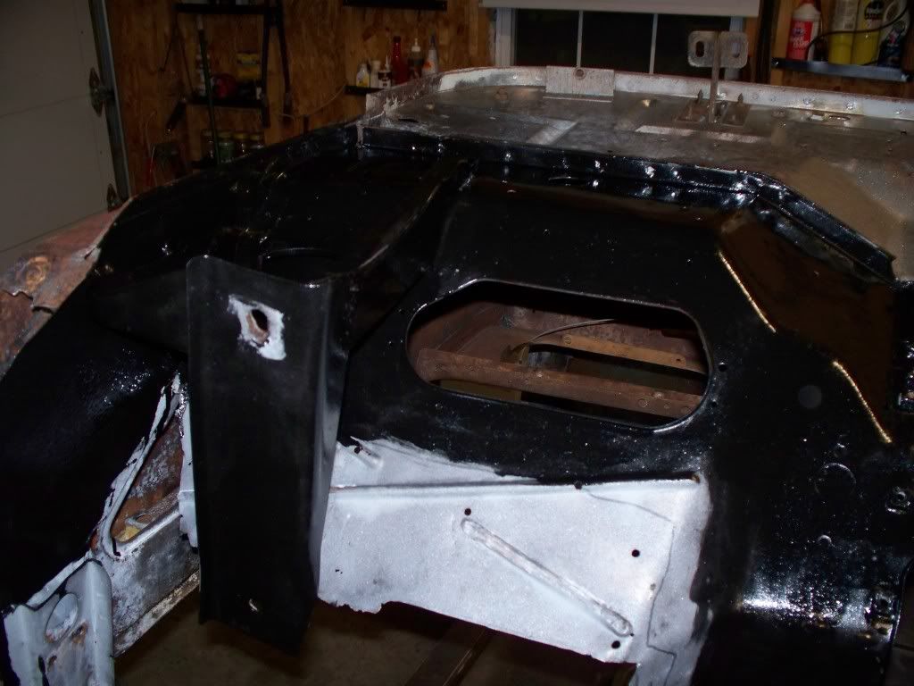

OK I have finally gotten around to using POR on the bottom of the cab...and a lot on myself.
I only applied one coat. I am going to put a truck bed coating on the underside to act as a undercoating. The reason I left some unpainted, and the reason the floor pans are out (again) is because I thought it would be easier to paint the underside of the floor riser, and I left some unpainted, so I can weld the pans back in, without grinding the stuff away. The top half is going to be body color. I also didn't do the rockers because I forgot abut them...
things are coming along slowly now...school, sports, girls...you know but things are coming along!
