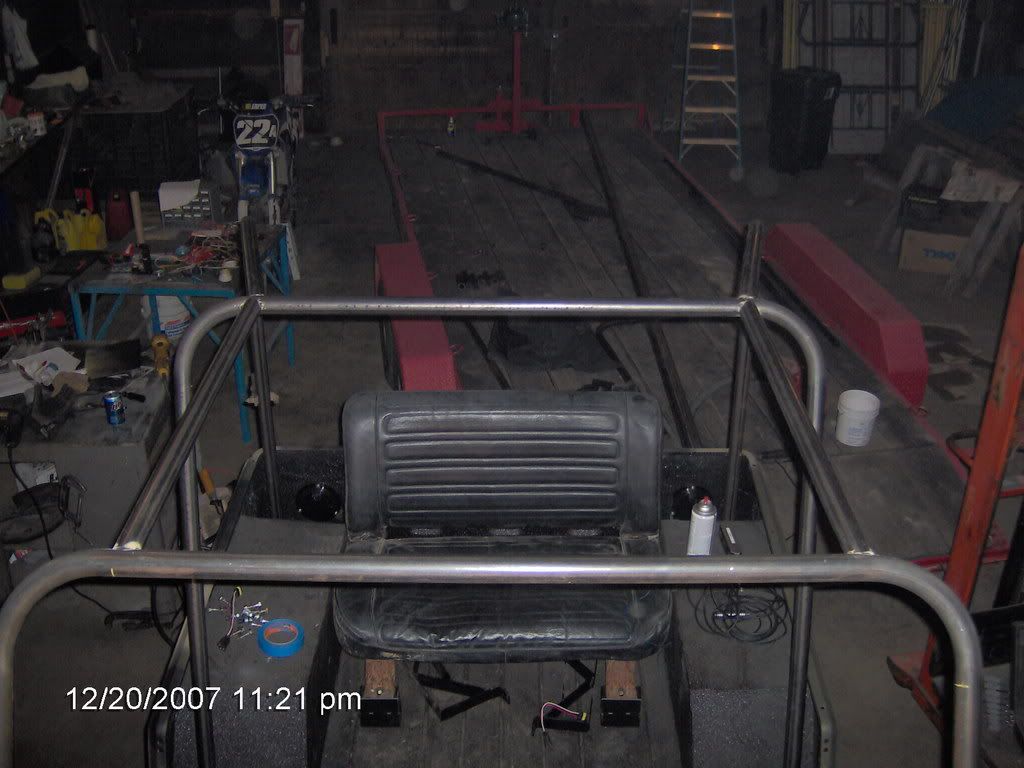

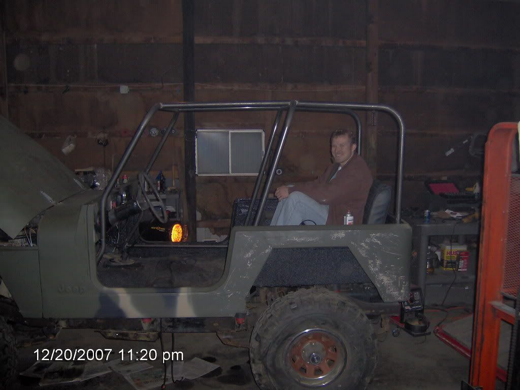

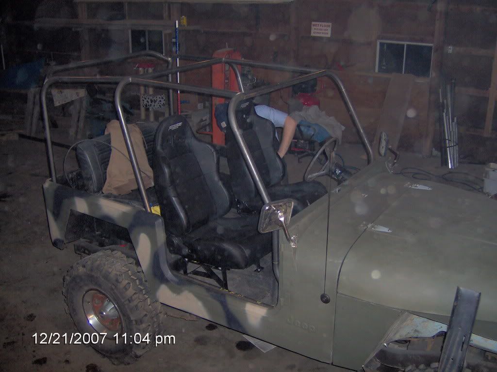

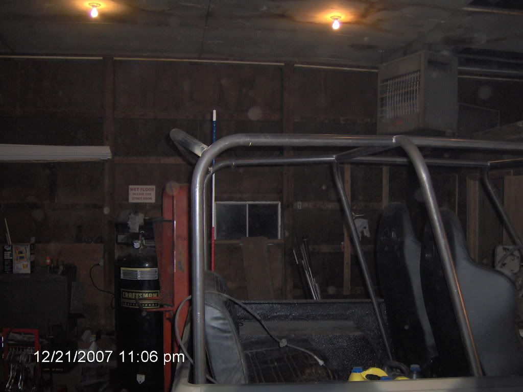

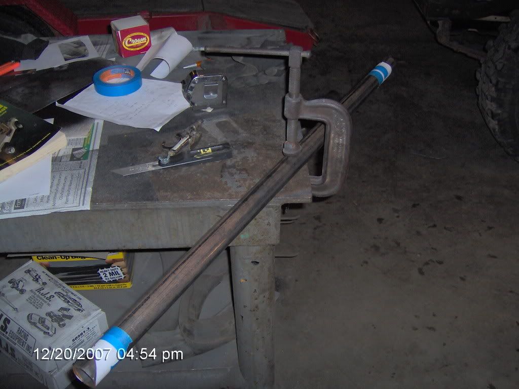

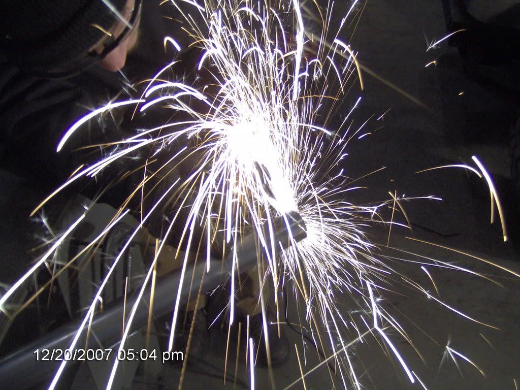

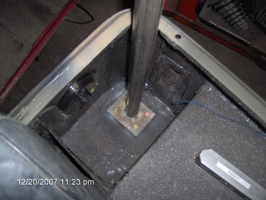

Day 3 on the cage went well. We messed up a measurement on one bend & had to re-do it which is frustrating but no big deal. 30 minutes later, we were still cookin with gas. The "skeleton" is pretty much done. Today is the last day of the build (so tomorrow will be the last day you guys will see pictures in awhile) and we have a lot to get done in a short amount of time. There is no way we're going to get it all done, but we need to at least get all the BENT stuff done b/c I return the borrowed bender today.

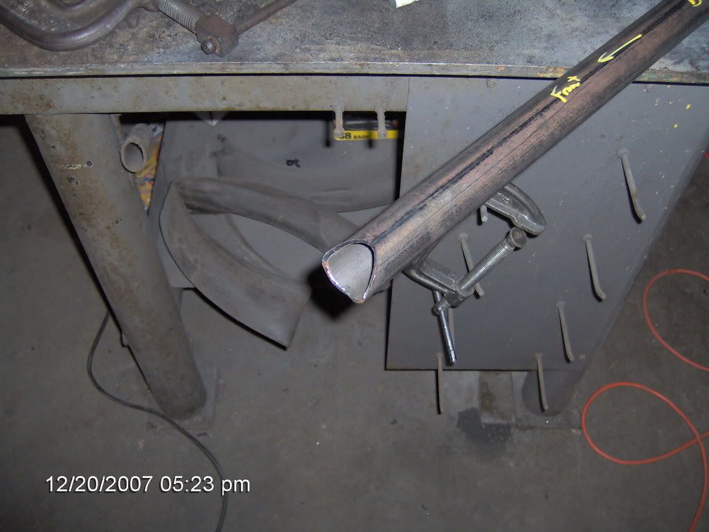

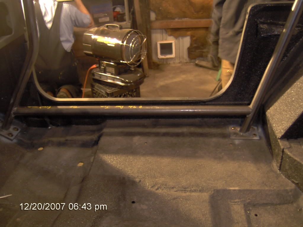

Notchin the door jam bars:
Neat picture...I did all the notchin with cut-off wheels on a 4.5" angle grinder:
Notch done:
Door jams done:
Shootin for 5-6" of head clearance in the back & we got it!
Got the rear part done now too...top view:
Skeleton done!
Cubby holes have shrunk in size:

So with tonight being the last day for the build, we're going to focus on the frame tie-ins, the connectin bar at the very back top corner, & the 2 support bars that run from windshield hoop to middle hoop up at the top because all those bars need bent. All other triangulation is mainly straight bar & I can do that later without a bender.

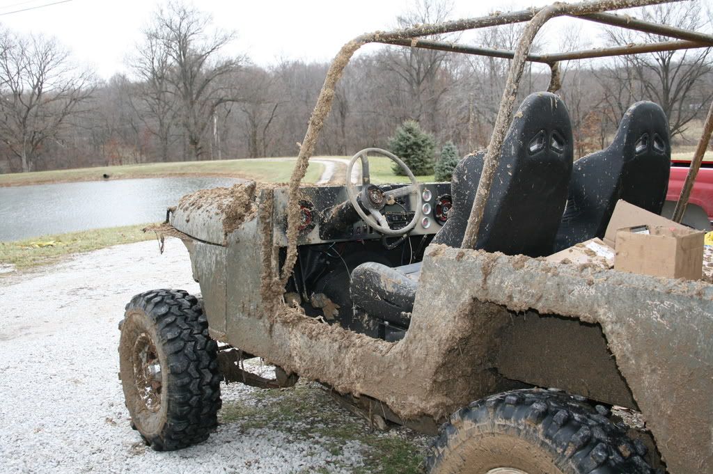

Well last night was the last night I'll get to work on it for awhile. Might have some time to do some things to it over Xmas break....but after that, it's back to school
Pictures won't show that a lot got accomplished but we did get a few things done. Spent a lot of time trying to get it to run right. I'll post that problem in another thread. Still have to make the dash bar, 4-point bar, finish the top pieces, run a few other triangles & weld it all together. It's just tacked right now.
Must've been dusty:
Front view:
Side view of the back connecting bar up at the top...that one was tricky but I like how it turned out:
Well, that's it for now. Hope to have updates sometime in the future. Thanks for all the help & comments.

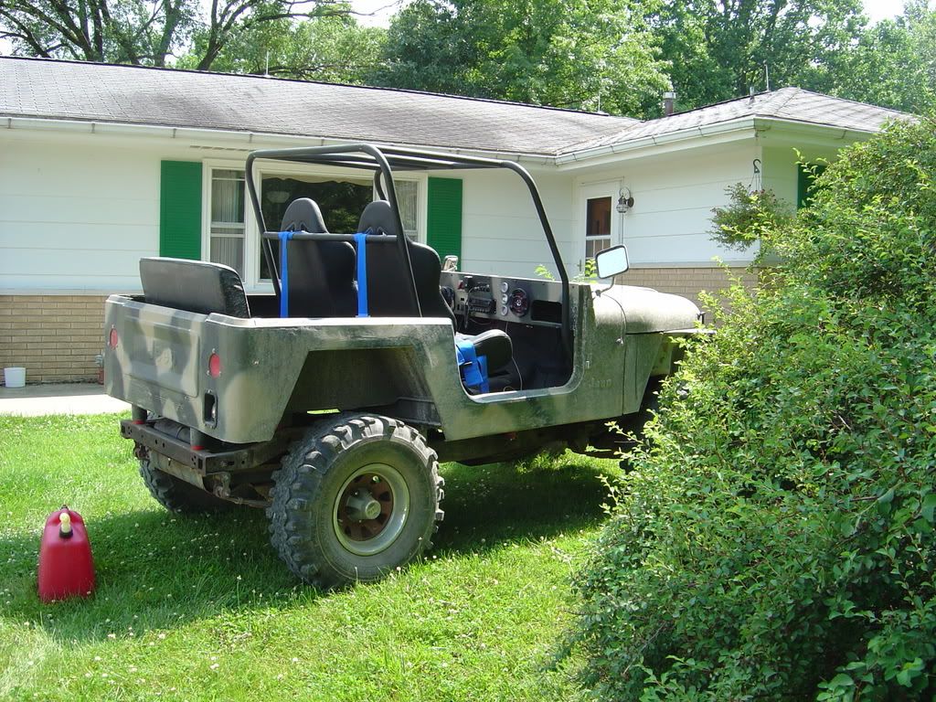

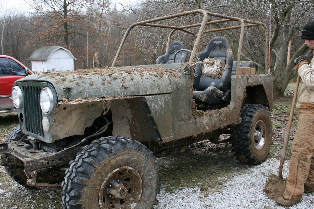

I did make some progress on her over Christmas break. I don't have a lot of the pictures I took due to dial-up internet at home but I'll get them soon hopefully.
Got the rollcage welded up solid and a few more pieces added (i.e. 4-point harness bar & a couple other random bars). Then got it painted with Rustoleum flat black and bolted back in. Will get those pictures up soon....
Here's a couple that I did get uploaded....these were taken before the cage was fully welded/painted/etc...

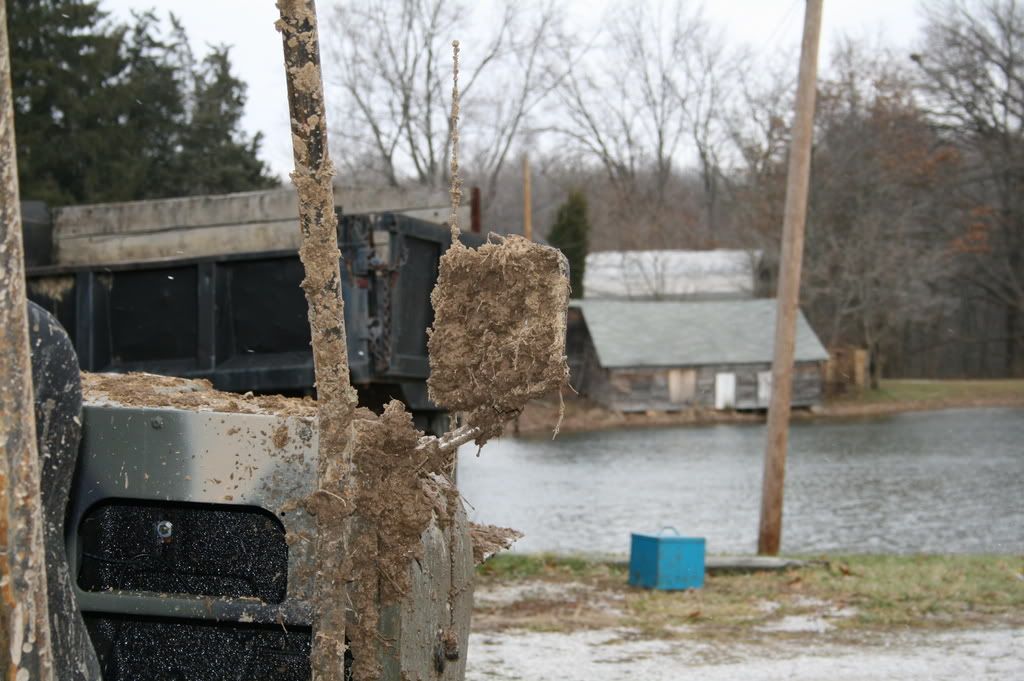

First time out and got it buried.....turns out 4wd isn't workin. Got something wrong with the lockout hubs.....didn't have time to fix them.

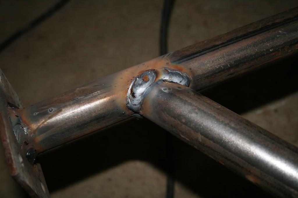

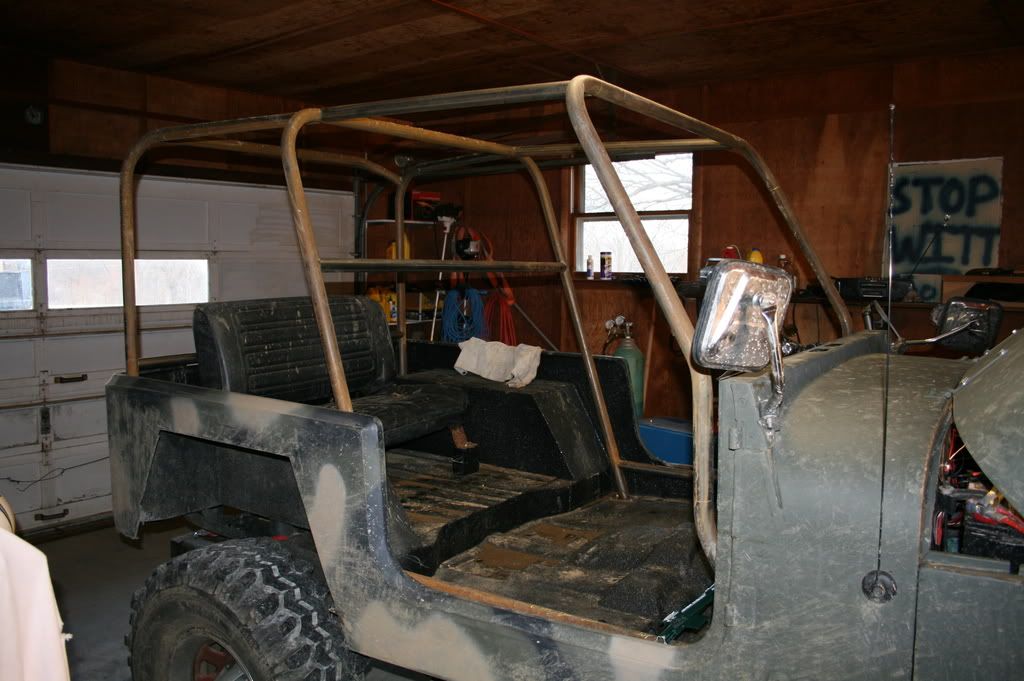

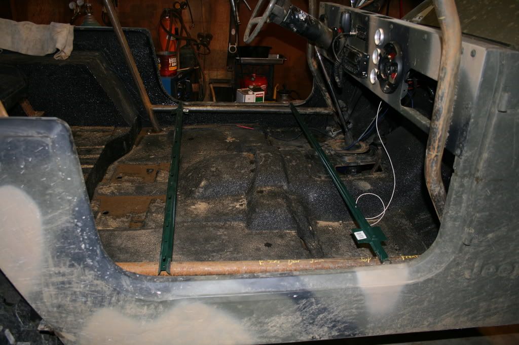

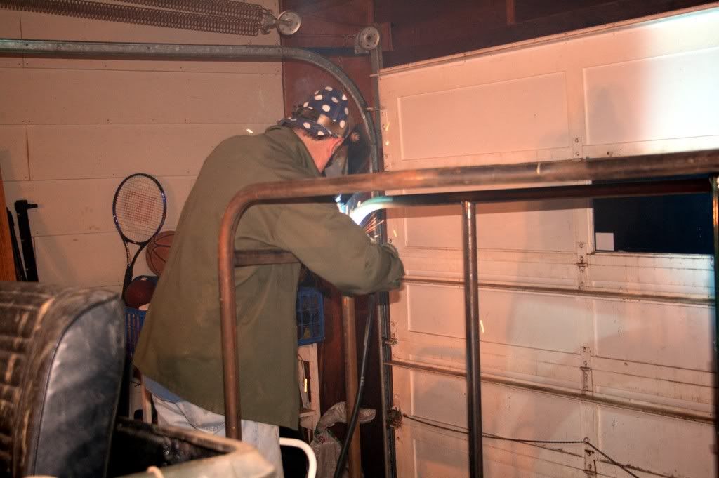

Not really any progress. I'm just never home to work on it...always at school or working. School's rollin along ever so slowly. 3 more semesters 'till that engineering degree (assuming all classes are passed ) and then it will be time to DIG IN!!! I do have the pics where me n Dad welded up the rollcage. He used to weld for a living and has a nice Miller mig so I let him handle the important stuff.

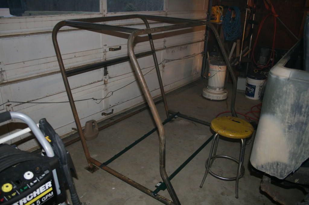

Gettin ready to tear it apart. We were able to remove the whole cage in 2 parts. Where the bars come BACK off the main hoop is where we split it so the whole "front" (from main hoop forward) came off in one piece and then the back piece came off in one part.

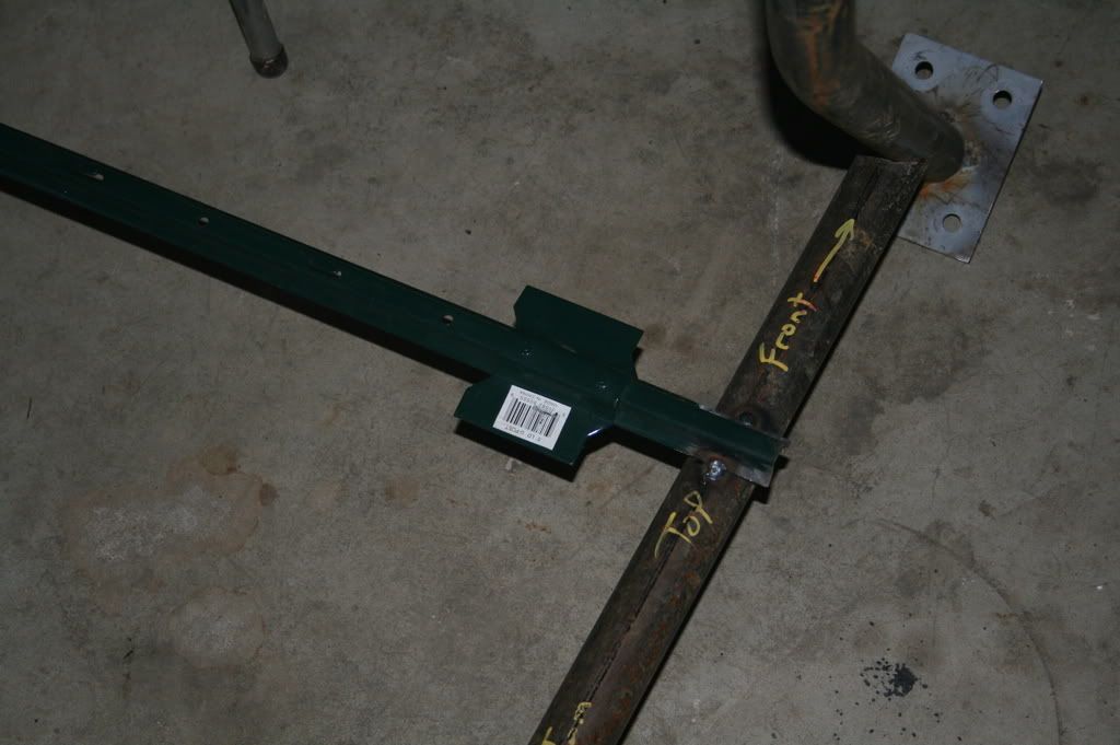

Here we tacked in some fenceposts before removing the cage so it did not twist up too much when we welded it all together just to make sure it would bolt back down when we were done
A better view of the fence post reinforcement:
Another bar that was added running along the bench seat:
There's the front half of the cage about to get welded up:
Dad layin a bead to secure one of the mounting "feet" to one of the uprights
Still weldin....
His disclaimer before he even started was that he hasn't welded consistently for some 15 years so he was WAY out of practice....but I don't think they turned out too bad....

That is coming together very well, your doing a d@mn good job! One thing though and you may have already thought of it, Drain holes? especially in the cubby? Just a thought...Nice work

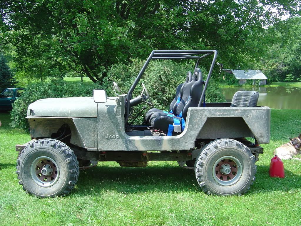

Got her out & drove around the countryside over the July 4th weekend. As you can see, still dont' have the roll cage all the way done. Just am never home to work on it unfortunately, but she is lookin good!!
