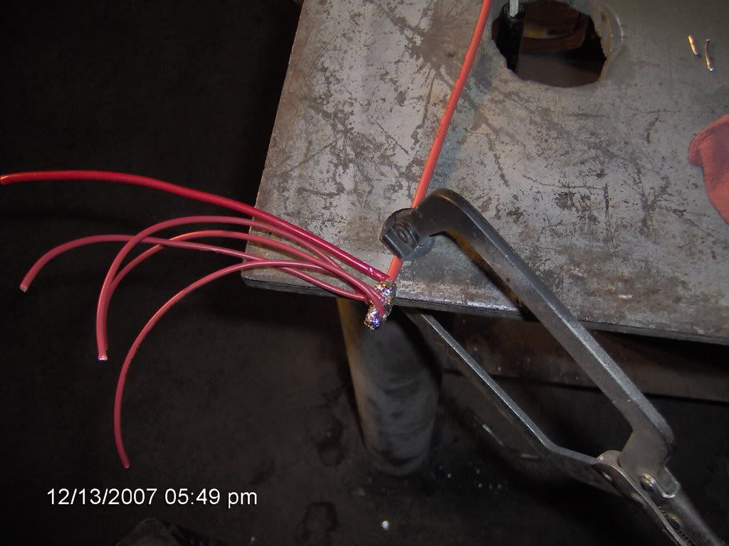

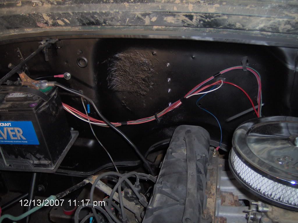

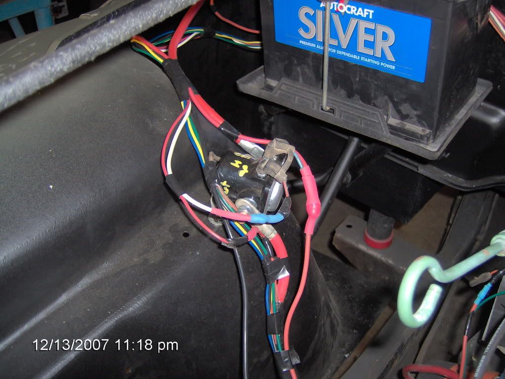

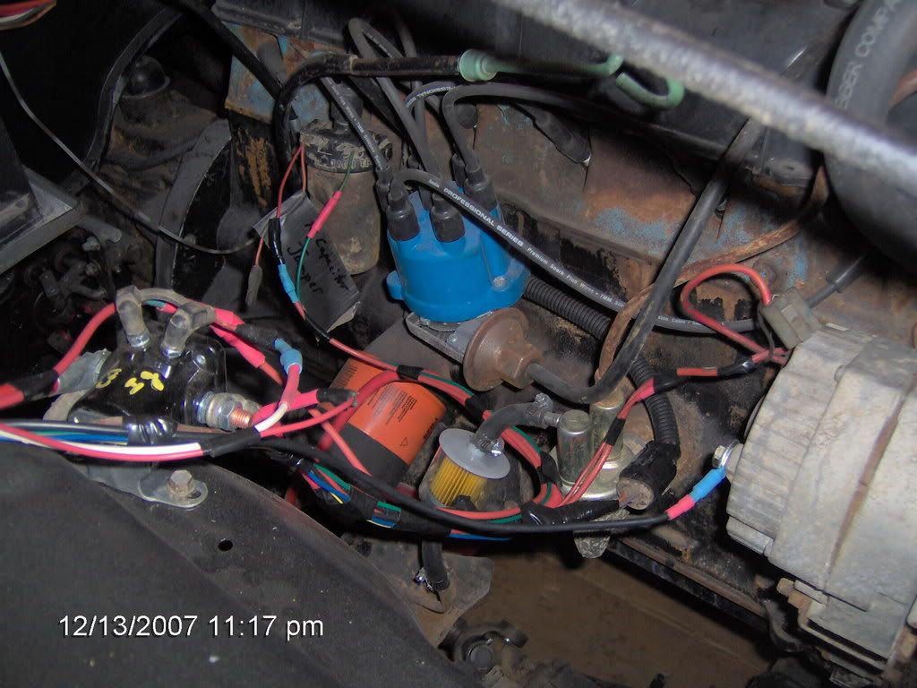

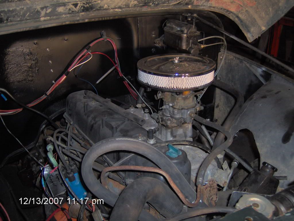

It's ALIVE!!! Last night was very intersesting. Found problems yet found loads of satisfaction. First of all, I was using I think it was JeepHammer's wiring schematic from some other thread on the ignition wiring...basically how to wire up the starting solenoid, battery, coil, & alternator and in the schematic, it indicated you had to use a diode or resistor on terminal #1 (the "excite" terminal) on the alternator.
Well.....i didn't do that and I think I found out why i should. Once I got the engine running, that wire was glowin red...then I tried to shut the engine off & it kept running. Additionally, the computer fried. I had a backup computer so I unplugged the alternator & plugged in the new computer & it runs fine!
Can anybody tell me what exactly was happening there?
Also, tied into the coil cap is a wire that is supposed to go to the "capacitor jumper".....i don't know what to do with this wire...can somebody help?
Last question, the hose that goes to the advance on the distributor...where does it go?

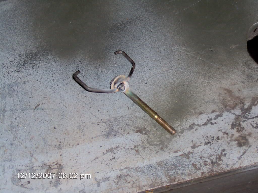

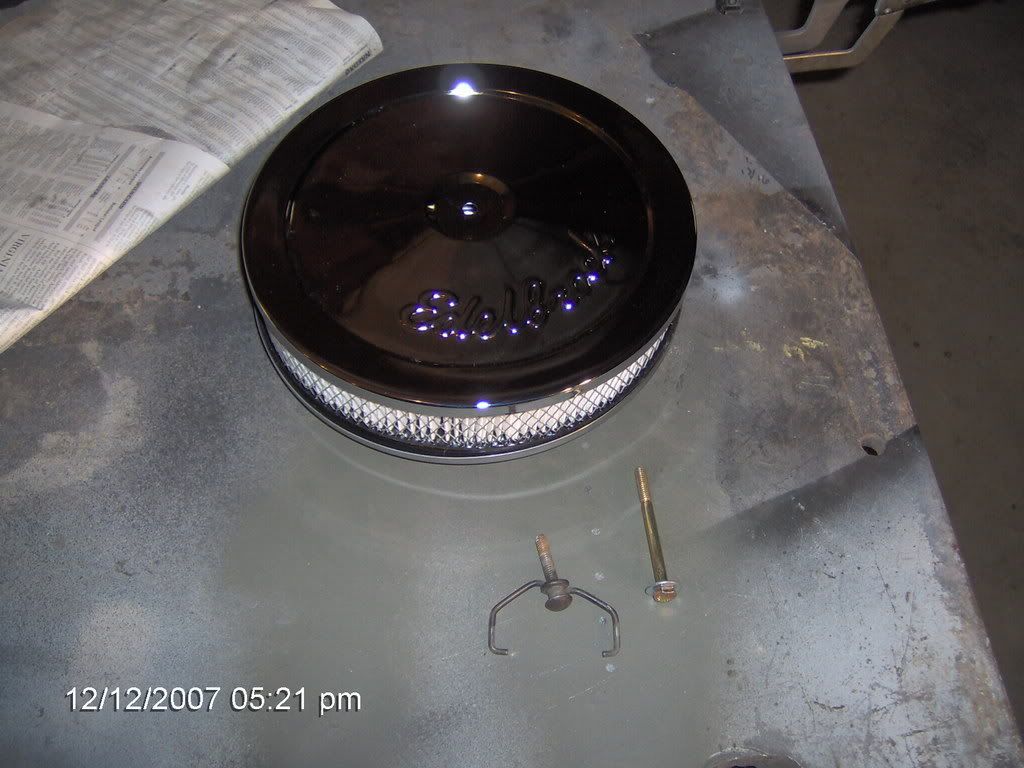

New air cleaner is goin to require a longer bolt....
New bolt welded on:

You can see that "capacitor jumper" wire in this picture...I don't know where it goes?

Engine bay:

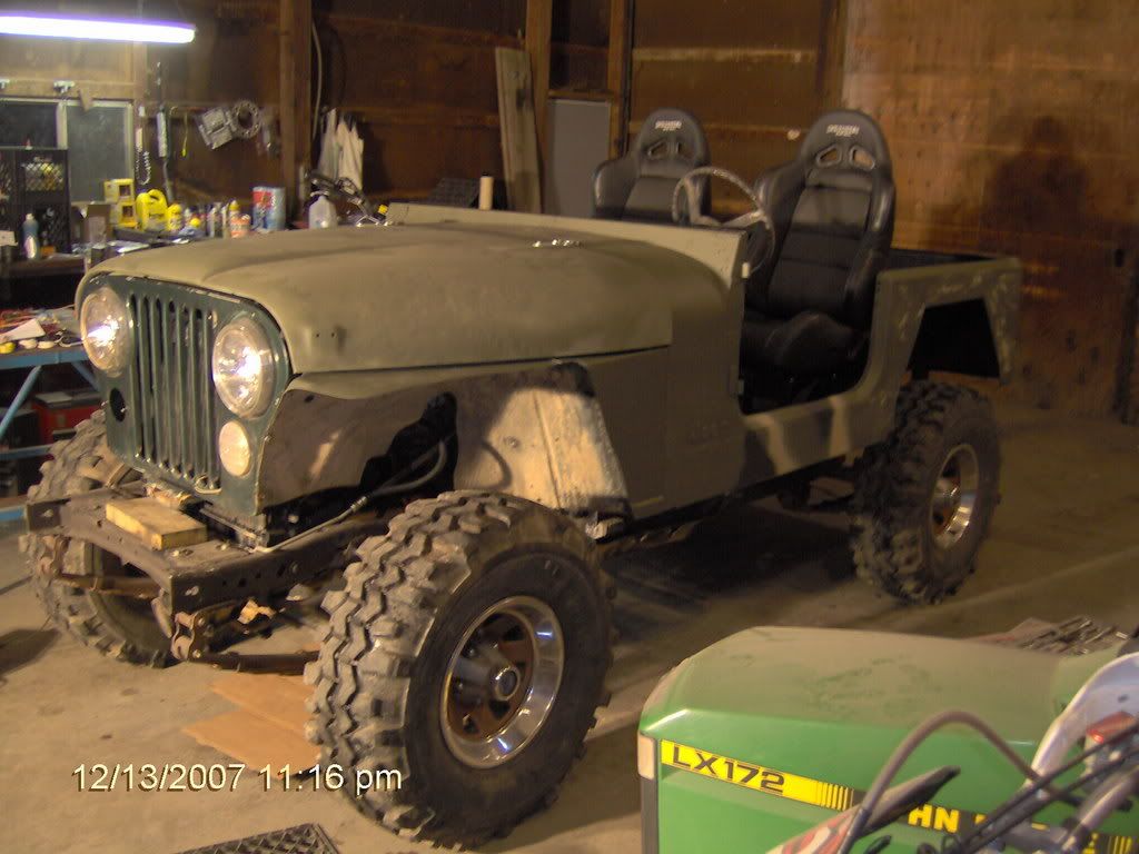

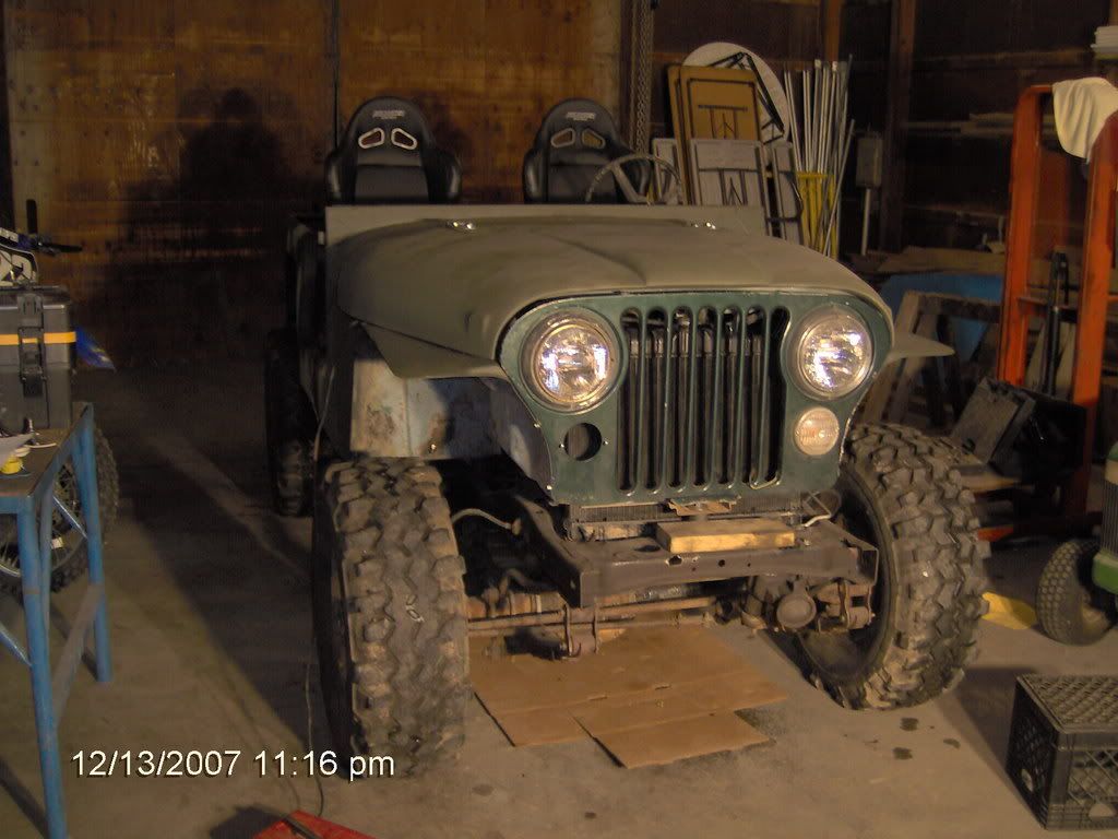

Still need to finish the paint job & paint the grill:

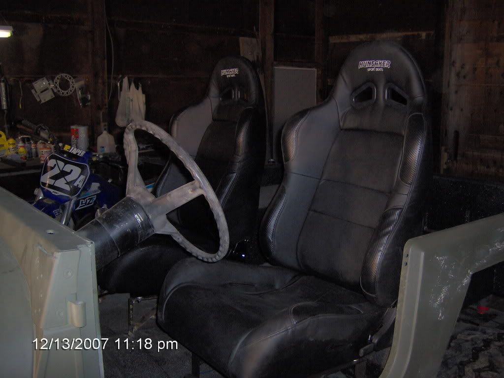

Seats installed...still need to drill holes & install seat belts:

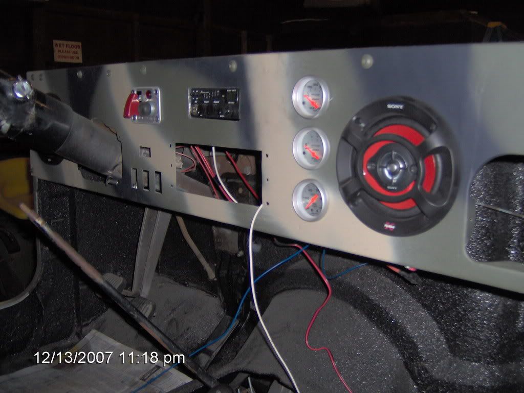

Dash so far...still have to wire up radio, CB, & speakers along with head/tailights:

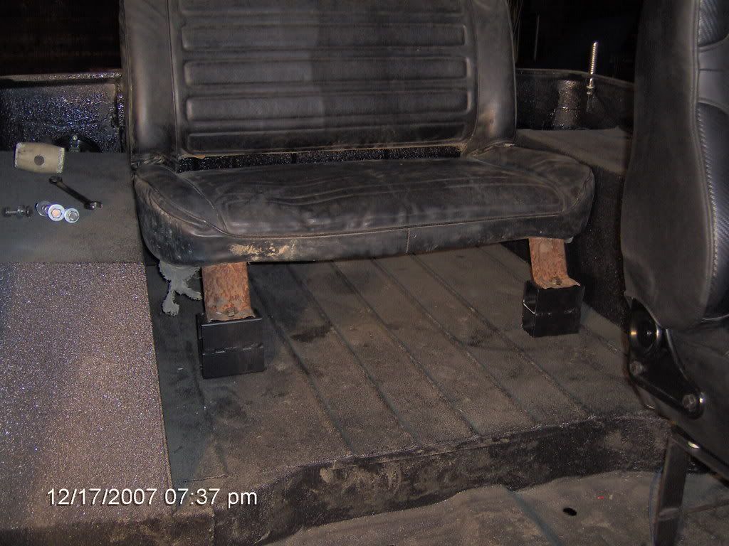

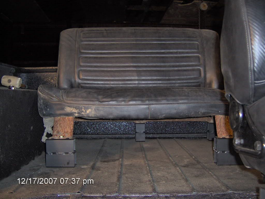

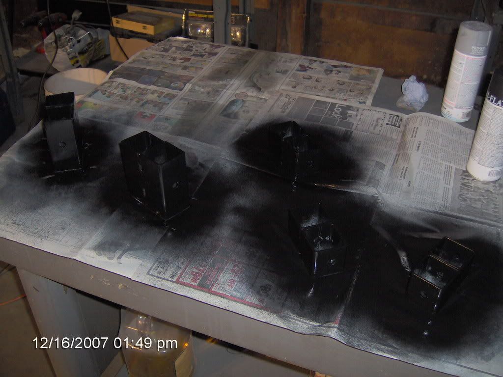

Got the rear seat brackets done. Had to raise the rear seat so people back there could see b/c the front seats are so high. Raisin it 4" so they'll have a good view. Plus, it makes room to store stuff underneath the seat.
All it is is 2X2 square tubing cut to length & welded together for 4" of lift:

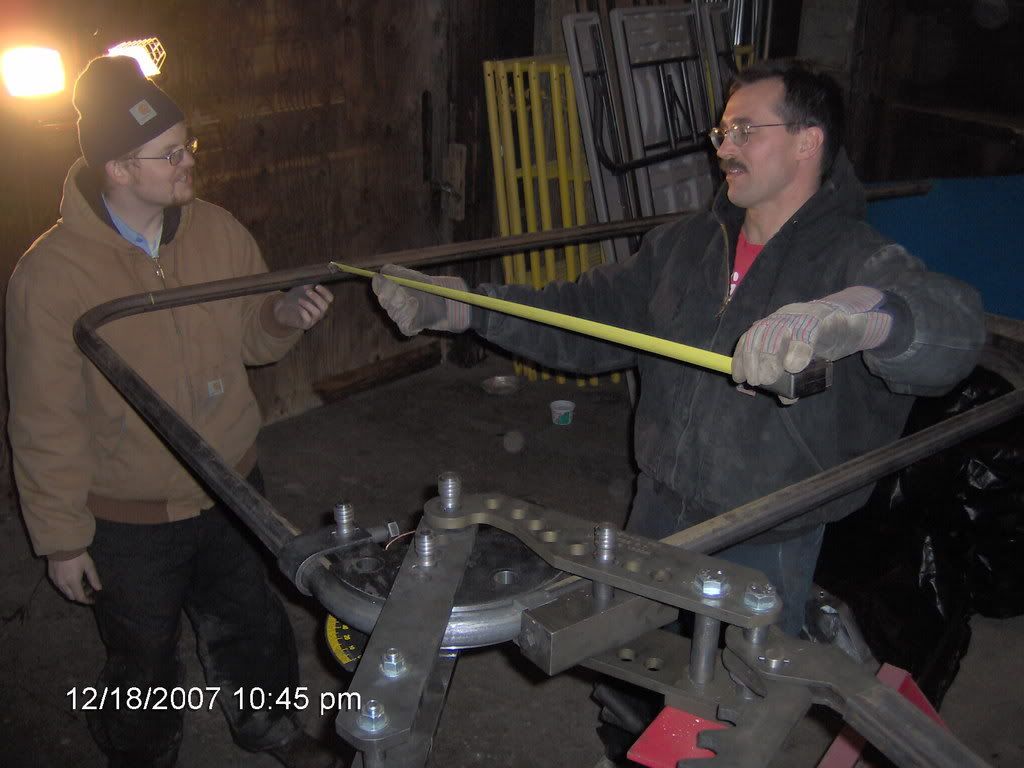

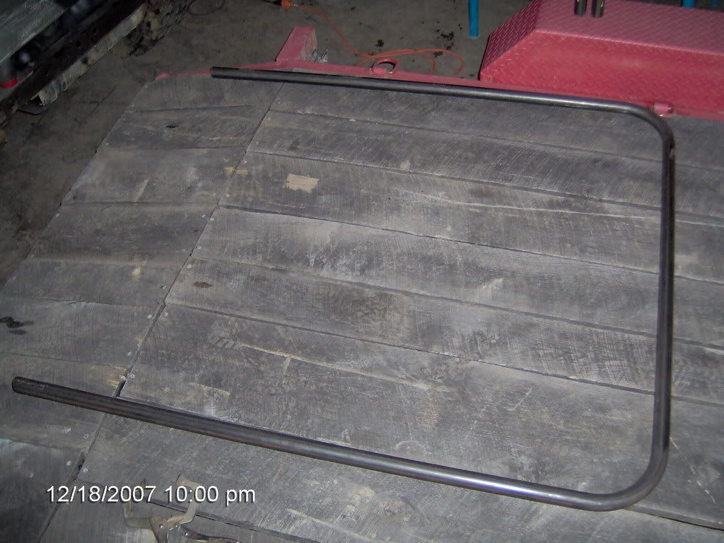

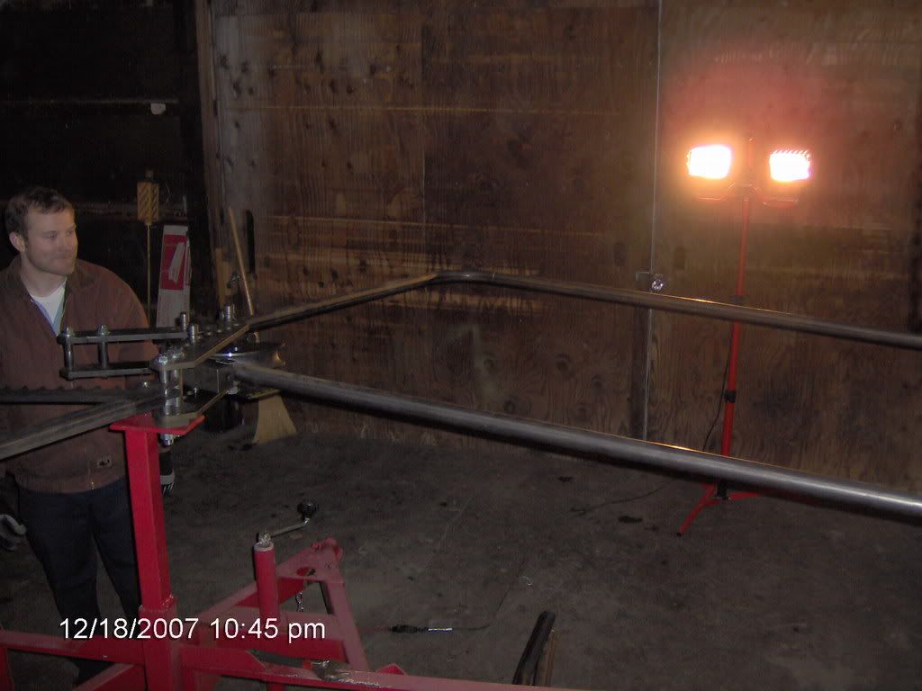

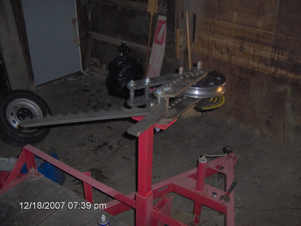

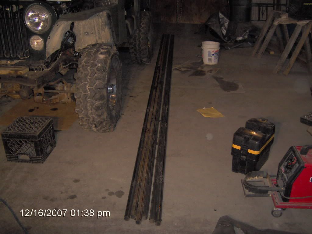

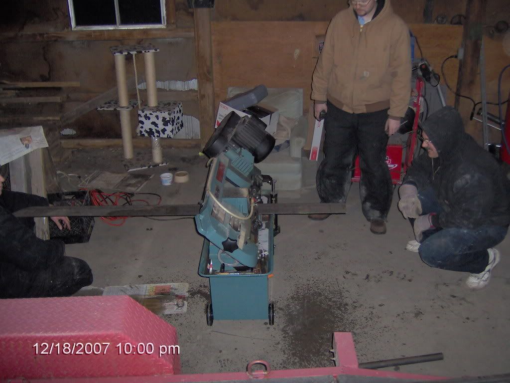

Well, we started makin the rollcage last night. I had to recruit a couple friends for this one....Those 21 footers are hard to maneuver in a barn & would be impossible to get in the bender by yourself! It was a blast though. It took us 3 tries to get a 90 deg. bend in the spot that we wanted....but we got er dun.
The bender....a Model 3. Mechanical but works plenty well:
Our first 90* bend where we wanted it!
The first hoop....it'll be the middle hoop (right behind the front seats). Nice & square and within 1/4" of the outside width we were shootin for:

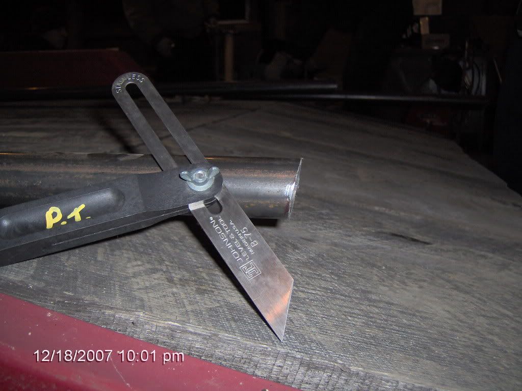

Usin this nifty little tool to cut the base at an angle where it will be mounted to the base plate:

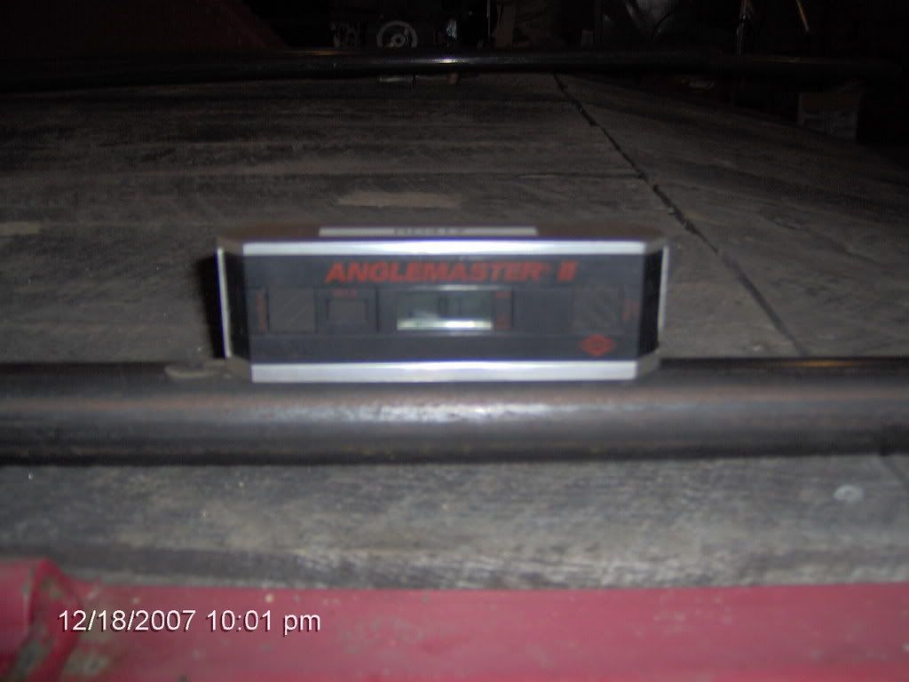

This tool is VERY helpful. It's an angle finder that you can zero whereever you want. Worked best when were bending perpendicular to the hoop (i.e. windshield hoop)
Cuttin the 3/16 plate for base plates:
Hoop up in the bender:
Makin sure it's square:

Puttin the 3rd & 4th bends in the hoop...this is where it got interesting!!!
4 bends done, 2 to go:
That's as far as we got last night but that's a huge step of progress there. To get all the calculations done of the angles of the hoops & determine the heights of the hoops and where the bends needed to be, etc, etc, etc is very tedious and time consuming but will hopefully be well worth it!
We'll be at it again tonight.....then Wed. night....and hopefully have it done by Thursday night. That's the absolute deadline..Thurs. night. Feels like we're on Overhaulin' or somethin where they have those deadlines they have to meet.

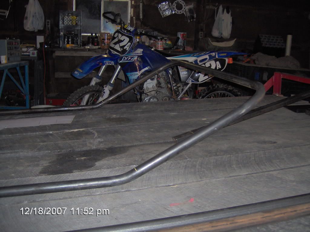

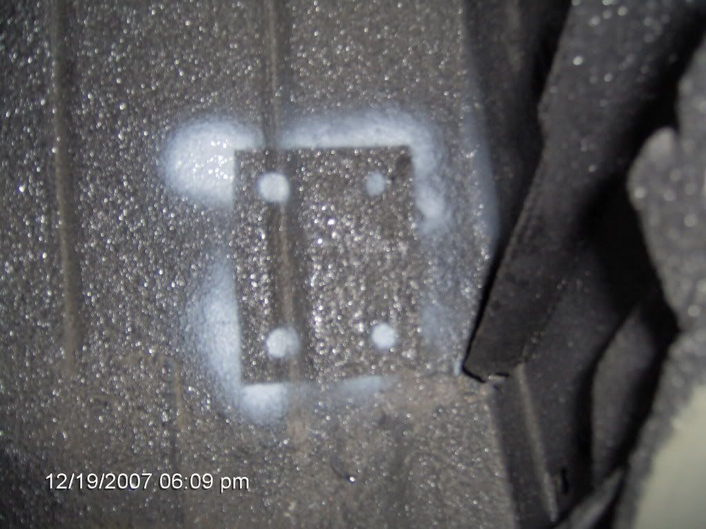

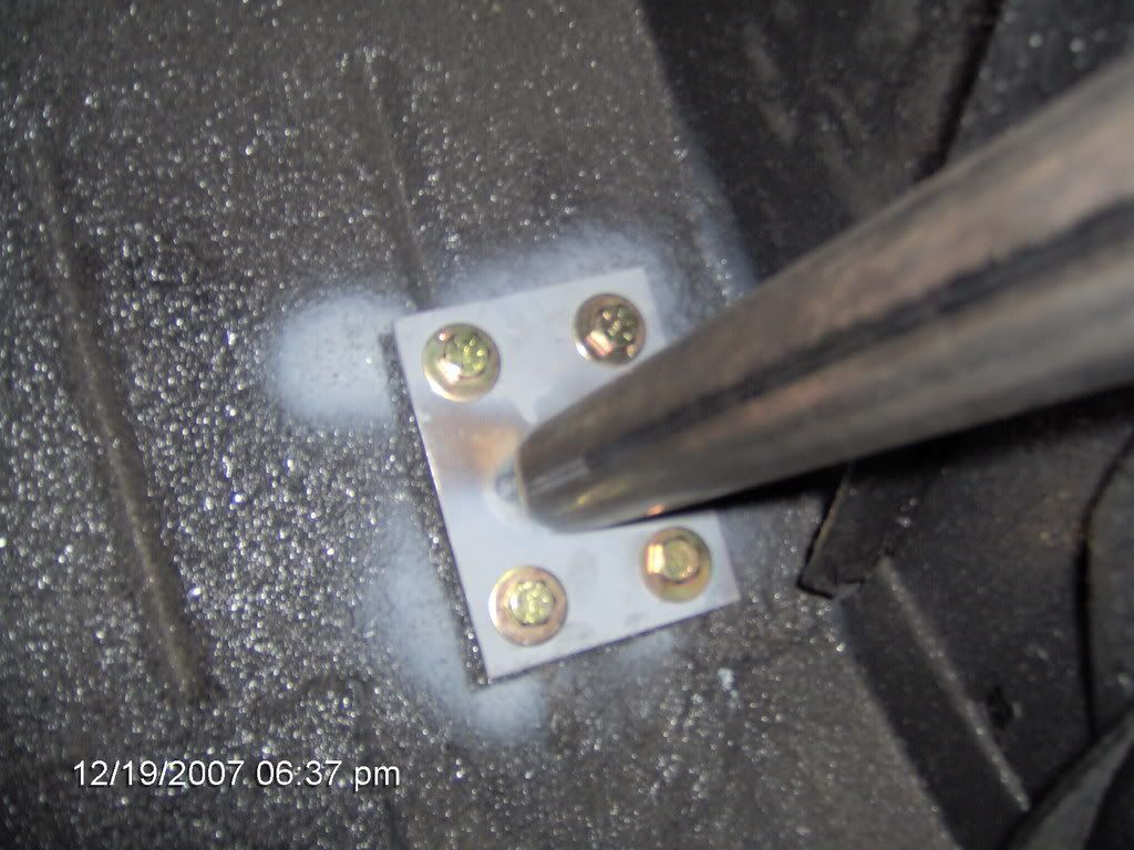

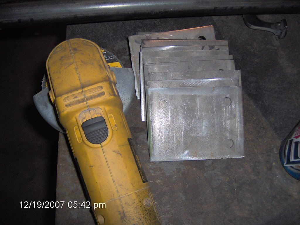

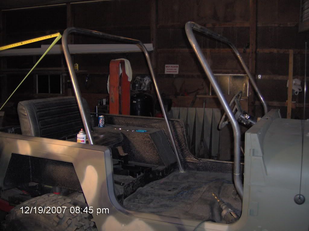

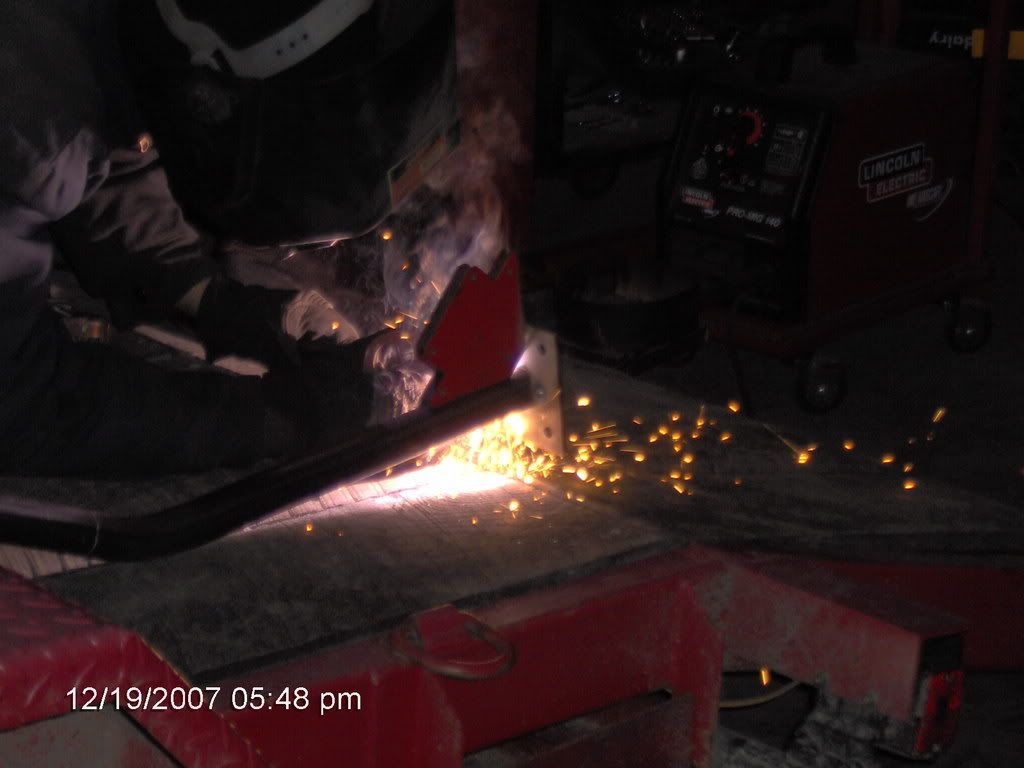

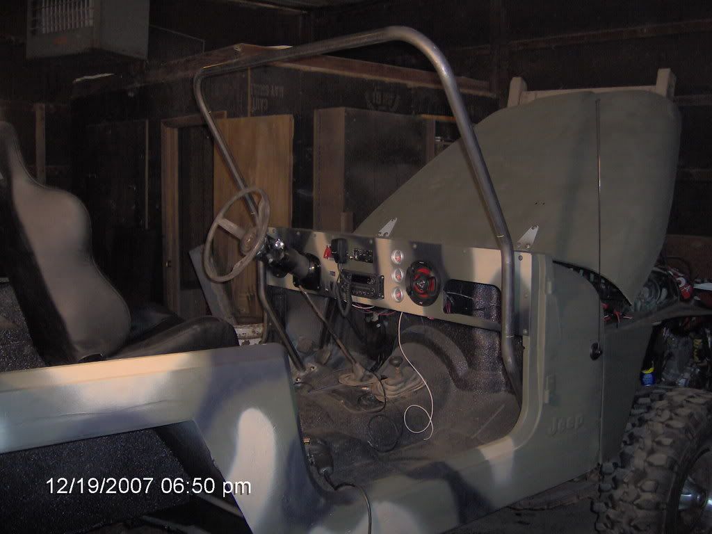

Roll cage day 2 went pretty well. It's actually starting to look like a cage now. The windshield hoop turned out really well...we were shocked we got it as square & level as we did. We were off 1/2* here. and 1/8" there but nothing you can't tweak by pullin on it just a little bit.
Windshield hoop done:
12 base plates....6 on the top & 6 on the bottom for frame tie ins:
Tackin the base plates to the windshield hoop:
Got the windshield hoop where we wanted then marked the holes to be drilled by using spray paint:
Windshield hoop bolted down:
Still makes me smile:
Middle hoop installed. We wanted a 4" rise to the middle hoop...and we were pretty darn close:

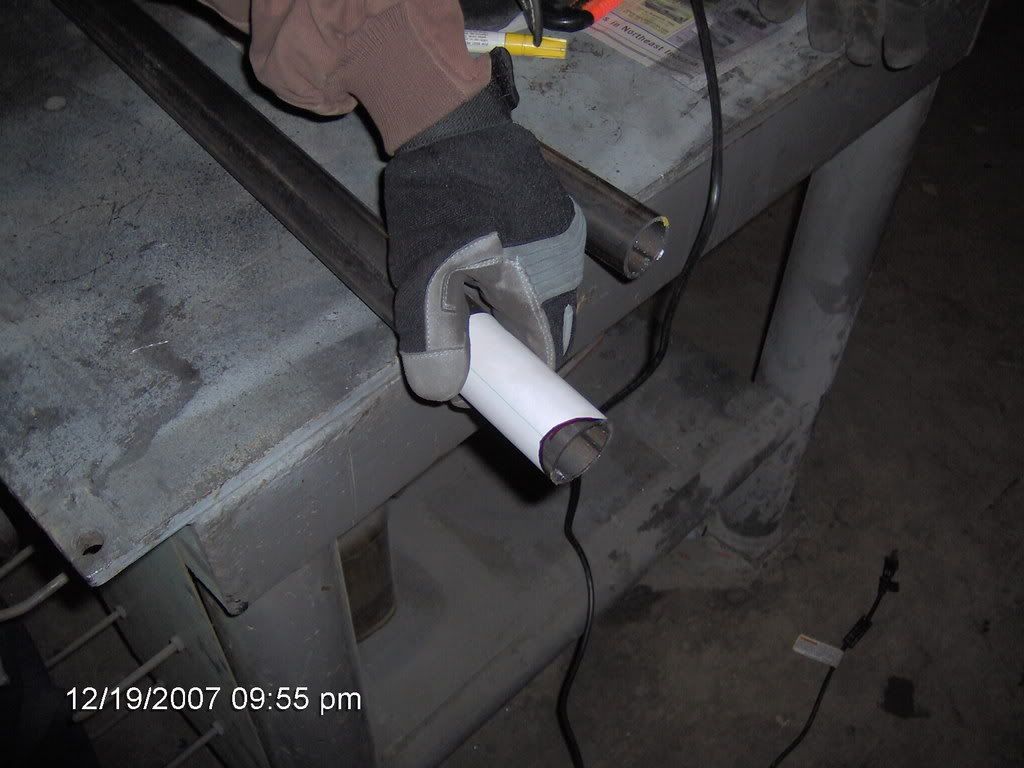

Notchin some tube:
We were shootin for 6" of head clearance and got 5.5"....I'll take it!

Startin to look like a cage:
