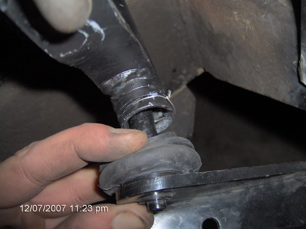

One last thing on the clutch linkage...there was a guy posted something the other day about those clips that keep the blushings from coming out...he was looking for an alternative b/c he couldn't find the clips anywhere. Well, I ran into a similar problem....it took me forever to figure out that those bloody clips go on the OUTSIDE of the bellcrank. I spent forever trying to foce those things in like an internal snap ring and by the time I had it figured out, I had broke one of the clips....SOOOO safety wire it is.

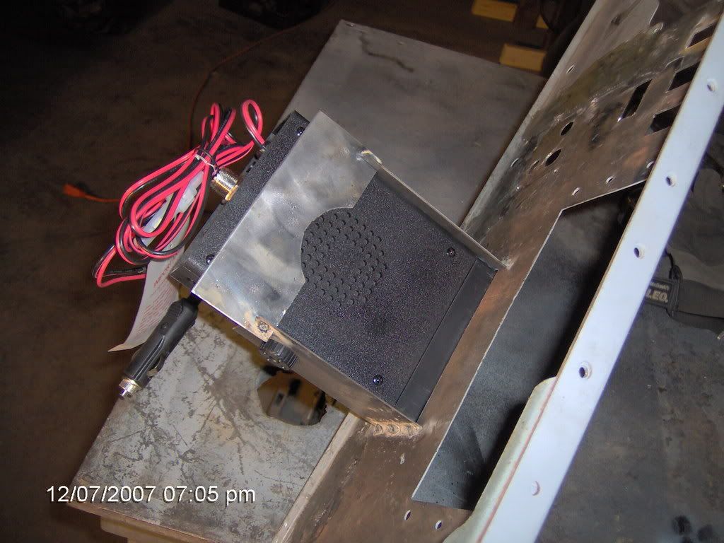

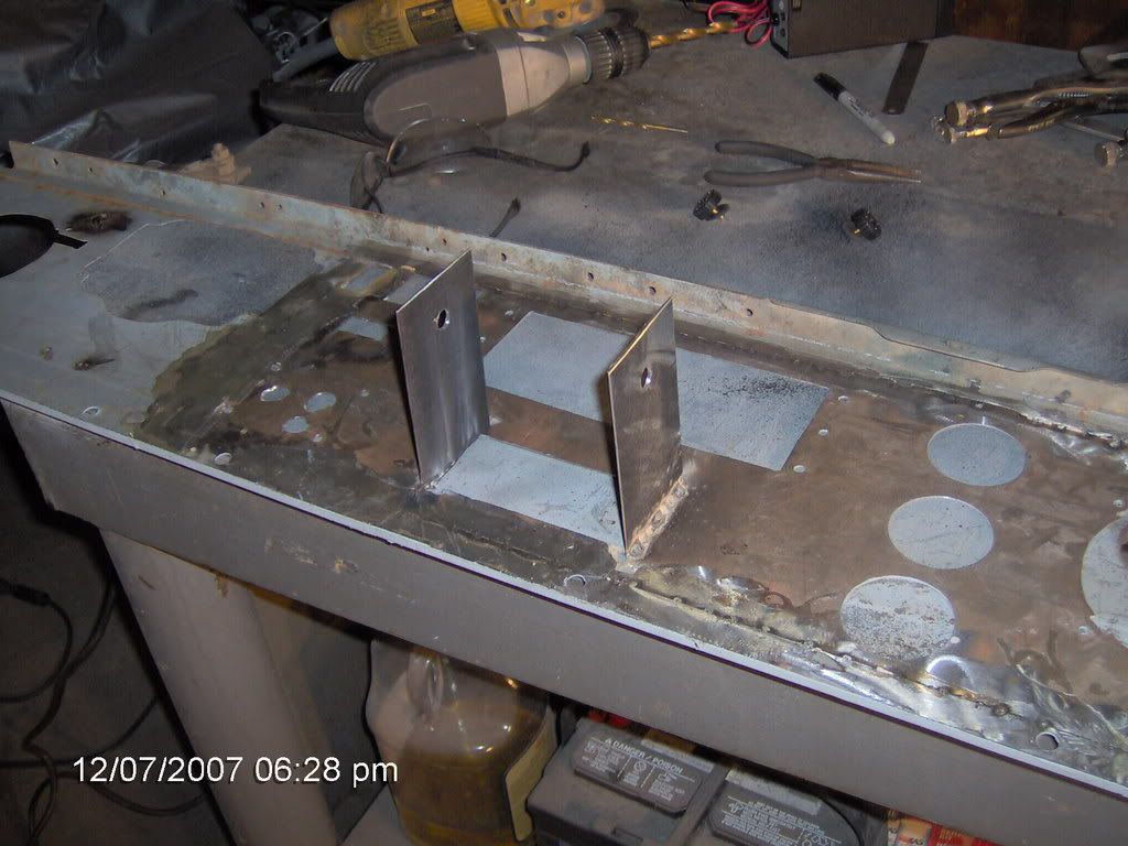

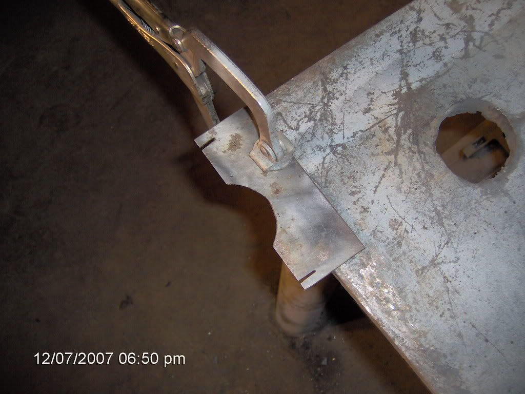

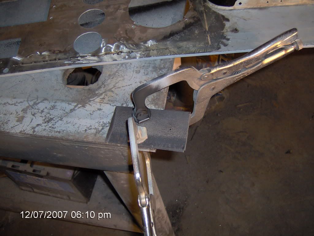

Making brackets to flushmount the CB into the dash:
Gettin a little too fancy for my own good:
CB mount done:
Now you see why I was gettin "fancy"...the semi-circle is so it's not blocking the speaker (even though i have an external speaker for it)...and I cut the slots so it slides onto the other 2 braces so I had something a little better to weld to:
Dash done!

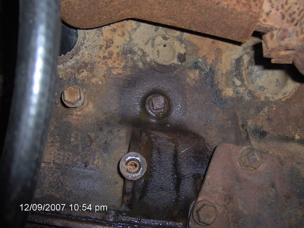

And of course my little discover in case you guys didn't see it on the other thread "Cracked block." There's about a .5-.75" crack headed straight "north" from the block drain plug hole. Still debating what to try first to fix it:

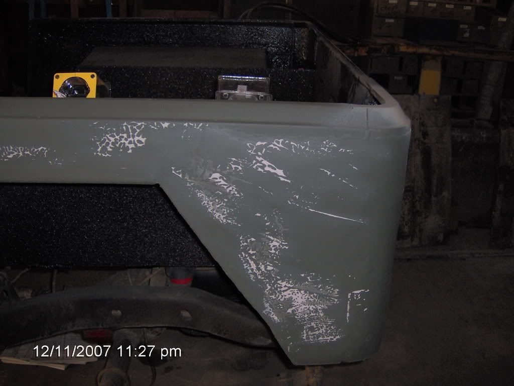

One question for you guys: I noticed that recently all my paint is flaking off real bad but only on the spots where there is bondo. Does Rustoleum primer not stick to bondo? What else would be causing it? Did I paint when it was too cold? Did the bondo just "settle"? Any help? Thanks!

How thick was the bondo? If you lay it on more than say 1/8", it'll shrink too much and the paint will crack. If you have to go thick, put several thin coats on, making sure each coat is dry before applying the next coat.

I hope you're right! Bondo is more than 1/8" thick in most places so I'm just gonna scrap all the flakes off, resand, & re-paint....another benefit of using spray paint!!!

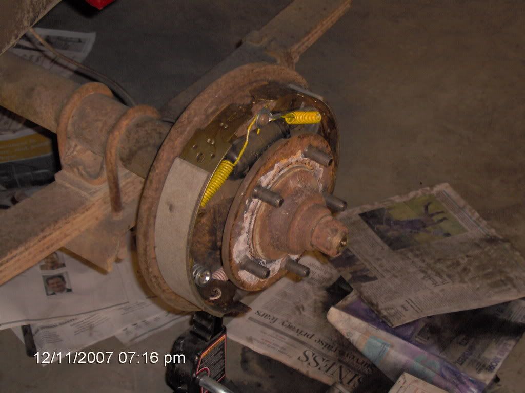

Progress is coming in leaps & bounds now boys...she's on a roll!!! the light at the end of the tunnel is gettin brighter! Got the new rear drum brakes installed last night. Had to replace everything, they were shot! All the springs, adj. cable, wheel cylinders, shoes, lines...and then it took about 1.5 hours but after pumping & pumping & pumping...then open bleeder, close bleeder, repeat 500X, we finally got PRESSURE!!! Huge hurdle tackled....I was very relieved when I couldn't push the pedal to the floor anymore. Remember, this chassis came off ebay from who knows where and THEN sat outside in the weather for a year so to get the brakes to work is in short order of a miracle!!

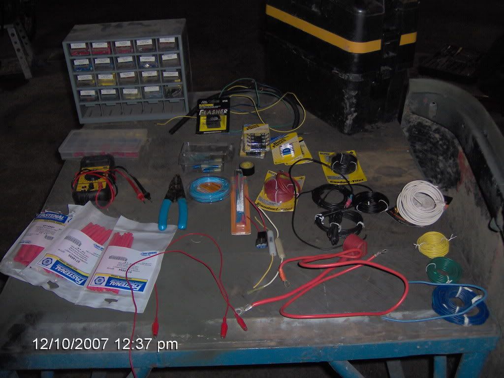

Wiring is coming along nicely...lots of soldering & heat shrinking but I like wiring so it's fun.
Getting everything ready to go to electrical war:

Pictures of the flaking paint:

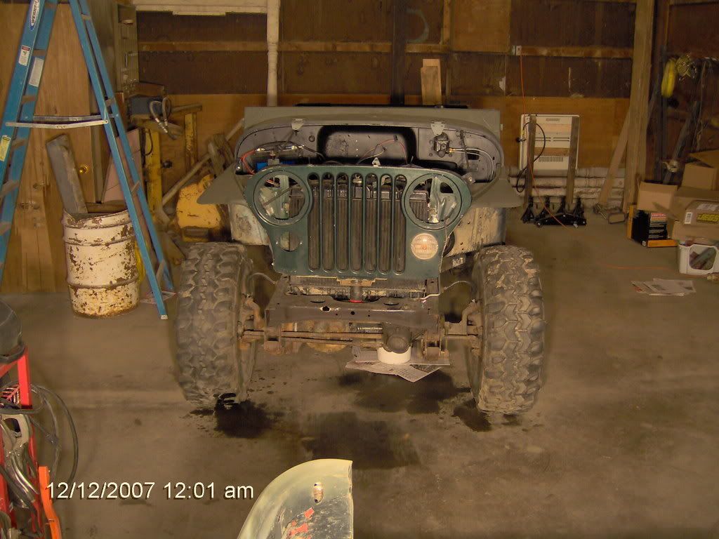

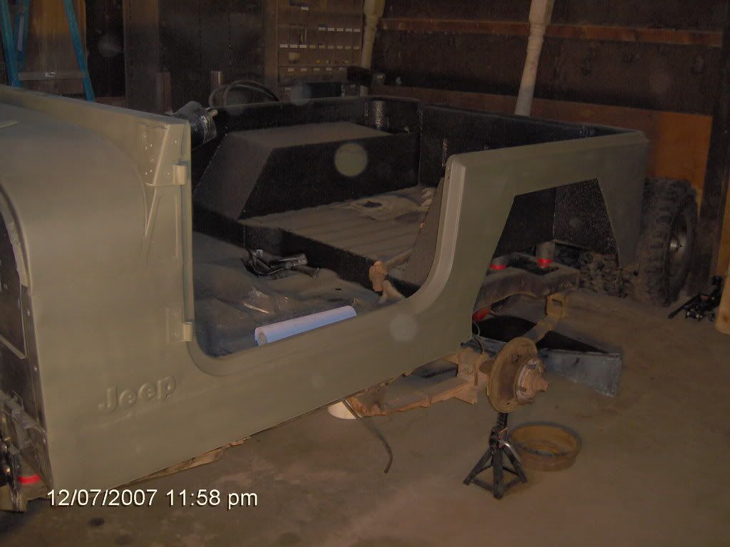

New fender style!
She's startin' to look mean:

Looks great. I get confused about which color is in which hand when I do it that way so I just do one color at a time. As for the Bond a good primer should help. The rest looks great. Just wondering why you didn't get a preassembled wiring kit. Wouldn't that have been much easier than doing your own harness? Just wondering.
Reason #1: Of a whole stock wiring harness, all I need (LITERALLY) is wiring for head, park, & tailights (2 wires length of tub), fuse block, engine control wiring. That accounts for maybe 40% of a stock wiring harness. The rest is for a bunch of junk I don't need like dash lights & heater controls, horn, safety switches, reverse light, indicators, etc, etc...
Rearon #2: My old harness was shot...shorted several places & melted wires left & right. So new harness: $150ish. My harness: $30 in wire + $4 in solder + $10 in heat shrink + $5 worth of electrical connectors + $10 worth fuses & fuse block + time = much cheaper without all the wires I don't need.
Reason #3: With my dash being custom, I would've had a lot of additional wiring to the stock harness anyway. 2 speakers, a radio out of an '02 TJ, a CB, 4 rocker switches, & 3 AutoMeter gauges so basically, I would've used a $150 stock harness just for the fuse block, wiring for the head/tailights, & some of the ignition stuff.
Yea, it might've been easier but I enjoy wiring....I like making it clean and taking my time making all the connections good with solder, heat shrink, & elec. tape & being able to run the wires however I want to. So to me, it was an easy decision. If I hadn't set the time aside to do it, then it would've been a problem. Plus, once you see my ignition, you'll understand....patience, pictures to come soon!
