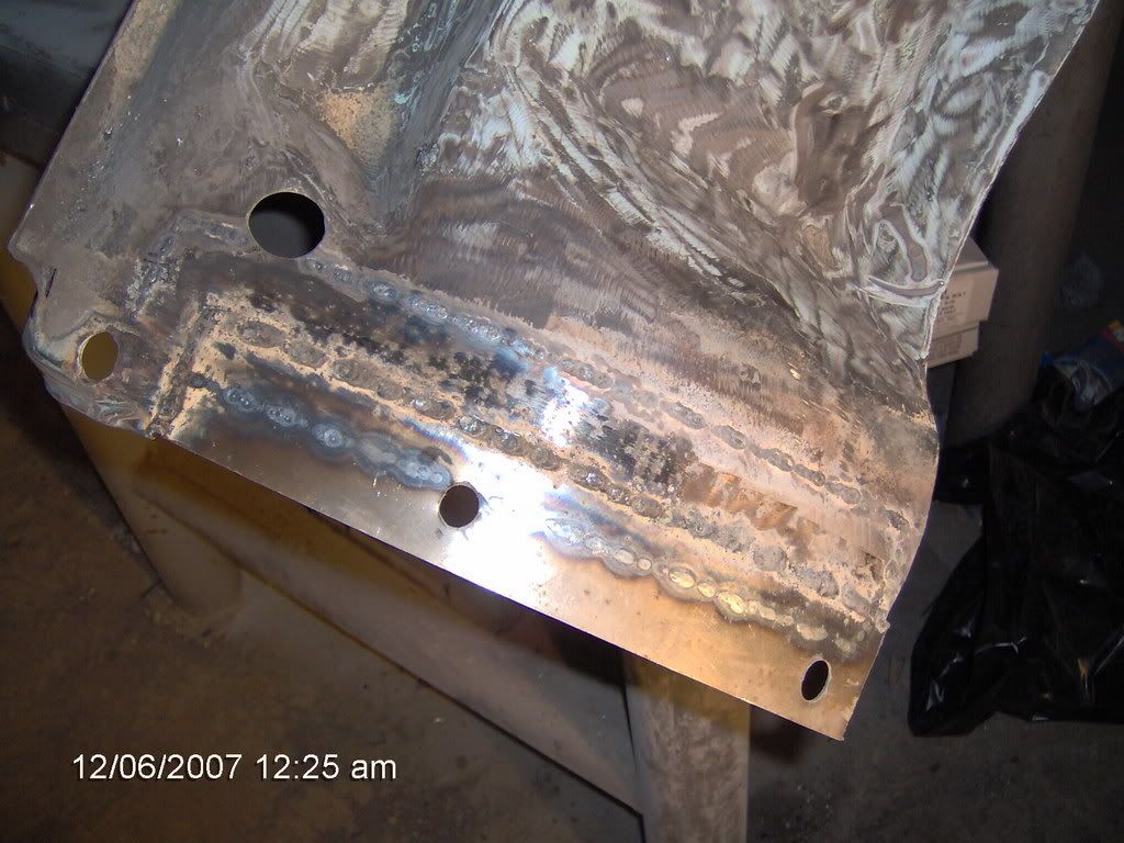

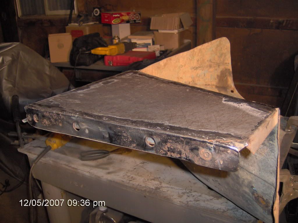

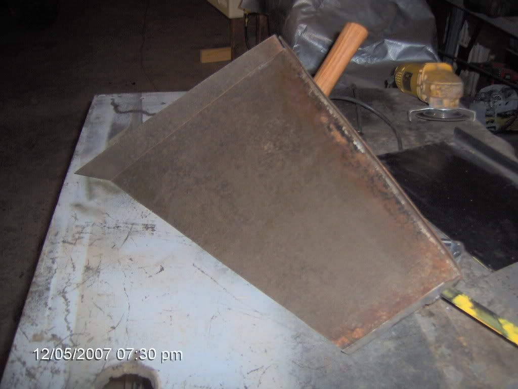

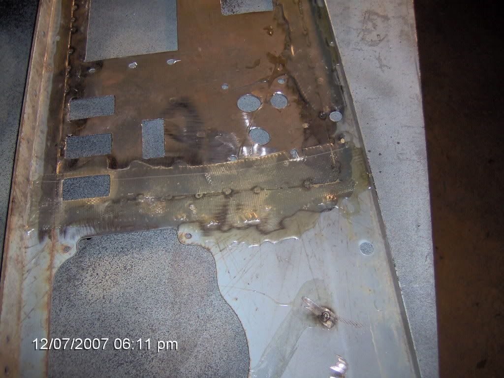

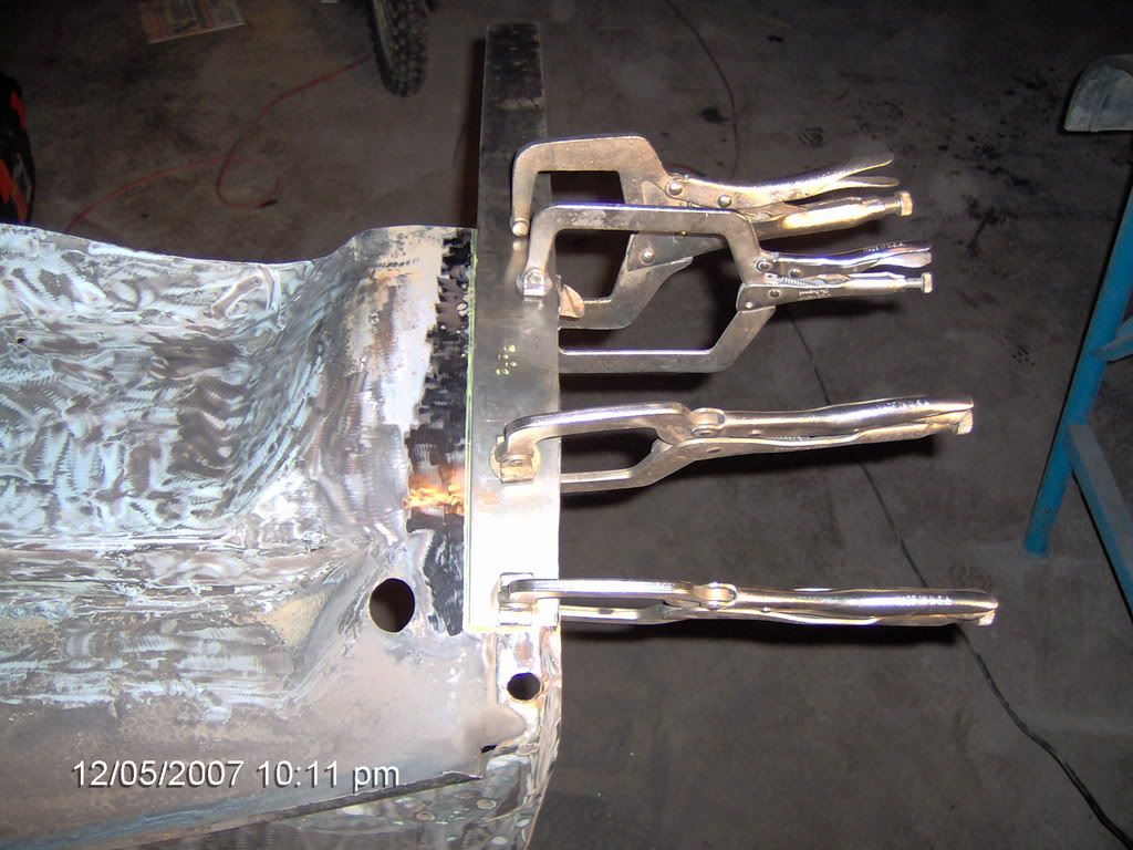

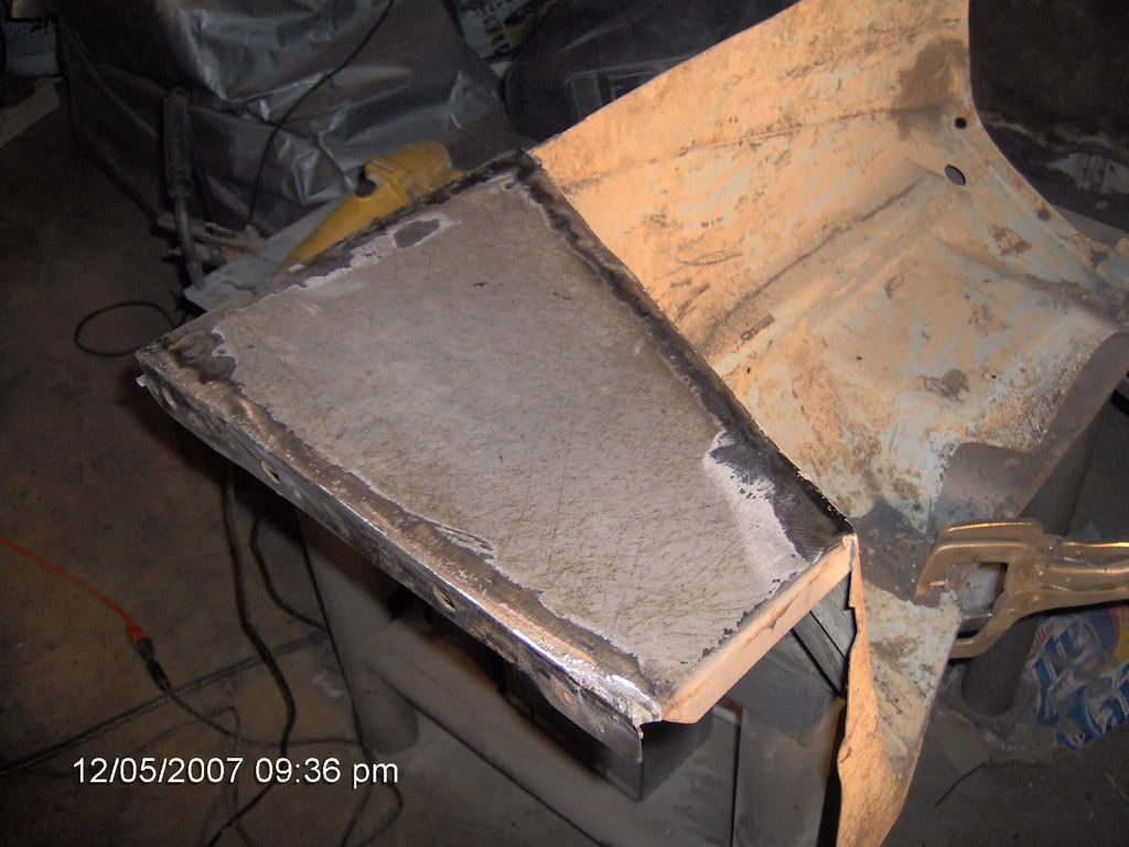

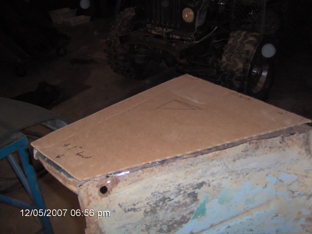

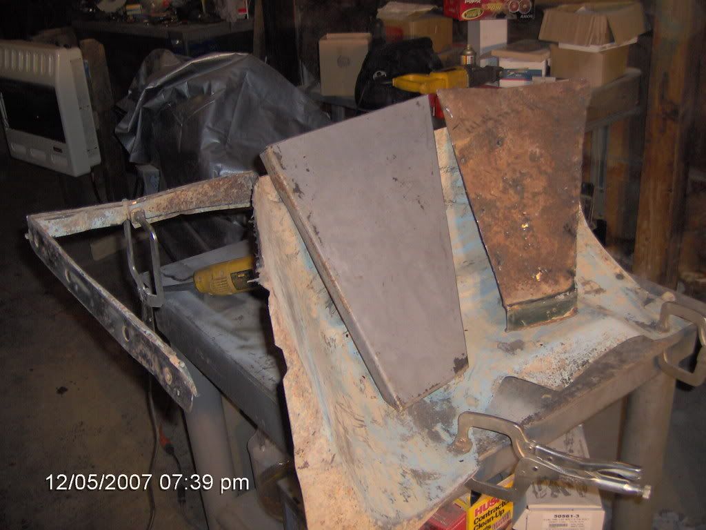

That whole rusty panel is getting replaced:
Cardboard is fabricating's best friend:
Replacement piece done:
Old one cut out and sitting by new one...you can see how I left the very edge all the way around (including mounting holes to the tub) for reference:
Fittin er up:
Welded in:
Cancer gone:
Another cancerous cell:
Fittin a new piece and markin for bolt holes:
Out with the old:

In with the new....and a little reinforcement:
Reinforcement:

Fatman: I owe a lot of what I know to Dad...he raised me in the garage teaching me a little here & there. He restored (back to mint factory condition....not heap of metal mud buggy) a Jeep before I was born and actually sold it to help pay for me after I was born so my bad on that. But I've learned an awful lot just from reading stuff on the internet....and of course the best way to learn is just doing it.
Subhaven: Sometimes I wish I had a torch! All my cutting has been with cutoff wheels on the 4.5" angle grinder or sawzall. I've been through probably 50 cutoff wheels or so. Also, I didn't do any sanding on the tub. the bondo job was so rough and the body panels are so out of square that it's really kinda pointless to even TRY for a "nice-looking" shiny paint job ...I already have the base coat of olive green (Krylon rattle can) down and I really like how it looks. When I get the fenders painted & assembled along with the hood, I will shoot the sand & black to complete the camo paint job. I did do some sanding on the primer on different parts (particularly the hood) however and I don't have anything to compare it to so I don't know if it was easy or hard....it was all wet sanding with 400 grit and the only thing I noticed was little balls of primer everywhere that I couldn't get to wipe off until it dried....

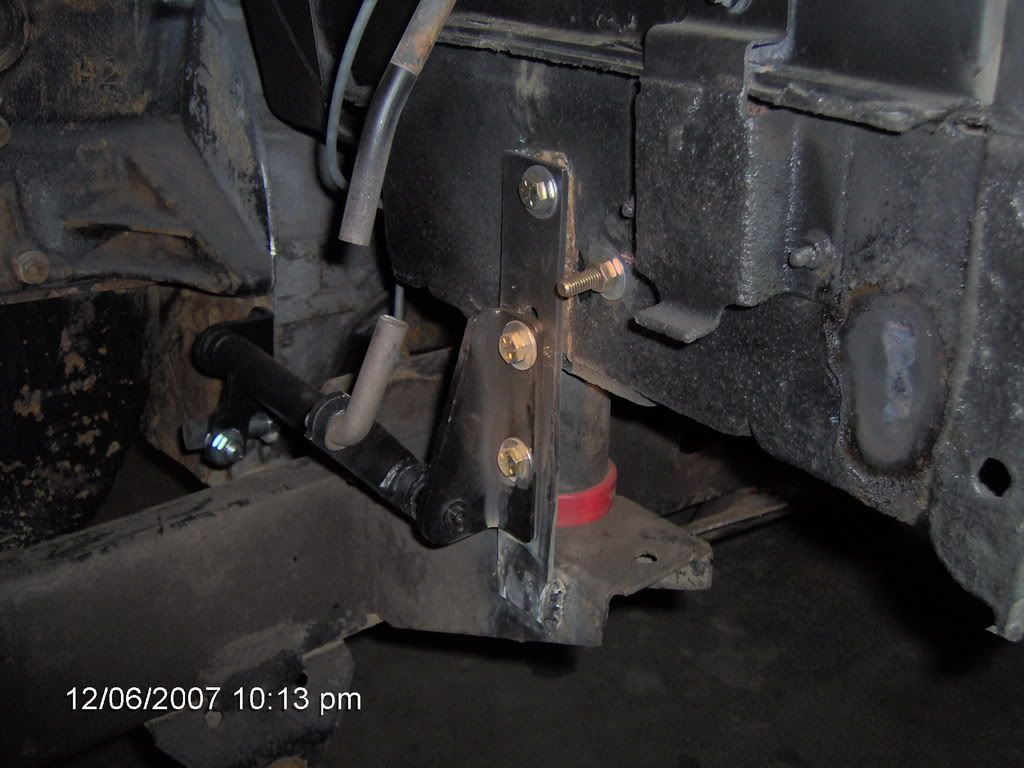

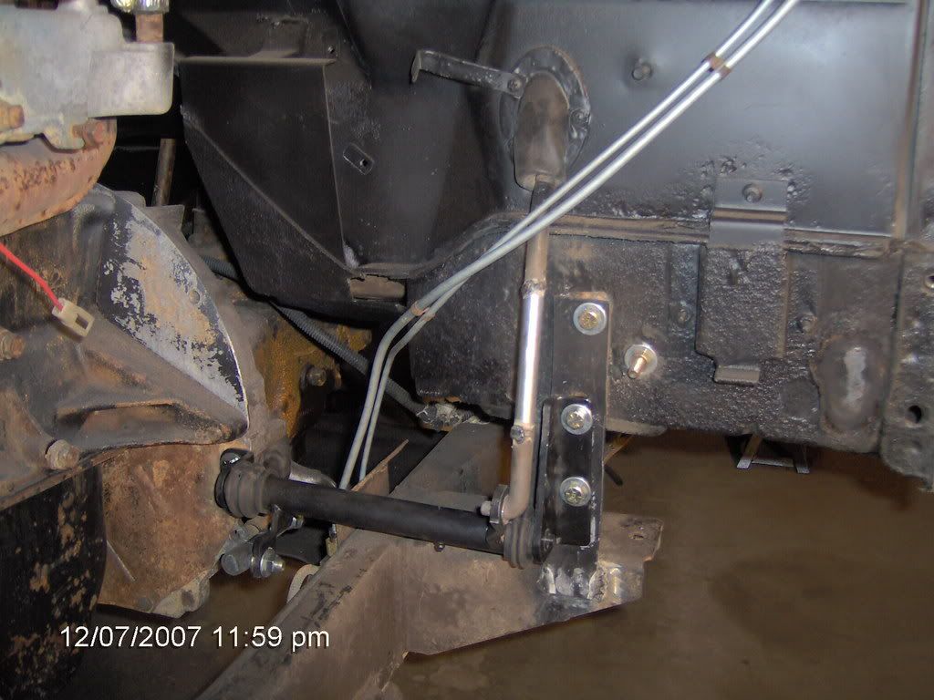

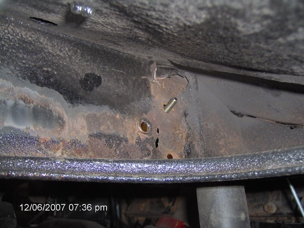

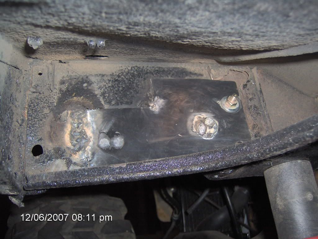

This is the backside of where the clutch linkage bolts to the body. It was pretty weak and having to extend all the clutch linkage stuff, I figured I'd do a little reinforcing:
Support plate added:

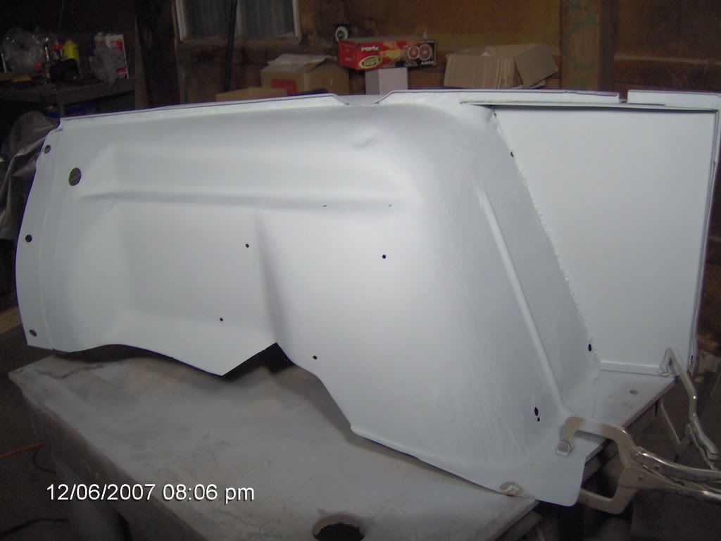

Painting the fenders:
Cut the clutch push rod to lengthen it:
Clutch linkage done!.....I might've stole Fatman's idea about tying the bracket to the frame
