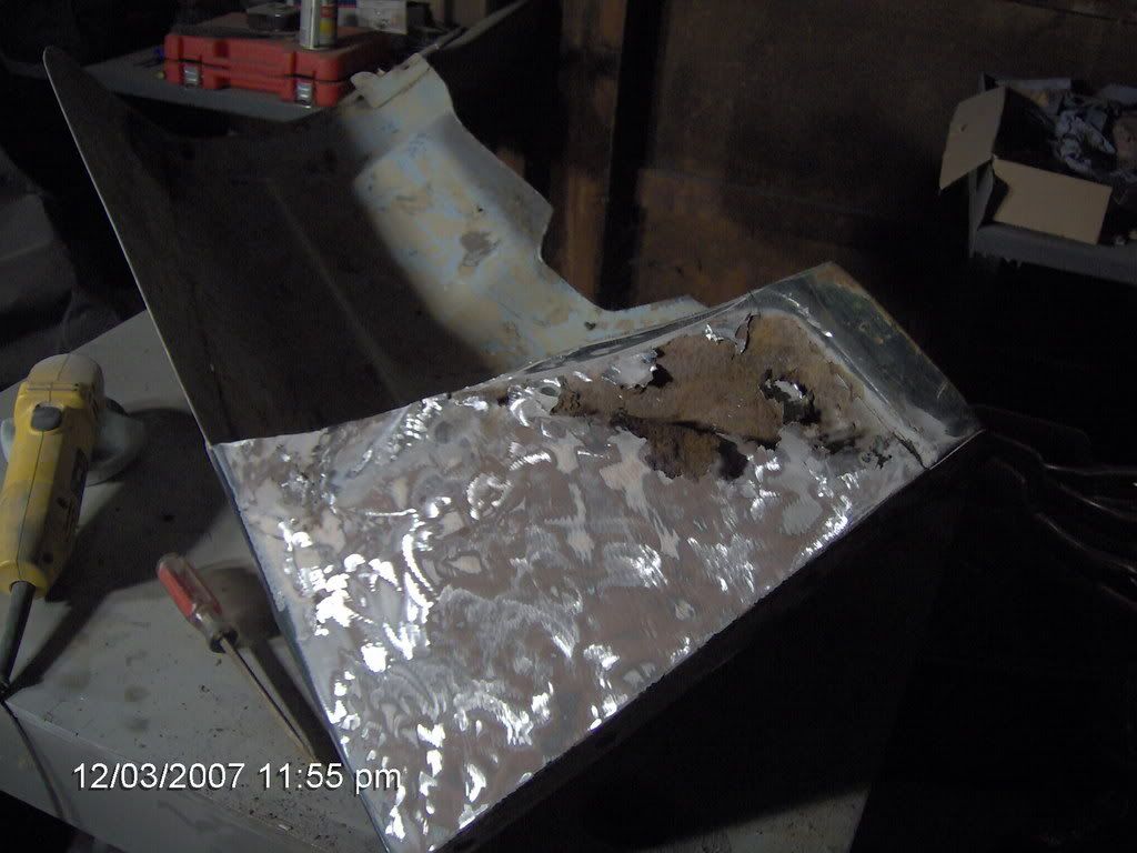

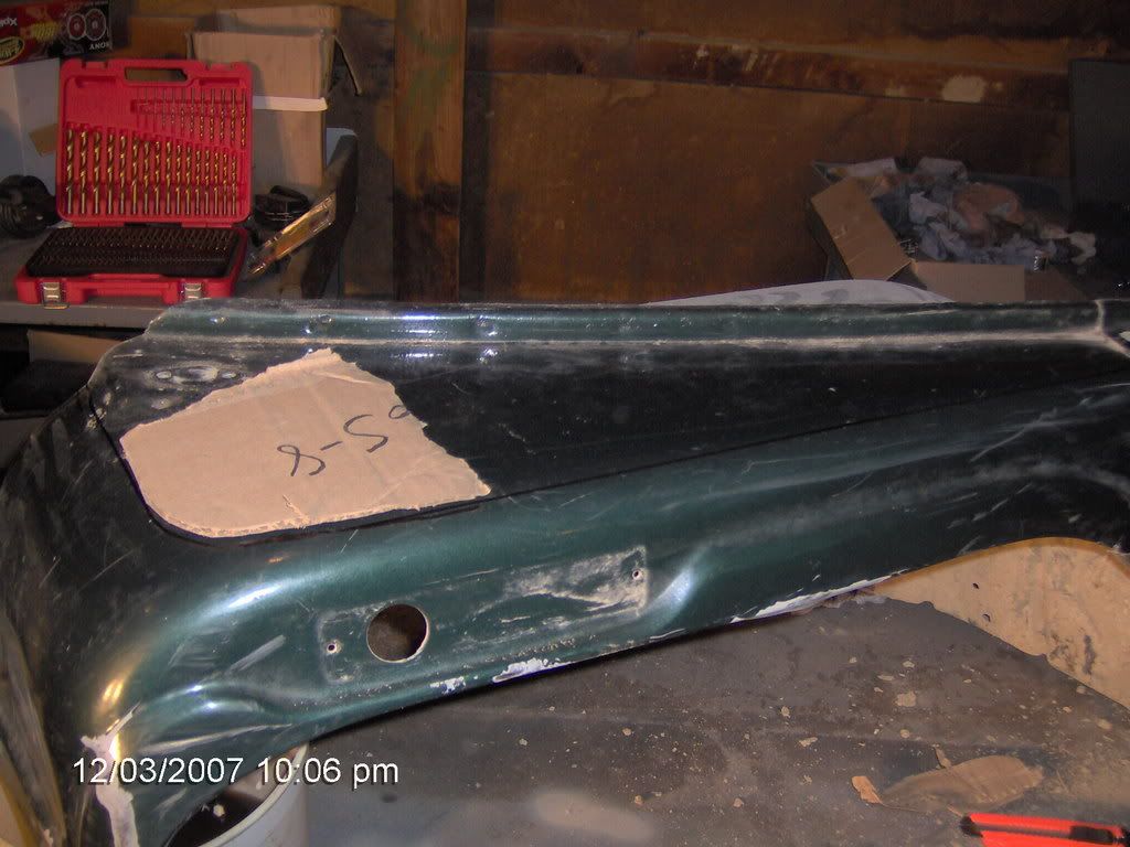

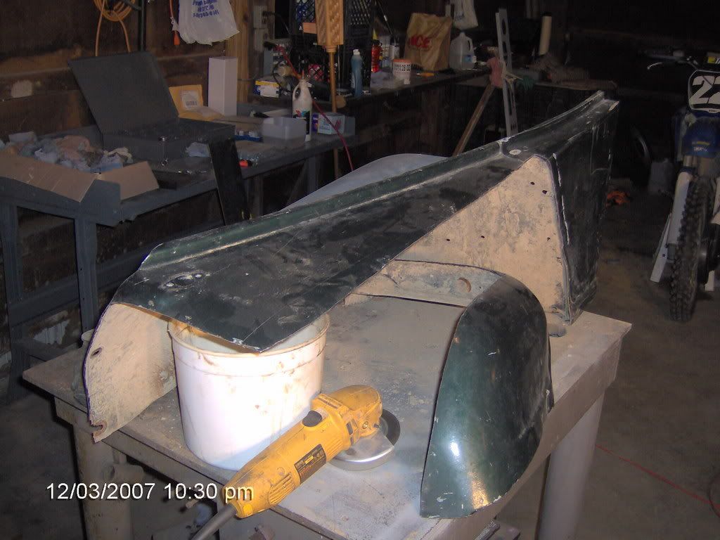

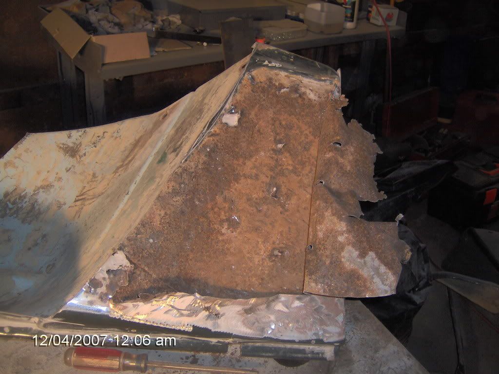

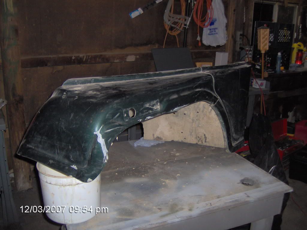

Ran into a minor glitch the other day that slowed the progress down....I wasn't plannin on doing any work to the front fender because I THOUGHT that they were in good shape...well, when I dug them out of the corner of the shop to put them on, I quickly realized that one of them in particular was definitely not doin so well....so I had to spend about an evening & a half fixin that up. Both front fenders are about done...just have to paint them and then they'll be ready to go on and then comes the wiring.

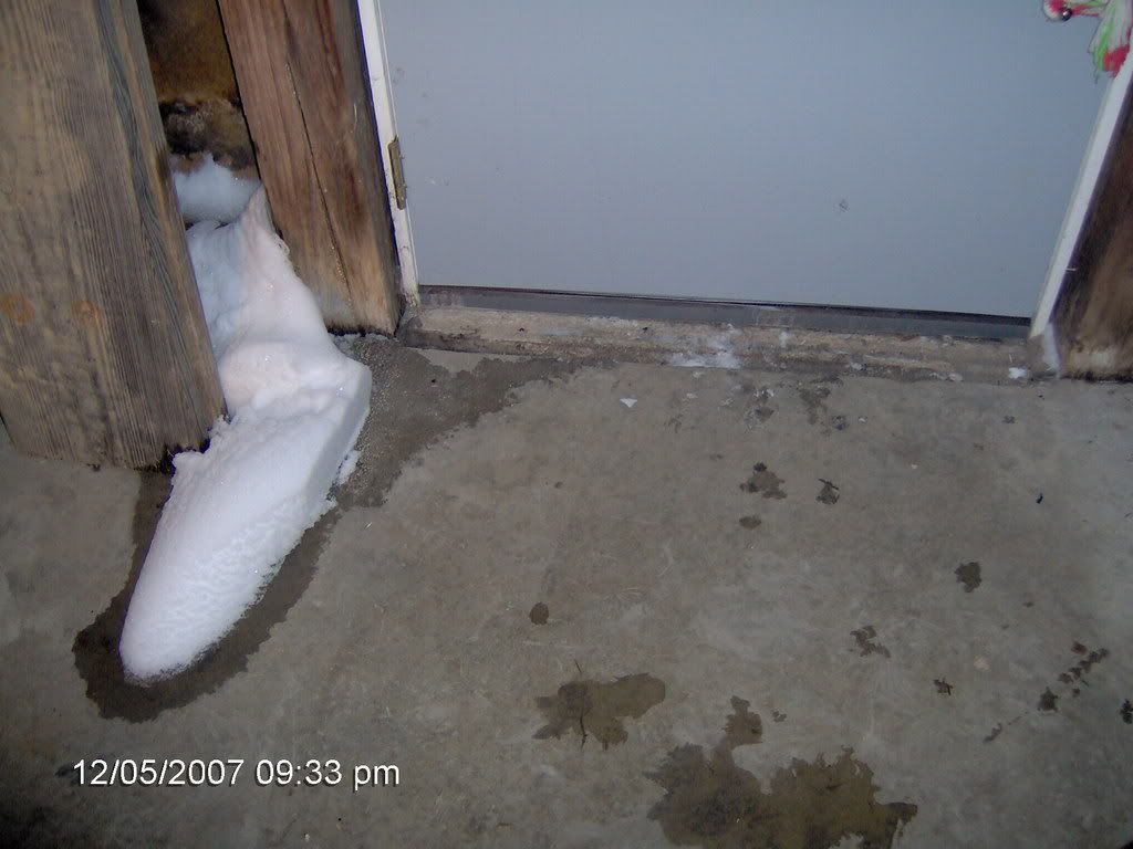

10* in the shop last night!!!!!!! The barn is not built very well toward the bottom & doesn't seal up against the floor or the ground so snow was able to blow underneath the wall & into the corners of the shop....so yea, it's cold out there!!!!

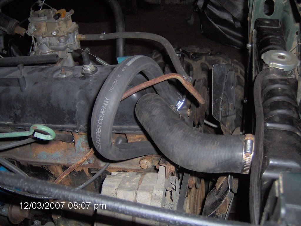

No heater so had to run the bypass hose straight from the thermo housing to water pump:
Front fender before going under the knife:
Pattern for the round corner....goin flatfender:
Flatfendered:
Cancerous body that needs FIXED:
Peelin the cancer back:
