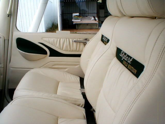

I've been in the upholstery business for 35 years and do a lot of leather work. I always suggest using Lexol for the seats. Here's a tip for cleaning leather if really dirty. Get some Ivory bar soap and put it in a container of water and swish it around until soapy solution. Dampen rag and clean seats. Rinse rag with clean water and wipe down seats again. Never soak leather. Only moist. The Ivory soap has Lanolin in it and is good for leather. These seats in my airplane were done in bone leather and got dirty a lot. I cleaned them often but you can see they still look new after about 6 years.
