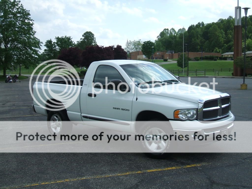

I have an 02 ram with the 4.7 auto and the 3.92 gears and 4wd. It will flat out run. Only about 30hp difference between the hemi and 4.7. Plus the hemi need 89 octane and has 16 spark plugs. I've had it for 6 years and never much fuss from it. I would be surprised if that truck has 3.92's being a stick especially if it's 2wd. I have towed cars on tow dolleys and it does it without much fuss. I wouldnt want to tow with it constantly, but it's fine for every now and then. A few of the big problems with these 3rd gen Rams are things like the LSD has retainer clips that like to fall out and can chew up the gears, people say they sludge up easily, but i change my oil every 10k using mobile 1 oil and never had an issue, the blend doors tend to break so test all the air positions, and lastly the fan for the A/C condenser tends to wear out. I love my truck and it has more room by far compared to other single cabs.
Here is a photo from a few years ago
