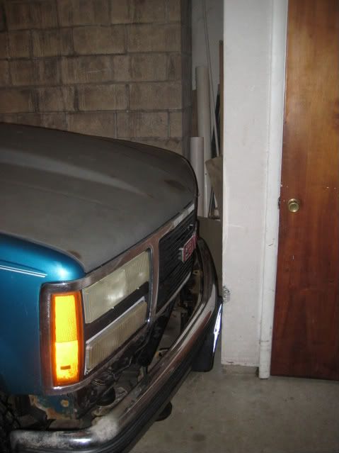

Earlier this year, roughly September 24th of the O-Eight year, beefsteW purchased a vehicle for the unbelievably low price of one thousand U.S. dollars! Said vehicle was for the most part a 1990 GMC K/1500, Sierra. The Truck that was now a possession of beefsteW had a custom five tone primer paint job.... Member beefsteW loved his new mode of transportation and all the character that came with it, but felt he needed to do something about the appearance, since to the untrained eye it would appear to look like a pile of scrap metal.... member beefsteW decided to name his new truck Frankenstein, a fitting name considering Frankenstein was made of many many parts of other trucks, put together to make one impressive monster beast!!! Also, member beefsteW really really enjoys saying "ITS ALIVE!!!" when Frankenstein eventually starts up... Pictures of said Frankenstein can be found below....
Ladies and Gentlemen, I present to you Frankenstein!

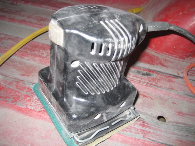

First, member beefsteW removed all of the trim from that Frankenstein o so loved and cherished, such as Frankenstein's ultra rare custom alteza/euro taillights and super nifty rain guards for the windows!
Once beefsteW stripped down Frankenstein, he gave Frankenstein and exfoliating sand bath... or as the general public may understand, beefstew sanded and prepped Frankenstein. Frankenstein is very ticklish and did not like this at all....

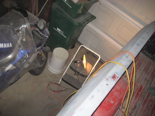

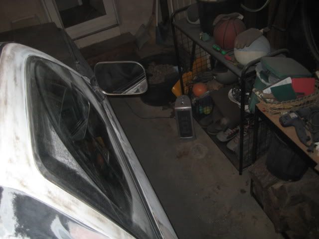

During the previous process, beefsteW realized how truly chilly it was in his tiny uninsulated garage.... He resorted to producing some sort of heat.....
Below we shall see a ceramic heat lamp that is intended for domestic reptile heat.... From this day forth it shall be known as a hanging human heater!
Here we can see the worlds smallest space heater... From this day forth to be known as a waste of beefsteW's money....
and finally, here we have a light.... truly a beauty!!!
Yes... now things where heating up!!!!

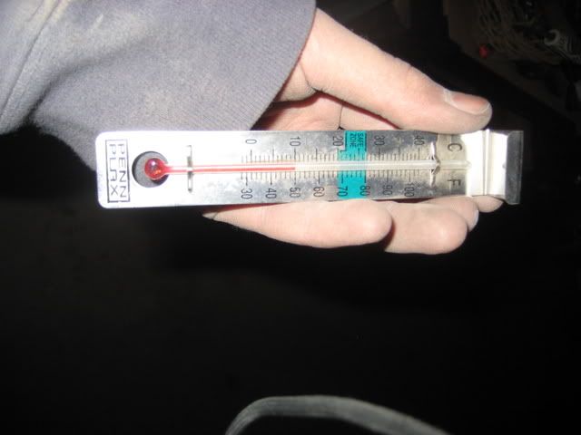

Since member beefsteW had finally created heat.... He felt he should see what kinda heat he was generating.... he then took a terrarium thermometer and converted it to an outdoor thermometer.... see below
With Frankenstein and beefsteW now comfortable at a warm but incredibly chilly fifty degrees that seemed to vary greatly throughout the week.... beefsteW was now ready to gather the ingredients to accomplish such a painting job!

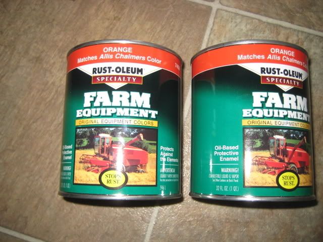

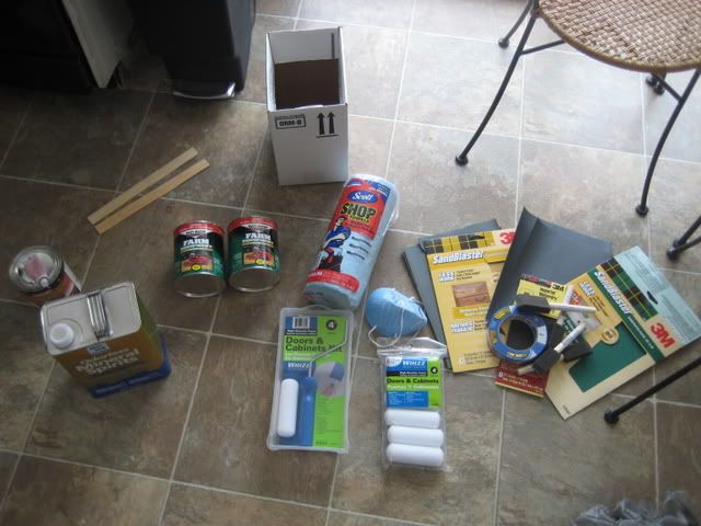

ingredients to said paint job are below...
they include the following:
foam brush rollers (high density)
Painters Tape
Mineral Spirits
sandpapers.... lots of grits...
and clearly paint (Rustoleum)

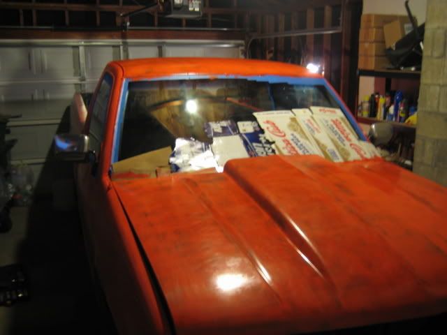

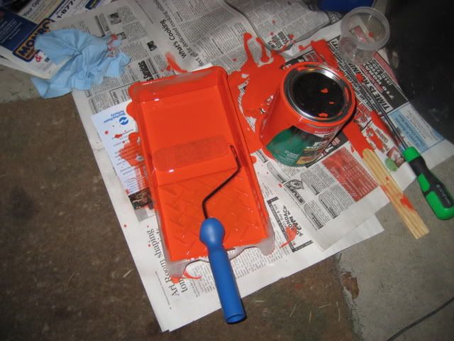

BeefsteW then took his newly aquired mineral spirits and mixed it with his newly acquired paint.... see below
BeefsteW then wiped all of the dust and dirt that was left over on Franky from the extensive sanding... Using mineral spirits on a rag beefsteW was able to clean Franky very well.... once dry the awesomeness ensued.... see below

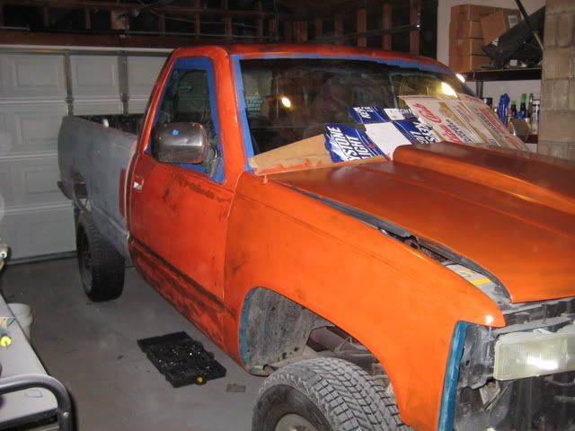

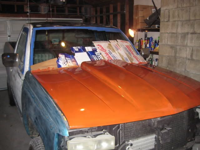

first coat on Franky's hood
Making progress
first coat
Frankenstein would also like to take this time to explain to the general public that he wanted to look like a pumpkin.... that is why he decided to have member beefsteW buy the special ALLICE CHALMERS ORANGE.... for those of you who want other colors here is a link to said colors offered by Rustoleum....
http://www.rustoleum.com/Product.asp?frm_product_id=18&SBL=1&dds=16
Also, beefsteW would like to mention.... You can have them tinted so you can pretty much get any color you want....

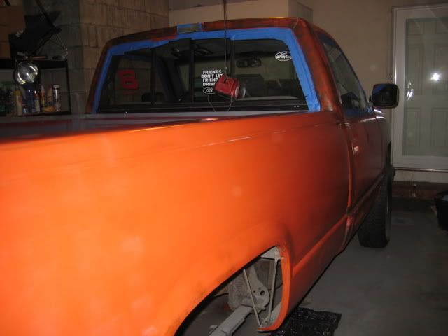

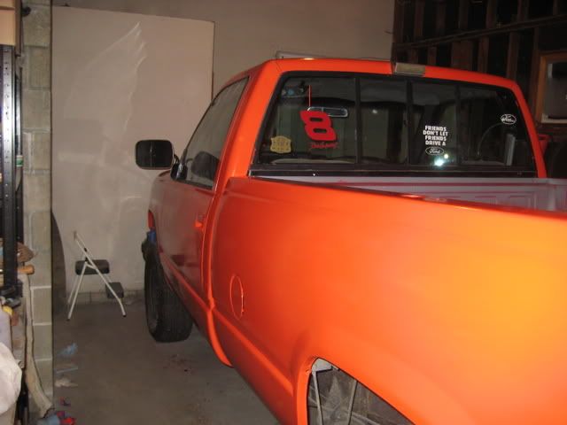

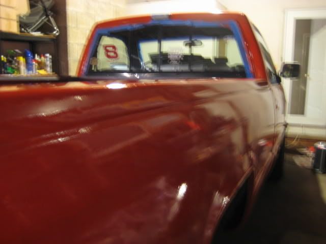

After every 3 coats of paint rolled on ever so carefully.... member beefsteW then wetsanded Franky.... Franky, again did not enjoy this due to his hatred for being tickled... but he allowed it since it was not as bad as dry sanding....
BeefsteW then repeated said process over and over... applying a total of 8 layers of paint to Frankenstein.... BeefsteW did not prime Franky before rolling said paint on.... He simply sanded using 80 grit then 220 grit... this took him quite some time since Franky was an old dirty bastard... not to mention the blemishes on Franky's body... BeefsteW found himself with bondo stuck all over himself after doing surgery and repairing all of Franky's bad spots...
To recap, the process was as follows....
1. Sand and prep...
2. roll on paint.... do not forget to thin it very thin with mineral spirits....
3. every few coats, wet sand and progressively use finer grits... finishing with 1500
4. Buff using a polishing compound... then apply a wax... member beefsteW prefers the original turtle wax!!!
5. Enjoy...

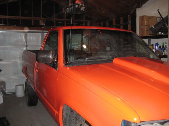

there is no clear coat and there is still a very great shine... Franky's shine may not be as deep as some fancy show cars, but for fifty bux it is damn impressive...
beefsteW just finished waxing just a few hours ago, and as such, Franky does not have all his awesome and cool accessories currently on... see below for final pics...
member beefsteW is concerned that the general public my not truly get a feel for the true quality of this paint job due to the pictures not giving it justice... it is very shiny and very strong... member beefsteW prides himself on how strong his fingernails are.... he was unable to put a scratch in his 50 dollar paint job when he tested in a very inconspicuous place...
here are more pics with and without flashes... more pictures shall come tomorrow when Franky is put back together and is outside in the snow... perhaps the pictures will yield better shine in the sunlight!!!
