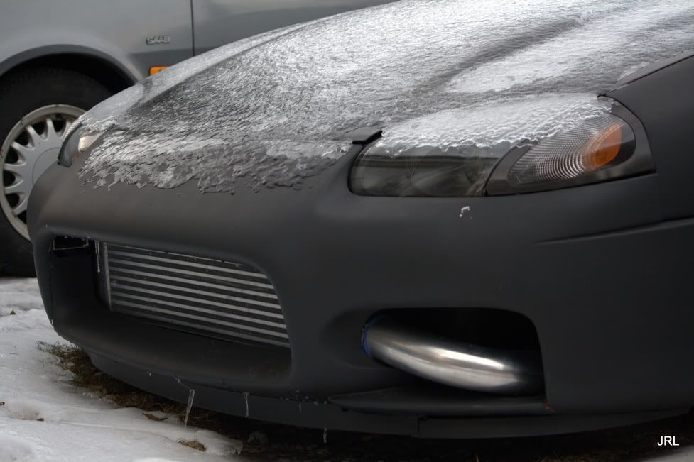

I'll put up a pic of my VR-4 that I rattle canned black. I just sanded w/ 320 grit, cleaned (terry cloth followed by tack cloth), taped (WSJ finally comes in handy), and sprayed (lightly at first then heavier, until each panel has enough paint on it). No post-paint buffing or anything. It's not exactly rocket science, and it's a lot of fun. I used Duplicolor 'Hot Rod Black' paint.

Thanks for all of the great info guys. The 3000gt looks great,as well as the Jeeps.

did it with a spay gun....just look up kustom shop flatz...good paint but kinda tricky to spray..
Yeah it looked like spray gun. Looks great!
