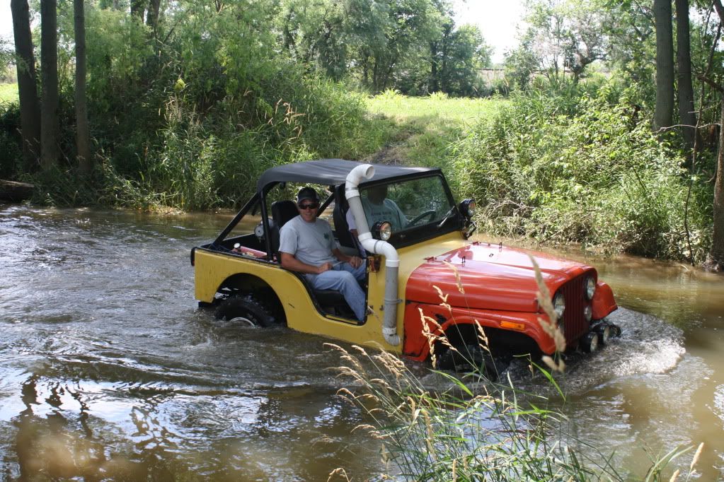

thats my seet up, its all 3inch pvc, i used the factory air cleaner, i just welded a 3'' rigid coupling to it and then I used a 3'' pvc adapter to switch to plastic. it threaded into the steel coupling. those are both electrial fittings. the rest is plumbing parts
its pretty simple, but it works

only reason i went through the tub was because i have a new set of fenders that i did not want to put a hole into
