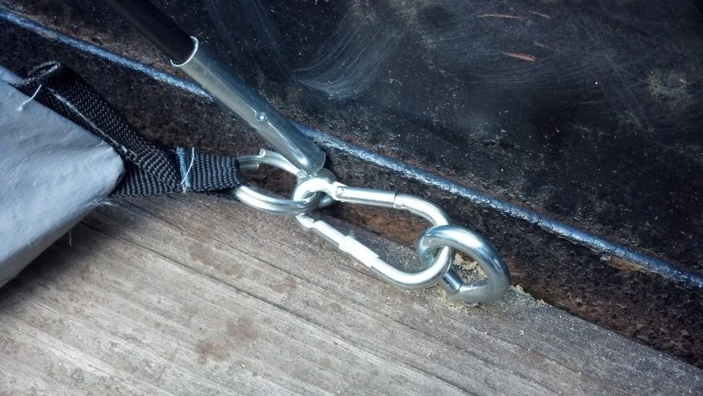

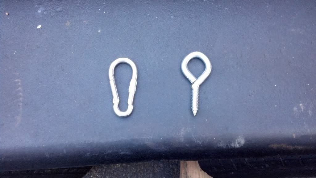

Alright for anyone searching on this topic, heres how I did mine. I took advice from this thread and my woman and got her set up so she aint going anywhere.
Doing some work on my gf's moms car and she paid me by buying us a tent. We picked out a 7ftx8ft tent that fits 2 twin matresses with room to spare. Then took some eye hooks, drilled a pilot hole and using a vice grips, threaded them in. Then used a carribeaner to the eye hook and ring on the tent and secured it. Very sturdy!
They make eye hooks with a nut so if you have a metal deck trailer you can make it work too. Thanks for everyones help

Ya man! Looks awesome!!
Thats what i meant about the caribeaners. You can just take it down fast if you needed.
Glad you updated the thread and good to see you got what you were looking for.
