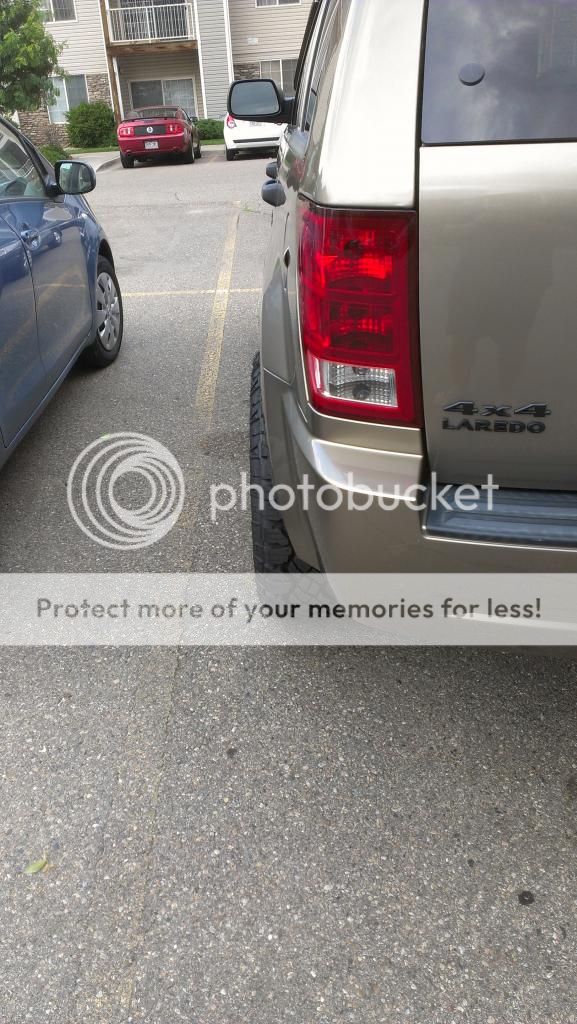

Unread 07-05-2013, 04:25 PM   #10
nocojeep
2006 WK
Join Date: Apr 2013
Location: Loveland, CO
Posts: 90
Originally Posted by 2010WK View Post
Any side shots of your jeep?
nocojeep is online now   Reply With Quote Quick reply to this message
Unread 07-05-2013, 04:32 PM   #11
2010WK
Join Date: Jul 2013
Posts: 10
Looks good, thanks!

Originally Posted by wknoob05 View Post
I know this is an old post but I'm looking at some xd cranks for 05 gc. +0mm offset love the look of yours also getting these same exact tires and size. I know nothing about wheels how would mine look compared to yours?
Since the XD Crank is also 9 inches wide, the 0mm offset will stick out 18 mm farther than my wheels in the picture, which is about 3/4 inch.
