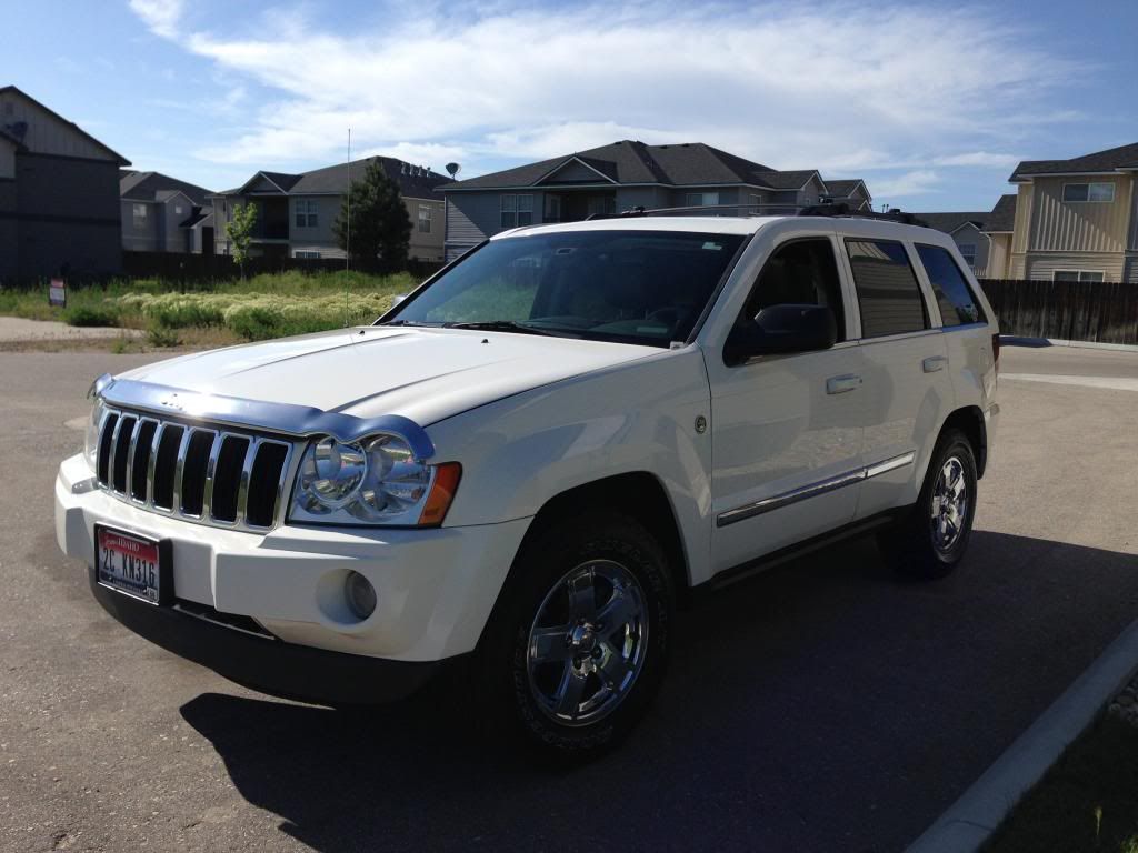

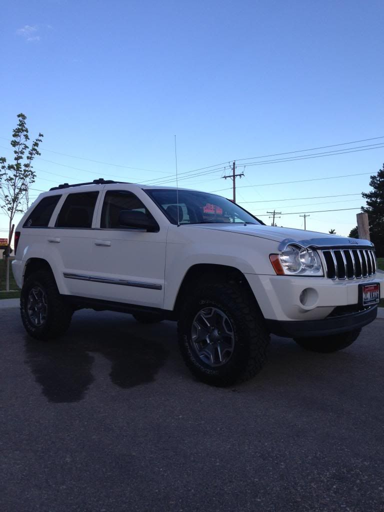

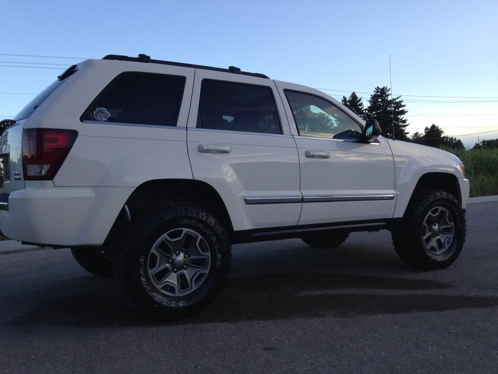

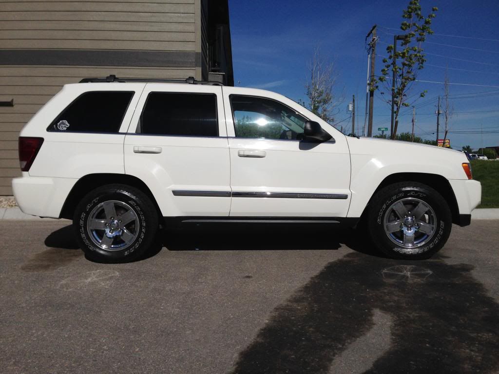

Got it lifted finally. After 11 months of ownership, here it is.
Specs are as follows:
OME HD Front/Rear
RRO Upper Control Arms
28" Blistein 5125 Rear, 5100 Adjustable (Set at 0.75")
2" Rusty's Poly Spacer for Rear
Rustys Adj. Trackbar
JKS 2001 Rear Disconnects
Spidertrax 1.5" Wheel Spacers
Pinch weld and rear fender mod
2014 Rubicon Takeoffs
285/70/17 Duratracs
Before:
After:
