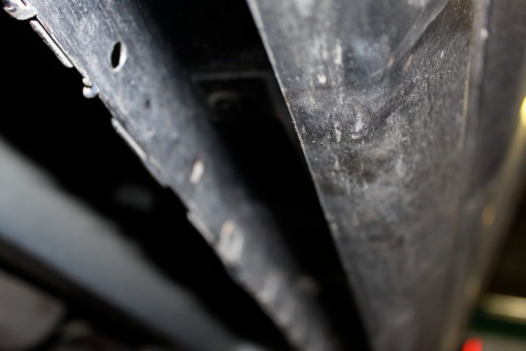

where the 2 x 2 tubing will be mounted.
what it looks like installed

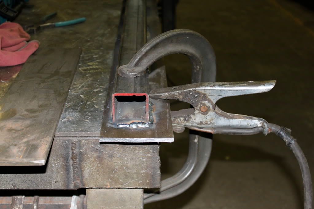

3/8" plate wielded on 2x2

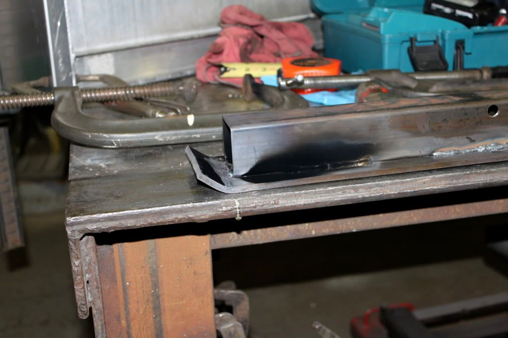

heated up both ends to but an angle on them so they wouldn't get caught up on things

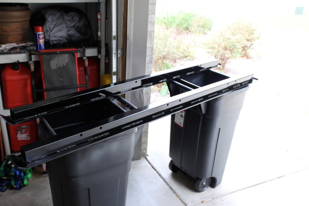

Painted!
