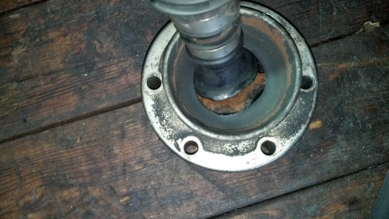

The good news is that greasing up the CV joint completely cleared it right up. Now I need to see how long the grease stays in there. Got another 1,500 miles to go before I know someone who can swap it out. Here is the rear end of the front driveshaft. This was making all that racket.

Another update. I could only find reman replacements online, but my cousin was able to get a new one from Chrysler. It arrives Monday morning. The grease has been holding up just fine. No grinding at all.
