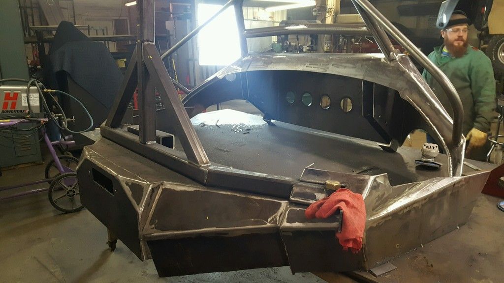

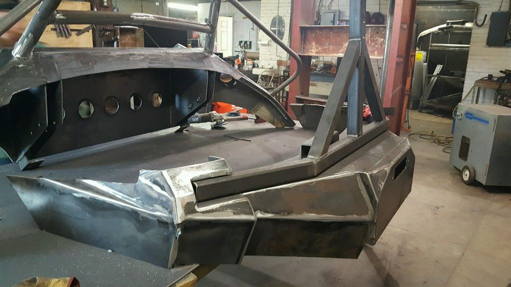

Rear winch mount bumper is coming along! I opted to leave off the receiver hitch since I donít need to tow with this, and from the designs Iíve seen it would have lowered the bottom of the bumper 2 to 4 inches. This design mounts the winch upside down with a cover plate to protect it.
Latest update from Brian at FMJ Offroad is that they have been slammed with moving into a new shop as well as an influx of new customers, but that fabrication on the new bumper is almost done and hopefully off to media blasting to prep for powder coating by this weekend.
Here are some progress pics. I donít know what to think about how far it appears to stick out. Iím not sure Iím going to like it, but Iíll wait until itís on to decide.

post #73 of 77 Old 03-18-2017, 03:35 PM
derpboss
Join Date: Jan 2016
Location: manchester
Posts: 420
I may not agree with his style, but he sure does some unique work. I Didn't like either of his front bumpers, or his non winch rear bumper. But it's cool he's willing to do whatever we want, the work is solid, and the prices seem reasonable.

post #74 of 77 Old 03-19-2017, 04:23 PM Thread Starter
azzkicker
2007 WK
Join Date: Dec 2016
Location: Beaverton
Posts: 261
He is very willing to customize. I didn't have a design, so I told him to look at the metal pasja bumpers (which I really like) and do what he thinks is best.
I can't tell how it's going to look until it's on the rig, but since it's steel, I have lots of options for having it modified. I thought about going with aluminum, but it's so easy to leave a stress concentration somewhere that matters, and so hard to modify or reinforce later.
I really like the idea that I can check out every possible size reduction, then have it done, instead of trying to design the most efficient bumper from scratch. I doubt I'll bother with it, but I will if it bugs me.
