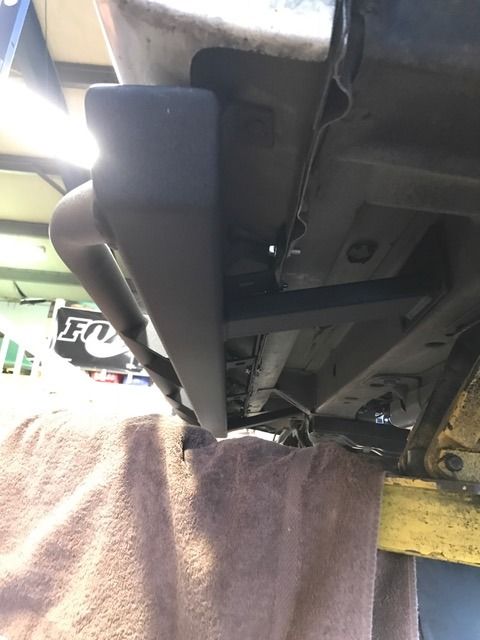

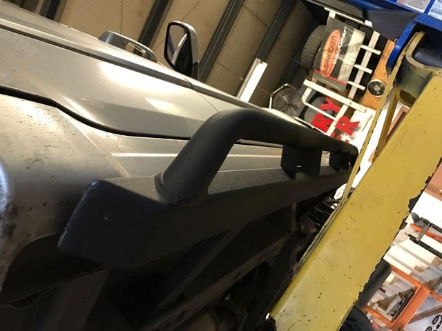

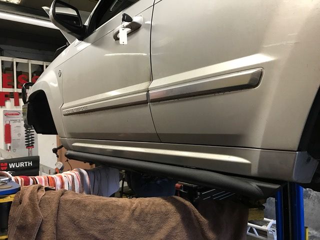

Here are the JCR rock sliders going on, again thanks to Matt at Accessory Outfitters to take pictures for me. They wisely don't allow me to hobble through their shop while they're working.
I really like how beefy these are, and that they attach to the "frame" as well as the body seam. The other ones I looked at tucked a little higher, which I liked, but didn't reach in to the "frame". In my opinion, without that big lever mounted to the frame, the slider is not strong enough to lift the side of the rig. I may never try to do that, since I have the hi-lift tire adapter and always prefer to lift at the tire if I can get to it. In any case, I may end up setting the jeep hard on a rock without meaning to so I wanted the beefier ones.
I wish I wasn't lowering that catch point under the door, but somebody pointed out to me it's still higher than the transfer case cross member (I think that's what they said). That's a good point, but I do often get hung up where the terrain is more V-shaped, so the center of the rig clears but it drags under the doors. I look forward to seeing how these do, and I'm not afraid to take them off if I don't like it.

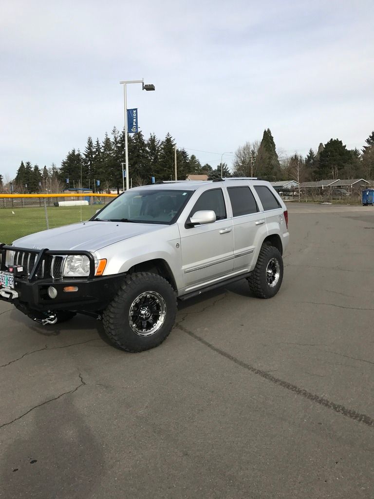

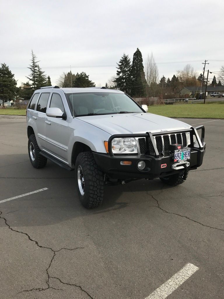

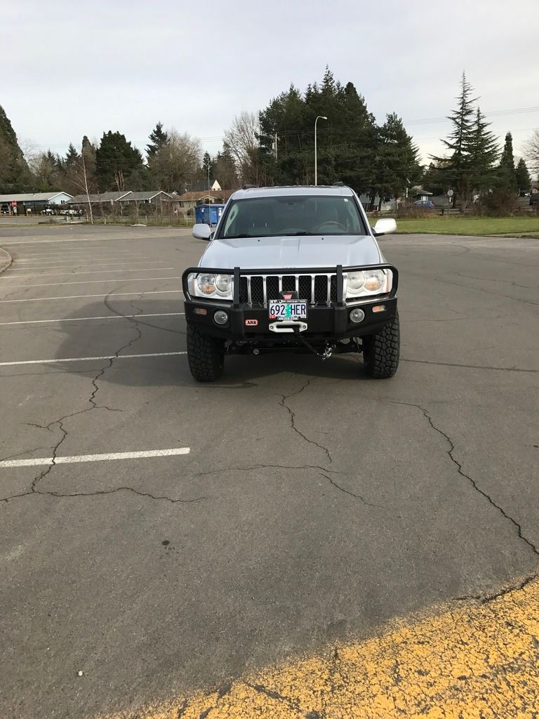

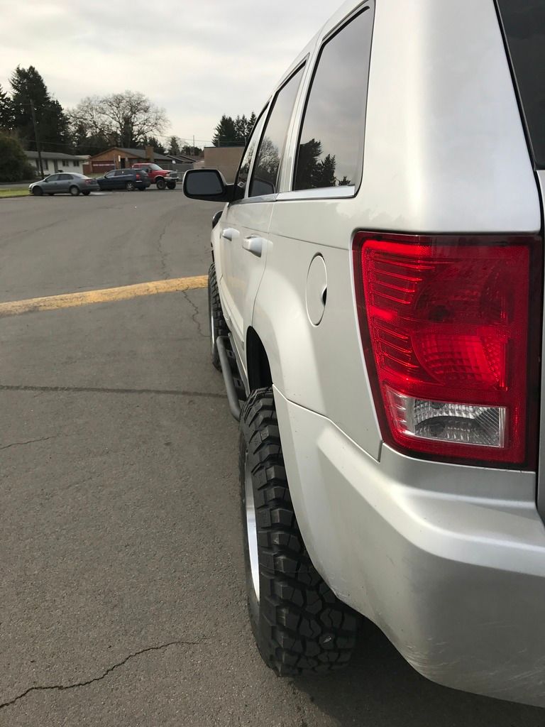

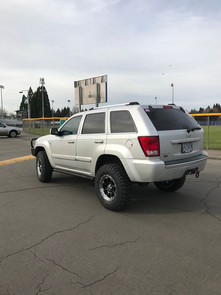

It sure did. I thought it looked like a skinny kid with a fat head. Now it's grown into the bumper! I just got it back late yesterday. I wasn't feeling well enough to go for a test drive, but on the way home I noticed the turning radius is much different (as expected with such a bigger tire). I noticed the tire noise now drowns out the hemi until I step on it, so I need some more muffler work or intake work. It sits up better in traffic so I can see better. It drove just fine, and while it has less throttle response, it still had plenty. Other than that, I thought it felt solid and drove well (again, not a test drive, just home).
I'll get some better pics when it's bright out, and go shake it out better. I'm very happy with the lift and tire selection, but I do wish the hind end wasn't sticking up so high. I wonder if I can get that down an inch or two. We'll see how much it crouches when I get my couple hundred pounds of recovery gear back there, but I don't expect it to sag noticeably.

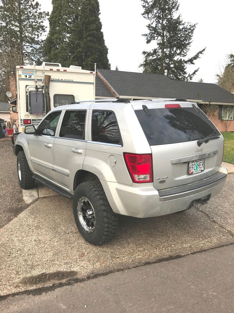

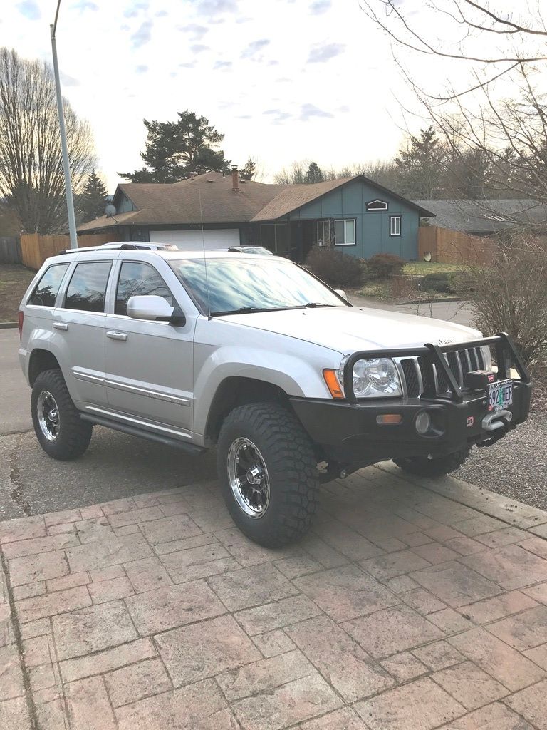

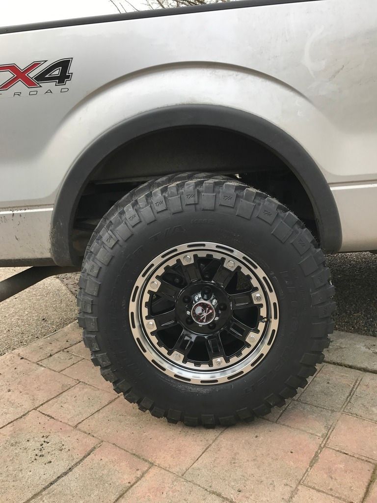

Here's more pics. Notice in this first one I've put the 33.3"X10" tire next to my truck with "35X12.5" tires. I haven't looked up those tires to see what the actual dimensions are. I was a little surprised how close in size they appeared, but of course the truck is squatting on it's tire a bit.

Now for some thoughts and problems with the project: Once the lift and tires were on, I was very pleased with how it looked (the bumper went on first, and looked stupid to me on stock wheels). I don't like the hind end sticking up so high. I've asked Accessory Outfitters to find me some springs or shocks to get it down an inch or two. They're looking into it.
It drives just fine, but of course with more tire noise and less acceleration. The turning radius is very noticeably worse, but I don't see it hitting anything, so I suspect it's software limited to make sure a 12.5" wide tire won't hit. However, since I have 10" wide tires, I could turn sharper if the system would let me. It may also be the geometry of the new knuckles (if they stick out farther, the steering mechanism just won't move the tire as far). I've asked Accessory Outfitters to see if there's anything we can do, and I've sent a message to superlift asking the same thing.

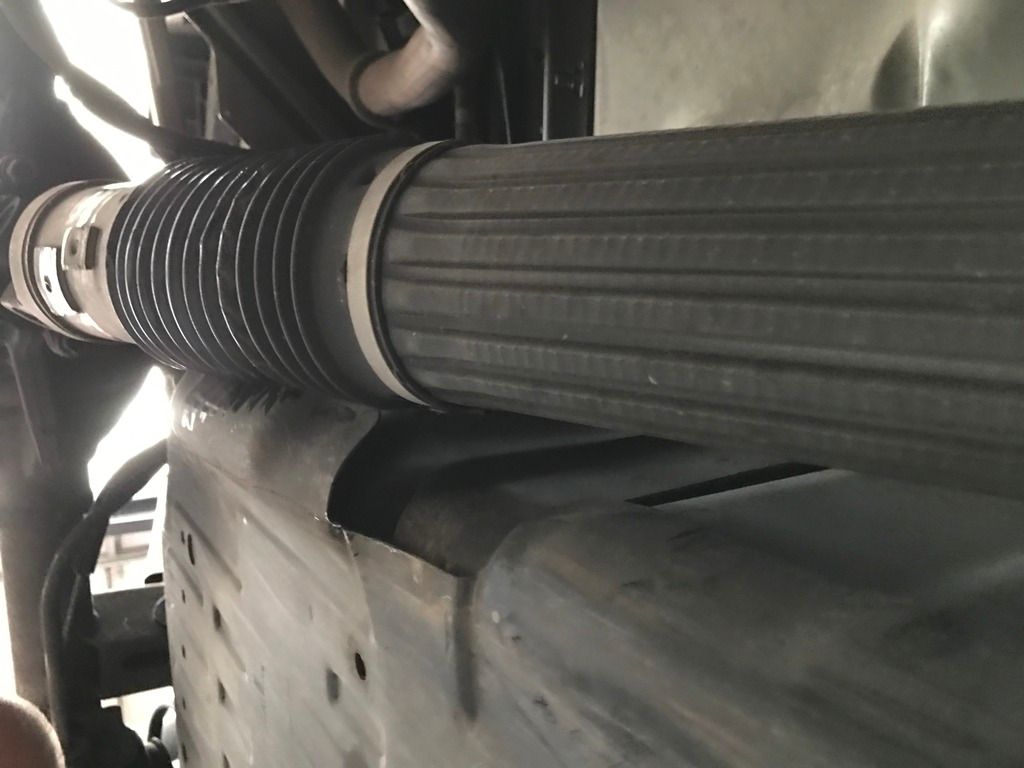

The driveline hit the gas tank skid plate on my first articulation test. It would have been a big problem, but my buddy's lift was only 200 feet away (I used his property to test it for just that reason). The driveline peeled the skid plate down and jammed against it, even when it was back on flat ground. You'll notice from the pictures that the drive-line also rubbed the next layer of the tank, so I was hesitant to just cut the skid plate away and let it keep hitting. All we did at the time was drop the drive-line and beat the skid back into place.
After posting on a separate thread, I found out other people have had this problem and simply cut the offended piece of skid plate off. That apparently was the only needed solution for them. I'm probably going to do that, but definitely not only that. I'm very worried about eating a hole in the tank.
I also noticed the lift bracket that raises the panhard rod had shifted to the extend the bolts would allow, in the direction letting the driveline approach the tank. We loosened the bolts and shifted it back, and it has stayed since but I've only been on roads and speed bumps; no special articulation. I will have the shop weld that bracket as far toward the driver's side as possible while still leaving the bolts in.
I assume the 95,000 miles and 10 years has left the panhard rod bushings worn out, which would further allow the axle to shift toward the tank. I priced bushings, and ordered a new panhard rod because they told me the labor for pressing new bushings in would be about a wash. I did consider an adjustable panhard rod, but a few people have had catastrophic failures with those, so I'm just not going to do it if I don't have to.
My current plan is to first replace the panhard rod and have the bracket welded. Then I will test it again at full articulation and see if it still hits the skid plate. After I see what that does for me, I'll decide what to do about the skid plate. I may cut it out, then I'd be tempted to glue some UHMWPE to the tank so that it can't chew through quickly. That stuff is very difficult to scrape chunks out of. I may also leave the skid plate, but weld a piece on top so there isn't an edge for the driveline to catch and pull down. Then the skid plate becomes the sacrificial wear surface. The only reason hitting the skid plate was so bad is that it caught the top edge and peeled it down until it was hitting the driveline even on flat ground.

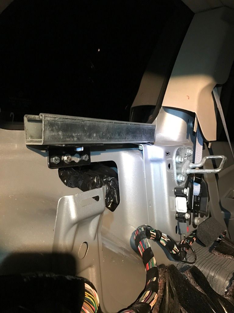

I'm well under way with my cargo area plan. I pulled off the rear trim (and cracked it on a cold day), then very solidly mounted a foot of unistrut right next to each rear side window. I have some 1 3/4" plywood that was donated to me, and I'm going to mount it across the unistrut and put bolts through it for my hi-lift jack. That's the only place in the rig that will fit my 60" hi-lift extraction tool. I don't want to mount it outside because this jeep lives in the rain. I know it works, but inside works better. I'm also going to mount my full size shovel across there.
I was able to very solidly mount the unitstrut. It doesn't even wiggle. One end is bolted through the bracket that holds the seat belt and seat bracket, so it's very solid. the other end is bolted with three 1/4" bolts and big washers on the other side. It's going nowhere. In the end, I'll rig up a 5/16" cable to loosely run over the jack, probably in an X, so that I either thread the jack under the cable, or use a strong snap link to release it. I'm bolting some eye bolts in all 4 corners of the floor, with big washers or even a plate underneath. That way, even in a severe accident, the jack (and the heavy job boxes under it) can't come visit me up front. I did this type of rigging on another truck years ago, and when I rolled it at the ORV park, the boxes of heavy recovery gear broke off the floor, but the cable kept it all hanging in the back.
