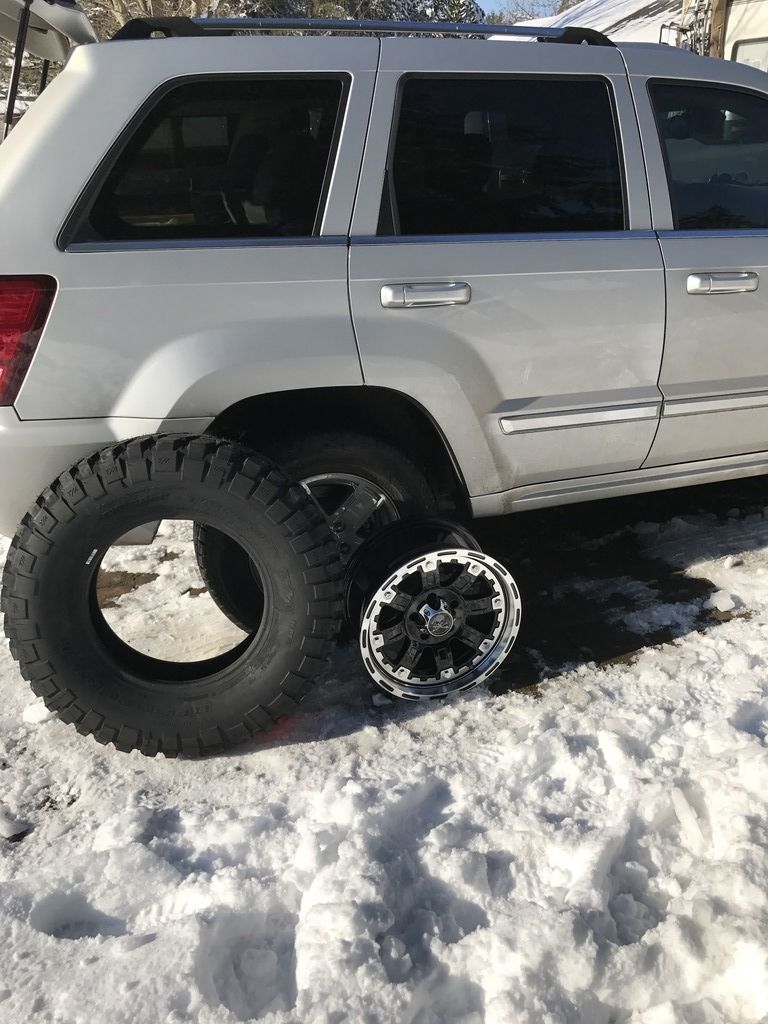

Back to the plan. 33" tires were the first thing I decided on, figuring that's the minimum size that will perform well in the woods and sand, but keeping the rig low enough that I can play at some speed without rolling, and keeping the ride as close to stock as practical.
I wanted a beefy mud tread, and I wanted them as narrow as I could get. I love the turning radius on the stock WK, and narrow tires will help me keep a lot of it. My gut feel has always been that narrow is better, and after doing a lot of google searching, that seems to be true in most terrain, and where wider is better, it's not much better. I know from experience that wider tires have more bump steer and wander more in pavement ruts.
The tire I found was this one (the pic should show up after I hit 25 posts). It's a BF goodrich mud terrain T/A KM2. It's a 33.3" by 10.0" tire, with a labeled size of LT 255/80R17. When I was researching tires, I found that while there are translations that will tell you supposed dimensions based on the metric designation, each manufacturer and each tire line varied significantly. What I had to do was search manufacturers websites and find the actual spec chart for each tire line that I liked. That's how I found this tire, after being told at several tire stores that 12.5 is the narrowest 33" tire I can get. It isn't. I found 10.5, 11.3, etc. I had to find the tire myself, then tell America's Tire to order it.
I think I mentioned my first mistake was searching in a 15" tire without knowing the big brakes up front require a 17" rim. Oh well, the tires came in before the lift, and when I ran one over to Accessory Outfitters, they quickly, and politely, pointed out my mistake. In my defense, I shopped for that wheel at the tire store to get the right bolt pattern, and they didn't catch it either. They did give me a full refund so I could order the right ones.
Some manufacturers, like goodyear, didn't have dimensions on their website. I did a chat with goodyear tech service, and found that they were completely ignoring that I told them what dimensions I wanted, and kept telling me to check the door sticker to see what size fits. I told them over and over that I knew what dimensions fit, and I just need them to tell me the dimensions of their various tire sizes, and they told me it varied from vehicle to vehicle. He didn't get it, so they missed out on a couple grand.
The lift manufacturer said a 5.5" backspace is the maximum allowable, so I had that research to do also. I'll get into the rim next.
Tire photo with specs:

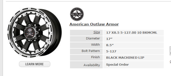

Next I had to pick a rim. I had found an awesome offroad rim in 15", but that line didn't come in a 17". I already knew from the superlift folks that a 5.5" backspace was the maximum I could have. Nobody seems to list backspace, but I found a conversion tool online that will translate the given offset in a given size, and tell you the backspace.
I knew the tire wanted a 6.5" to 8.5" width. I would have preferred to hit that right in the middle, but I wasn't finding exactly what I wanted and went with a cool looking rim that's 8.5" wide and about 5.3" backspace. I would have liked about 4.5" backspace, but again I got tired of searching and took the one that will work. I'm not crazy about having the widest rim this tire will fit, but everybody told me that's not a problem. It also has the added benefit that if I decide my next set of tires should be 12.5" wide, this rim will work for those as well.
I'm going with black bumpers (haven't found a rear bumper I like yet), black rock sliders, and I was going to go with black wheels but this seems like it should look a little better than all black. I'm not going for looks in this rig, but if I can make it look cool without sacrificing function, I would like that.
I went with aluminum instead of steel to keep the overall rig weight down, and the unsprung weight especially. I've had a lot of motorcycle experience, and sound engineering says that unsprung weight is the worst weight on the vehicle. I know steel is tougher, but I've never broken a rim before and I'm carrying a spare. If I regret it later, I'll buy steel wheels. For now, I went aluminum.
Here's the wheel I picked. I haven't had one mounted yet, but I did deliver a wheel and a tire to Accessory Outfitters so they can make sure this setup will work. An initial inspection with a tape measurer looked good to them. Once the lift parts are here (one part was missing) they will be able to check it out better, and they will run my stock wheels up to America's Tire to have all 5 mounted up. I'm told that once a tire is mounted to a new rim, the rim can't be returned unless it's defective.

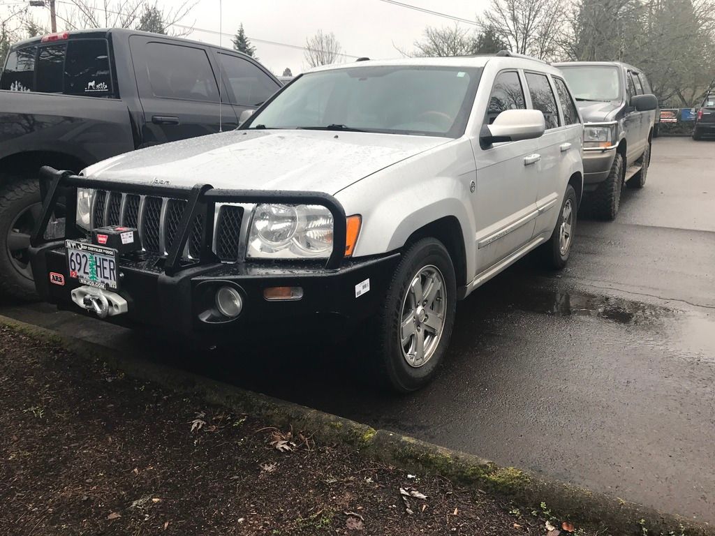

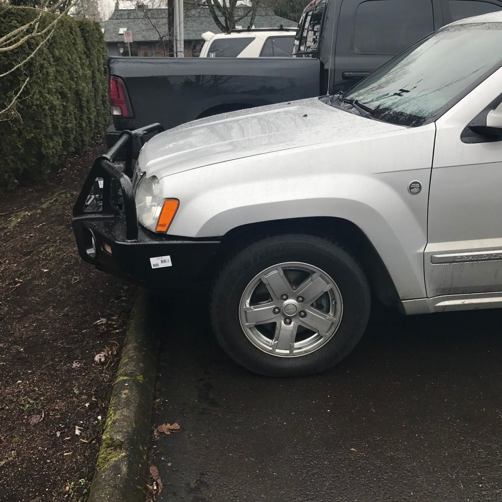

Winch mount front bumper: I went with an ARB bull bar winch mount bumper. It was obviously going to work, readily available, and I trust the ARB name. It's not as sexy as the Metal Pasja bumper, and I don't doubt there's better bumpers if you're willing to wait or deal with issues. I may still end up ordering the Metal Pasja bumpers. I found a place that says it will ship to the US. They would cost about $2500 each shipped, but that's with the rear having a tire carrier, winch mount, etc.
The place that will ship them said they have to be built first, after I pay. They said it would take a couple months, but their website said about 10 months in the warning when I put it in the shopping basket. I also worried that I would pay now, wait months and months, and get nothing. I don't know what recourse I would have with a European distributor buying from a Polish manufacturer. It's a little scary, but If you search for them online you'll see how awesome they look. There's a guy on this forum that got a set, but not the winch mount rear. He was having all kinds of fit issues, cutting frame members, said the bumper parts didn't even fit each other, much less the jeep.
I'll dig up the link to the place that sells Metal Pasja, if anybody asks for it. I also have an email address for a guy there that writes in English and seems responsive.
On to the ARB, which is installed already. I'll post some pictures of the mounting brackets and the finished product, which looks stupid on the stock tires. I'm sure it will look great when the jeep grows into it. Right now it's like a really skinny guy with a huge head; it just looks out of place.
The mounting hardware looks really good, and has inserts to go in the thin jeep structure. I'm a mechanical engineer, and mechanically inclined, and I think this mounting setup is plenty strong. I was worried the winch would pull the bumper off, but after seeing the parts going together, I'm not worried at all.
The finished bumper is huge. It could have been a little closer to the rig, and a little higher, if I designed it myself. I'm sure it's a design that fits multiple vehicles, or multiple options of the WK, with different mounting brackets. Other than the size and loss of approach angle, it looks pretty good. It's not sexy, but it should toss Bambi right into the ditch (or the windshield) without giving up the radiator or headlights. Also, if the prius in front of me needs a push, this thing should do it.
I would not like the look of this on a stock rig, but like I've said, it should look about right once the lift and 33" tires are on there.
Here's a stock rig (not mine, but looks like mine did) and the finished product. I'll post closeups of the mounting hardware next.

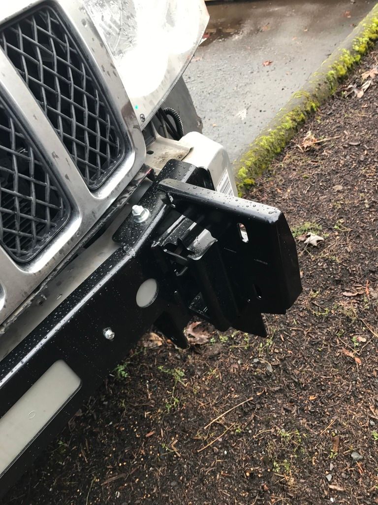

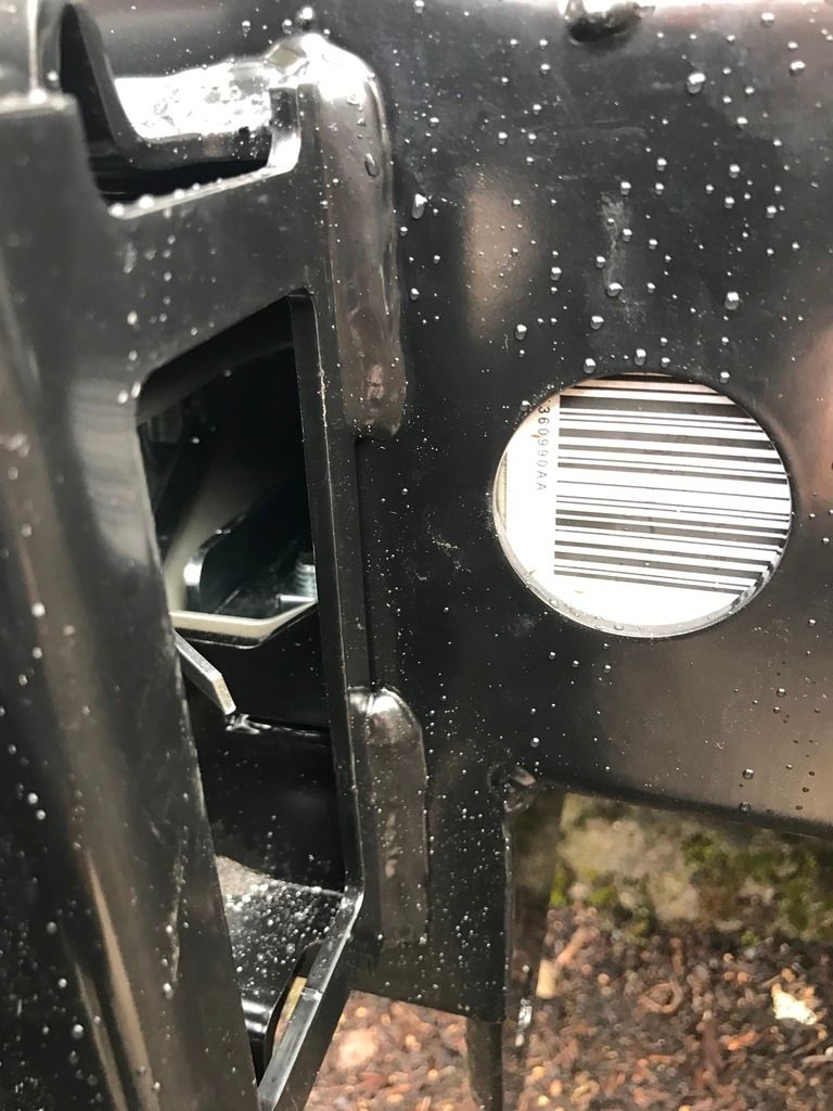

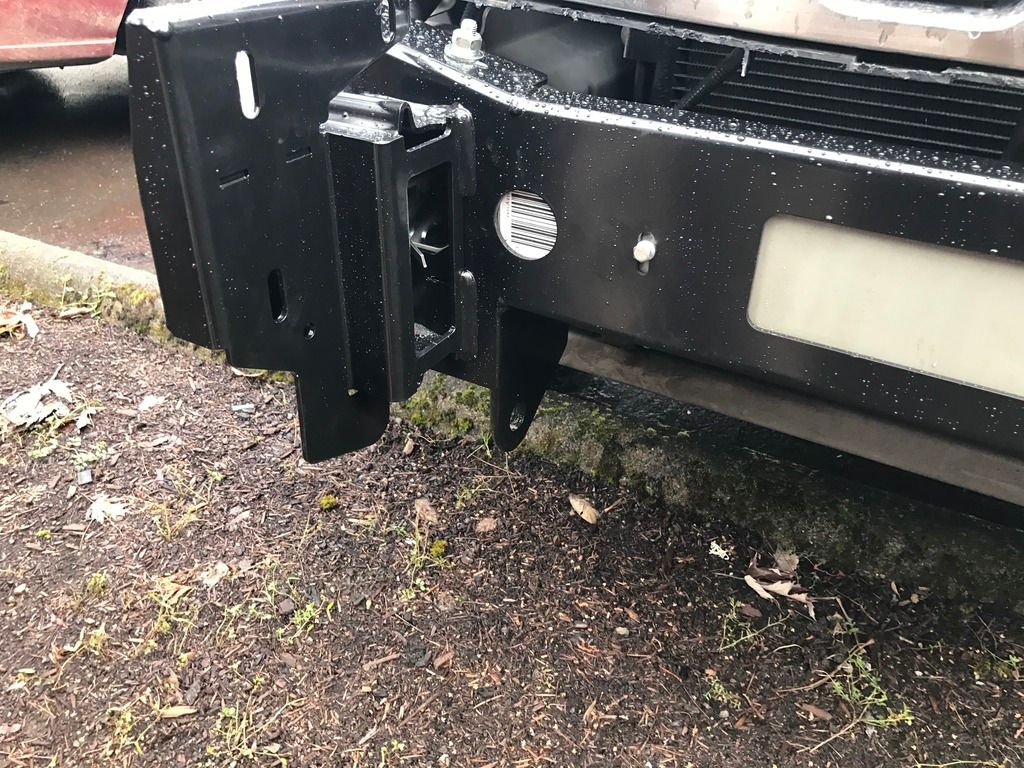

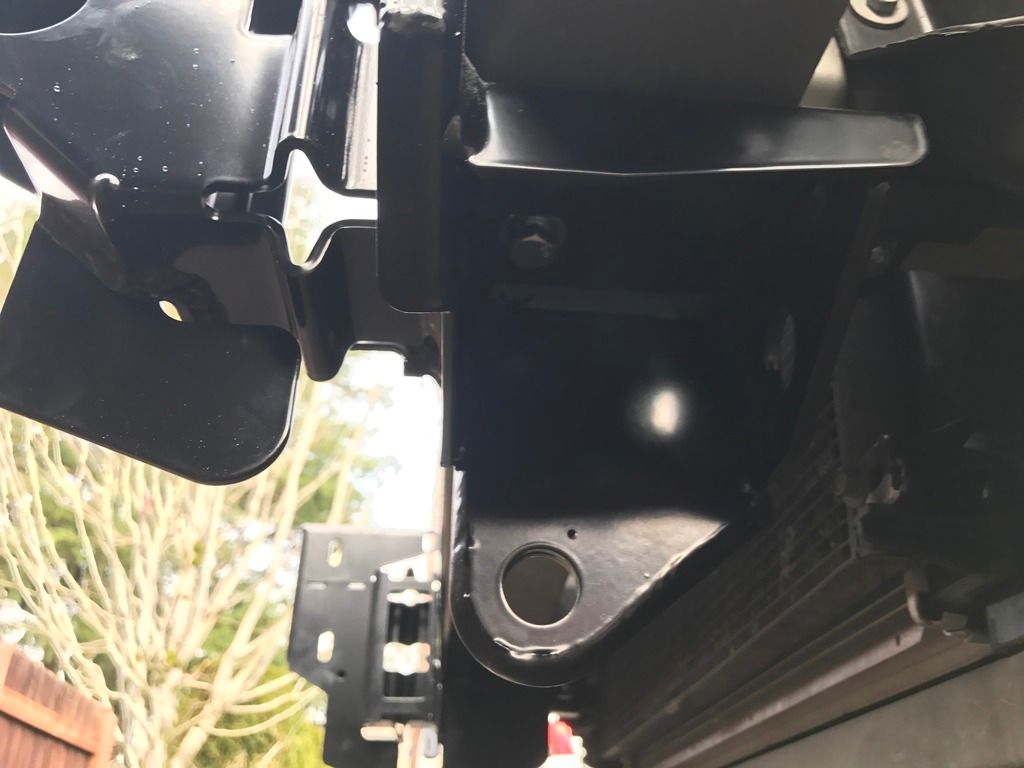

Here are some pictures of the mounting hardware, which I took when I stopped by part way through the project.
In this one, you can see the mounting bracket that goes behind the winch and bumper. All the black stuff is part of the ARB, not part of the stock rig.
Here is a closeup that's hard to make out, but you can see how sturdy the ARB stuff is. If you look close, you can see the threads of a mounting bolt, protruding through one of the heavy inserts they use inside the jeep tube to spread the load out. The silver stuff is jeep, the black stuff is ARB.
This is a shot from underneath. You can see they give you a very sturdy pull point under there, and if you look up and to the left, there's a funny set of bends in the bumper mount. I'm convinced that's to give you some crushing in an impact, and probably meets the 5mph no damage standard that I think stock bumpers are required to have. I'm confident that ARB did their engineering homework to make this sturdy, and as safe as possible given how tough it has to be. I'd rather need a new bumper than a new neck.
Here's a shot from above. There's a jeep cross member right behind that bracket. If I were designing the most elegant bumper I could, I would have to cut that out so the winch could back up closer to the radiator.
In this one, you can see a little better all the metal they've wrapped around the jeep "frame" to get a good grip on it. I like the mounting system.

My apologies. The first two pics in the last post must not have copied the link right. Photobucket keeps jumping to ads and reloading the page because I'm too cheap to pay. I'm not complaining, because in the words of the sometimes wise Butthead, "it was free, azzwipe".
Here was supposed to be the first one, showing the whole bracket in place. Hopefully this copied correctly now.
Here was supposed to be second one, commenting on the inserts:

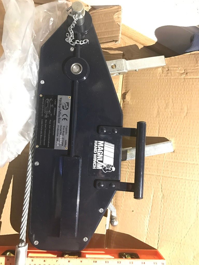

I'm still missing a part from the superlift, which seems to be a common issue with them. I picked up the WK so I could drive it around during the snow storm we're having here (not much snow, but for this area it's a blizzard). Here's a picture of the tire and wheel sitting next to the rig. Until the lift gets here, that's as close as it will get.
I also picked up my ARB hand winch (called a Magnum Hand winch). It looks like a quality item, and I can't wait to try it out. I have the winch mounted on the front of the jeep, and I have 3 snatch blocks to theoretically winch backwards if there are trees in the right places, but I always carry a comealong in addition to a hi-lift to make sure I can get out of whatever I get into. I might post some stuff on the hand winch in a separate thread.

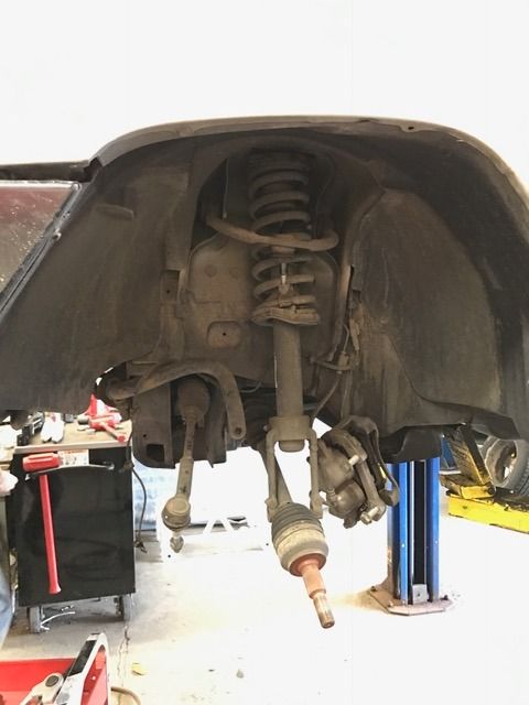

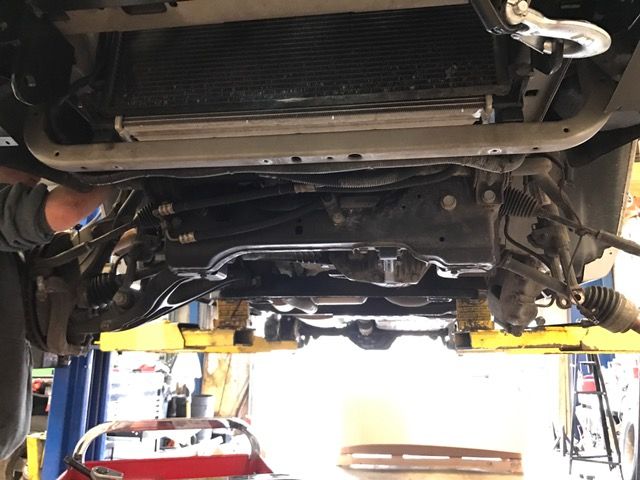

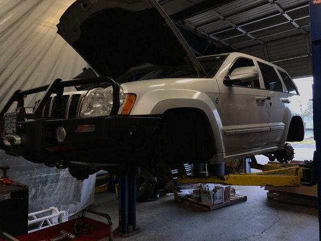

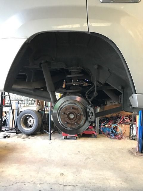

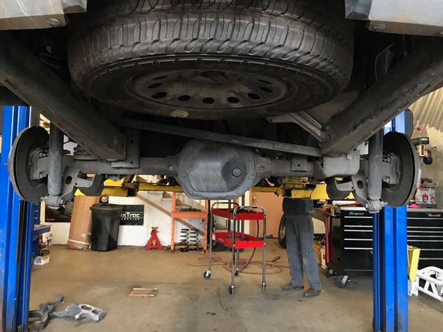

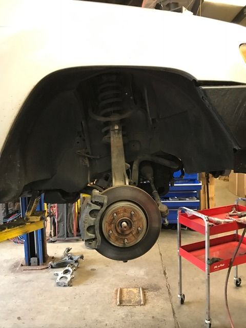

The Badger is finally back in the shop for the lift! The parts finally showed up after the snow melted. There's apparently some cross member or something that needed notched for the driveline, and a plate needed to be created to get the strength back. The shop said that was an unusually tough thing to get a good plate made. Maybe some people are just notching it, but it sounded like this lift is more difficult than most.
Here are some progress pics of the lift, provided by Matt at Accessory Outfitters (did I mention these guys are awesome?) :
